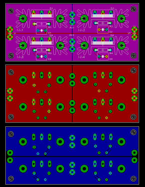

Hi, as a part of the UK Aleph-X group buy, it looks like we are going to try and get some rectifiers specialy made for the purpose, as some of the otherones currently available might not quite be up to delivering the curents people are after.
I have now come up with a design based around the BYW99W-200 Ultrafast diodes that are now used in the PASS amplifiers (have a look here). In it's current configuration, it should be able to supply up to 30A RMS before the diodes start to overheat (assuming an ambient of about 25 degrees, and keeping to the voltage limit of 200V for the diodes) which should be enough for most projects.
If enough people are intrested in getting hold of these modules, I will be putting an order in soon for the PCB's and the rest of the components to build them up. I would be looking to sell them on for a cost of £19.00 each fully assembled (with heatcinks and snubbing network) or about £4.00 for the bare PCB's if there are any spare.
The board itself will measure aproximately 90 x 40 mm and the heatsinks are 51mm tall on top of the thinkness of the board itself. It should also come with full solder masks and silkcreens.

I guess I was a little quick off the mark with this one:
It has now been decided that as we are doing this, it should be done as well as we can, so the board has now change to a double sided number which should perform a bit better and looks a fair bit neeter too.

I did know of peranders boards before I started on this, but we decided that for some of the Aleph-X implementations that people have been looking at, it would be hard to find a diode in a TO-220 case that could cope with curents much over about 8 amps using the heatsinks that will fit on the board (even with this design using the TO-247 package, thermal limits are reached long before the diodes curent limits), although saying that I did forget about teh MUR1520's which would probably be ok.
I did think about having a side mounted design, but I though that this method would be more flexible, as it can be put anywhere it will fit rather than needing to be fastened on to the main heatsinks.

One critique I would have about your board and Peranders board is that it would be easier to mount the rectifiers on an external heatsink if they were either back-to-back or face-to-face.
