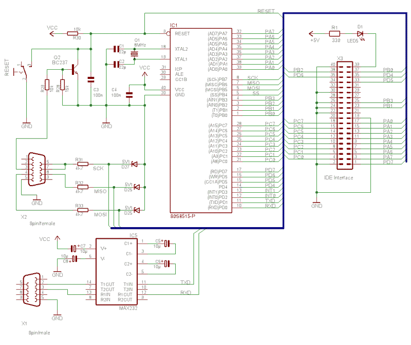

Technically, it should not be too difficult to control the drive via the ATA/IDE interface, for we don't need to transfer data through the controller.
One interesting (in terms of hardware simplicity) approach I have found is here: http://home.cybervillage.de/heesch/english/ide.htm. I have attached the schematic for all non-Eagle users. This unit so far is kind of a RS-232 controlled data storage device - not exactly what we want, but not too bad as a starting point.
As you can see, you need a microcontroller with 23 I/O pins to perform communication with the drive - no problem.
Most probably you will need a second controller for controlling keyboard, display and remote - I remember having seen this approach on a korean(?) site posted some time ago.
The problem is: controlling a drive via ATA commands is possible, but not that simple (at least not for me, as I haven't read all the hundreds of pages of interface specs). I am pretty much into hardware design as well as assembly programming on AVR microcontrollers, so this will be not too much of a problem - but only if someone can tell me exactly what to do.
So if there are some ATA/IDE interface experts out there it should be possible to get this thing started.

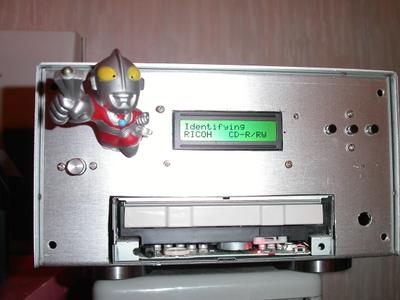

In Taiwan Chinese Website, diyzone have a KIT - 8051 CDRom Controller V:2.2 (Commerial Version)
http://www.diyzone.net/article.php?sid=195

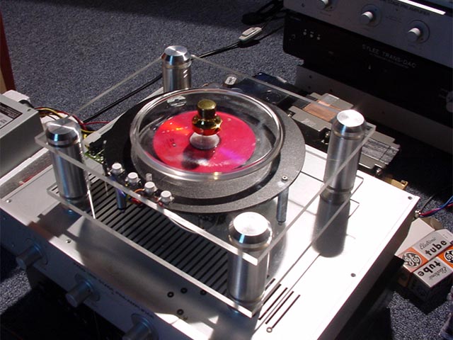

Thoughts about looks
Great thread,
was looking into this for myself some time now.
Got some nice link for the casing.
http://www.diymania.net/pass/project/transport.htm
You could add the display via some angled piece of plexiglas.

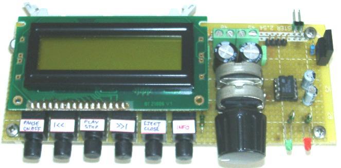

another link
Have you seen this side,
Already a controller with display.
Not sure if the software to control the display is already finished.
http://private.addcom.de/KeithWilson/Projects/mucop.htm
