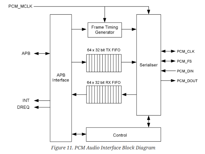

I see some chart with nanosecond figures, while at the same time the table says period-size 147 frames at 44.1kHz. The latency induced by the period part of the buffer alone is 147/44.1kHz = 3.3ms. IIUC the quote is comparing interrupt latency in your chart (microseconds) to playback-chain latency specified by the other linux distributions (milliseconds). Do you have any idea why?
Our development policy is to pursue improved sound quality by reducing latency. We are very committed to this approach. Any unessential features that increase latency are against this policy and are discarded. Disabling upsampling (soxr) is an example of this.
The PCM audio interface of RPi described on pages 138+ of https://www.raspberrypi.org/documentation/hardware/raspberrypi/bcm2711/rpi_DATA_2711_1p0.pdf has input and output FIFOs 64 ints long (i.e. 32 stereo frames). Default settings in the I2S driver linux/bcm2835-i2s.c at rpi-5.6.y * raspberrypi/linux * GitHub specify the PCM interface will issue a DMA request to copy one frame (max_bursts = 2 linux/bcm2835-i2s.c at rpi-5.6.y * raspberrypi/linux * GitHub times 4 bytes linux/bcm2835-i2s.c at rpi-5.6.y * raspberrypi/linux * GitHub ) from the alsa buffer to the I2S 32-bit register BCM2835_I2S_FIFO_A_REG when the fill drops below 48 (0x30), i.e. 24 stereo frames. The FIFO is clocked out at PCM_FS and PCM_CLK rate, not dependent on any latency setup.
Even if the driver was modifed to throw the DMA request at 0 fill (causing the FIFO underruns constantly), the FIFO is still there and no amount (or lack of) of software latency can influence timing and data values of the output I2S signal. Changing the latency can only influence buffer underruns/overruns = data corruption from the sound-quality POW.

papalius: Thanks for your answer. Still I do not see how all of this affects the jitter of the output I2S signal in a controlled way. Have you done any measurements for long term PCM_CLK/PCM_FS jitter improvement of a specific configuration for master mode, or PCM_OUT noise component for slave mode being improved by your changes in a consistent way?
Can I see the modified GPL sources? Thanks. I am trying to learn RPi4 limits for high-speed I2S, this is an important topic for me.

I still do not understand what timing regarding the D/A conversion you can make more precise with your software changes in RPi4.
At symphonic-mpd, we believe that our success was due in part to the fact that we were not fixated on the time-varying voltage of the I2S signal, but rather on the basis of developing an indicator that was observable, repeatable, and sensitive to minor software changes.
Interesting, what observable, repeatable, and sensitive indicator is that if as you say you cannot measure the changes?
