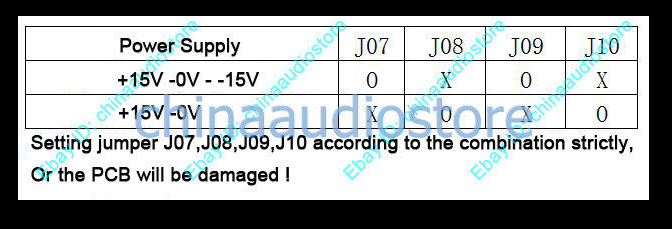

The board arrives set up for dual rail supply +15 0 -15 volts and the supplies you have linked are single rail. +15 0 volts
It can be run on single rail but you will have to do some soldering and desoldering on the board at J8 through J10.
From the sellers description...
Power supply: regulated DC voltage double 15V
* It is recommended to use dual 15V power supply to play board best results

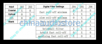

Note that "o" = connection and "x" = no connexion... see attachment ...very confusing as this is back to front from usual
Power supply instructions: board shipping silent dual 15V power supply,
change the power supply need to set the corresponding jumper:
Jumper setting Description: (O = connection; X = off)
Also, it will not perform or sound as good on a single rail.

see attachments...
0=connection x=open...
so coax is J2 optical is J3 and i2s is both J2 and J3
You seem to have it reversed and are using x=connection o=open
If I could see your image I maybe could see if your board is different version.. Mine is VR-1.04

Your image won't load so I can't see what you have set but...
see attachments...
Right click on image and try to open it in another tab. Should work.
I got same version as you and J2 shorted is for toslink and J3 shorted is for coax in my board. I2S is when J2 and J3 are opened or both shorted (I just tested it).
