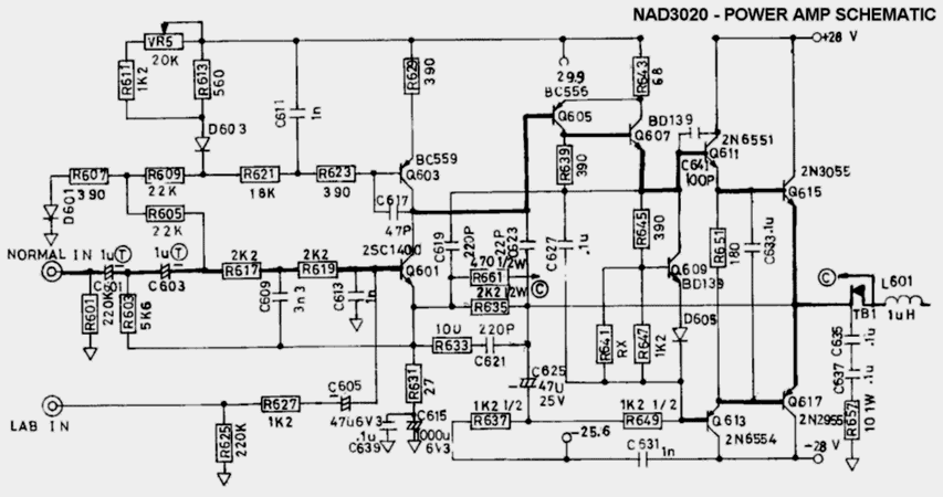

Every now and then, has been topics about NAD 3020.
It is really one Classic and good Amplifier.
We should know that there were several versions of NAD 3020.
With some modifications in components.
Here at The Class-A Amplifier Site
is a schematic of such classics.
I guess the version is the original NAD 3020.
http://www.tcaas.btinternet.co.uk/index-4.htm
Schematic:
See my attachment.
Regards and New Year 2007
lineup
