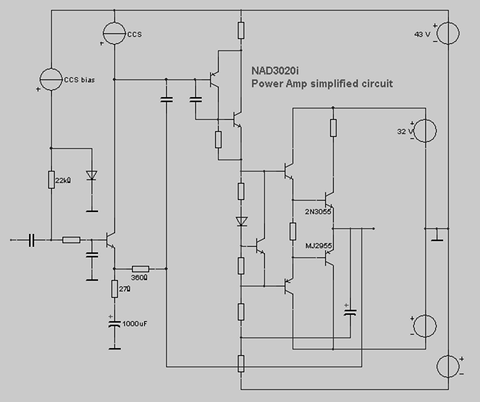

I used cpemma link schematic thanks!
to set up NAD 3020i power amp in my Sim.
I wont tell you any results, of THD and Fourier ..
It will be my little 😎 secret 😎 !!!!!
So, what kind of power amplifier is NAD3020i ????
Really ???
As can be seen from my attachment
there is not any remarkable features.
Kind of 'old style', with bootstrap
and feedback to emitter of one single input BC550C.
So what makes this amp so loved, so good?

that mexbro link to the NAD schematic is illuminating.
Nested feedback and lots of other designer tweaking shows in the complexity.
I wonder how long the designer spent optimising the component values!!!
For a cheap amp, the PSU is surprisingly complex and discrete opamps in the RIAA & Tone.
I begin to marvel at the value engineering that must have gone into all that.
No wonder it got good reviews, I can imagine how simple (=cheap to make and =cheap sound) it's competitors were in comparison.

It is true the bandwidth of NAD 3020i is restricted.
Not only in local stages.
In my simulation it shows a total (including input lowpass filter)
upper limit -3dB at ~75.000.
But I can guess this was not too bad in those days when this amp was first released.
Still is not bad today.
It is surely enough for handling LF-signals within the audio band.
