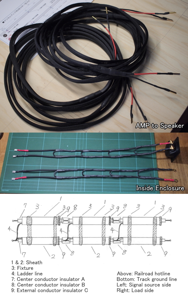

Ladder type Speaker Cable
Cable : Single core coaxial cable 1.25sq or 0.75sq * 2

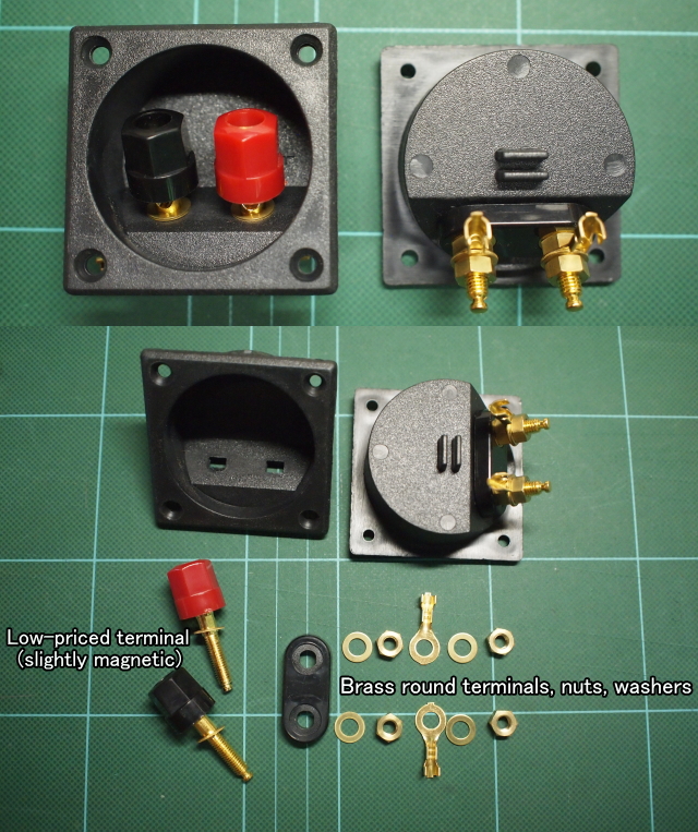

Banana plug : SteinMusic IBP-24

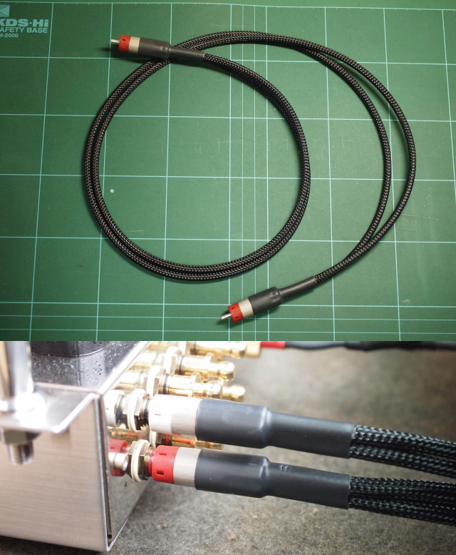

[+][-]separated RCA Cable
Plug : AECO RCA plug
Cable : Single core coaxial cable 0.5sq * 2

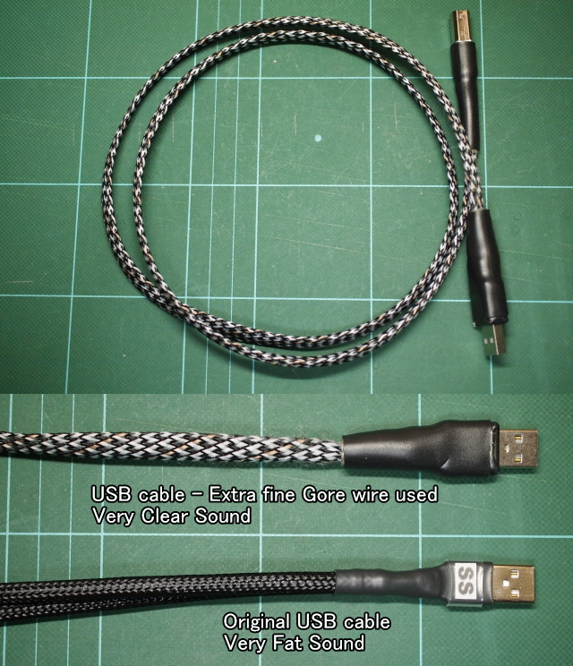

[signal][power]separated USB Cable
Plug : Normal plug
Cable : 2-core coaxial cable 0.5csq * 2

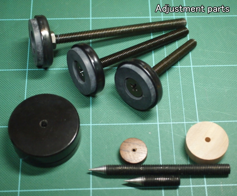

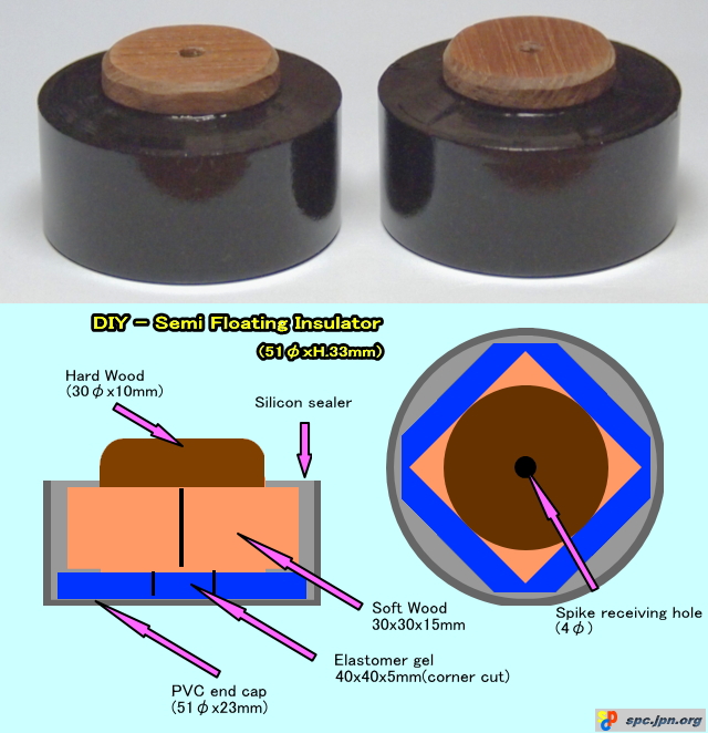

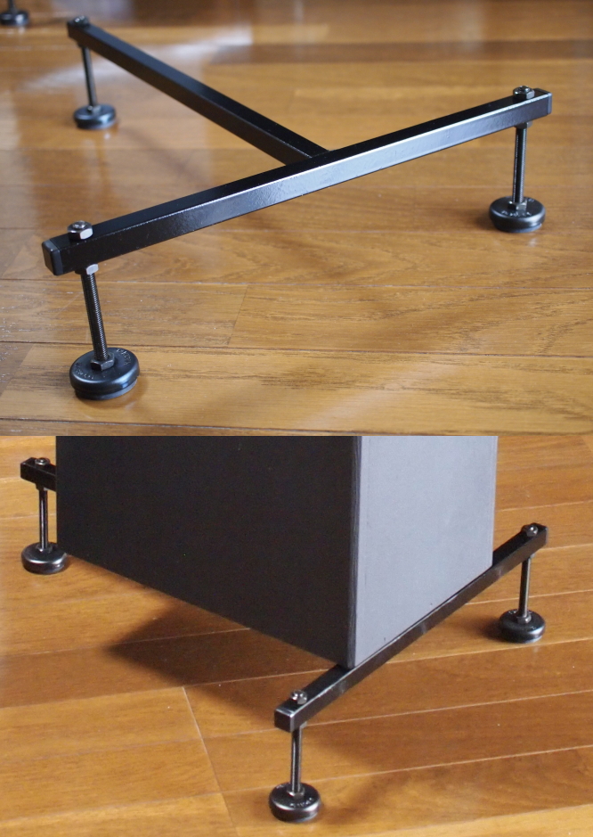

Speaker Insulator
original, semi-floating insulator

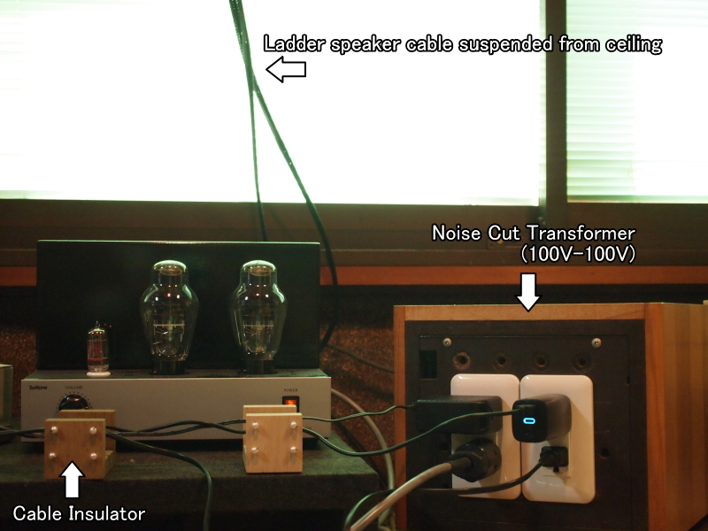

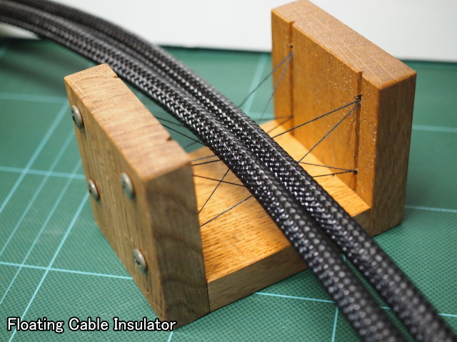

Cable Insulator
original, wood and tetron thread used

The only equipment I use to "improve" a fullrange is a simple analog band equalizer - nowadays preferring the DSP due to it's flexibility and bigger playground. I like your stuff especially the floating cable insulator. Looks like a fun DIY project! The ladder cable for inside an enclosure keeps me wondering how you fixated it that there is no rattling noise happening. I guess the cable is sturdy and heavy but if it's swinging against a wall... No criticism just being curious

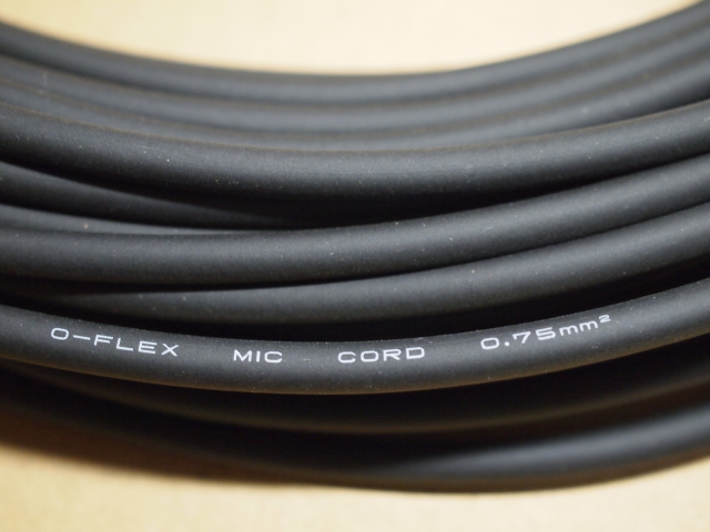

In addition, only the internal wiring uses a rubber sheathed microphone cable, but it feels good sound.
Assuming a ~typical 6m loop length, then single core 1.25mm^2 wire (roughly 16.2ga) will have a DC resistance of about 0.17ohms & approximately 0.18dB losses into an 8ohm load. The figures for 0.75mm^2 (roughly 18.4ga) with a DC resistance of about 0.28ohms & approximately 0.3dB losses into 8ohms. That's likely to be audible. In some circumstances where additional series R is desirable to artificially raise Q and alter the bass alignment this may be useful. The lateral separation of the cores will also raise loop inductance; assuming, say, a 30mm lateral separation of cores, it will be over 80% higher than if the cores had only 5mm separation. Arguably a moot point given the bandwidths & types of driver involved, but still technically reduces the HF bandwidth limit.
Looks like a good single-ended interconnect to me.
Plug : Normal plug
I'm no expert on digital transmission, but this does not look like it will conform to USB technical standards, which may cause an increase in the number of errors (and more work for the error correction).
Speaker Insulator
Very interesting. Isolation can certainly be beneficial, especially on suspended floors.
Cable Insulator
Is this to lift the wire off the floor? I'm not certain what it's supposed to do, but like the others, I don't see how it can prevent drive unit motor distortion caused by excess excursion.

Ladder type speaker cable is suspented from the ceiling.
Cable thickness was selected after listening 0.1cm2 to 5.5cm2.
In addition, I decieded other all cable's thickness after auditioning.
And, material of wire is unified with tough pitch copper(TPC).
About USB cable:
Ultra-fine wires are considered to be the best for digital transmission, but compared to many finished products, I choise "0.5 cm2 with fat sound" for Full-range driver.
At the finished product, USB cable that uses an extra-fine Gore wire(for airplanes) is which makes a very clear sound.

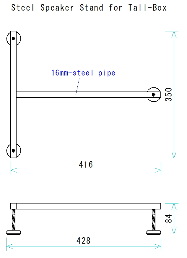

I like enclosure that are light and vibrate, so I made a stand with light steel pipes for full-range speaker.
[ YouTube ] Sounds of "MAOP10 + TWTD-13.5T + Light steel pipe stand"
