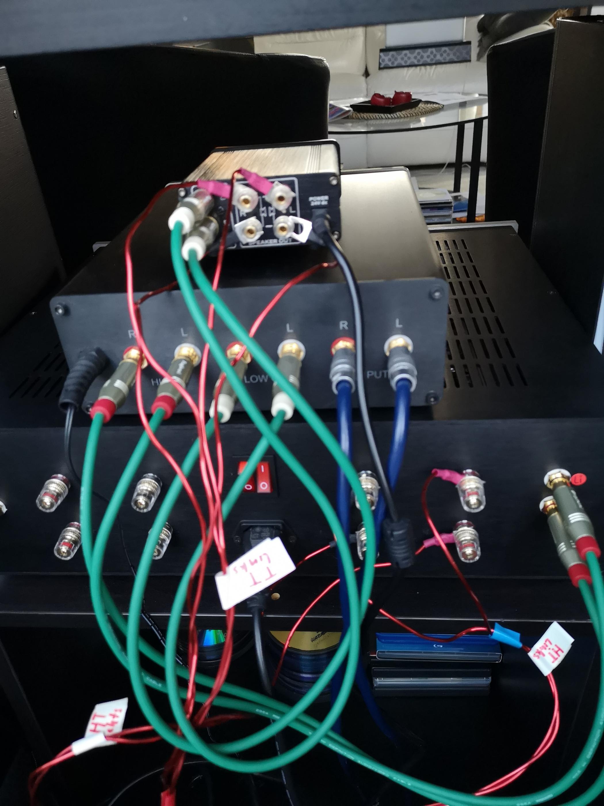

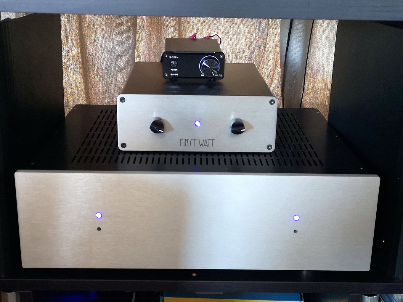

A quick photo with my mobile phone. On top of the pile the little stop gap digital amp (SMSL SA50) powering the woofers, then the B4 active crossover, then the housing of currently one SAKSA. When the second module gets put in, all 4 LEDs will light up. Unfortunately no photos of the inside yet. I was just too eager to get it finished and playing to take photos during assembly. :blush: I will catch up on that when I get the second module.

hopefully the photo will show now. Sorry, its the first time I try to upload a photo and something went wrong on my earlier post.

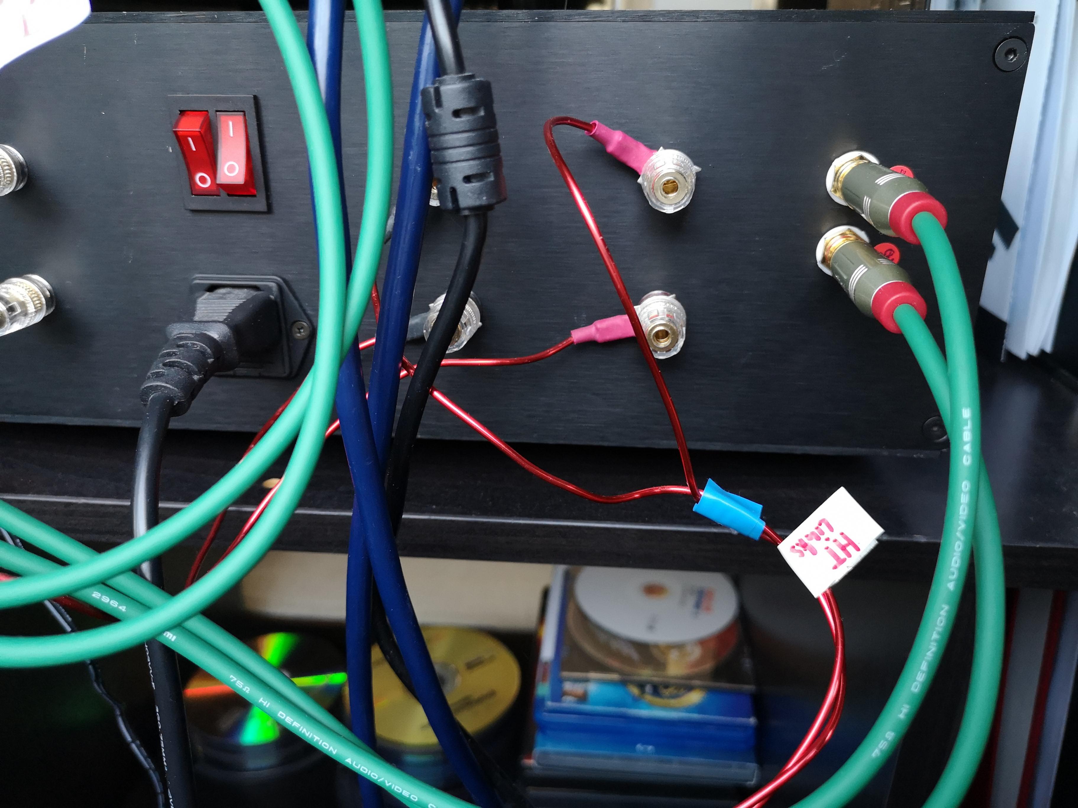

Due to a very narrow space behind the shelf the photos of the back side are suboptimal.
The cables are rather untidy as a) the speaker cables (the US „AntiCable“) are solid copper and very (!) stubborn and b) I have to run
the second pair of cinch connectors up to the little digital amp.
That will be much better after the second AKSA gets put in the enclosure and all cables run into one
enclosure.

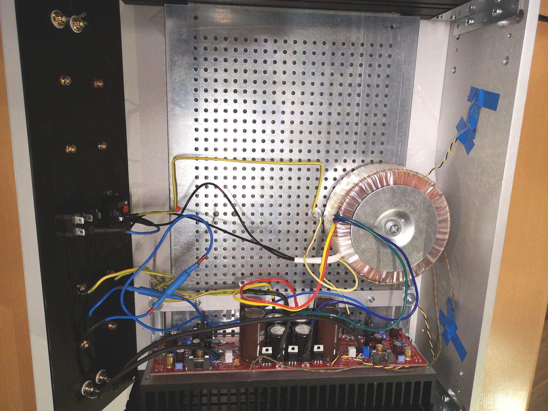

Hi maty tinman,
Unfortunately just one lousy photo of the inside. I was just too eager to get it finished and playing to take photos during assembly. :blush: I will catch up on that when I get the second module. In the middle of the case the second transformer will sit, on the empty side the second AKSA. The wiring is not as it should be, its a bit sloppy. The blue tape on the front panel keep the 2 rectangular LEDs in place. Looks perfect from the outside and horrible on the inside. Will construct some brackets as a final solution.
[Big IMG] http://maty.galeon.com/WP-imagenes/hum/Saksa-85-one-module-pan53-inside.jpg

Same modules but in mono from other ensambler, NORD:
[IMG, link] https://imagizer.imageshack.com/img924/3920/l1FE0X.jpg
You know, beautiful case -> buyer is willing to pay more to show off, but as soon as he takes a look inside, with that wiring and over the wires above the transformer ..

Wiring
There is an intermediate term. Just take into account the physical laws, for example, that force and energy decrease exponentially, with the squared distance.
What areas are the most sensitive? The transformers and the coils thus radiate. The power cables, if they are long and the audio section.
No one who has a little idea will think of passing certain wires over a transformer that is not shielded!
Seeing the wiring and the layout of the modules many things can be deduced.
[IMG, link] https://www.audiosciencereview.com/...mplifier-module-teardown-optimized-jpg.28904/

Hi Rom,
thanks a lot! I fixed the cable, it was a bit loose. The space on the backside is very constrained, one has to be careful not to get a short circuit by touching cable terminals.
I am really looking forward to have everything (the 2 SAKSAS) in one case neat and tidy.
Maty,
thanks for the law to work or look from ("that force and energy decrease exponentially, with the squared distance") and the links and pictures, much food for thought. I am aware that I have to thoroughly rework the routing of the cables inside the amp. Was thinking about making some "pillars" (brackets) to fixate the cables apart from each other to achieve maximum distance. The sub-chassis with the grid would facilitate that. As I mentioned before, I will do that when the 2nd module arrives.
