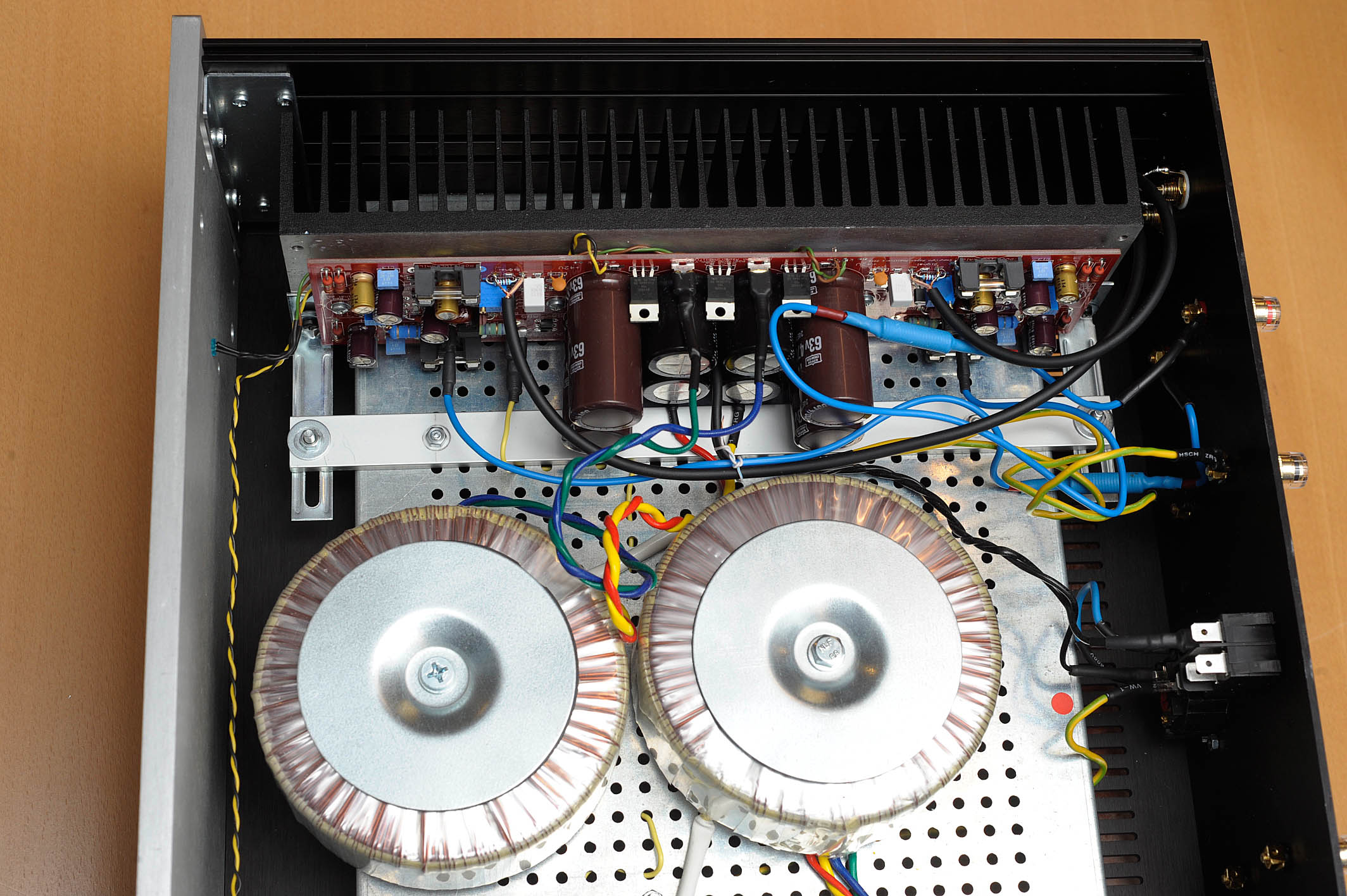

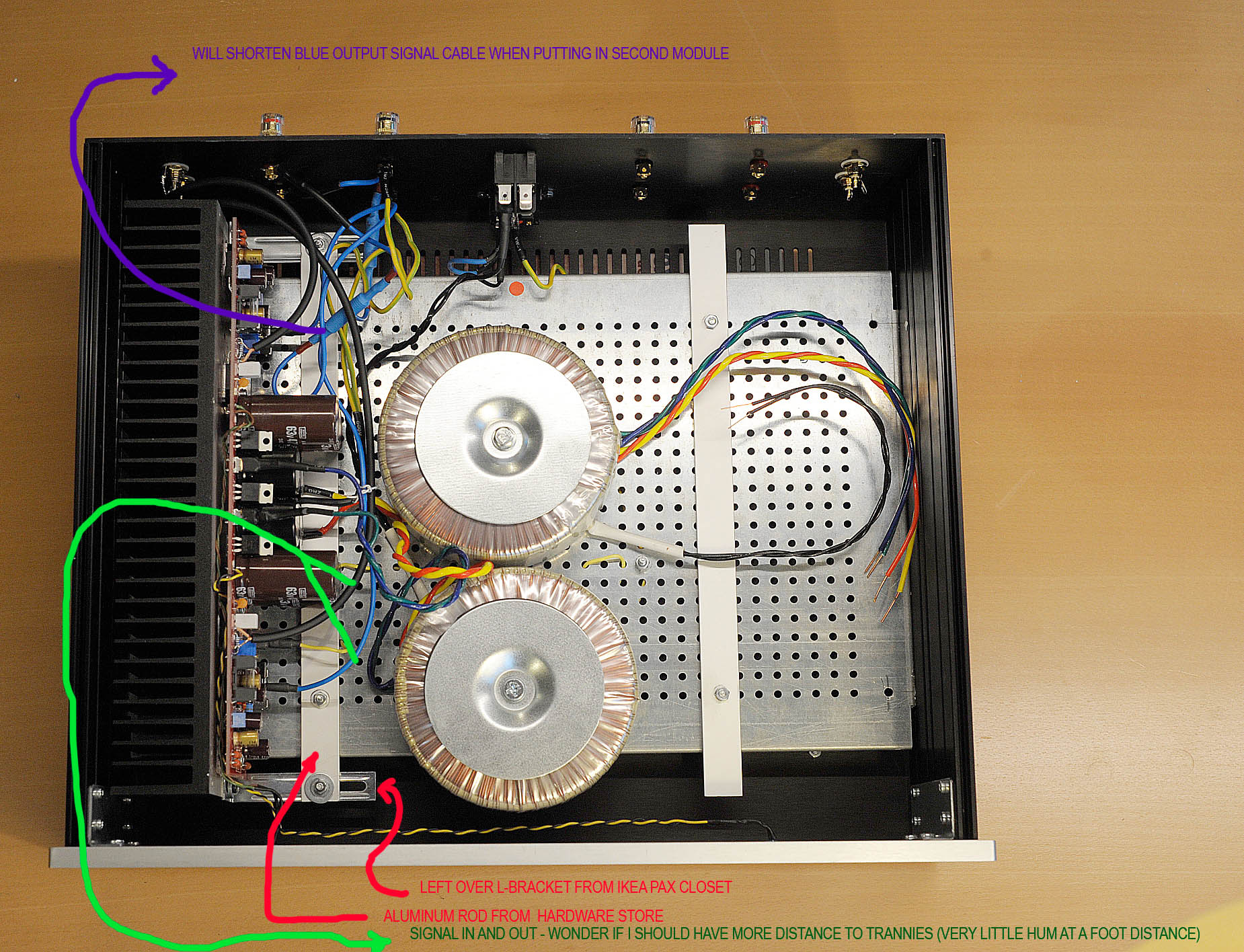

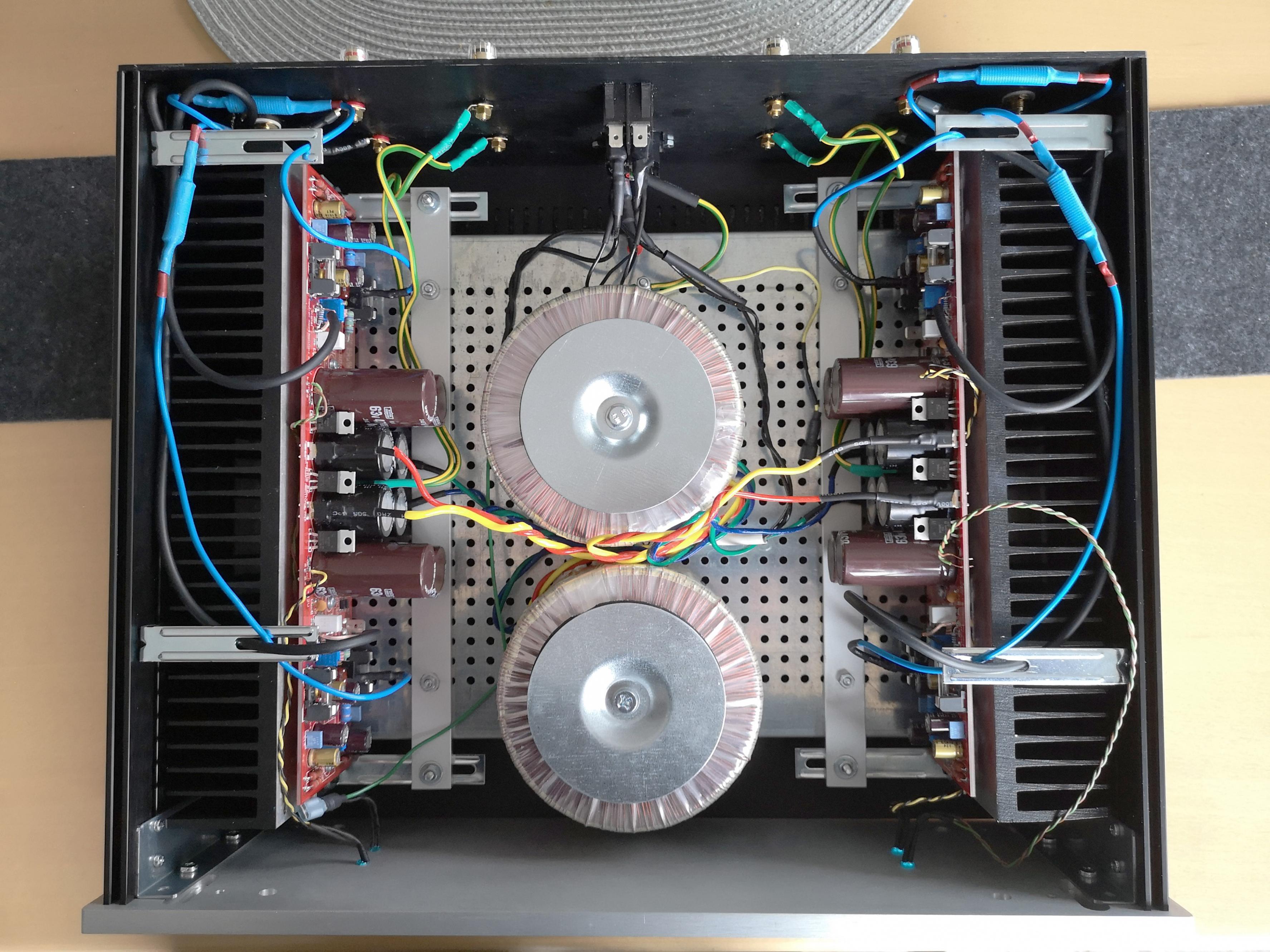

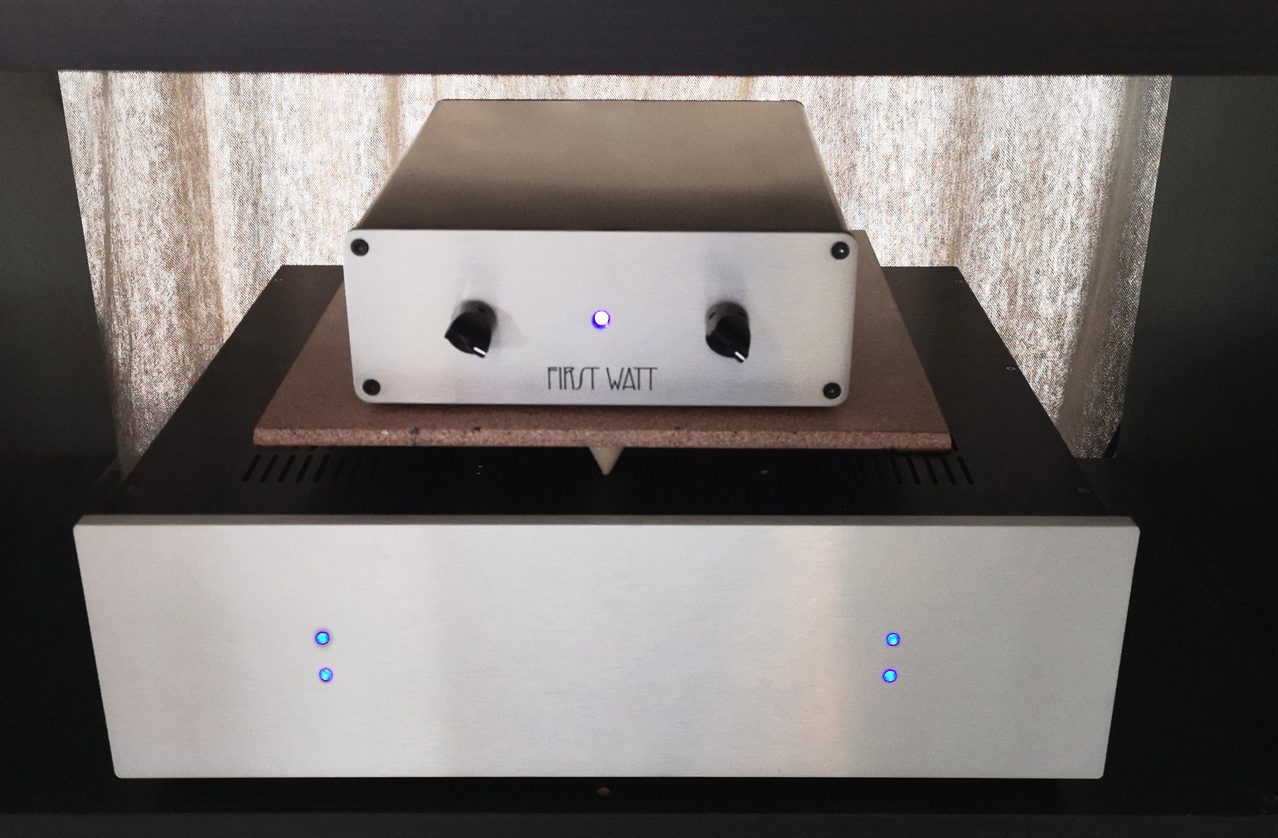

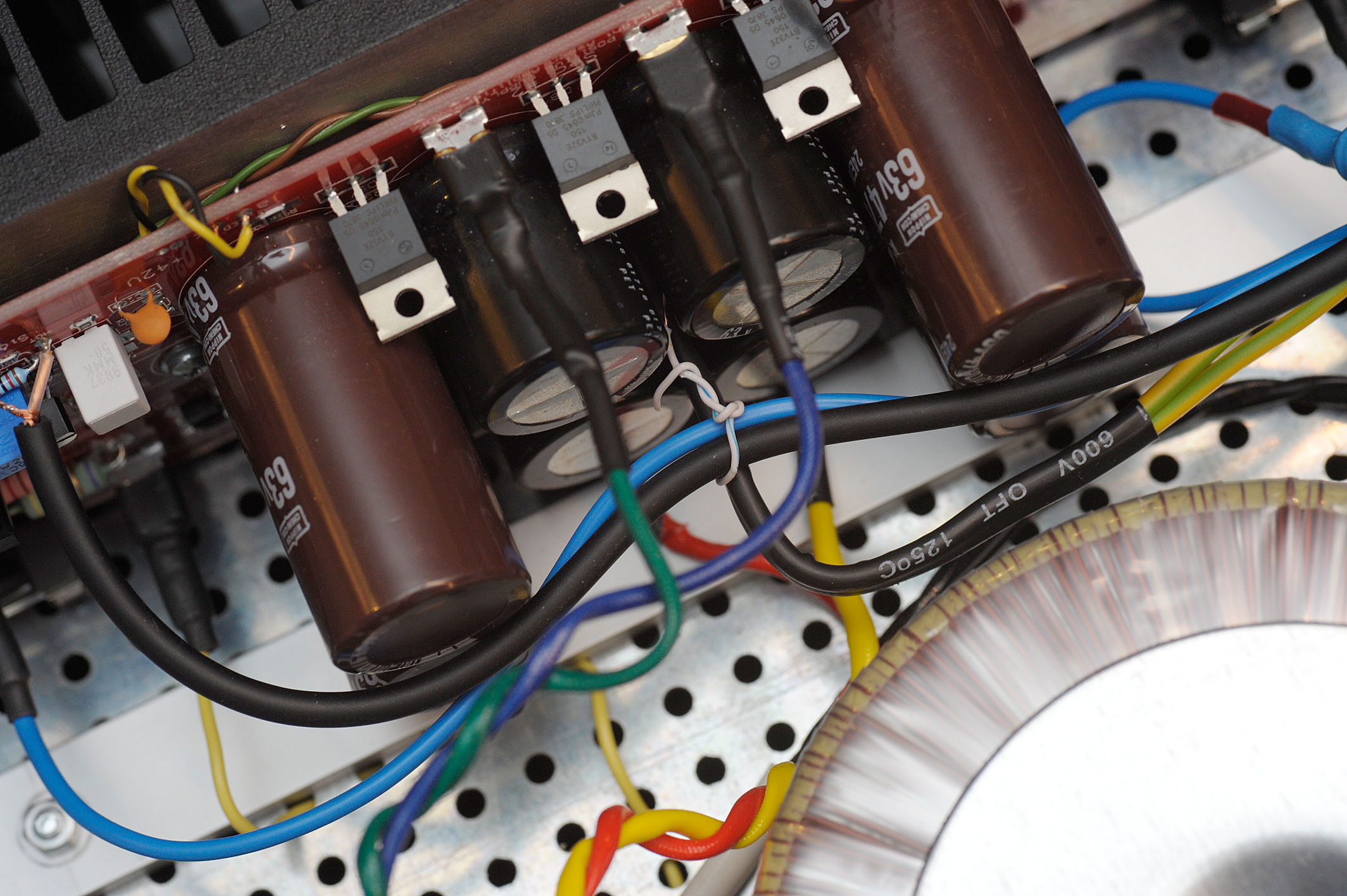

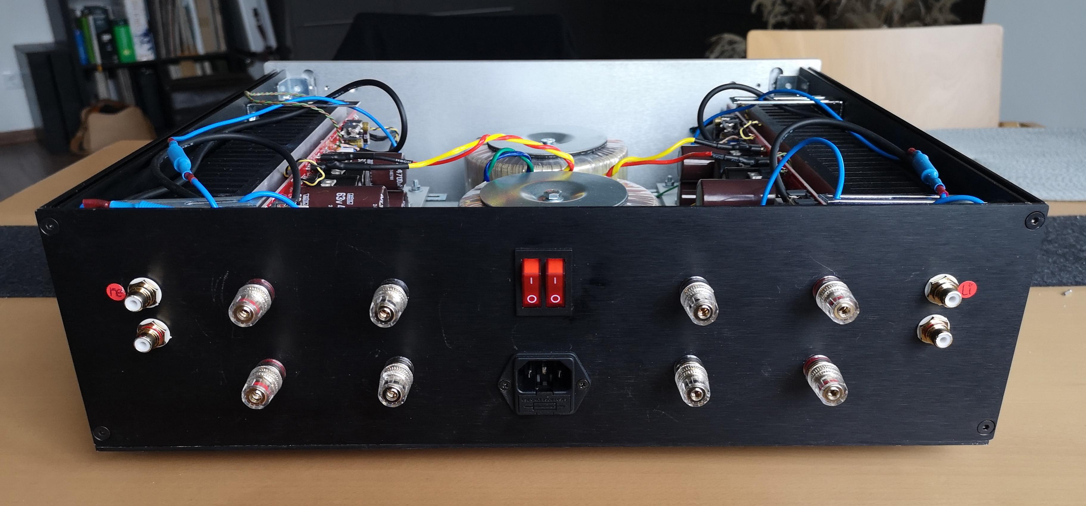

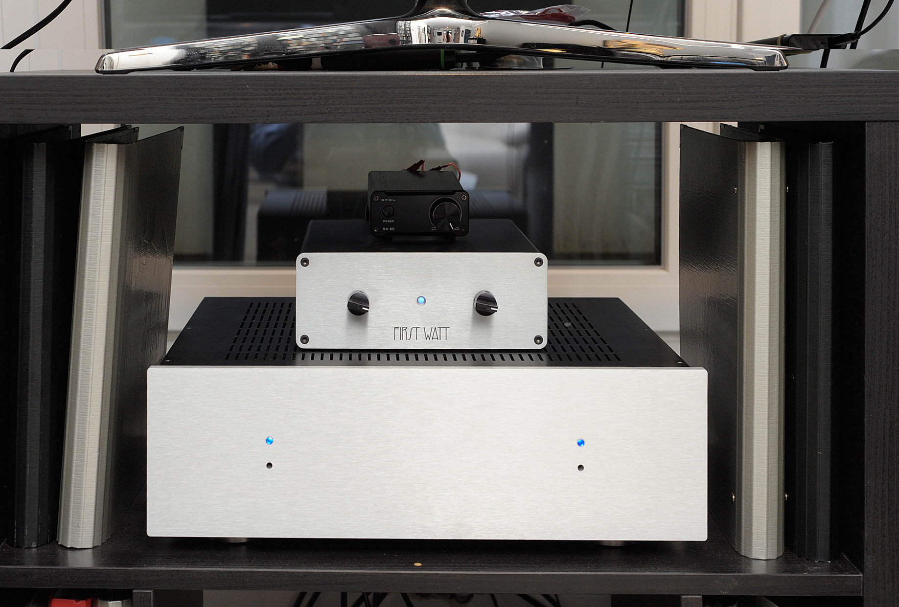

second transformer arrived so I had to put it in...
Today the second transformer arrived and round 5mm LEDs so I could not resist putting them into the case right away. I turned both transformers upside down so as to get the transformer cables down to the grid plate and a bit out of the way. I also put the common ground screw on the underside of the the grid to get it out of sight too. Then I exchanged the rectangular LEDs I had fixed with tape to the front plate to the newly arrived round ones. (Looks much nicer if only on the inside...)
Twisted the transformer cables and bent them away from the signal leads as far as possible (ca. 1 1/4 inch).
The black input signal cable was too short to get it further away from the transformers.
Please Hugh, when dispatching the 2nd Saksa, please add 120 cm of the input cable, I could not find a decent one here in Austria.
I hear a faint hum at around a foot from the speakers, therefore I have to get longer cables and reroute them, probably between Printed Circuit Board and heatsink, where I hid the LED-cables for now.
Currently the amp weighs 13,7 kg (30 lb) (completed it will be around 15 kg (33 lb)
When I first put the module into the case I had it oriented so the heatsink was in the middle, between transformers and the PCB. I did not like that as I could not easily get to the connections on the PCB so I turned it around. Did not make a sound check to see if the little hum was less that way.
If anyone has experience on that any help is appreciated.

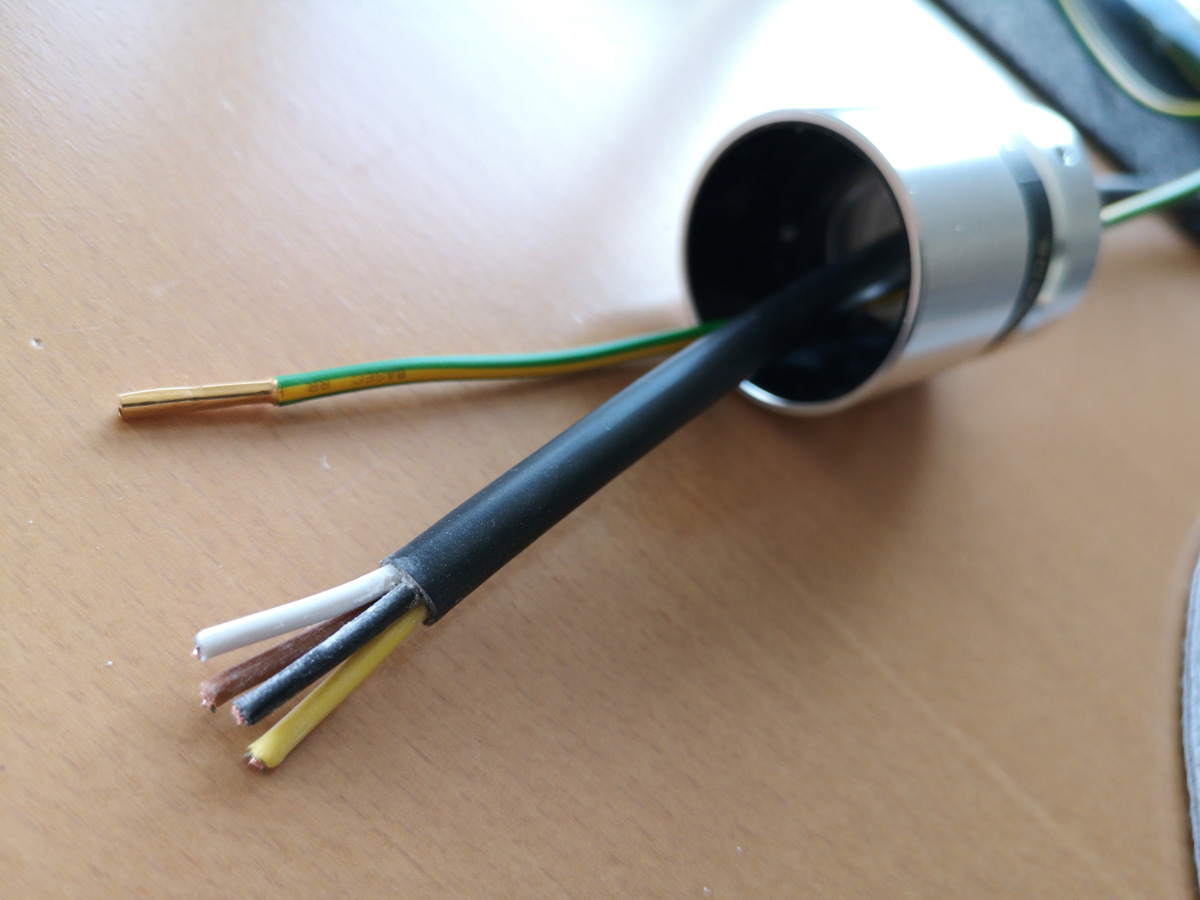

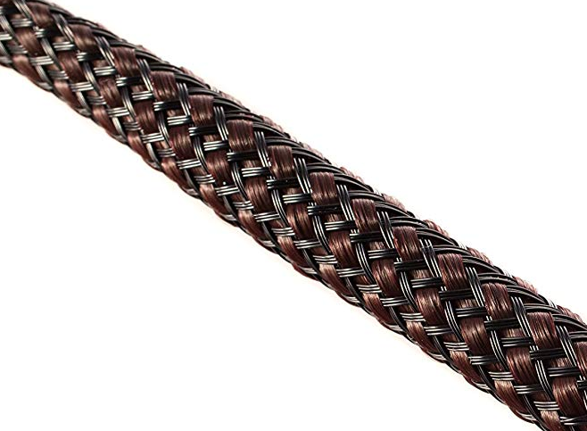

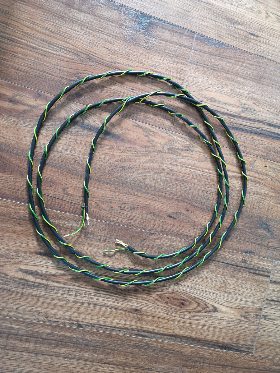

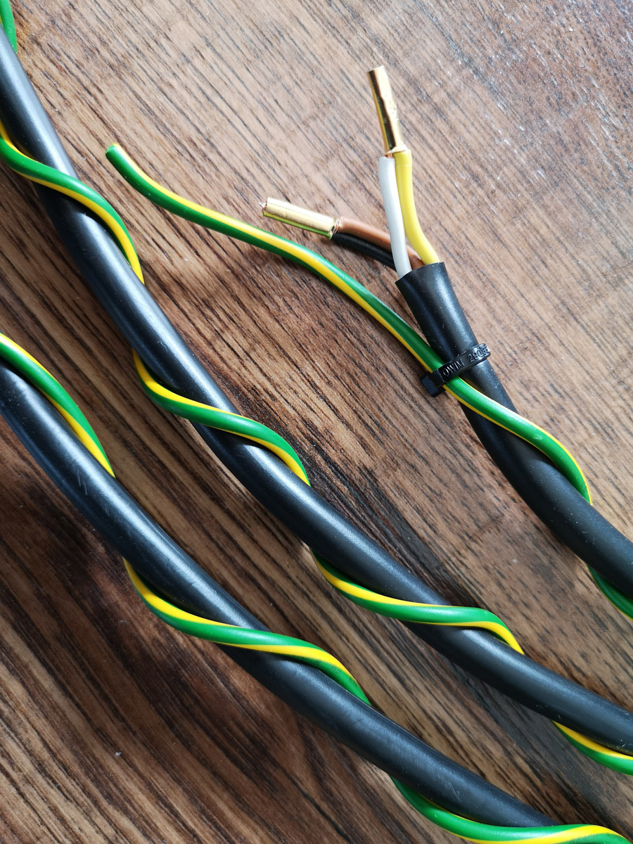

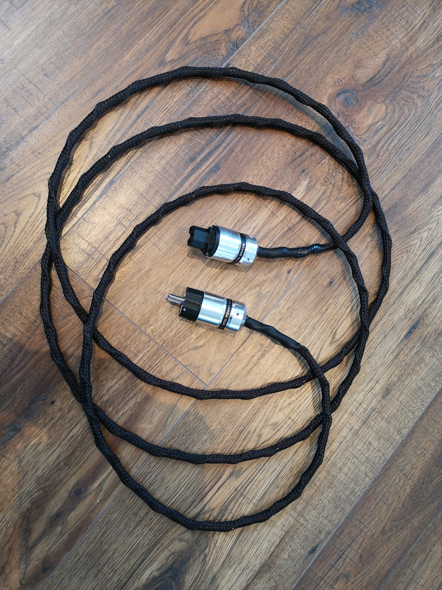

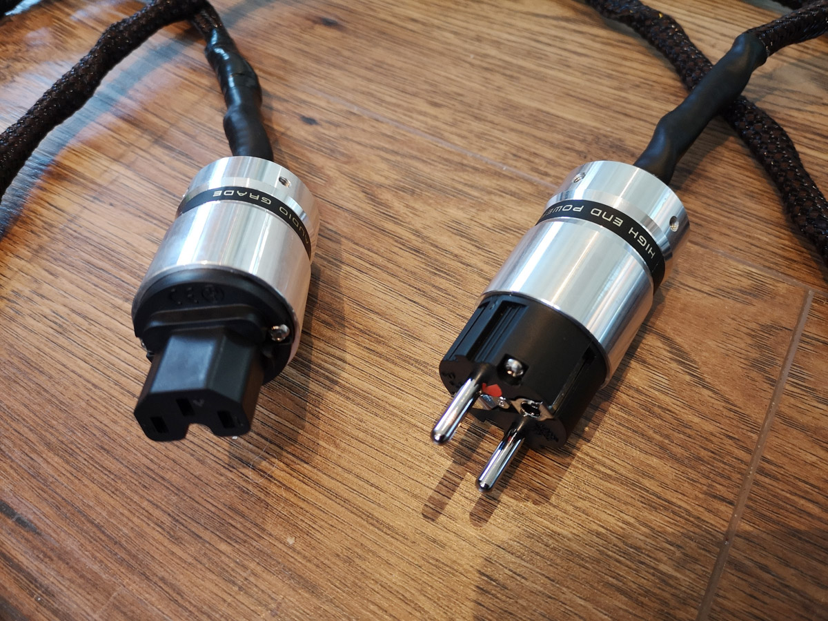

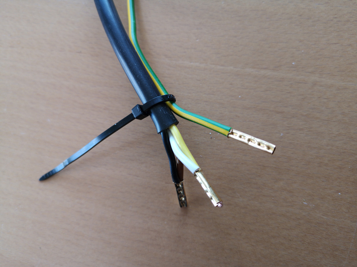

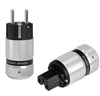

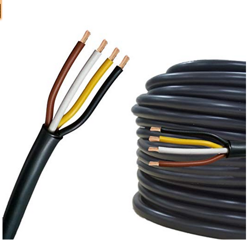

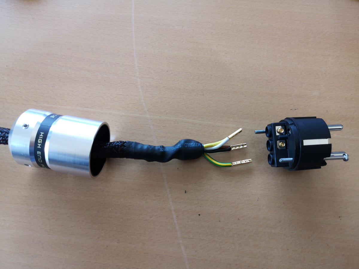

To provide some reading stuff and prepare the home for my next SAKSA….
Thanks to Maty tinman I had a look at the Starquad cable. I must admit that I mostly use the ordinary black power cables. Not being willing to spend a lot of money again I built two power cords myself.
One 60 cm for the SAKSA and one 3.5m for the connection from the wall outlet to the Dynacord X4100 line filter.
I ordered
Viborg power plugs:
4-strand cable: 4 x 1,5 mm² made in Germany, but no 6 nines copper, no fairy dust.
ground cable (1,5 mm²)
expandable braided sleeving
shrink wrap
And according to the photo tutorial at
Belden 83754 Star-Quad Powercord -
I built the 2 cables.
Look nice, give peace of mind.
Audible difference?
Nothing I can reliably report. But then, I did not take the time to compare old and new….
Maybe I DO need some fairy dust ….

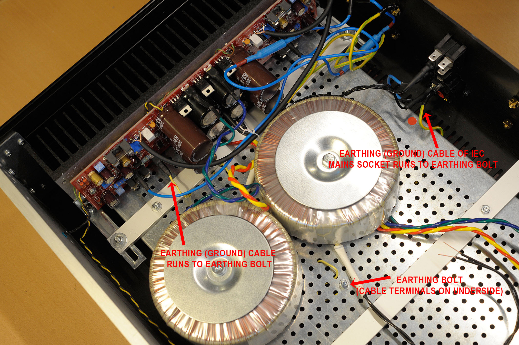

hum from the speakers
I have a little hum problem from my saksa and I can't find the references to appropriate measures to get rid of it. In a distance of 1 m I can hear a distinct noise in my speakers. It is not only a clean low 50 or 100 Hz sinus hum but contains also a "scratchy" component. (Don't know how to describe it better)
Currently I run the yellow earthing cable from my saksa to a bolt I fixed to the subchassis of my enclosure. From there I run another earthing cable to the earth terminal of my IEC mains socket.
Is there a tried and tested procedure to follow to minimise this noise? Are the earthing cables still just to close to the transformer?
Should I turn around the module so that the heatsink is between PCB and transformers?
Should I position the grounding bolt to another part of the enclosure?
Is it important that the distance from the grounding bolt is the same for both modules (the second module is going to arrive soon) ?
Peter,
If you disconnect your input RCAs, do you still have the hum?
Try one, then the other to see.
Hugh
Hugh
If I disconnect the RCAs, the hum looses some of the "scratchy" (higher frequency) component and becomes a cleaner hum. The lessening of audibility is about 30 to 40%.
Peter,
Try disconnecting the green earth wire from the chassis earth. (Pull off the spade on the pcb connection, easiest to do.)
Before you do this, test that there is 10R resistance from RCA ground (disconnected from source) to chassis earth.
Hugh
Hugh
Thanks, Hugh I will do that. Now (13:30 local time) I have to leave to pay a visit, will do it at night (in about 6 hours) and report back.

Some progress
re hum: Before mounting the second SAKSA I turned around the first module so that the heatsink was between transformers and PCB to see if the heatsink would provide some shielding and the increased distance would reduce the hum. That wasn’t the case so I turned it around again and mounted the second SAKSA (see photos). Thanks to the extra length of signal cable Hugh provided I could reroute the signal cable along the side walls of the enclosure, as far away from the transformers and the power supplying wires as possible.
I also moved the ground bolt close to the IEC power input socket at the rear of the enclosure.
I tried to run all the cables as symmetrical as possible.
Result: A little overall reduction (20%) of noise. Only when I disconnected the ground wire from the PCBs to the grounding bolt of the enclosure I achieved a reduction of noise (mainly hum) on the RIGHT channel only. On the left channel (the new module) there is still a a bit of hum audible from about 50 cms and closer.
Fortunately it is not really discernible when music is playing (and I am sitting 2,8 metres away from the speakers and not 50 cms…). Still, it is something I need to remedy in the long run.
Any hints and tips what I can try to get rid of the hum are very welcome!
Specific question: Would 2 aluminum „walls“ between the transformers and the modules be promising? As this would be difficult to organize (can’t do it myself) I’d like to be rather sure about the result before I try this measures.
But now I am just enjoying the marvelous sound. At one point of listening to a classical recording I was just overwhelmed by the beauty of the sound. It cannot get any better than that!
Next on my llst will be meticulous positioning of the speakers and subwoofers in my room.
It MIGHT still get a bit better than how it is now….
