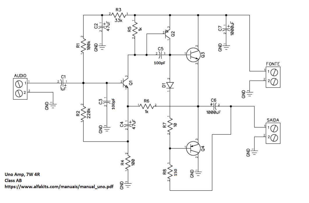

Hello friends,
Today I tested an extremely simple project (4 transistors) developed and produced by a friend of mine from Brazil.
His website is this: AlfaKits Eletrônica
The cool thing is that on his site is shared free of charge the electrical scheme and layout of the PCB for those who want to produce for their own use. Production for sale is prohibited.
I was impressed by the level of THD he achieved with a simple 12 to 15V power supply and only 4 transistors.

Neat design, reminiscent of a singleton input cap-coupled output amps that I have seen around here on DIYA.
attachment.php
No emitter resistors, and a single diode as a base spreader as a consequence, to limit the risk of thermal runaway is a good recipe for Xover distortion.
It may give more "edge" to loud music, but for softer programs it could be somewhat unpleasant.
In addition, the speaker will see a permanent 30~40mA DC current.
Not catastrophic for a big 100W or so unit, but not ideal for a 5 or 10W one
I also had a ZX spectrum, and IIRC the OP stage was even cruder, something like a single, binary-controlled transistor.
The THD figure of the 4-transistor amp might be relatively low (hard data please?), but Xover distortion does generally not have a large impact on the global THD figure, it is simply extremely unpleasant, even at very low numerical levels.
An oscilloscope or an ear is a better detection tool than a THD meter in this case

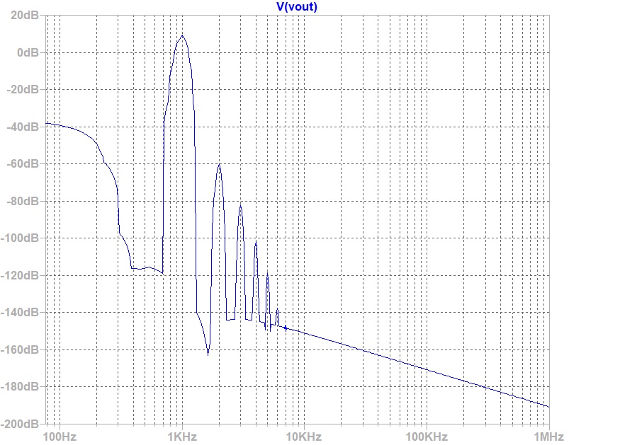

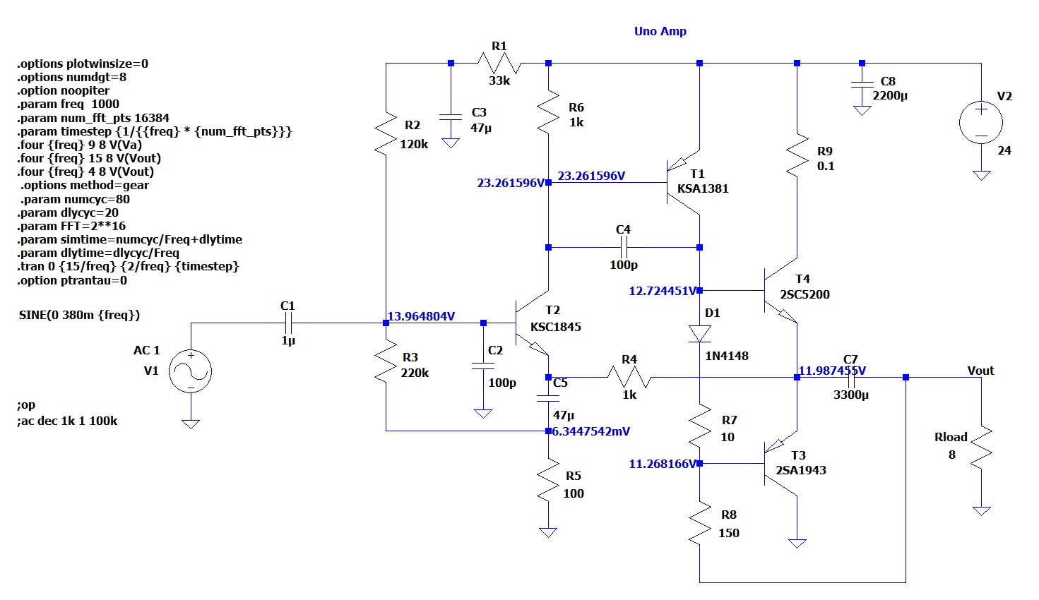

I ran a quick simulation using commonly available actives for the typical roles here.
attachment.php
Increased the operating voltage to 24v and got this:
For 8Vpp (2.83vrms) into 8ohms for 1w:

Total Harmonic Distortion: 0.040360%(0.292814%)
It has 2nd order dominant distortion with a monotonically decreasing profile. So should sound good. I do not see it as particularly low THD though, but that is to be expected of a 4-active singleton amp:

It is able to make 7w into 8ohms with fairly low distortion:

Total Harmonic Distortion: 0.102280%(0.309343%)
I should add that this is a fairly high bias current of 640mA (sort of Class A) and dissipating about 8w per output active.
