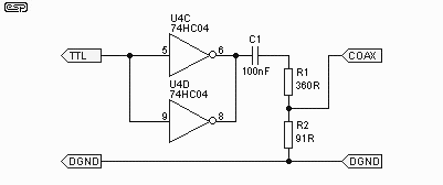

Seems like there is an optical output if you take a look at page 17 and the board PX54. At the bottom there it seems like there is a TOSLINK transmitter. If that is the case a converter from TOSLINK to SPDIF would be the easiest road. If not you have to solder this one together. TTL level SPDIF taken from J205 and connect output of circuit directly to a female RCA connector for your coax to DAC.
Taken from this site: S/PDIF Digital to Analogue Converter

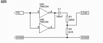

Hi again.
I have connected the 74CH04 to the DOBM, but its not working.
Do i have to have "something" between the DOBM and the 74CH04 ?
The 74CH04 are connected like at the picture and getting 5,6 Vdc
No sound, no output :confused:
Do i need a pulsetrafo ?
No, you should be able to get the signal you want for the input to the 74ch04. Have you connected the ground (earth) as well? Connect the input directly to pin 31 on SAA7372.
This output is 5 volt TTL pulses. In the schematic R234 is marked with an X. May be this resistor is not mounted on the card. Use this point for a direct connect.
