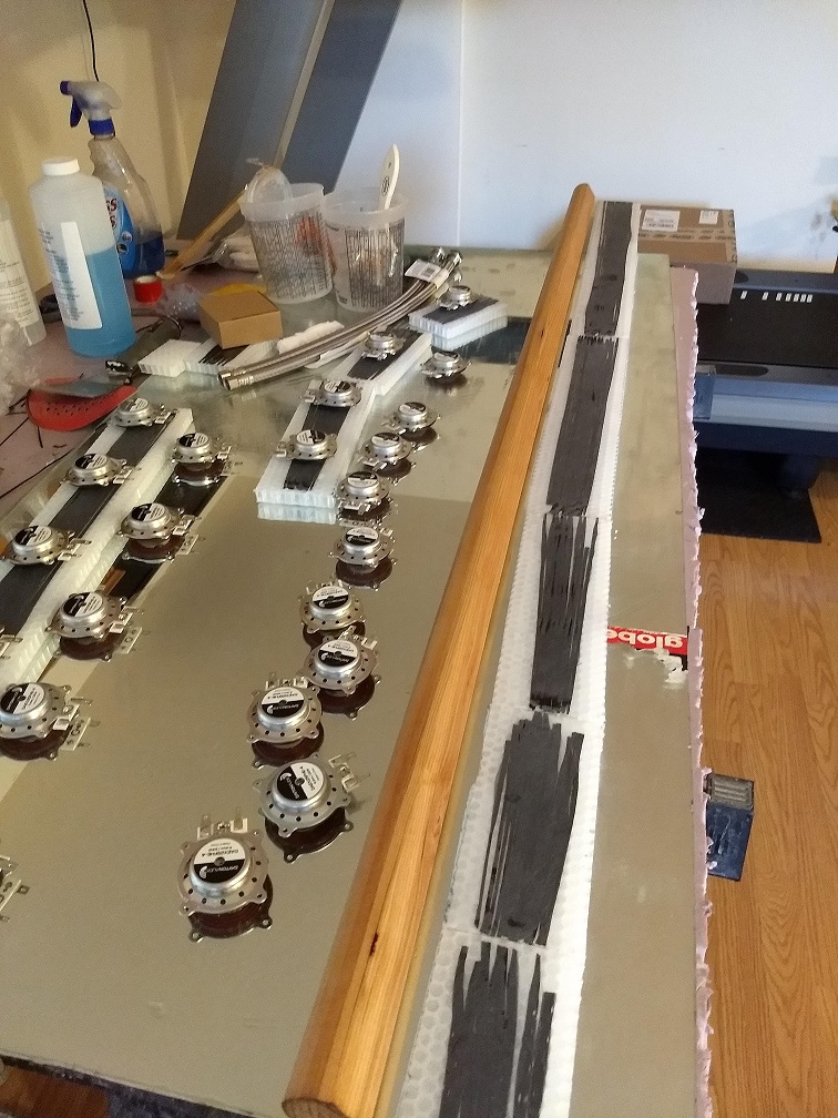

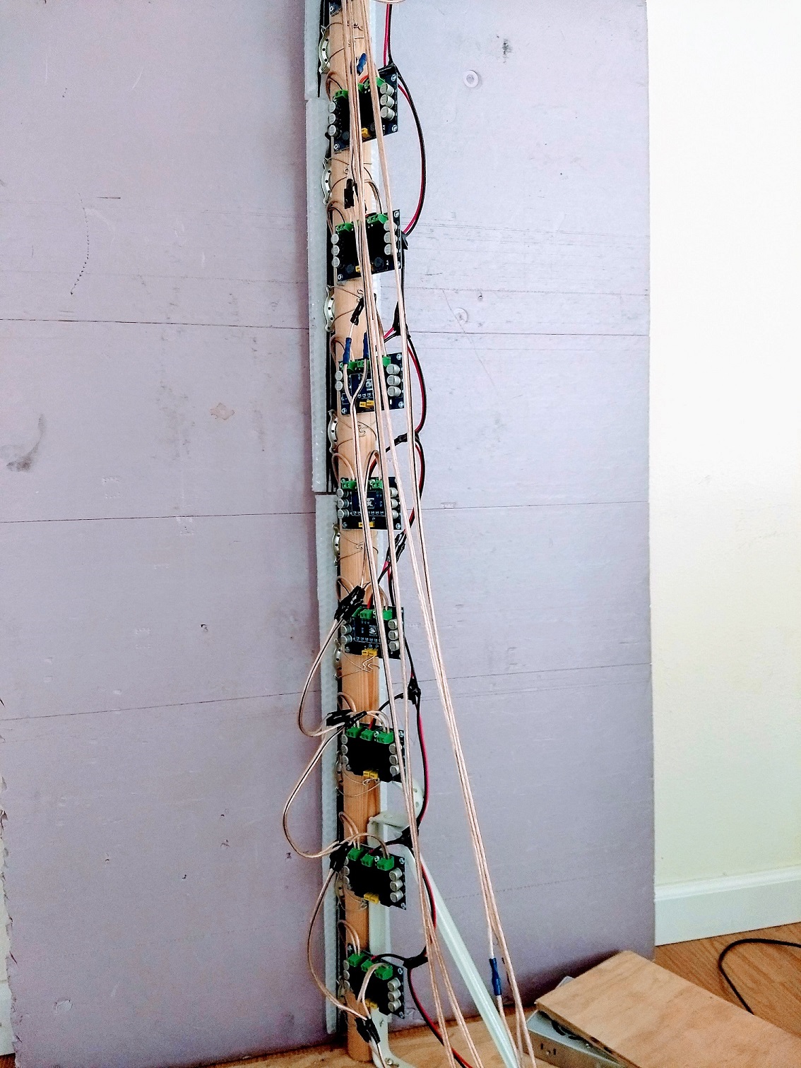

I'm sharing work in progress of a Constant Beamwidth Transducer/Technology ground plane array (CBT) using Distributed Mode Loudspeaker exciter/actuator panels (DML).
66 inch/167 cm straight CBT array using time delay to approximate physical curve shading at -6 dB half-angle: Cosine 47°, Legendre 36°, Chebyshev 25°. Shading (virtual arc) can be reconfigured with the DSP by adjusting the time delay for each bank.

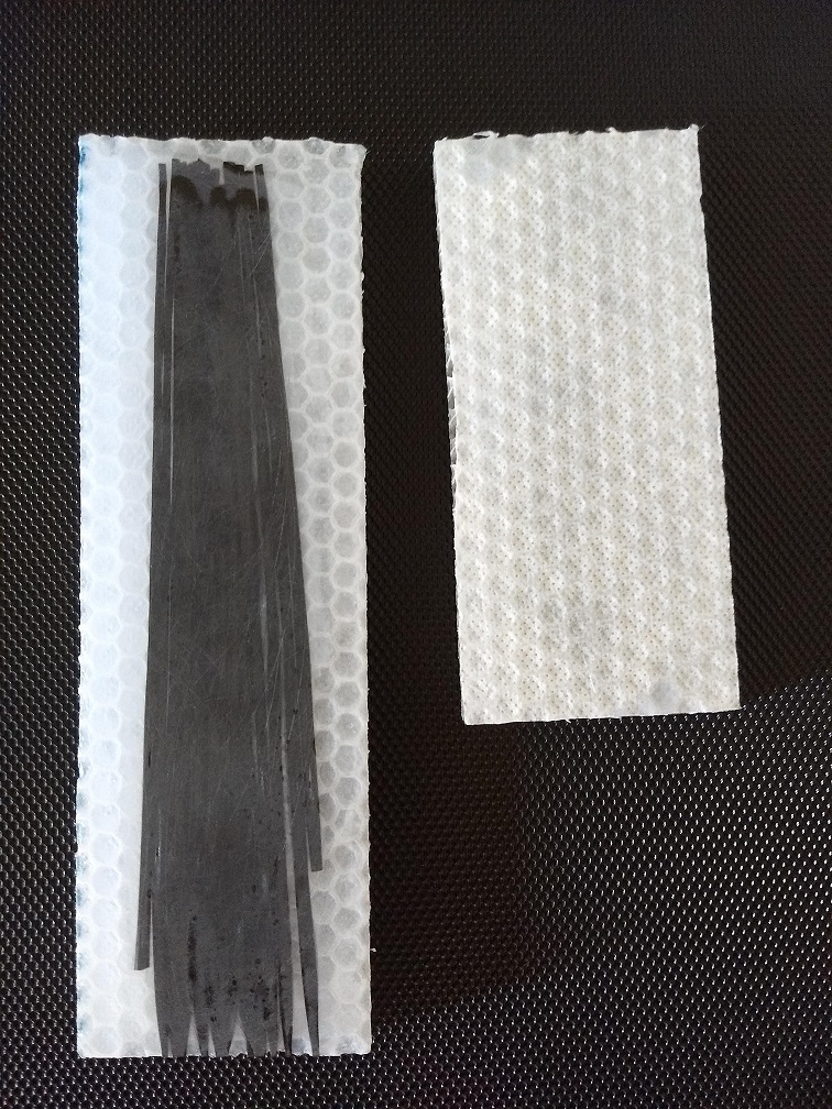

Twelve total actuators per array are positioned 5.5 inches/14 cm center-to-center. The actuators are attached to a wooden spline (hand railing from Home Depot) and excite a poly honeycomb core covered with fabric. One side of the core was left as unmodified fabric. The other side was covered with resin and loose - unwoven - carbon fiber strands then sanded to a flat finish. Each panel is 3 inches/7.62 cm wide and 0.5 inches/1.27 cm thick. They currently use separate panels for each Bank, however, I don't think that's necessary. I think you could do this with one narrow and tall panel with even spacing between the actuators.
(Edit: this paragraph is wrong. Read this post for accurate information Project: CBT array, balanced DML, delay curved) Like Don Keele's CBT-24, this array uses five shaded banks rather than constant shading. Each bank is separately controlled by a DSP channel and each actuator is powered by an amplifier tuned to the same voltage.
I have not taken good frequency measurements with REW. I have taken bad (sloppy) measurements with REW. At present, the array has an unequalized audible resonance between around 1000Hz to 4000Hz with a peak at 2200Hz. It hurts my ears and my dog's ears. I'll equalize it out at a later time. I have only measured the array while Legendre shaded at 36 degrees. I have not measured it while shaded in Cosine or Chebyshev configuration yet.
I've attached photos of work in progress. I will also upload the spreadsheets I used to calculate shading in a second post.

Also, I have no science for the way I modified the poly honeycomb core panel. Covering both sides with resin made an extremely stiff panel. I wanted some damping so I left one side unmodified. The carbon fiber? I don't know why. I don't have any idea it even helps. It was just an attempt to retard reflected resonances from the panel edges.

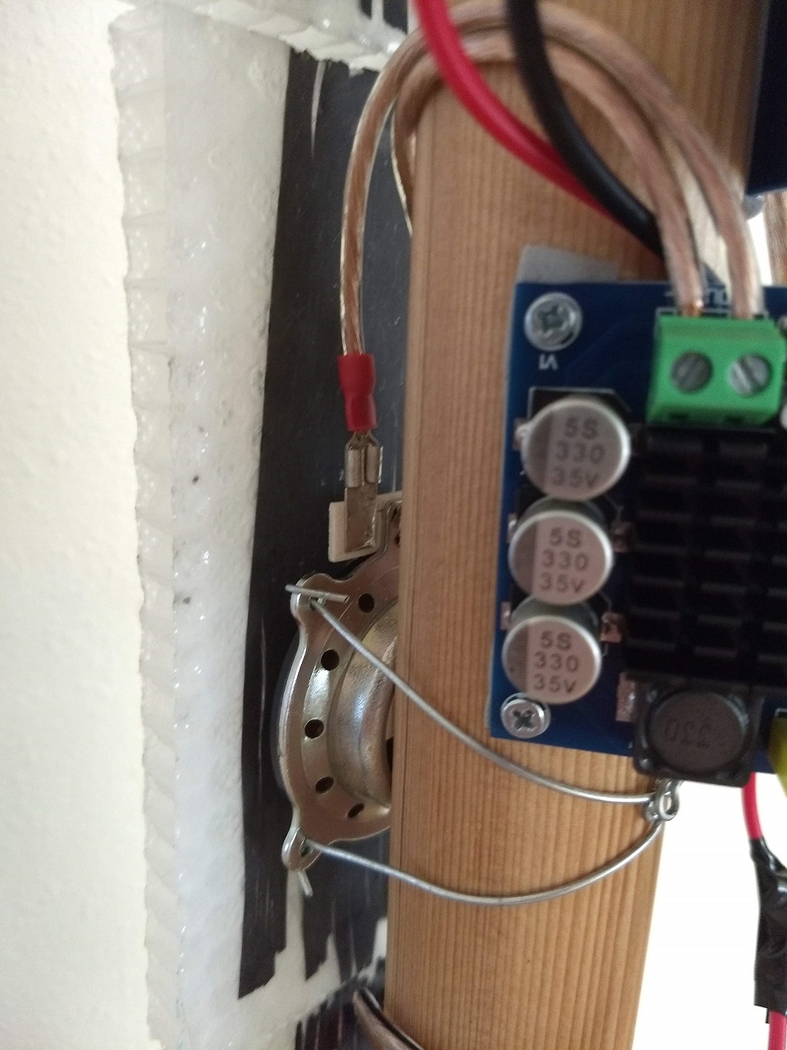

Neat project! Impressively low frequency reach. Each driver has its own amp? Are those TPA3116’s? How many channels of DSP do you have? More details on the electronics and signal processing when you get the chance.
I'll wind up cutting off the low frequency with equalization and handing it off to multi-subs designed to calm the modal region. The lows due to array length are an accidental side effect. On the other hand, Earl Geddes said you can let mains run as low as they naturally go and equalize them in conjunction with the multi-subs.
Yes, each driver has its own amp and is adjusted to deliver the same volts. Yes, TPA3116s. Five DSP channels on each array, one for each Bank. I have a total of 48 DSP channels devoted to the final system: all arrays plus subs.
I'll do the DSP tuning at the end so I won't have that information for a while. Electronics should be very easy. Just power supply, TPA3116 amps, and the DSP. The TPA3116s will probably even be able to run the multi-subs. So I won't have any expensive amplifiers in the entire system. The vast majority of the money is in the DSP.

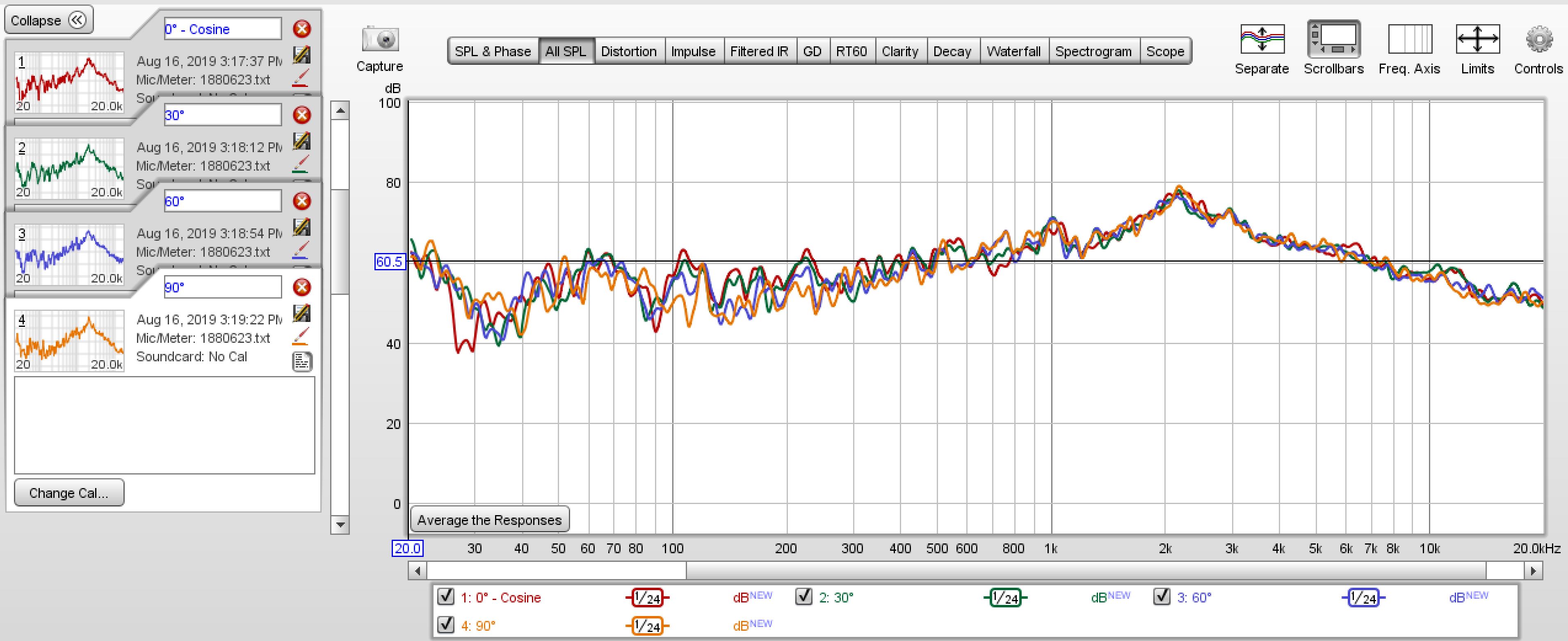

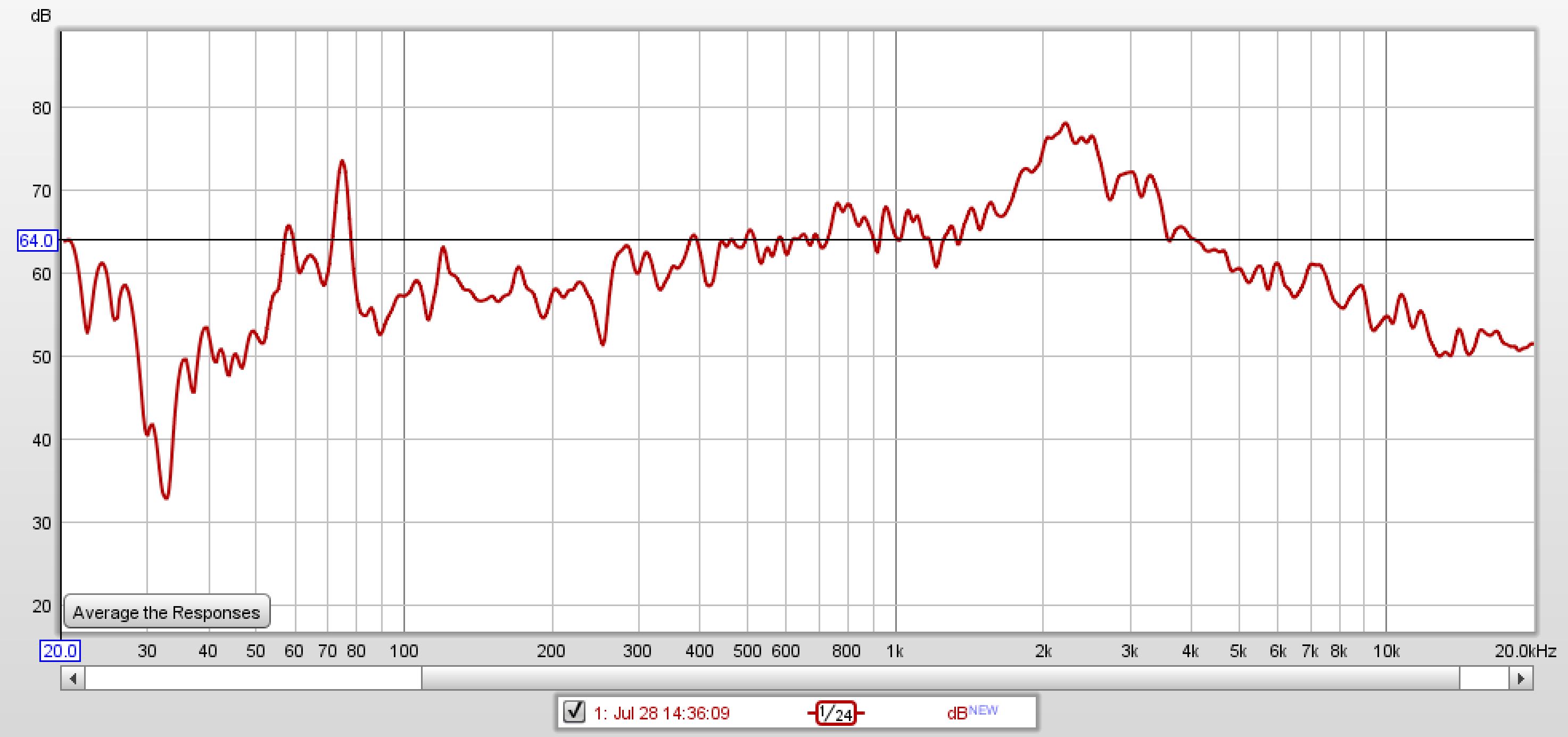

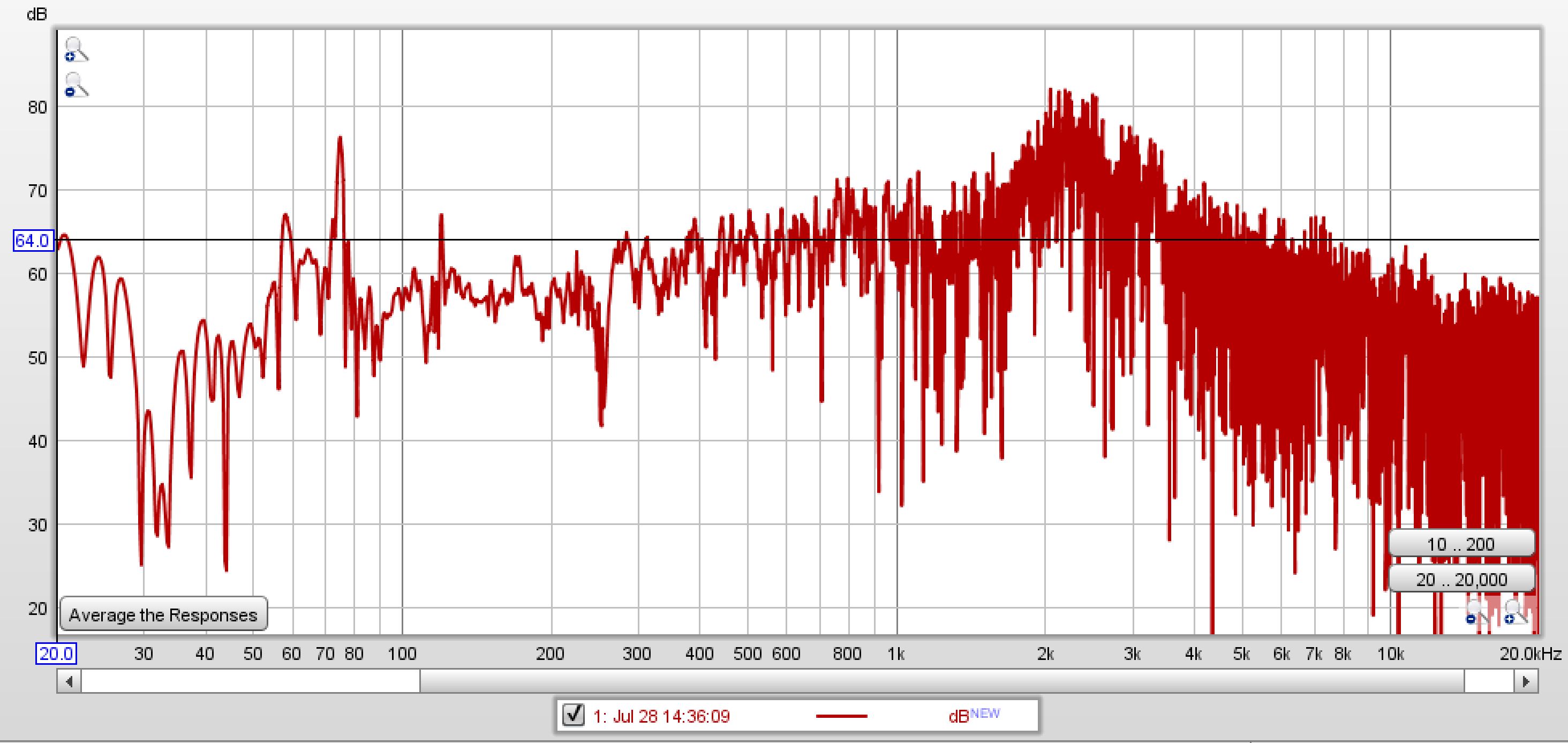

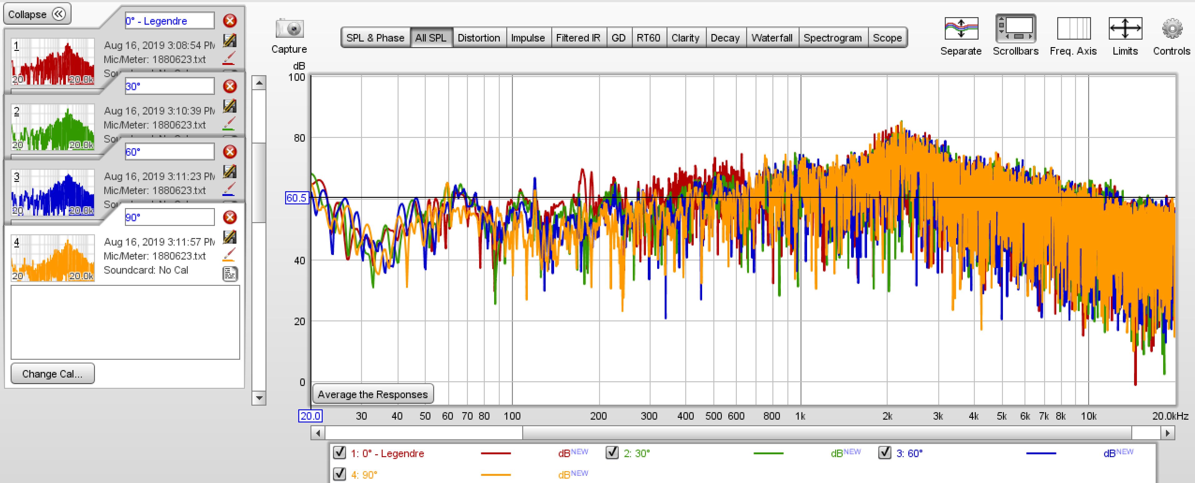

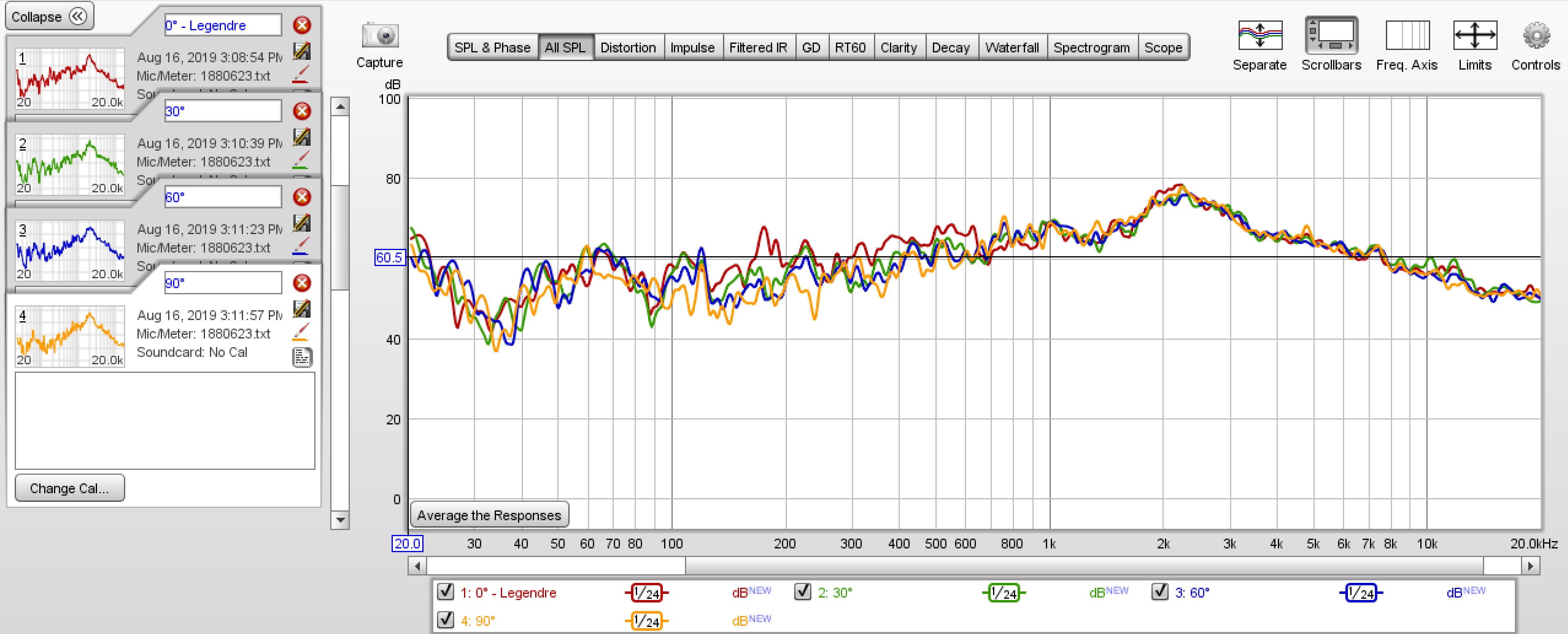

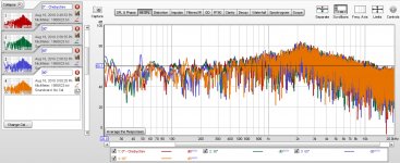

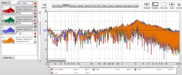

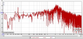

Got my protractor out and measured the array axis frequency response. Mic placed 2 meters away at one meter high for the axis measurements.
First is Legendre shading, 36°. Raw and 1/24 smoothed.

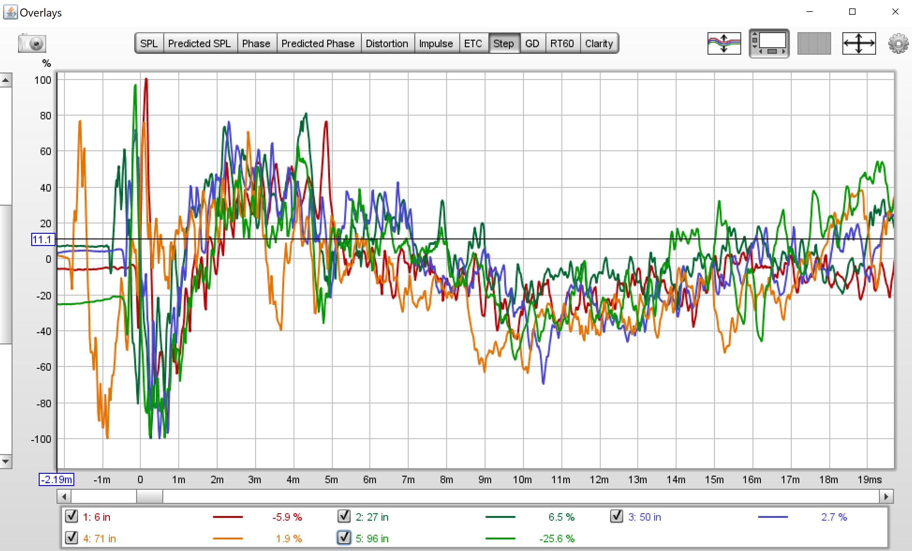

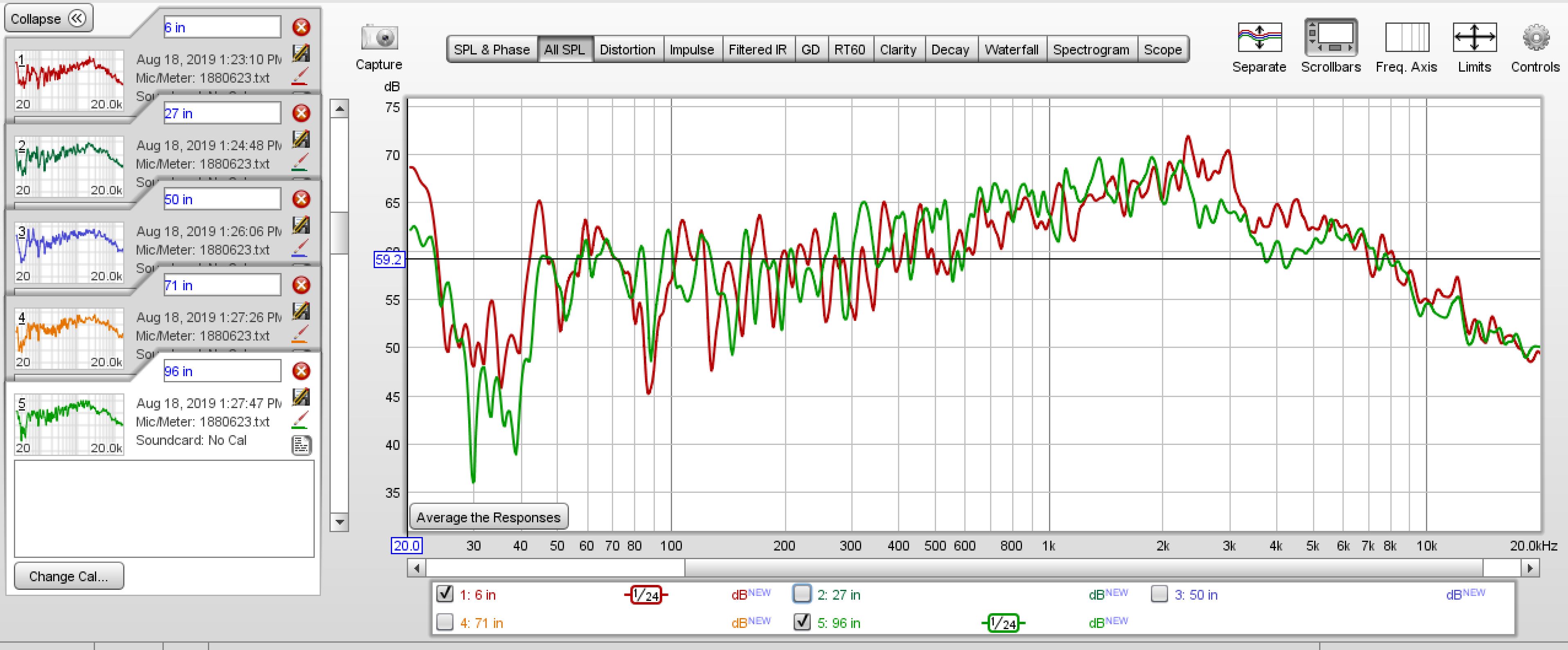

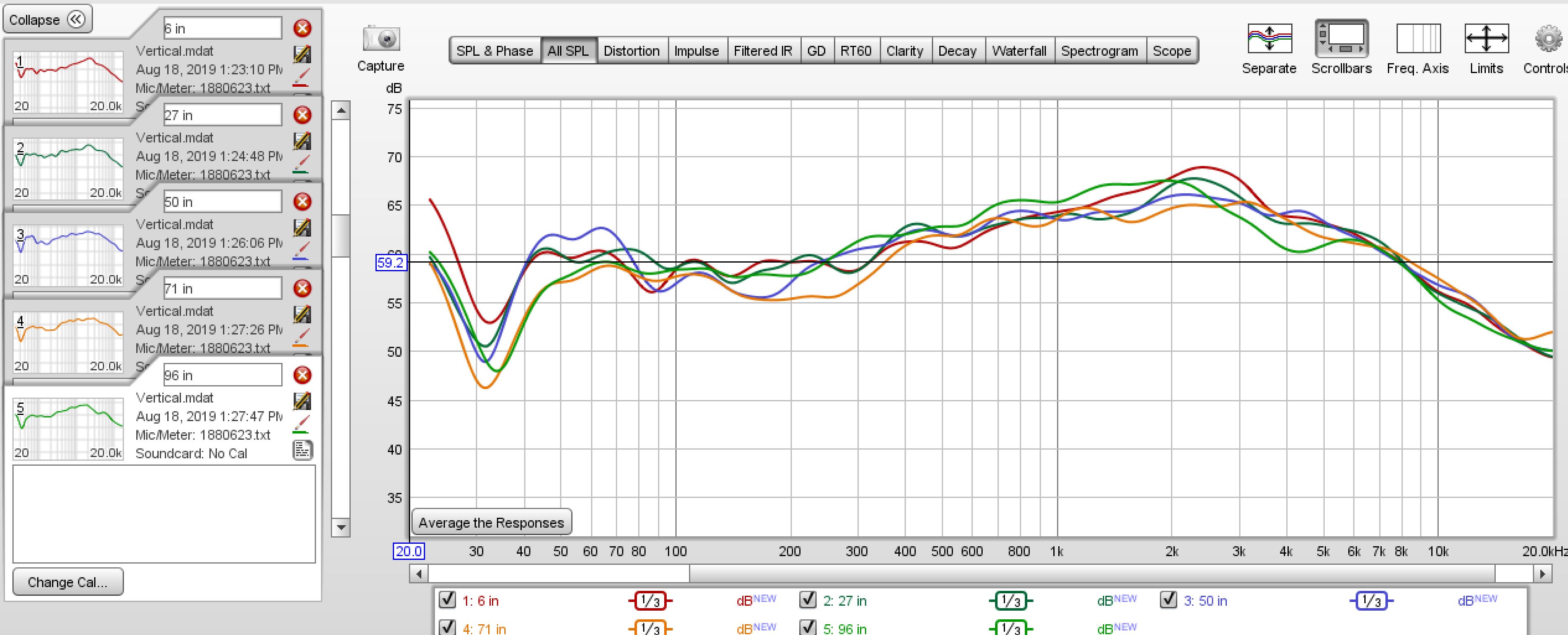

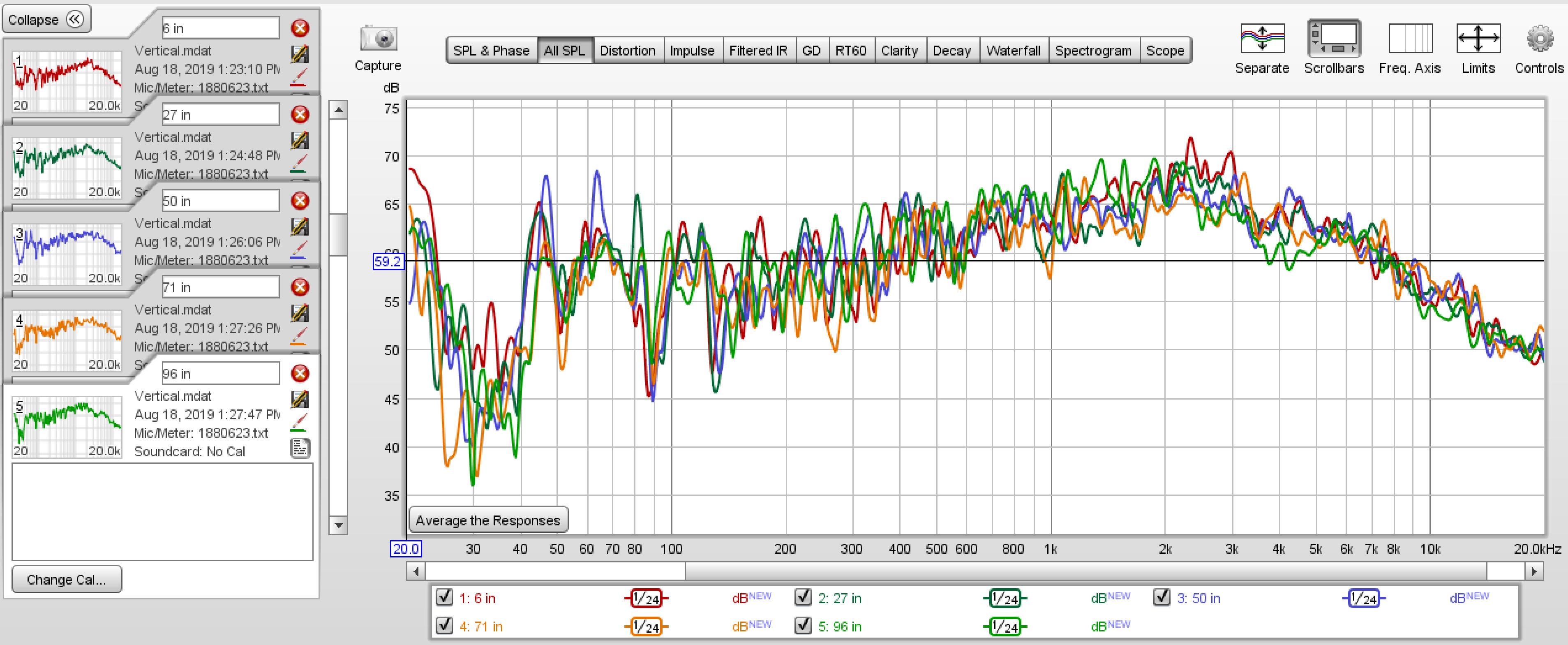

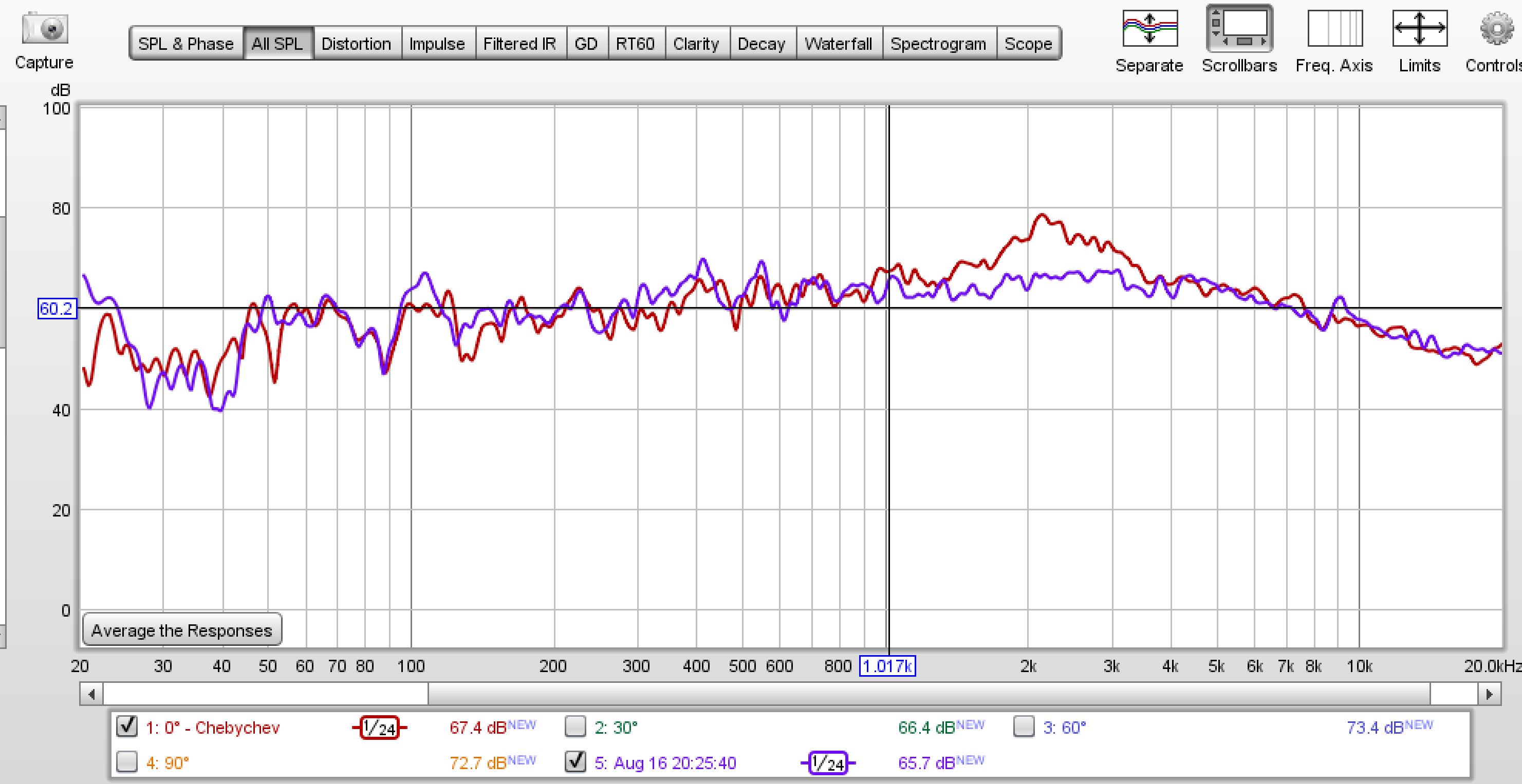

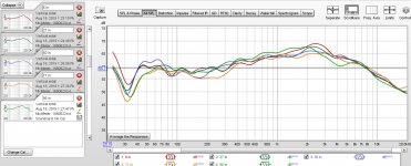

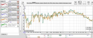

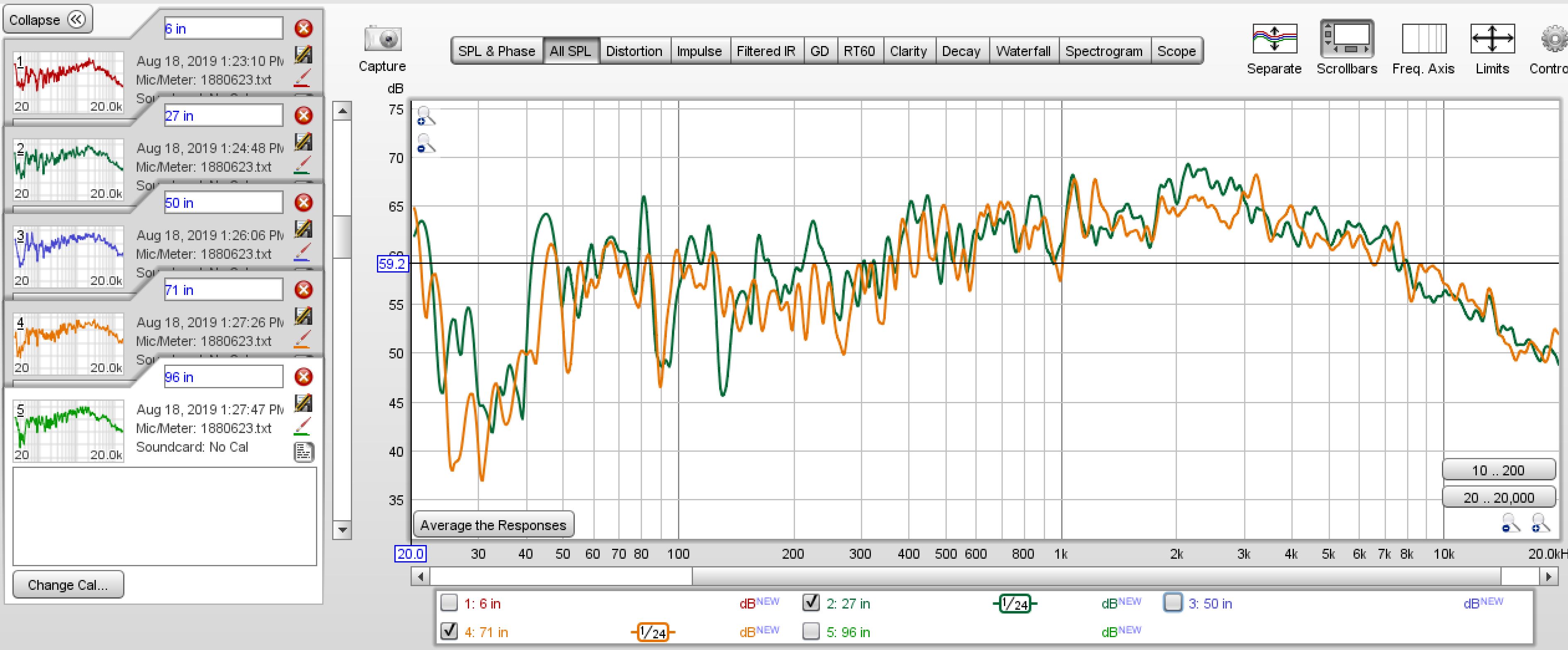

Vertical frequency response measurements. Mic six feet away from speaker: 6, 27, 50, 71, and 95 inches high. In a room with a 96 inch ceiling. I separated out measurements for 6 inches vs 96 inches and 27 inches vs 71 inches. Finally, a 1/3rd smoothed graph.

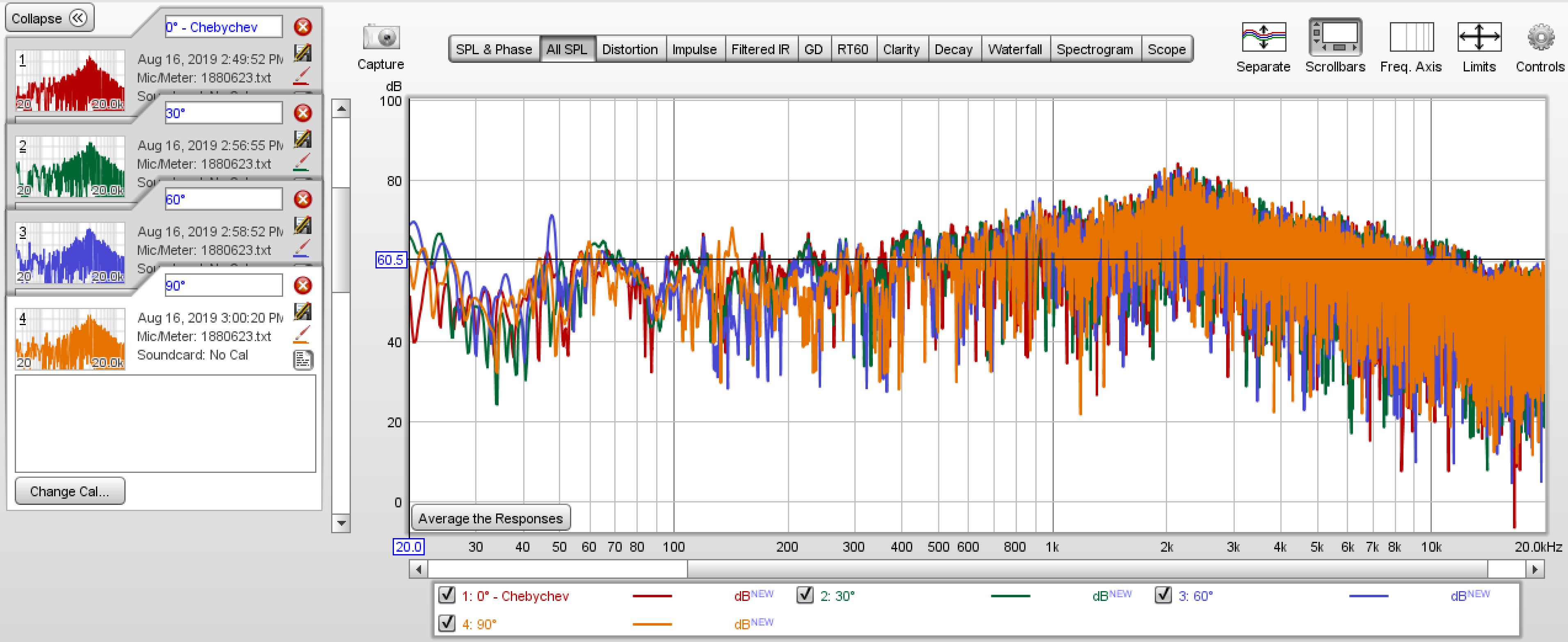

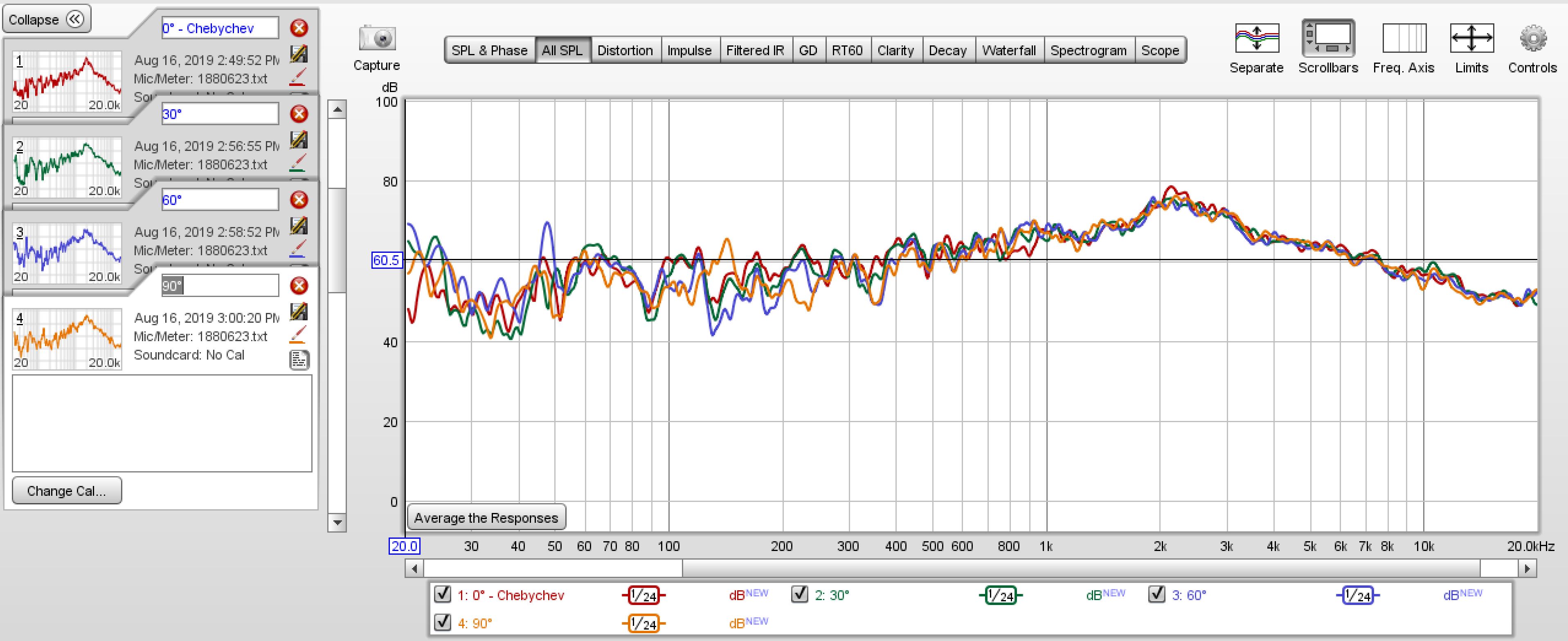

Chebychev shading.
I also included an impulse response for the vertical measurements.
