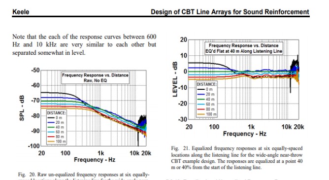

From Keele-CBT-Paper-10-Sept.-2016-Design-of-CBT-Loudspeaker-Line-Arrays-for-Sound-Reinforcement.pdf
Wide angle of 51.3 degrees cut off at 200Hz, array height needed is 2.5m.
Narrow angle of 14.46 degrees cut off at 400Hz, array height needed is 3.32m
Interestingly this is the same rule for even a waveguide. The mouth size depends not only on the frequency cut-off but also on coverage angle. Lower coverage angle needs bigger size than higher coverage angles.
By the way I hate "cut-off" as definition. With speaker stuff, all changes are gradual, but the steepness (Q) of change may vary. Waveguide/horn loading limit is rather steep vs. baffle step.
