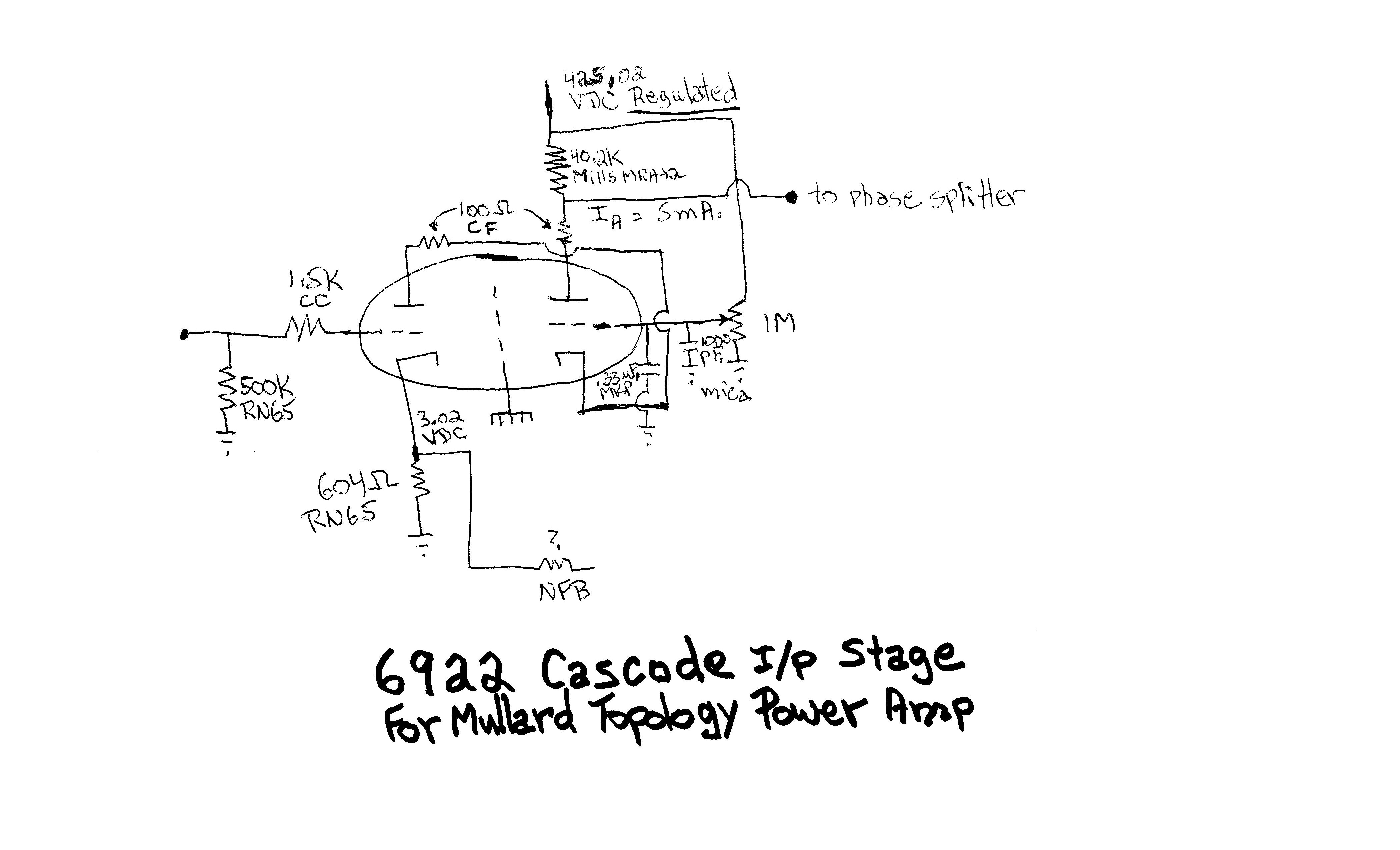

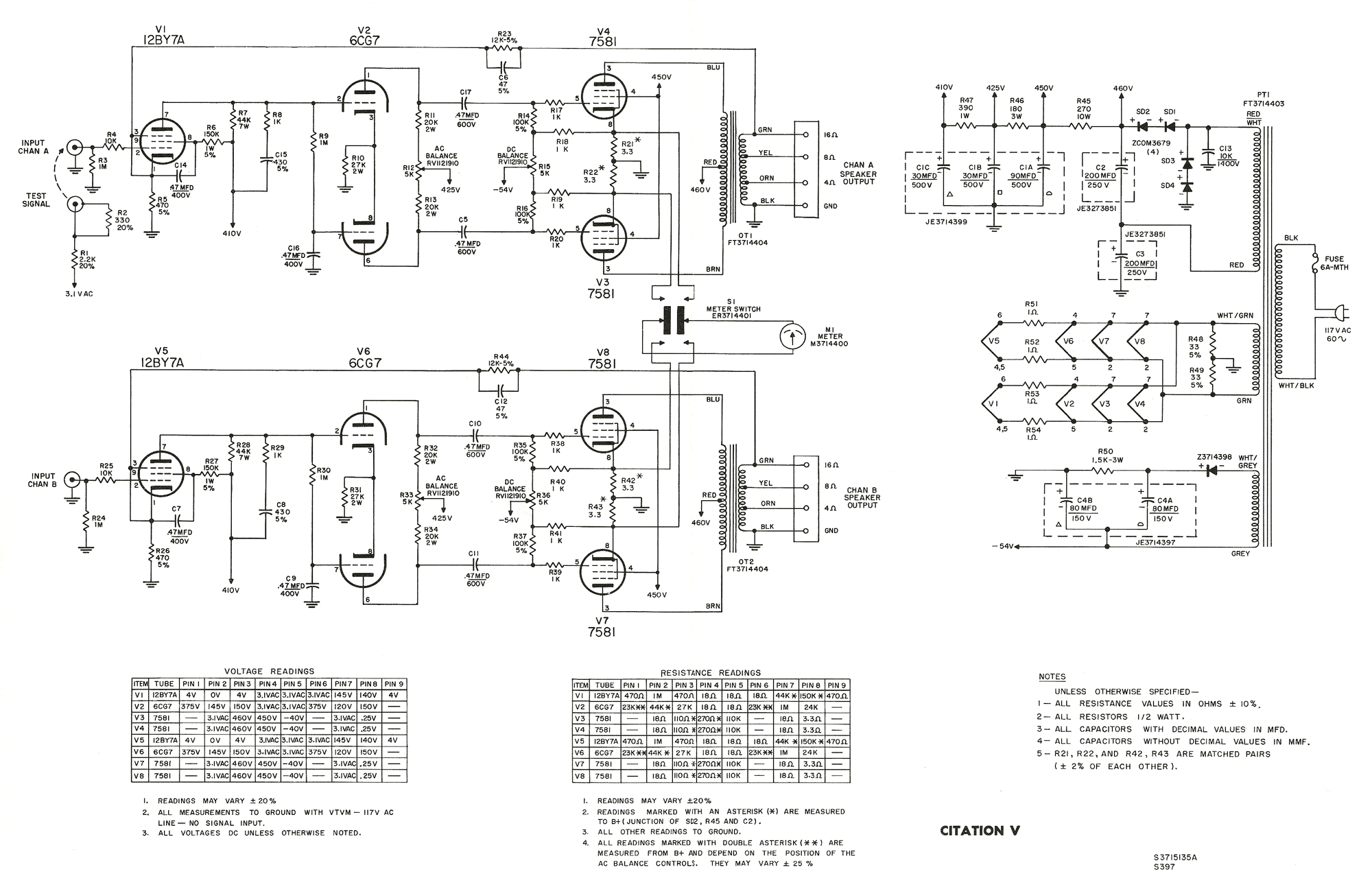

The best "vintage" version of Mullard style circuitry I'm aware of is the Harman/Kardon Citation V. Notice the high gm theme in the small signal types. 12BY7s are becoming scarce. So, a 6922 cascode is provided as a substitute high gm/low CMiller voltage amplifier.
Possible enhancements to the Cit. 5 are a CCS in the LTP tail, instead of a resistor, and employing the ECC99 (yet higher gm) as the LTP.

The EF184/6EJ7 looks interesting as a voltage amp. The 6922 cascode has (IMO) the big advantage of using an in production type.

Eli-- I am working up a version of the schematic for the Citation amp you recommended using the 6922 front end. I'll post my version shortly to see if what I drew up is what you were talking about (spoiler alert: it probably won't be as I tend to misunderstand things-- just Google my posts and you'll see what I mean...).

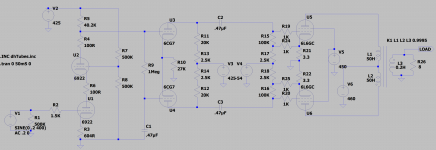

Whipped up this version of the Citation V using the 6922 approach you drew up. Is this what you were thinking?
Not sure if this is exactly correct so feel free to critique.

What is shown as R7 & R8 (2X 500 Kohm parts) is, in fact, a 1 MOhm trim potentiometer. The "set & forget" pot. is adjusted to yield 3 V. of 6922 self bias.
PSRR in cascodes is very poor. At a minimum, well filtered B+ is needed and regulation is (IMO) indicated.
The GNFB loop was omitted.
I'm concerned that the fixed bias will be an issue and that the aesthetics of having a visible / hot / touch-able / ouch-able heat sink won't work for my friend. He will likely never calibrate the bias when it drifts out of whack and the optics would be a no-no. Note that this will be going into a restaurant he owns and I'm trying to limit his legal liability.

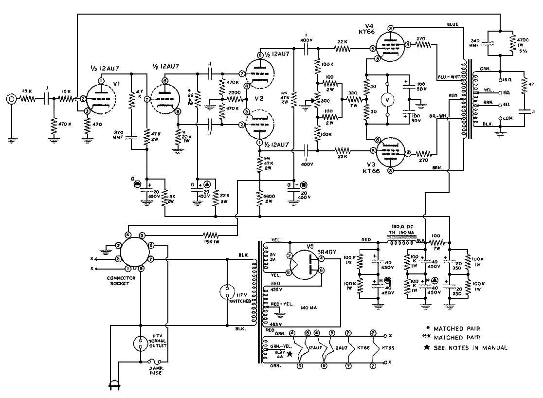

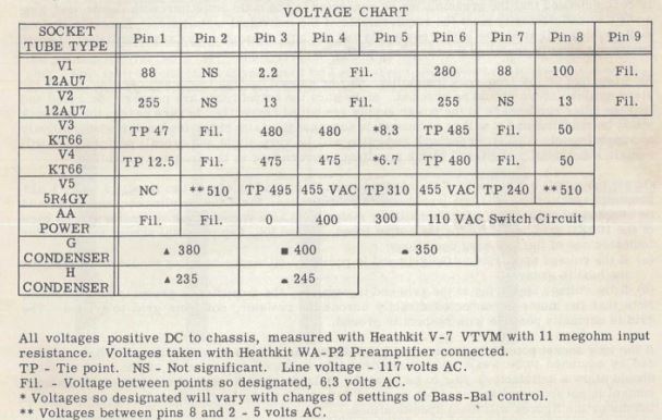

The H/K Cit. 5 is very much a "fixed" bias amp. So, let's use its "idiot resistant" Mullard style small signal circuitry, but "clone" a self biased O/P tube setup. The Heath W5M provides that template.
Edcor's CXPP100-6.6K O/P trafo will provide the magnetic headroom needed to ensure that the GNFB induced deep bass error correction signal does not saturate the core.
When legal liability rears its FUGLY head, a substantial tube cage is a must. Keep those mischief making little fingers out of places they definitely don't belong.

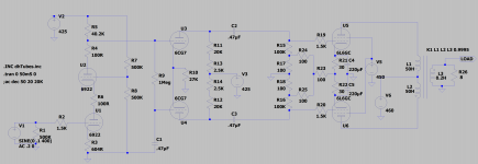

Hmmm... so, I updated the schematic in LTSpice. Does the attached look correct? It appears this would run the 6L6GCs at around 98mA. I assumed a 330R cathode resistor would be OK here, but maybe lower would be better?

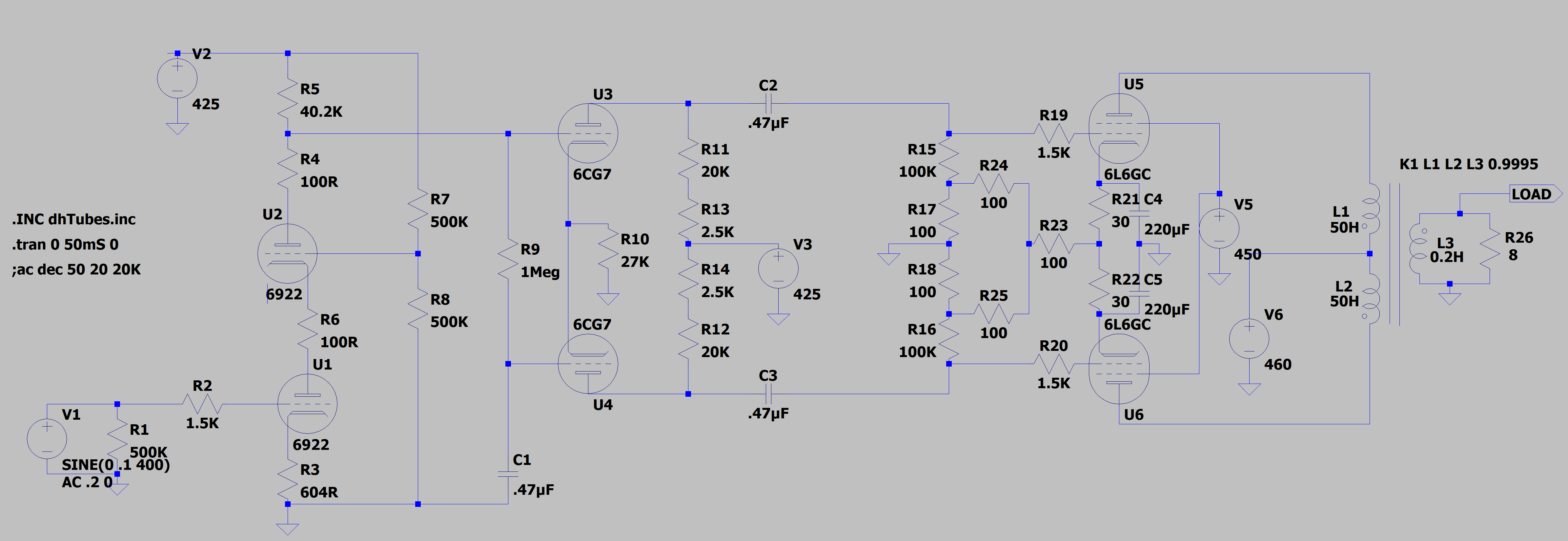

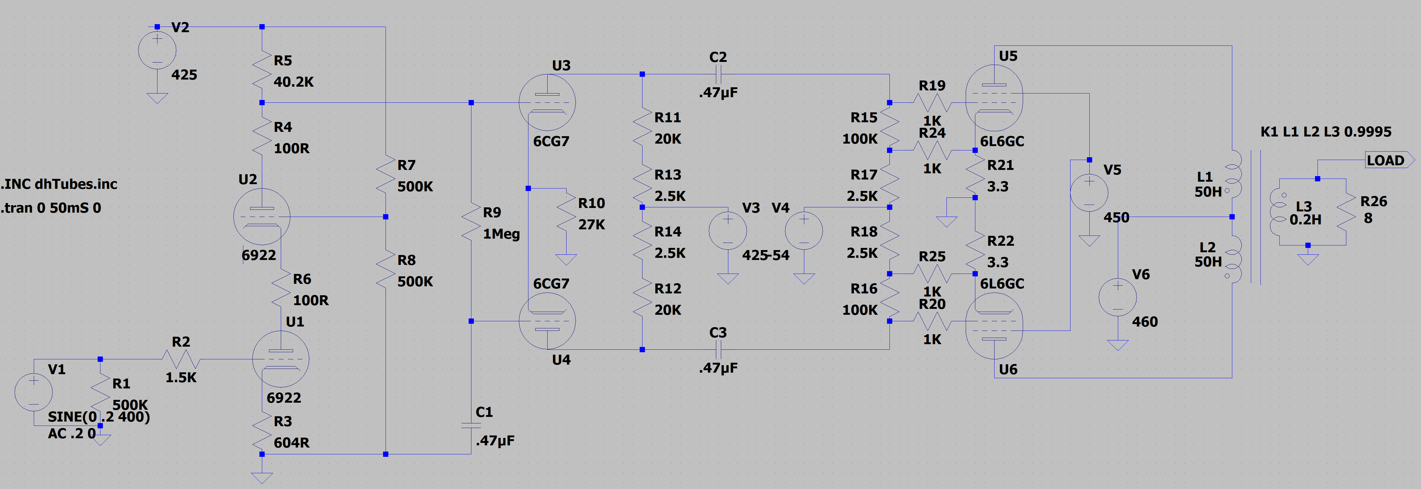

Administrator
Joined 2004
Make sure the thing is in a properly grounded, fully enclosed metal box, properly fused, that there are no accessible points with HV on them, and the tubes are not accessible without removing a cover first. Make sure that the end user understands that it must be properly ventilated and that regular maintenance is required. (For which you must be paid.. :) )

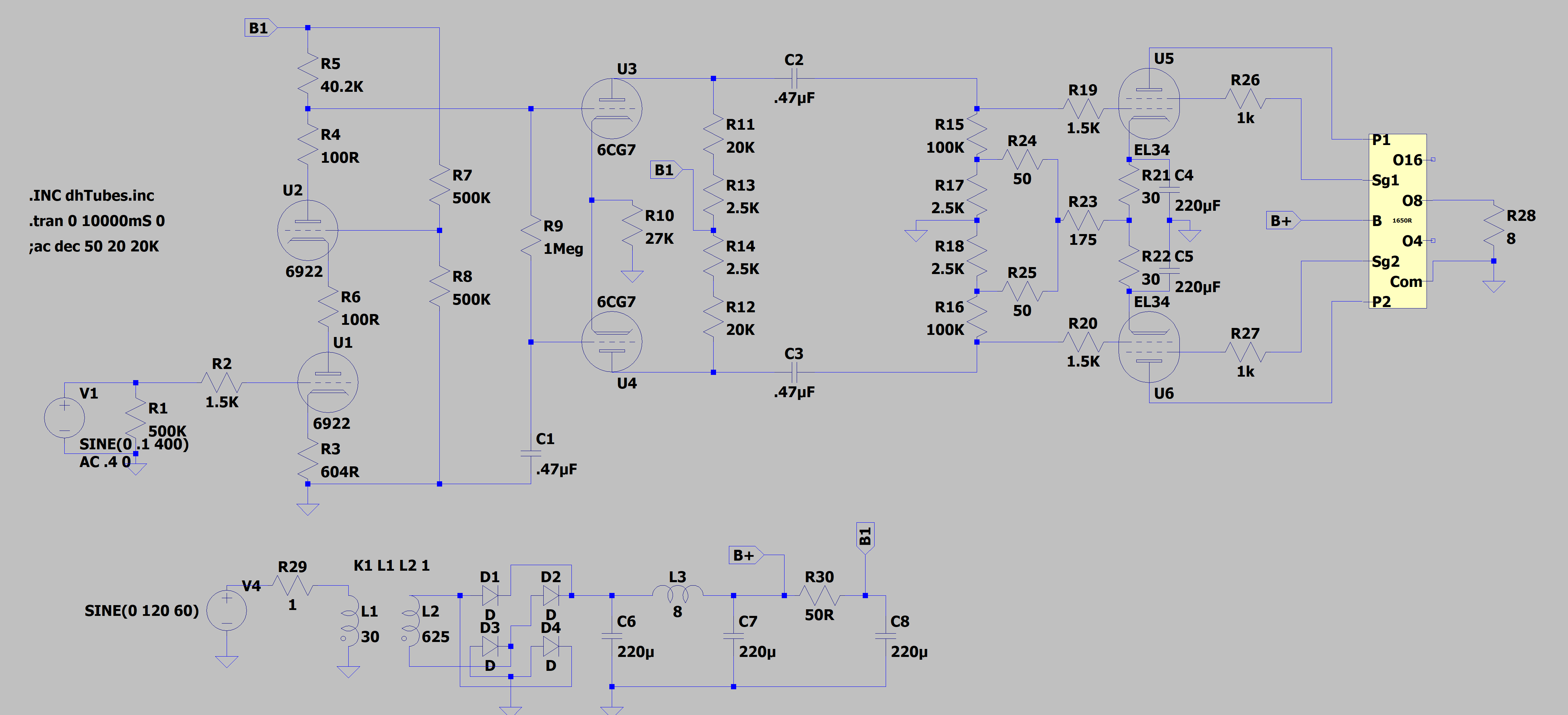

Also-- @Eli: I have been noodling around in LT Spice with the Citation V design and input scheme you posted and wanted to see about using the the EL34 (I happen to have a quad of those already).
Would you (and everyone) mind taking a look at the design I attached and tell me how horribly awful I am at this? Also, would I need to have a regulated supply if I CLCRC the snot out it (see PSU below the audio circuit)?

Because of current hogging, forget PPP EL84/6BQ5s in a self biased amp.
Different O/P "iron" for EL34s than 6L6 family tubes. Edcor's CXPP60-4K should be OK, but make certain to roll infrasonic noise off at the amp's I/P. A single RC high pass pole whose F3 is in the 16 to 18 Hz. range gets the job done.
There's little to be gained by reinventing the wheel. Use Mullard's original 5-20 as the starting point, for a self biased PP EL34 O/P stage.
BTW, Mullard was trying to sell tubes that they manufactured, when the 5-20 design was published. The topology is fine, but the high RP/low gm 12AX7/ECC83 is a poor choice for the LTP.
