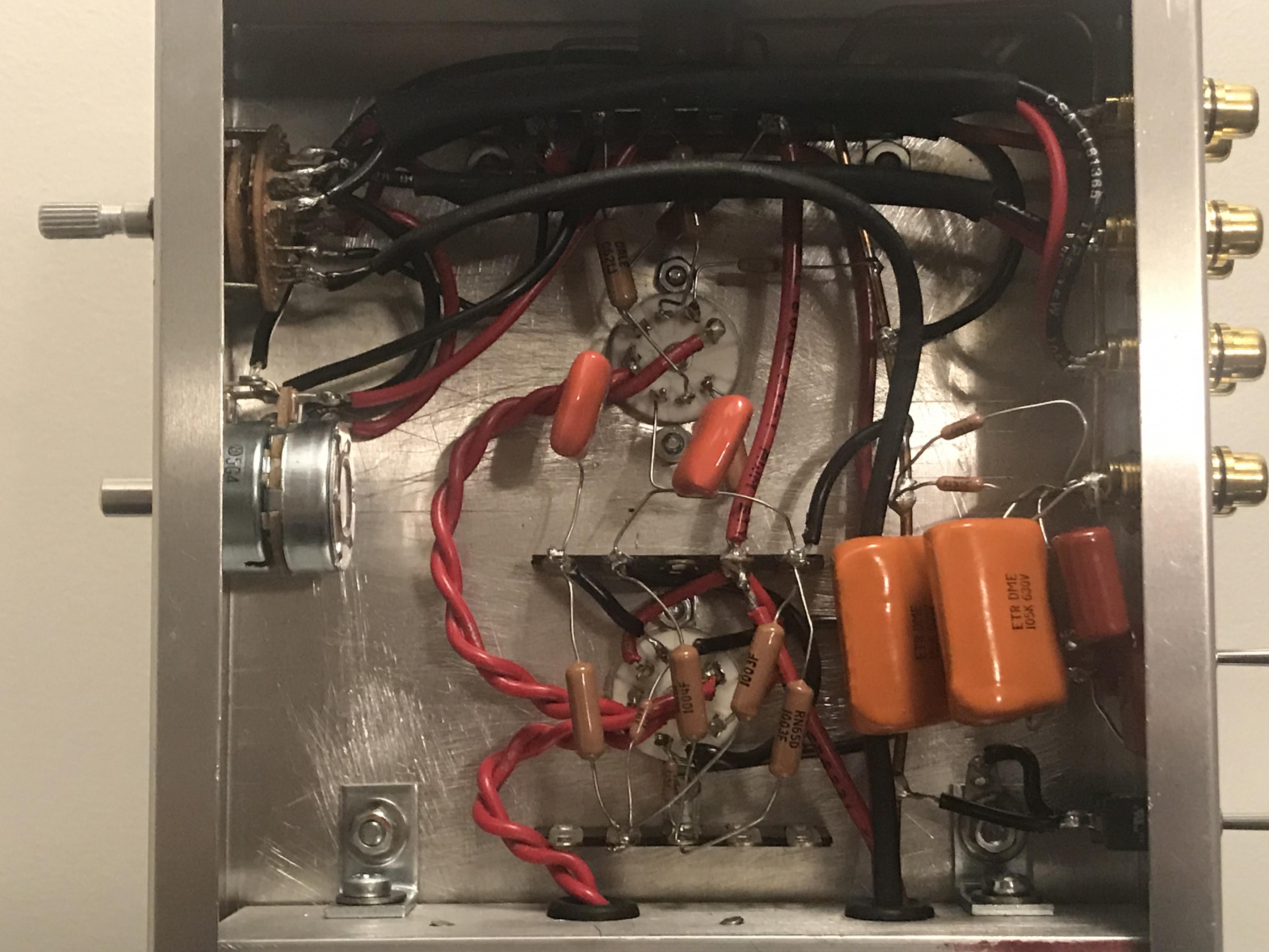

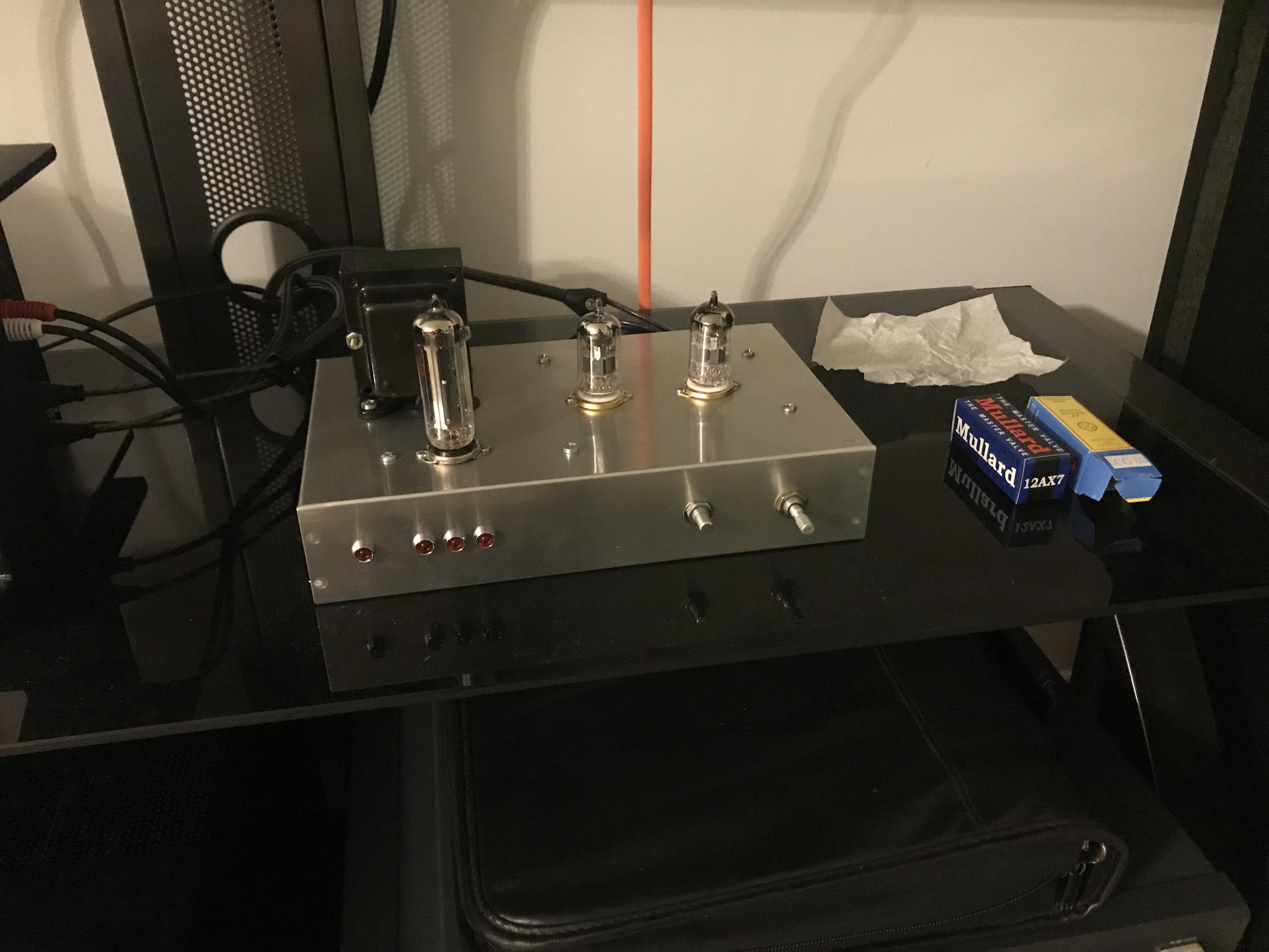

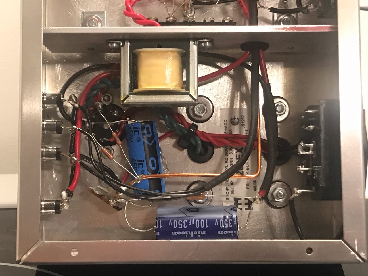

I have built one of these, but with a few major differences.
First, the goal of the circuit was to be able to tube roll pretty much all the 12a_7 familly without any adjustments needed between tube changes. It helps to find wich tube sounds you like the most.

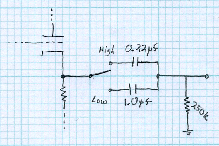

The volume Is on the output to avoid amplifying the noises the the pot creates. But yes, it changes the output impedence when you adjust the volume. if built this way, the 4s might not be able to drive all power amps, especially solid states ones.
My build is quite different than the original 4s preamp. A cathode follower buffer stage was added after the amplification stage in order to lower the output impedence. It allows the 4s to drive pretty much any amp out there. Mine also has a switch that allows me to choose between a low and a high output impedence depending on the amp that the 4s is driving. The low frequency roll off is than approximately correct for most solid states and valve power amp.
With the cathode follower added to the circuit, the volume pot was installed in the input, so the output impedence does not varry with each volume adjustments.
I don’t think that this preamp was ever meant to be part of a main stereo system. It’s a toy for the tube geek to play around with. It’s also quite easy and fun to build in a point to point layout.
