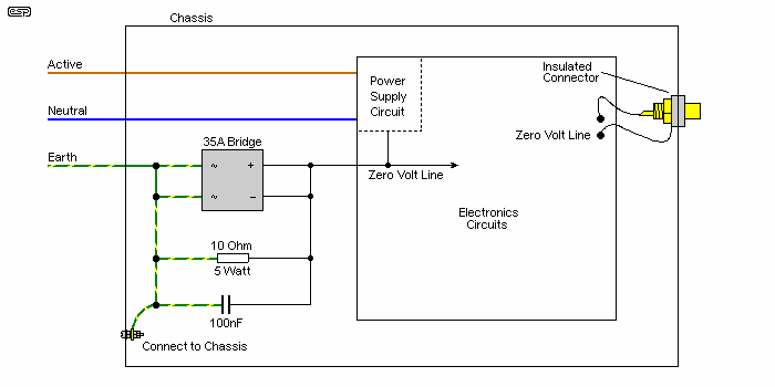

Thanks Ben, your linked paper said: "The signal return is bonded to the chassis through a single connection from the power supply 0V to the metal chassis" Rob from DHTRob does attached pic and I read for example Elliot Sound that shares the same chassis point signal GND & signal GND trought a SLB attached pic so still confused what's the proper way.
Here Rod Elliot earthing the mains PSU to chassis.

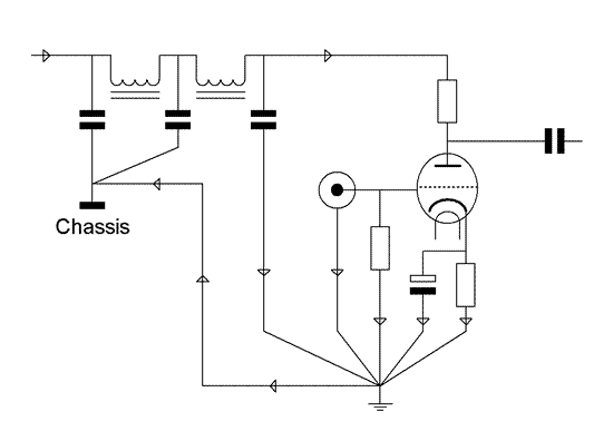

ValveWizard uses separate points to signal GND and safety mains AC earth, also says to take the input RCA signal ground to chassis in place of 1st cap mains AC filter PSU indicated in other places.
http://www.valvewizard.co.uk/Grounding.pdf
It's really so complicate to know what's the correct way, I'm puzzled.

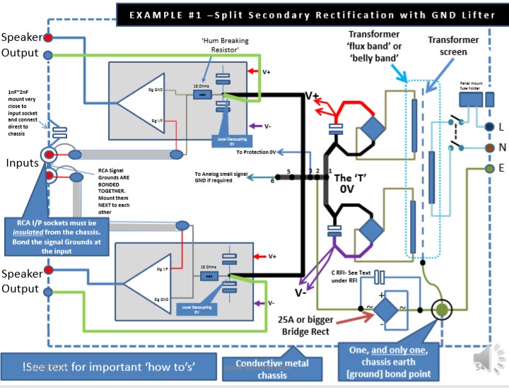

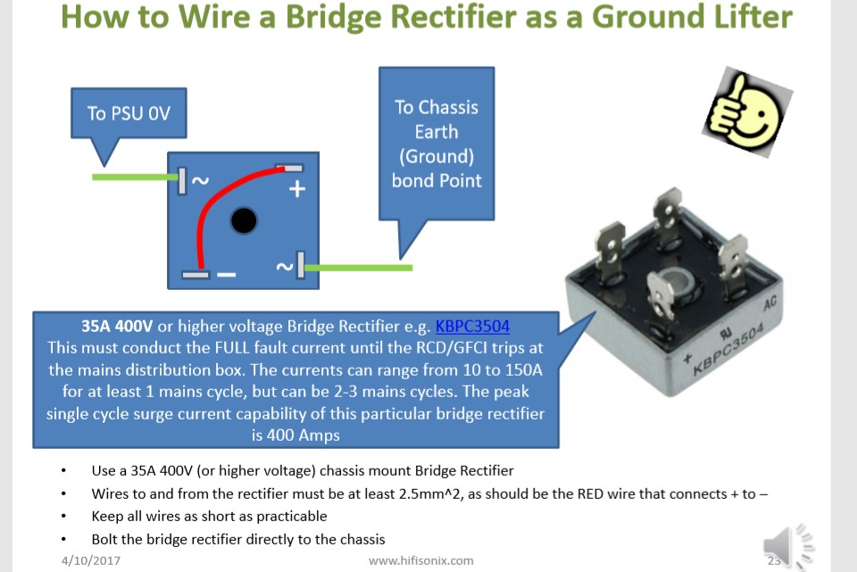

Hi merlin el mago, Scroll down to near the end of the long article that I referenced and there are diagrams that show grounding scheme, more specifically "Example #1 - Split Secondary Rectification with GND Lifter".
It is an example of solid state amplifier with solid state bipolar power supply but the grounding principles still apply.
From http://hifisonix.com/wordpress/wp-content/uploads/2018/07/How-to-wire-up-an-amplifier_3.pdf

Grounding done as attached schematic of Rod Elliot.

The diode bridge connection to ground in the diagram that you posted does not agree with the connection shown in the article that I referenced in my posts: Another ground lift connection: DC Servos
This is in agreement with the arrangement shown in my previous post and also as shown in the Valve Wizard article that you referenced in one of your earlier posts.
The safety ground connection to chassis and the signal ground connection must be two separate chassis connections. On that we should all agree.

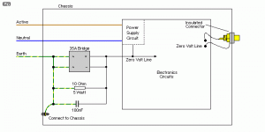

Here shows like Rod Elliot schematic:

I have used this connection method for 20 years. It is easy and reliable. I happen to have a bag full of X2 caps with 4.7nF value, but anything from 4.7nF to 0.1uF will work well. I would recommend an X2 or Y2 cap for this.
I also ground the earth right at the input RCA signal ground or as close as you can to it.
