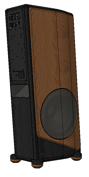

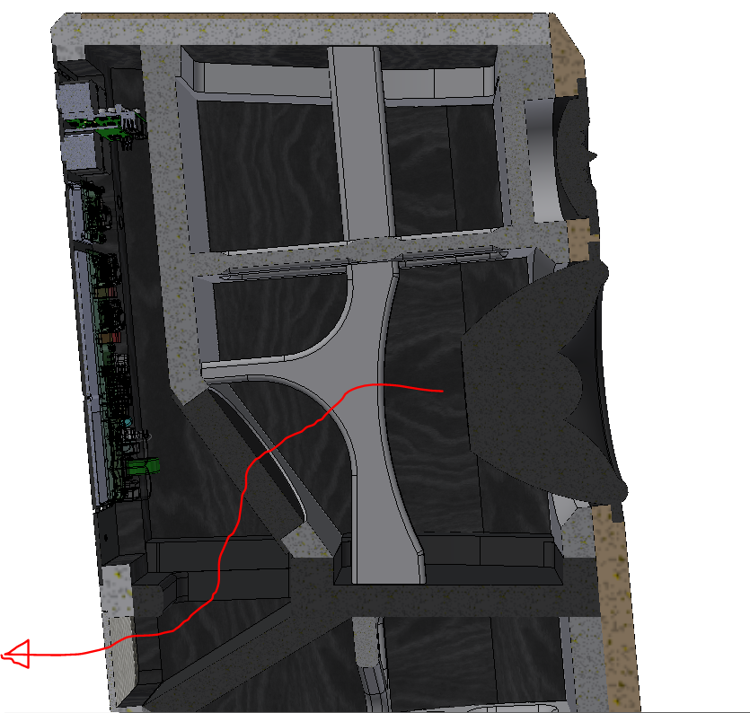

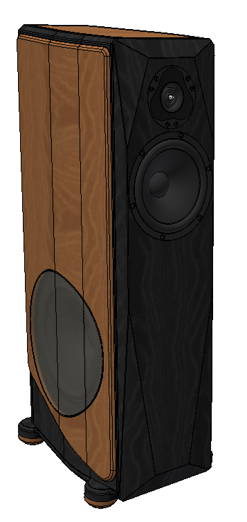

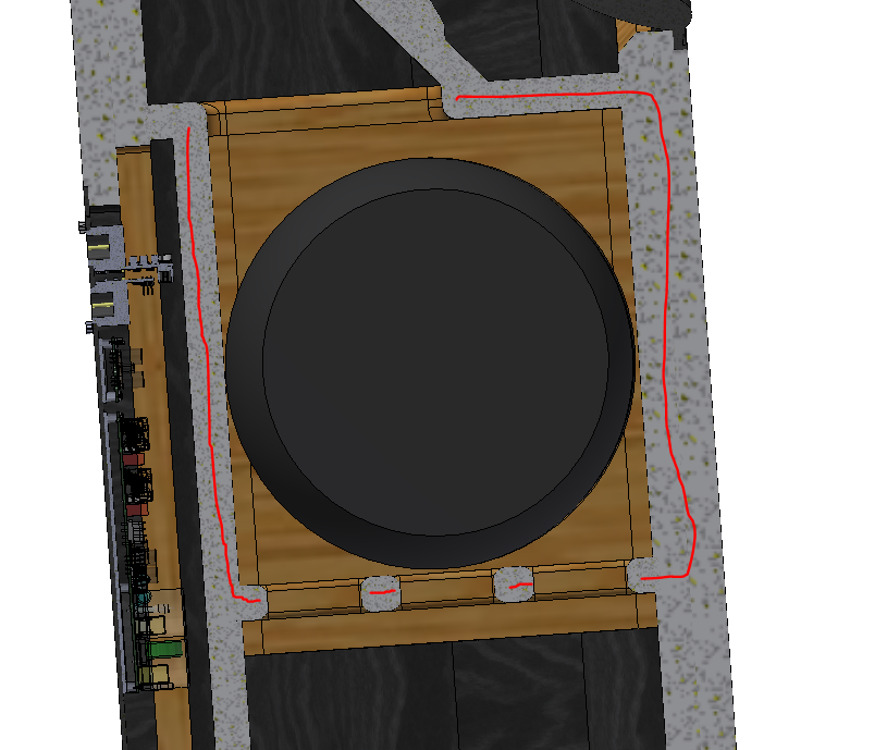

So far I have chosen the NE265W in the 4 ohm version. This driver should achieve a Qtc of 0,713 in only 15,7L !! :O It also have a sensitivity and power handling better suited for my FA123 than the SB driver. At 100W one of these Vifa drivers should deliver 95dB (1m) at 30 HZ! And if I compare with the single 18W I made some tests with then this driver has a little more than twice the membrane area and 40% more travel at 100W. The numbers say it will perform better than 2 18W in less volume than one 18W would need!. I am very excited over this driver! …. At least it’s numbers.

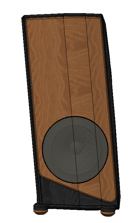

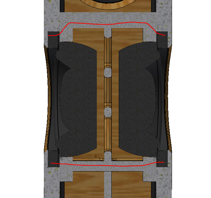

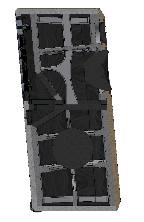

My new design can be seen on the first four pictures.

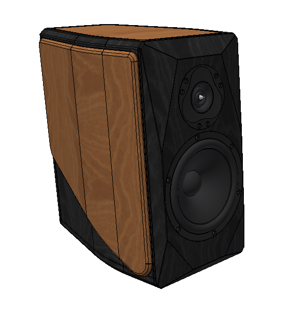

Another new thing is that the design is actually just a 2-Way active bookshelf with an extra Sub output, which is then stacked on top of a passive Subwoofer. The fifth picture show what the 2-Way would look like alone (with a different front and rear plate and side covers of course). The sixth picture show what the Subwoofer would look like without the 2-Way on top.
This will give me some flexibility for the future. I can rebuild the Sub without having to redo the whole thing and Vice-Versa.

First Questions
So of course, I have some questions!
Does anyone have experience with using the 7” SATORI in a sealed 13-14L cabinet down to 80Hz? Would you go with the 4 ohm for a Qtc of 0,62 or the 8 ohm for a Qtc of 0,71.
Would my design with the aperiodic vent work? The channel has the same cross section as the vent itself, and with no damping material it shouldn’t obstruct the frequencies let through by the vent, or? Would it have some kind of port effect? The image is trying to ilustrate the intended airflow.
Does anyone know the Vifa NE265W-04? Have anyone used it in a sealed subwoofer? I have read that Michael Chua (a member in here) have build a subwoofer with this driver back in 2011. He seemed very happy with it, but he didn’t give much details on it. Remember I will be using my DSP to boost it in the low frequencies That is why I can go sealed.
Are there any other 10” driver out there that would be even better for a small 16l sealed sub? Or will I get better results with a smaller 8”?
And as always, general design inputs are always welcome! Even though I tried to incorporate as much as possible of what you told me in the old thread.

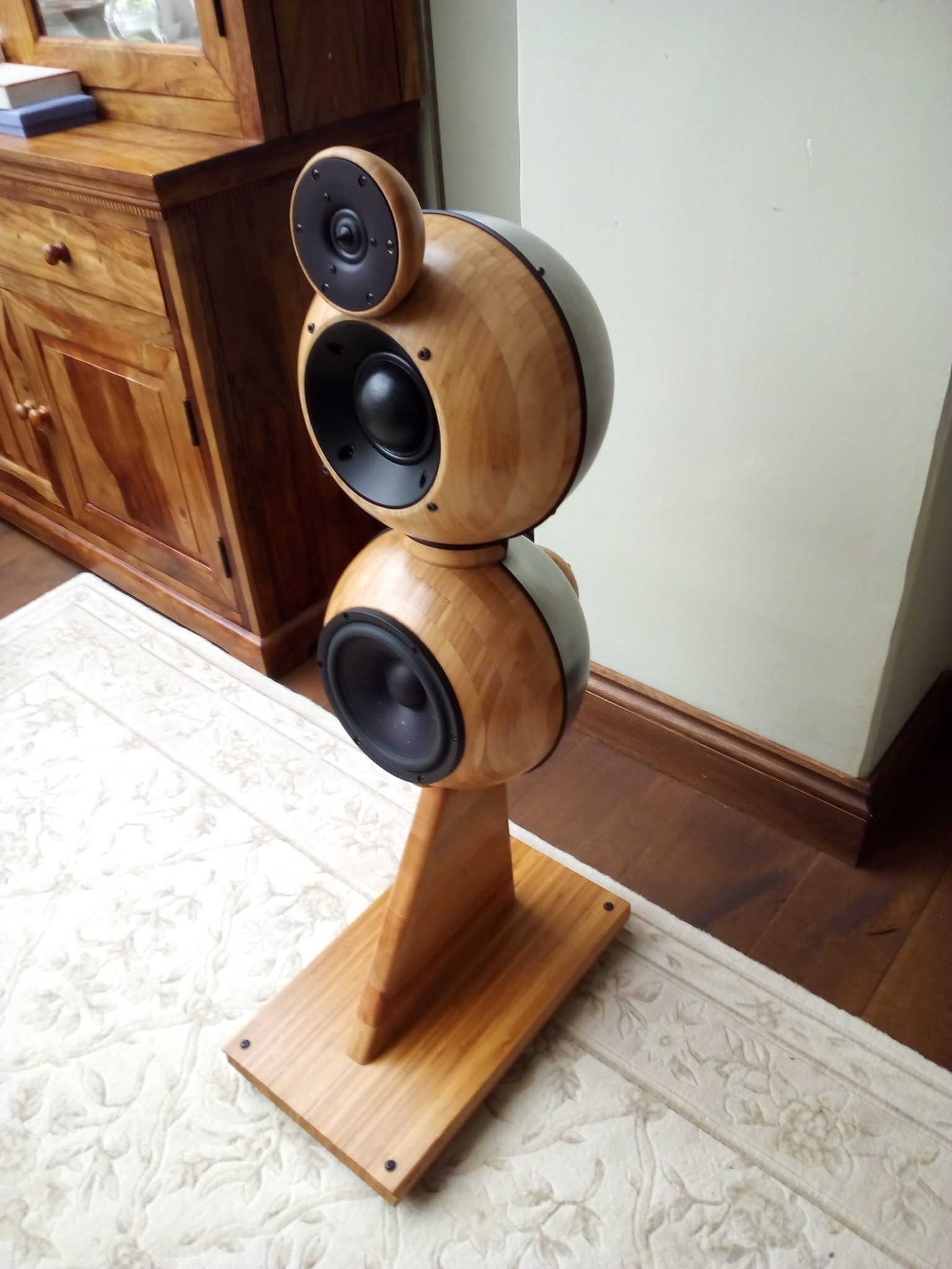

Hi i use that driver in a 9L sealed sphere for a qtc of 0.707 ish. I use it from 85-600 hz and think it is an amazing driver for midbass.
Link:
Great Balls of Prestige
Funnily enough i also use that tweeter!
Link:

Very nice. Salad bowls.
Having a peak at the build link now.

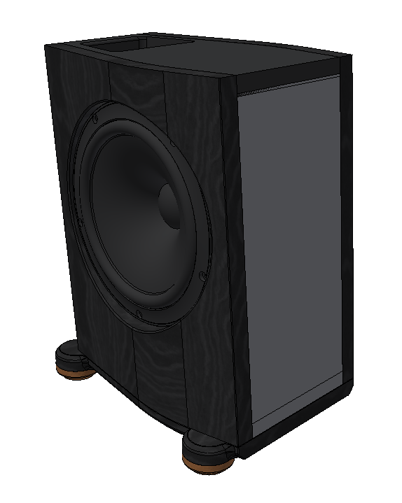

Hi Danner, for music a single 10" woofer/sub should be fine as long as it has reasonable x max. Also as long as your cabinets are solidly constructed and heavy, dual opposed is not essential - but it sure is nice!
My subs are overkill for most stuff, but with some music and most movies they really shine!

Hi Danner - that really depends on the drivers!
I will say the the dual opposed configuration completely cancels all driver induced vibrations from passing into the speaker cabinet.
This is particularly important if you are putting the subs into the same enclosure as the mid and tweeter. You want to minimize cabinet coloration as much as possible.
The 10" subs I used - alpine SWR 10D2- can be used in as little as 11 litres per driver. So if you have 20 litres to play with you are almost there sealed. They also have 20mm X-max, with 70mm X-mech - so really decent displacement and safety margins!
I would recommend DSP for the low end - but I think DSP is essential for decent sub performance - the ability to manage in room response from listening position average measurements for <100hz is one of the best uses of DSP in my opinion. Unless you have an amazingly treated room, and can place your subs in the ideal position (both of which is unlikely) or you have 4+ subs (also usually unlikely), DSP is a fantastic tool.
Of course it has to be used properly - cut peaks, do not boost dips, use averages for the whole listening area - not single point measurements, and follow trends rather than chasing down absolutely flat in room responses.
Yeah i know the dual driver is the ideal, it was also my initial thought. I did look at those subs, they truly look mean, but they also require a lot of power and room inside the cabinet don't they?
I am very limited in size though. My cabinet is only 250mm wide on the widest spot, The subs have to be slightly submerged from that point not to stick out anywhere. So the largest drivers i can put back to back will be 7".
If i put one driver higher than the other, i may be able to have 8" or 10" but this wont be ideal either, right?
I am definitely going to use DSP. My speakers will be 100% digital with the FA123. All crossovers will be DSP controlled, no analog crossovers.

Okay so i have been looking on subwoofer drivers again. Considering your advice on back to back woofers I think i ditched the Vifa and is back with flat drivers. However, I have compared the Dayton to my original SB choice and I think I will be going with the SB driver:
"SW26DBAC76-3-DV"
I somehow trust it more, and the simulations are better. Two of these SB'drivers will fit in 20L with Qtc of 0,685 whereas two daytons would have a Qtc of 0,852 in 20L.
I laso talked to Hypex on how much power the amps can deliver at different ohm loads as this was important for mi choice of the Dual Voice coil version of the SB woofer. Two SB woofers should deliver 97dB @ 30Hz and the two Daytons will deliver 93dB @ 30Hz.
I will start out by buying two of the SB drivers, one for each speaker and the possibility to test the benefit of having two drivers in one cabinet. If I can hear it is worth it then I will buy two more. The cabinets will be designed for two drivers mounted back to back.
Also the cabinet design will change again.. I will just make it as one combined unit, this will allow me to move the Amp down to the bottom of the speaker, simpler design and more volume for the Sub's.
It would be best to physically join the backs of the subs - with a brace or something- this is what allows the force cancelling to work.
In my subs the enclosure is a cylinder so the frame of each driver is directly connected to the other by the cylinder, but I also had threaded tensioning rods too. This results in a solid driver-driver coupling and complete force cancellation as a result.
Hmm.. I reconsiddered my bracing and I just changed the design of the bracing structure slightly. Now i think my cabinet and barcing will act almost like your cylinder cabinet.
Since my woofers are sliightly off angle i cannot use threaded rods through them, but i am convinced that this design will give a pretty solid woofer to woofer connection.
The red lines on the first image show how the woofers are connected top and bottom. The second image shows where the connections are - also the front and rea plate connect the woofers.
This is a square "cylinder" with holes.. Of-course not as strong as a full cylinder, but i am sure it is strong enough!
