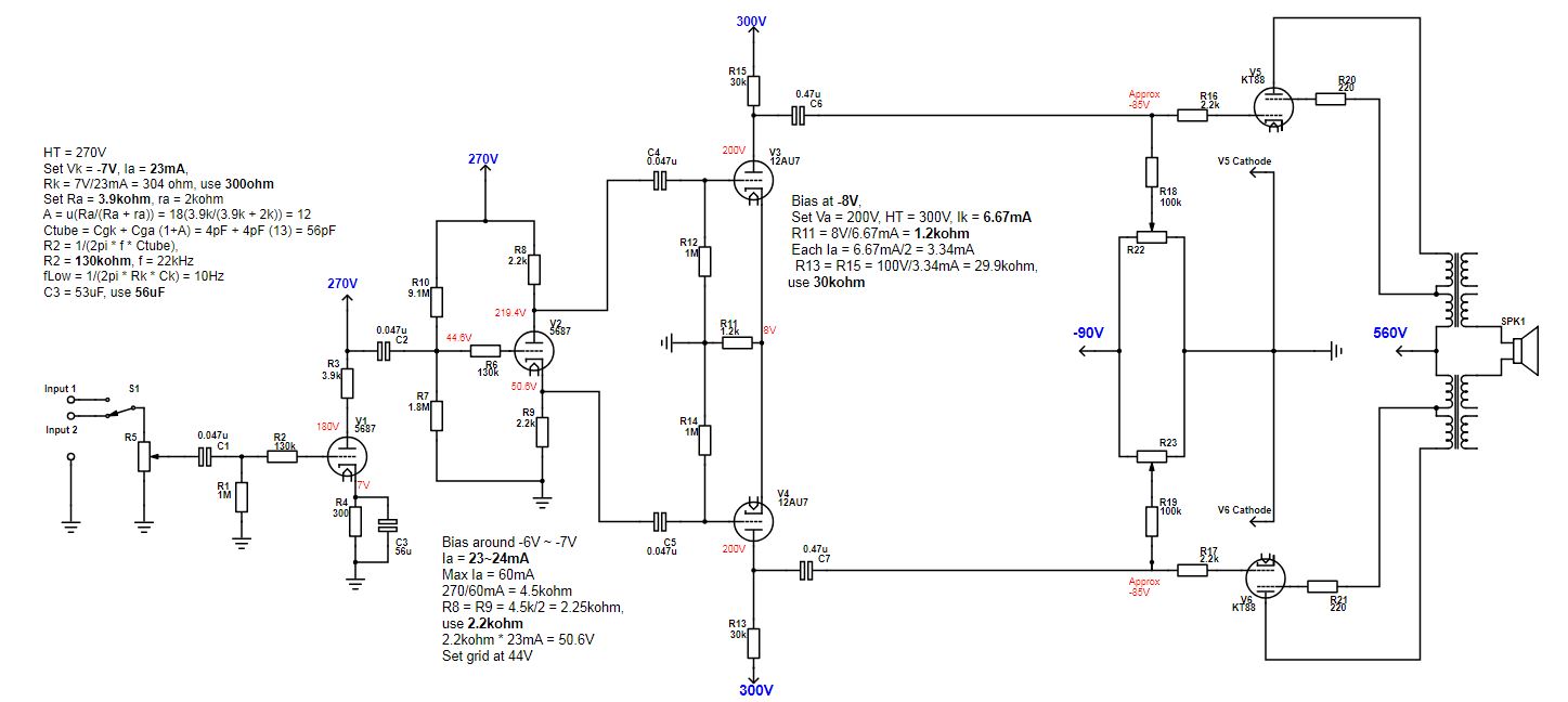

Currently working on my first DIY tube amp project, had a big picture figure out but just running into some detail questions. I have the schematic attached below, with some notes on there about how I pick the numbers, calculations, and all that stuffs
Note: The drawing app does not have a UL type output transformer, so I used two to represent it... I'm sure you'll get the idea. Second, some how it doesn't allow me to use the cathode pins of the KT88s, so I used arrows instead.
The design idea is based on the site below: Valve Amps: Output stage
I'm trying to get it to have 75 to 100W power/channel
With all that said, I questions:
1. How do I pick the primary impedance for the transformer?
2. How to calculate the voltage amplified after the power stage (or even each stage)
Also if anyone have any comments or see anything that could be potential issues in the schematic, I'm open to any of them :)
Thanks! ;)

1. starting with the datasheet figures for UL operation is always a good idea.
2. simple, just Vo = A x Vin, where A is the gain of the stage, which you can calculate/estimate based on the operating conditions.
There is no NFB. Is that your intention?

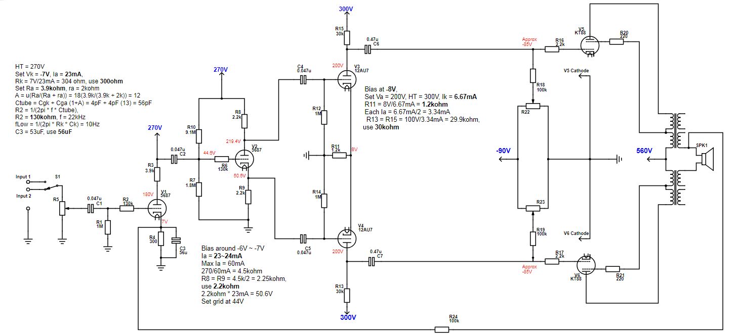

Right there should be a NFB, shown in the attachment

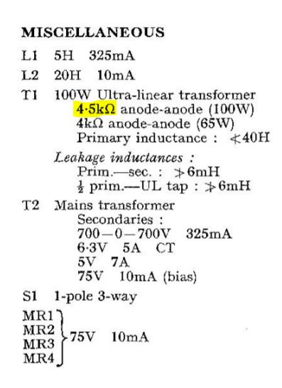

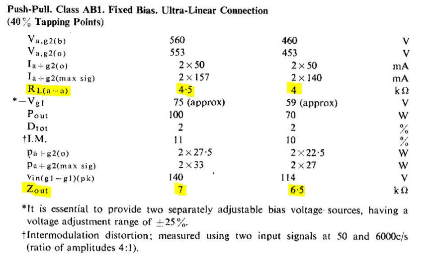

In the PP, fixed bias, UL connection (which is what I have right now), it says Zout range from 6.5k to 7k ohm, I assume that means the primary impedance of the OPT. But there's also RL(a-a) range from 4k to 4.5k ohm.
And if you scroll down, there's a PP 100W schematic, and they use a 4.5k ohm transformer. So... I'm little confused over here....

I did find some 5k and 4.2k transformers but no exact 4.5k ones. I assume that would slightly alter the output power but shouldn't be anything serious
So for the NFB, could that be fixed by simply removing the cathode bypass cap? or is there other way of connecting the NFB loop while keeping Ck?
To get 75 watts output in UL mode with KT88's, 6550's or equivalent, you'll need approximately 525V to 550V at the center taps of the output transformers with 4.3K to 5K primary impedance transformer and with 33% to 43% UL taps.
