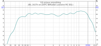

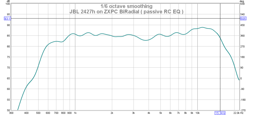

An older generation ( 1" exit / 44mm diaphragm ) will get you pretty close ( to your low X-over point ) when working through a large enough BiRadial horn.
"Older Gen." will usually translate into a Lansing company product ( JBL & sometimes Altec ) where historically the Fs of small format drivers were low and down around 600hz ( & max UHF is 15-16K ).
Here's a trace of a JBL 2427H on an Altec 811 sized BiRadial sold by ZXPC ( in Florida ).
This horn needs about 1/2 lb of mastic/plumbers putty added inside it smoothed around the throat entrance area, to fix the egregiously lousy stock expansion curves ( IMO, the horn is useless without this treatment ).

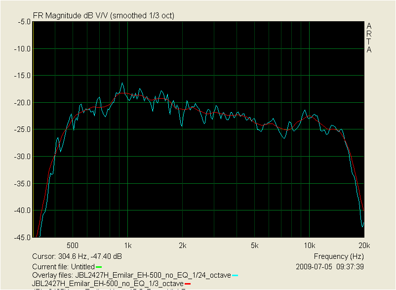

Here's another ancient trace of mine showing a 2427h on an Emilar Radial ( which is slightly smaller than the ZXPC.

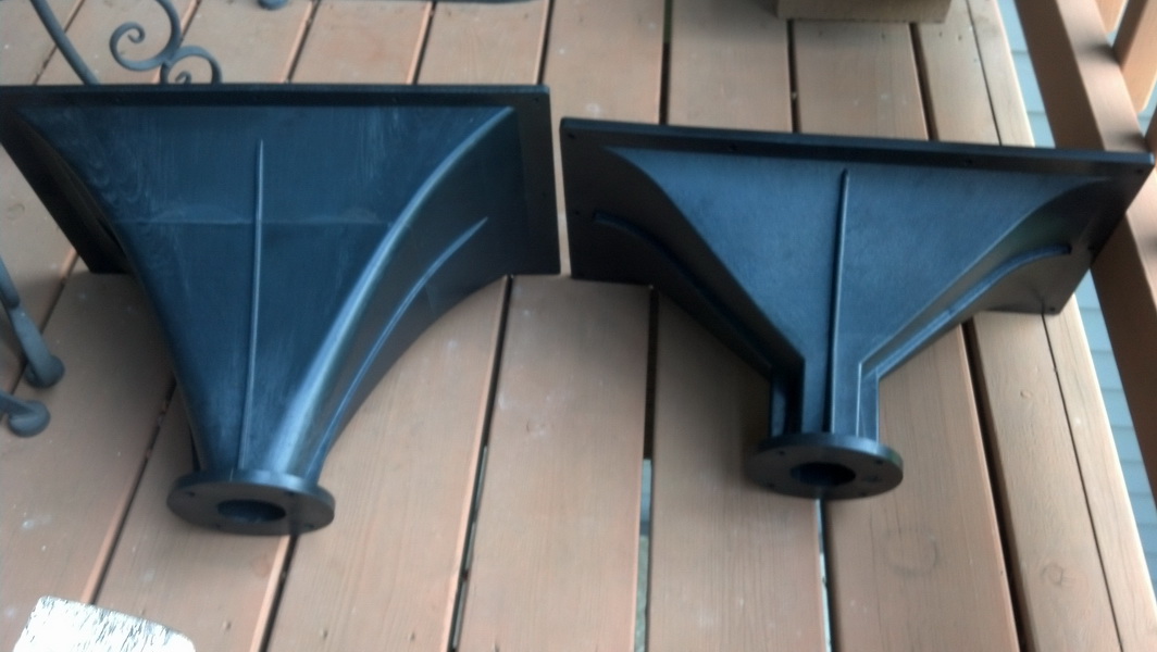

HERE's the horn link!
& here's what it looks like.

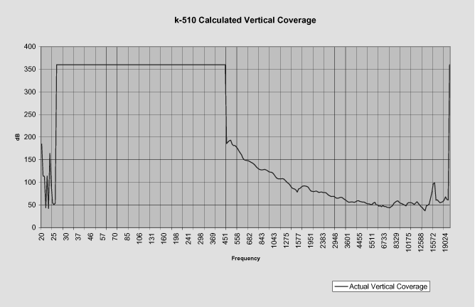

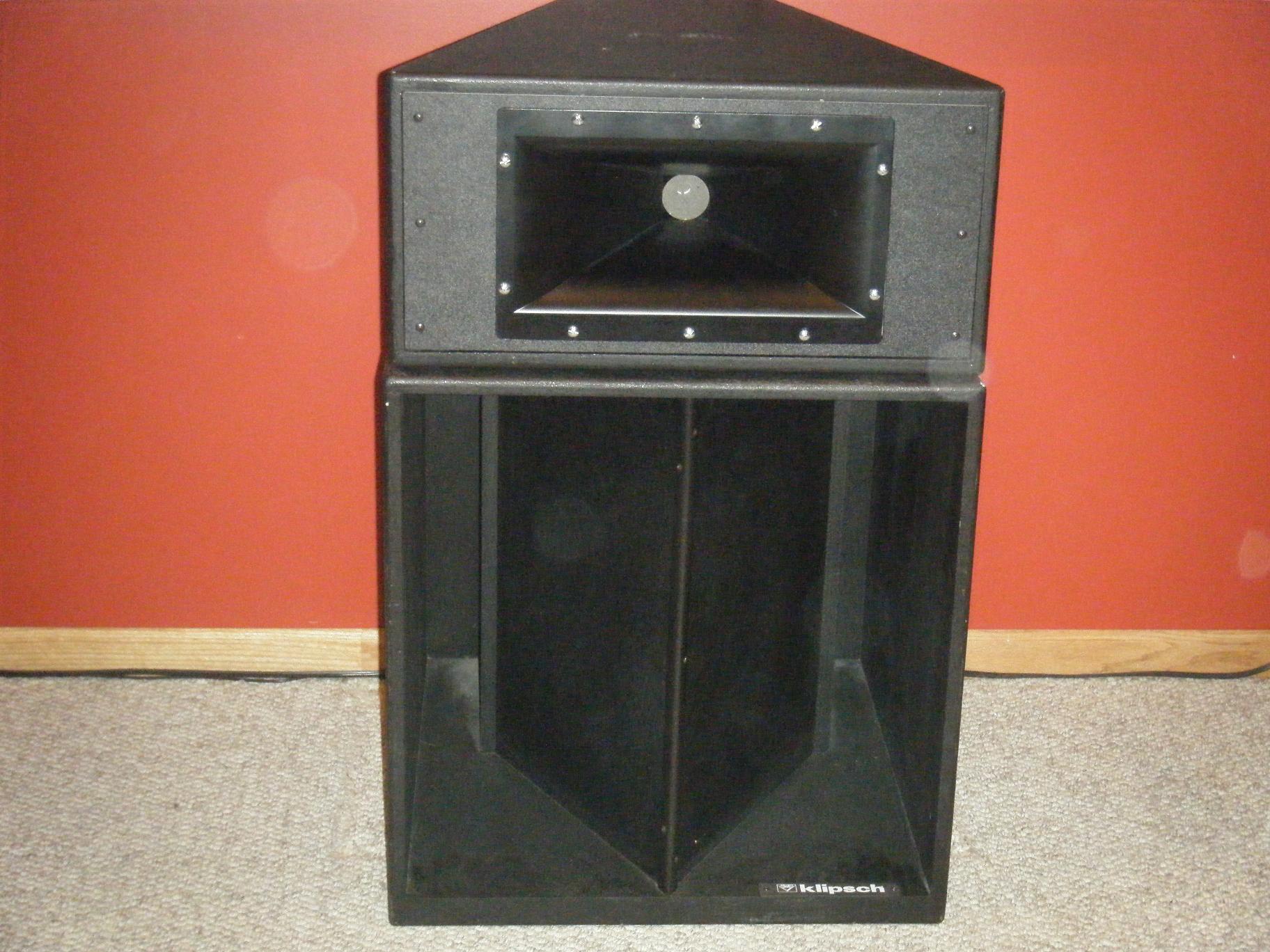

Here is a small horn that can hold its polars down to 500 Hz...the Klipsch K-510 horn in the top of a modified La Scala industrial (split):
...and the vertical polars for that horn and compression driver (...measured polars, not calculated--as is shown in the title):

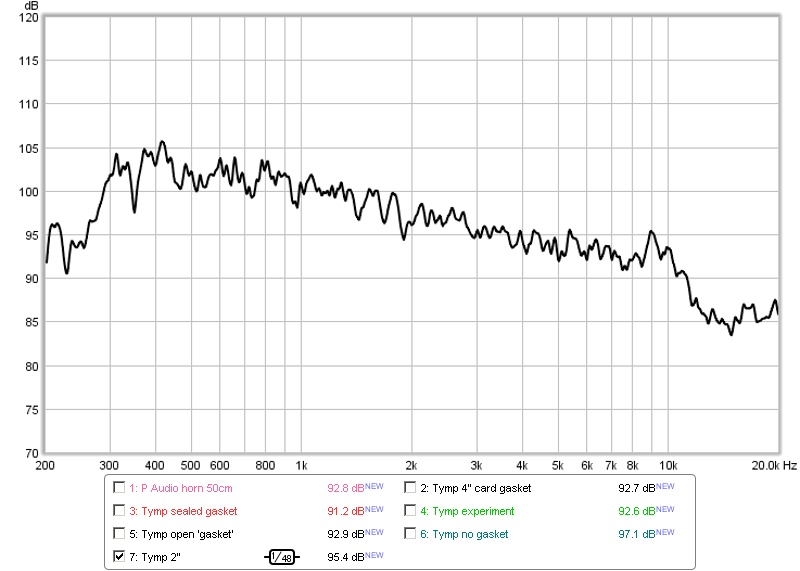

you need to make a small little mating flange to connect the peerless driver to the horn to get a better/smoother transition and using some eq to boost the top end and cut down the mid and you get reasonably smooth response down to 400Hz .
I tried the NE65W-04, just using a brace & a chunk of foam to press the driver against the horn throat. It is not a perfect fit (the throat is a trifle larger than the moving area), but it worked nicely.
The pic = full space response without eq (just a 200Hz high pass), measured 50cm from horn mouth. Nothing clever done (no windowing, not calibrated with SPL meter, mic positioned on reflective object), but it still shows very smooth horn gain that will be easy to eq flat.

To follow up: it's clear that the 500 Hz to ~20 kHz band is easily covered using one horn and one driver...notably a 1.4 inch to 2 inch throat diameter compression driver. You can also look at using dual-diaphragm compression drivers (BMS makes them, among perhaps others) in this regime to reduce any existing angst about using single driver full bandwidth.
The reason for posting on the K-510 horn is that it has posted polars that are outstanding relative to other horns in this size class, and it is a very small horn physically to meet the stated requirement-15" width x 9" height x 4.75" deep (38wx10x12 cm). You also stated that you're planning to use miniDSP to perhaps cross and flatten the frequency response due to the constant coverage nature of the horn. This horn is unlike any others that I've seen or personally measured in terms of its performance. This is a significant performance advantage.
This K-510 horn is available with compression driver attached from Klipsch in Hope, AR. There may be others available used (horns only)--as I bought my K-510 pair. I have used these horns on top of Belle Klipsch bass bins, both in two-way bi-amped and three way tri-amped configurations.
