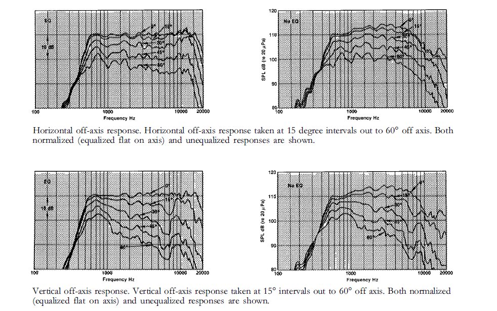

I'm quite happy with my JBL 2385a's crossed to 15" drivers (800Hz xo)

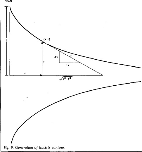

TRACTRIX-350 - Horns by Auto-Tech
Only 235mm [diameter]
The K-510 is 15" x 9" x 5" (381 x 229 x 127 mm).
The horn profile to which you linked is nothing like a modified tractrix profile. There is a world of difference in polars...and especially in its overall depth. The K-510 is about half the depth of a tractrix profile horn you posted.
Perhaps you should look at the K-510 profile more closely. I think you'll find it's much different--mouth, throat, and everything in between. Here's a clue from Bruce Edgar's tractrix horn paper from 37 years ago...

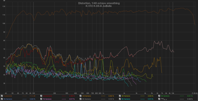

Could you show the Gain and the THD of the K-510 please ?

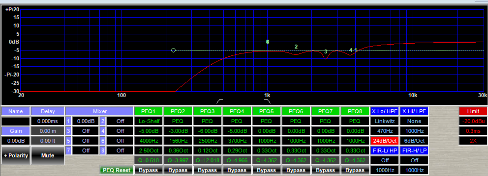

Note the drive level of the compression driver/horn (110 dB at one metre on-axis)...
I'm not sure who uses harmonic distortion since it's one of the least useful measures that I've seen when measuring horns/compression drivers. (Dual-tone modulation distortion is a much better measure in my experience.)
Chris

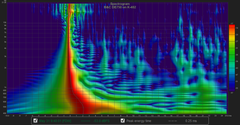

Here is a spectrogram of the B&C DE750 on a K-402 horn:

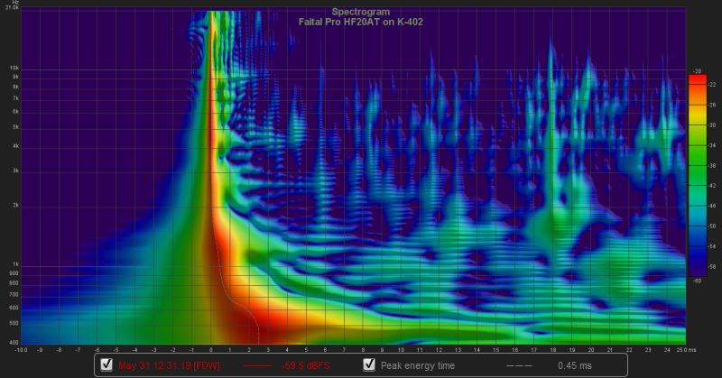

And here is the same plot for a Faital Pro HF20AT on a K-402:
Note that the Faital driver settles down almost within 1 ms and has minimal pre-ringing. The B&C driver has considerably more pre-ringing and ring-out after the peak, in fact, it exhibits a pretty good second, third, and fourth slap relative to the Faital driver. Both drivers sell for about the same cost in the US. :Listening tests correspond closely with the evidence from these measurements.
P.S. Sorry I can't make the plots bigger as these images are right up against the image size limit set by the forum admin. I recommend zooming in on the plots to see the nuances of their respective transient responses. The vertical plot divisions are 1ms width.

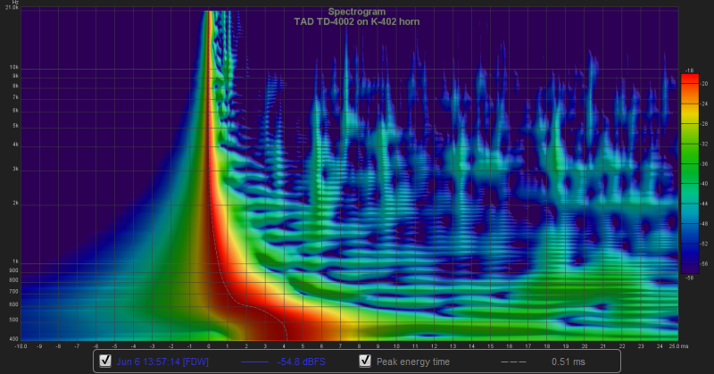

Here is the same plot for the TAD TD-4002 on a K402 horn:
The difference in transient response between the lowly Faital Pro HF20AT and the TAD TD-4002 is actually a bit difficult to hear, and it certainly doesn't knock you down like the B&C DE750 transient response using cymbal-heavy recordings. I personally would recommend the Faital Pros first to anyone, then let them decide if the cost of drivers at 10x the price is worth it. I would assume that this is also the case for the Radian 2" Be diaphragm driver.
