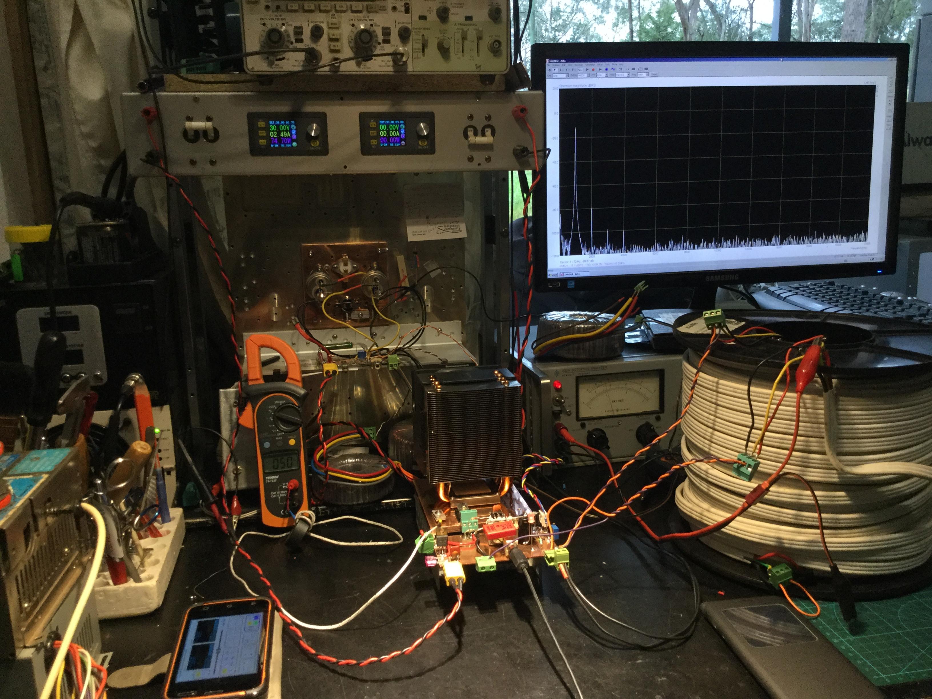

Do not worry much about noise with SMPS, my unshielded output transformer can pick up 50Hz interference from domestic appliances nearby, but the level is less than -90dB, at the far end of 20kHz, grass line is quite elevated about 5 dB above the -120dB threshold.
I used a trifilar transmission line air core transformer, straight out of a 100m drum of 3 core electrical cable, no more no less than two 3 way connectors attached at both ends.
The result is stunning, not easy to tell the difference between my SIT amp and my “Reflow MoFo”
(don’t trust me, due to my old age hearing and speakers quality, :lickface::lickface:)
Well, the coil resonated at 1650Hz with 3.3uF cap, “on line calculator” told me that I have a 2.8mH inductor, that is the way for one who knows only +-x/.
Cheers from Pascal

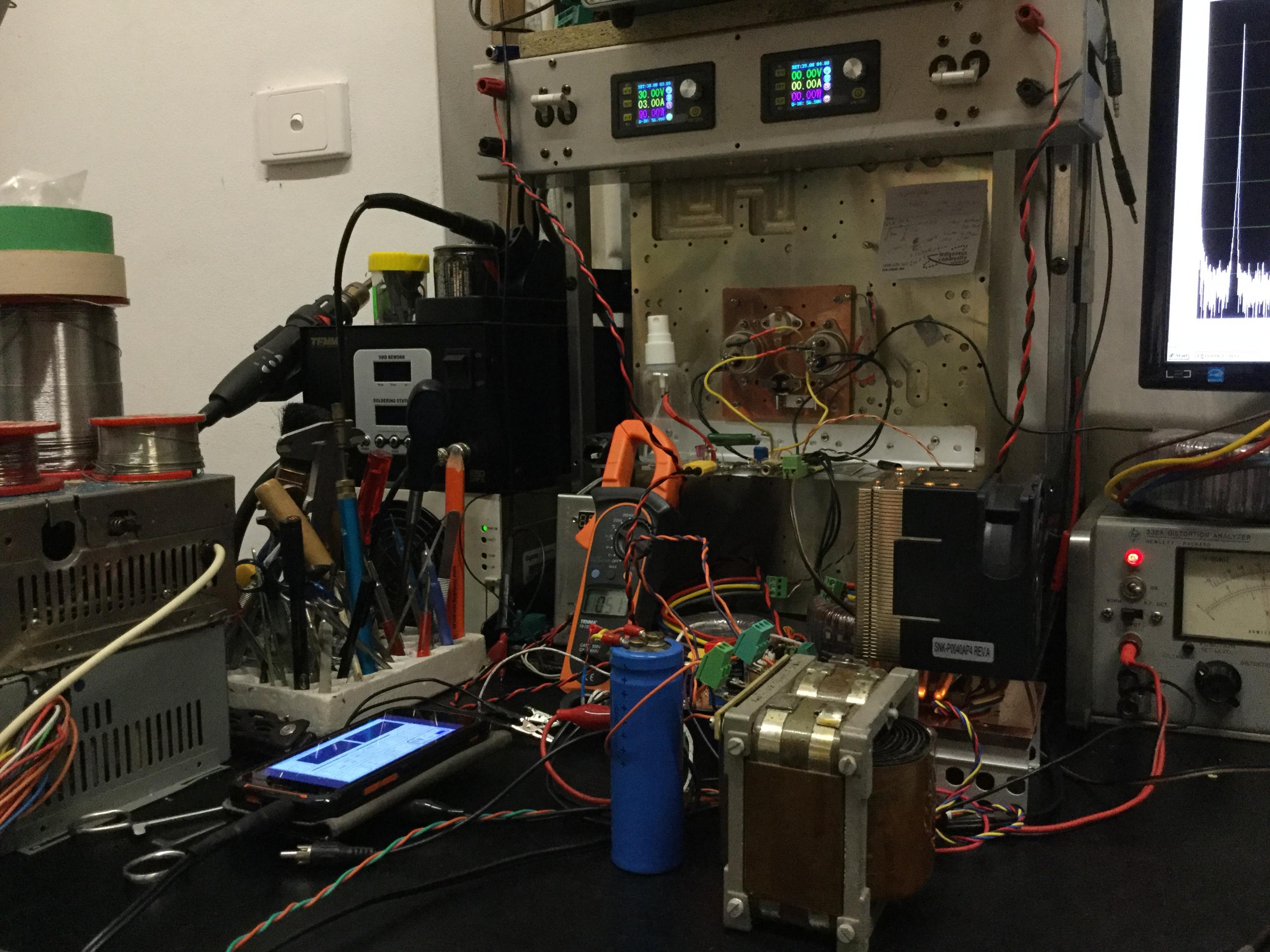

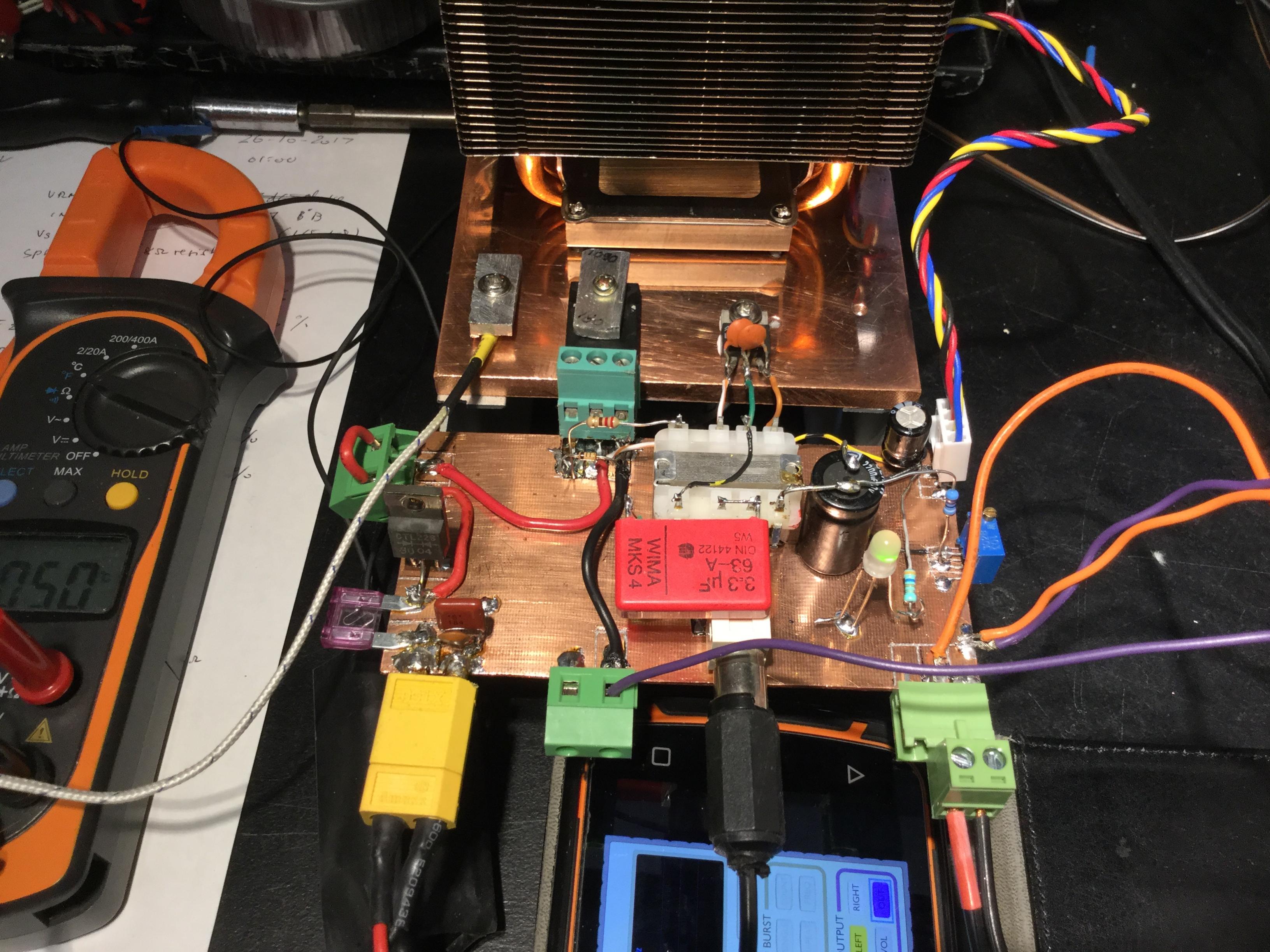

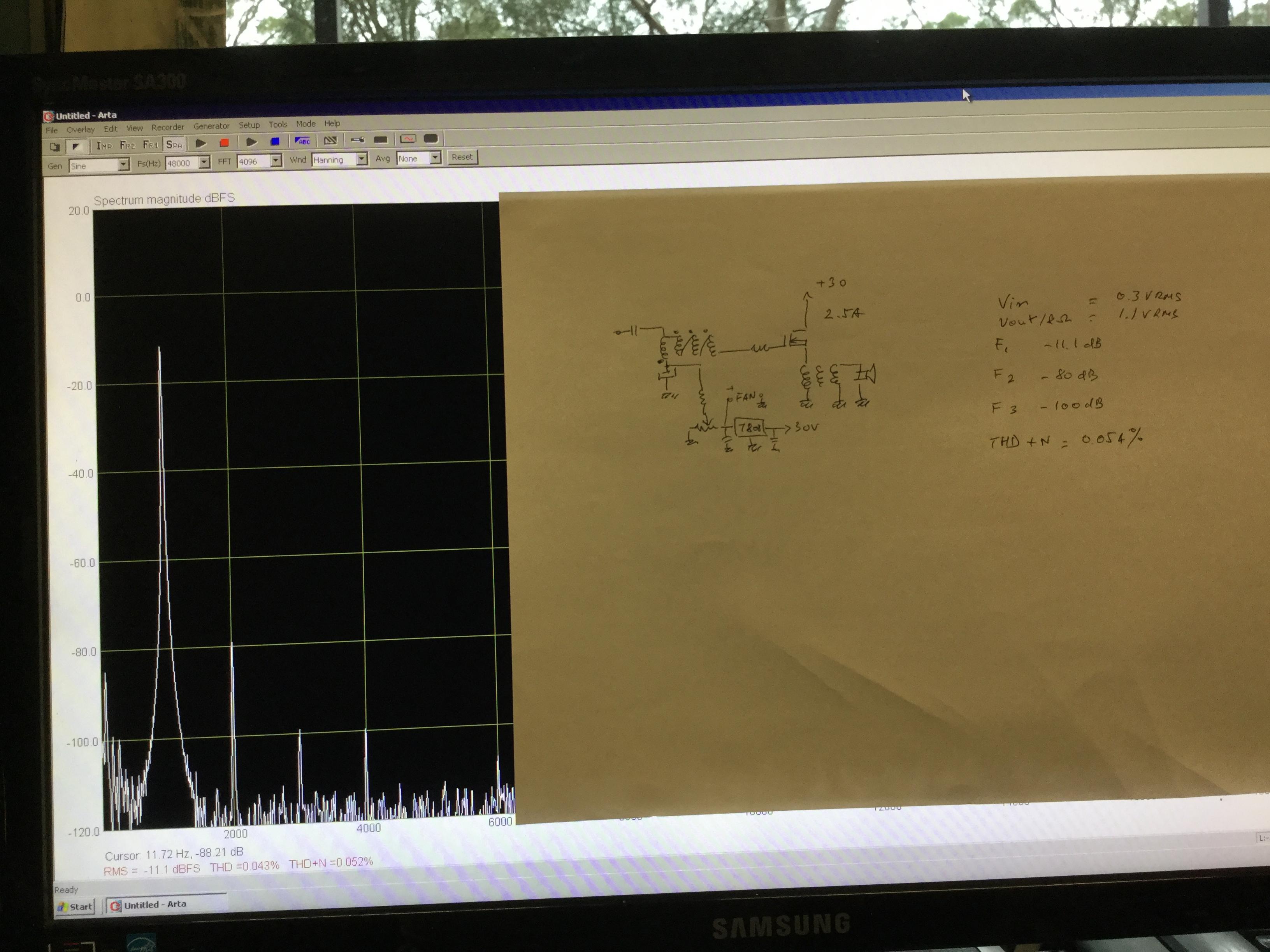

Air core versus Ferrite
It is raining, so I have plenty of time to do the winding.
Got a pot core FX2243 with 3H1 (A13) ferrite material with an AL 8830.
The size of my final transformer is D=45mm and H=30mm
I manage to wind in 30 turns of 50 Ohm coaxial câble.
Trifilar air core transformer // 3.3uF @ 1650Hz L=2.8mH
Coaxial FX2243 transfo // 3.3uF @ 1675Hz L=2.73mH
Pretty close for a fair comparison

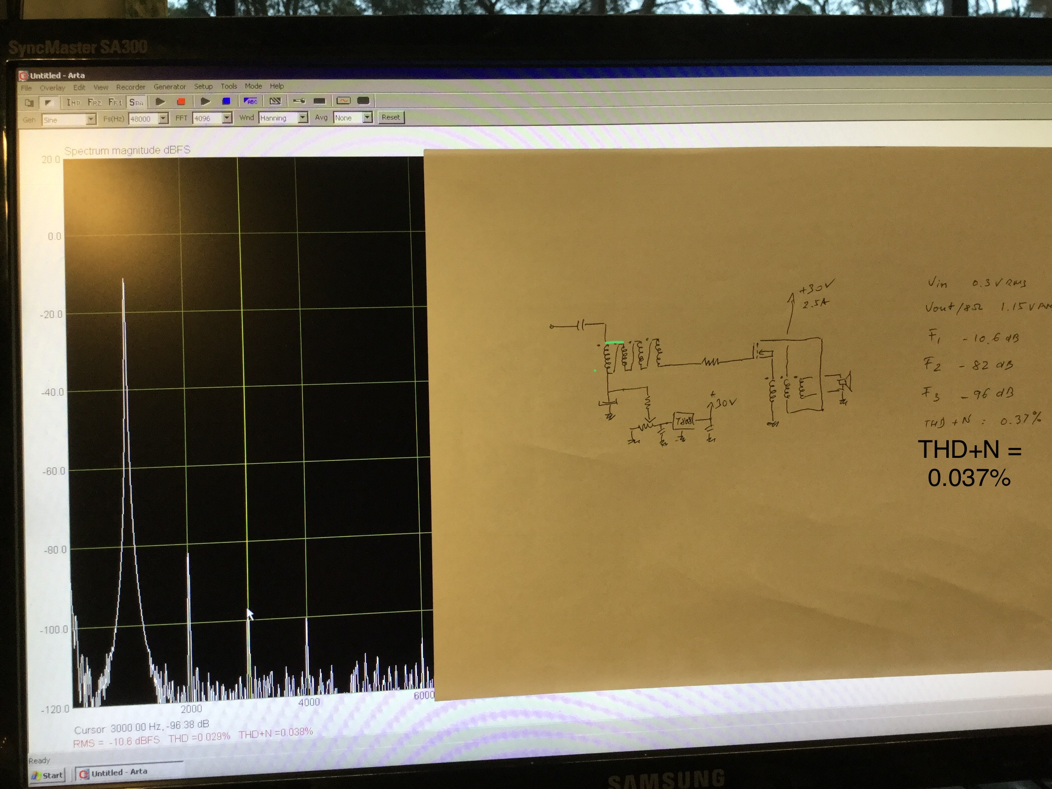

1) Bias Iq for best THD+N
Air core 2.5A
Ferrite 1A
2) THD+N for 0.3Vrms input
Air core 0.054% @ -11.1dB output/8 Ohm dummy.
Ferrite 0.30% @ -11.2dB
Pascal

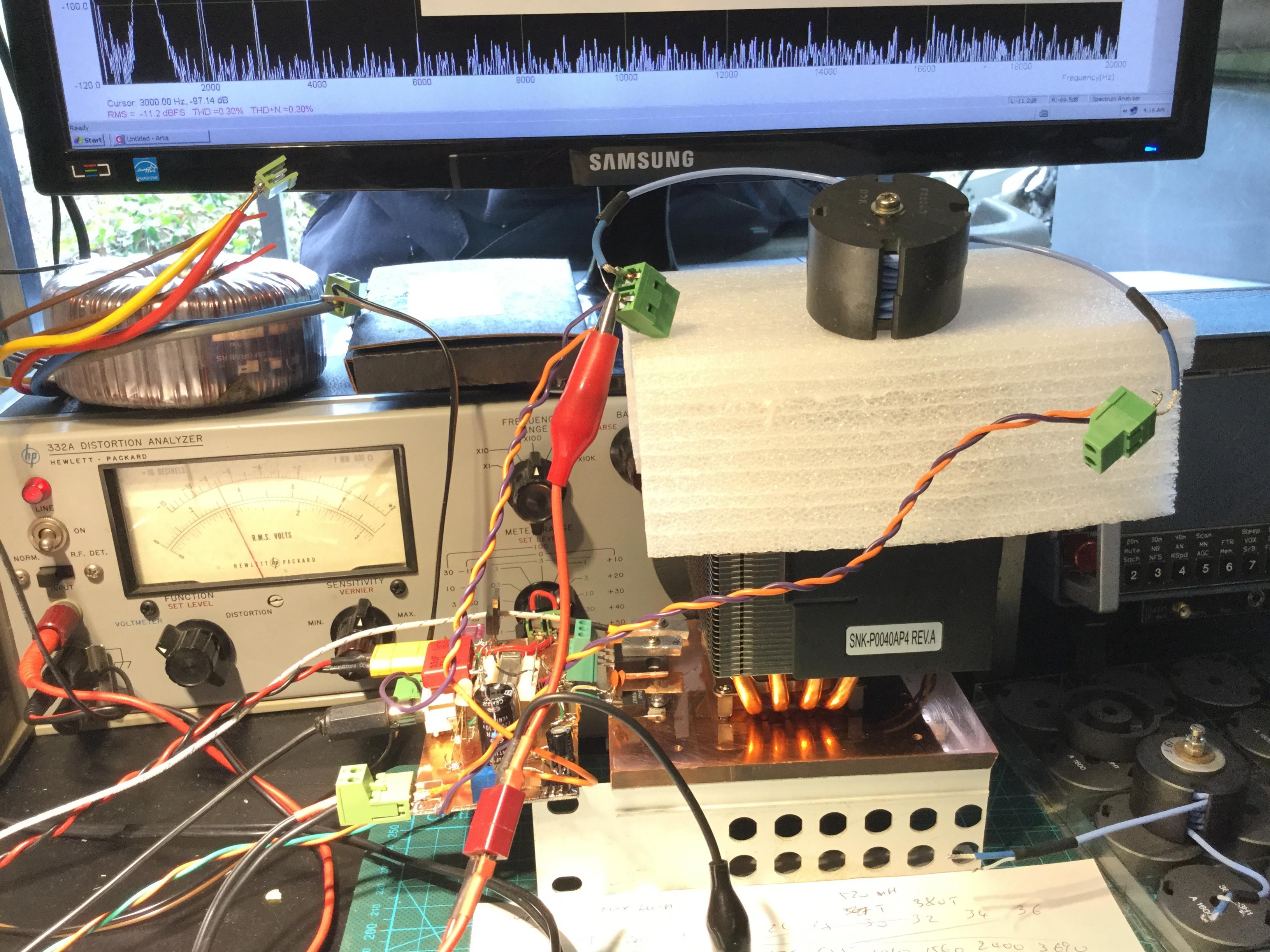

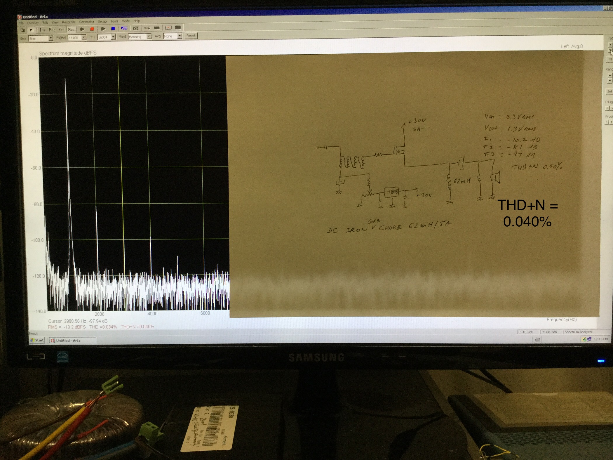

Versus Iron Core
A 62 mH dc choke is loaded to the Mosfet Source and coupled via a 20kuF to an 8 Ohm load.
Iq is optimised to 3A, fearless IRFP240 is under 90W of heat dissipation to a manageable level of 51deg C at copper heat spreader.
Close to 1 dB gain compared to the air core circuit.
0.01% of THD+N better than the air core.
Pascal

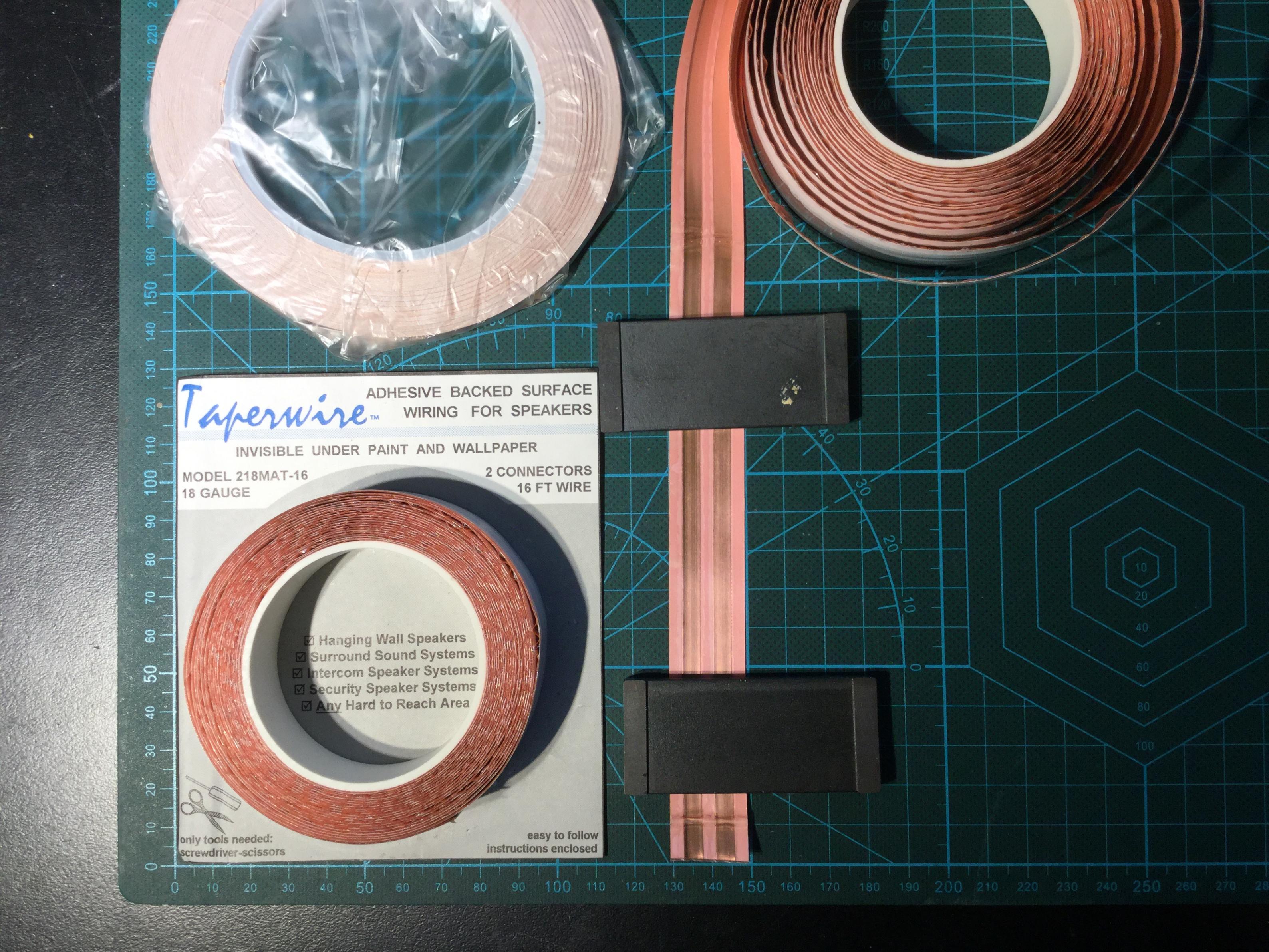

Hi Mr Rothacher,
Lot of useful info I gathered from you, many thanks.
I am on the same Charlie’s path, looking for ferrite core audio transformer.
Dealing with common drain amp topo, I believe that a current transformer is the way to go.
I gather some flat ribbon cables with a hope to build low impedance (4 ~ 12.5 Ohm) transmission lines then to assemble them in a current transformer with ferrite core for my Zeus, an amp small enough to fit inside a 10x5x20 cm case.
Warm regards
Pascal
