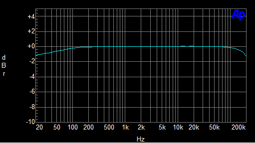

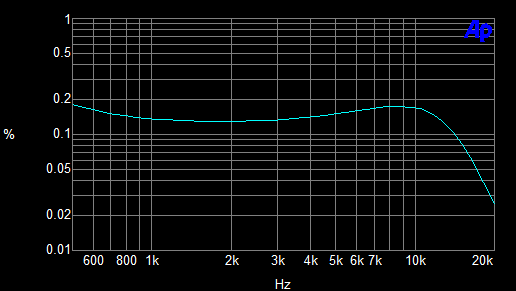

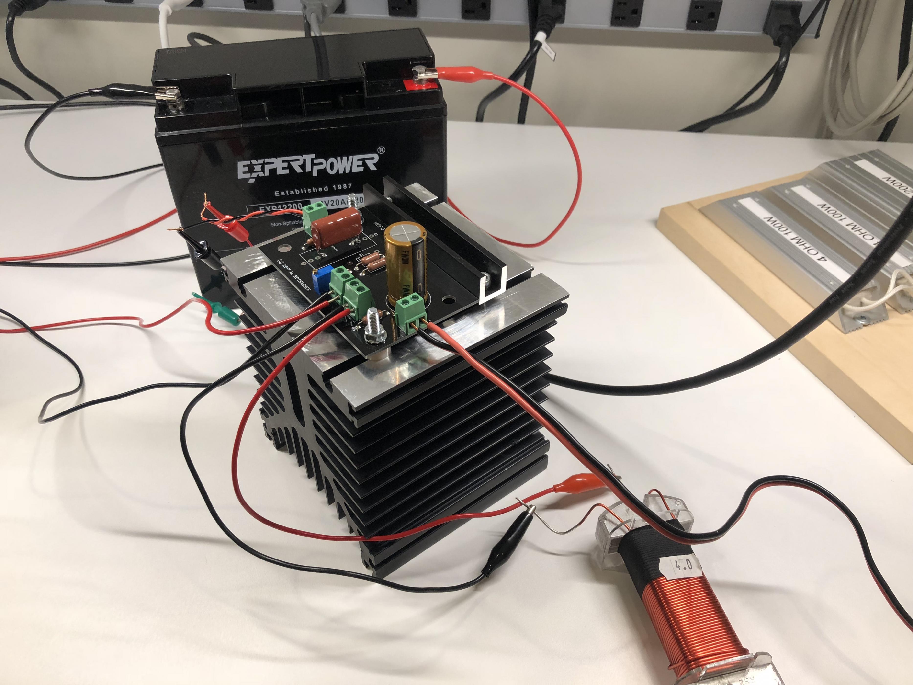

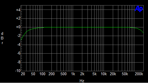

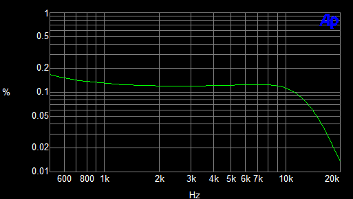

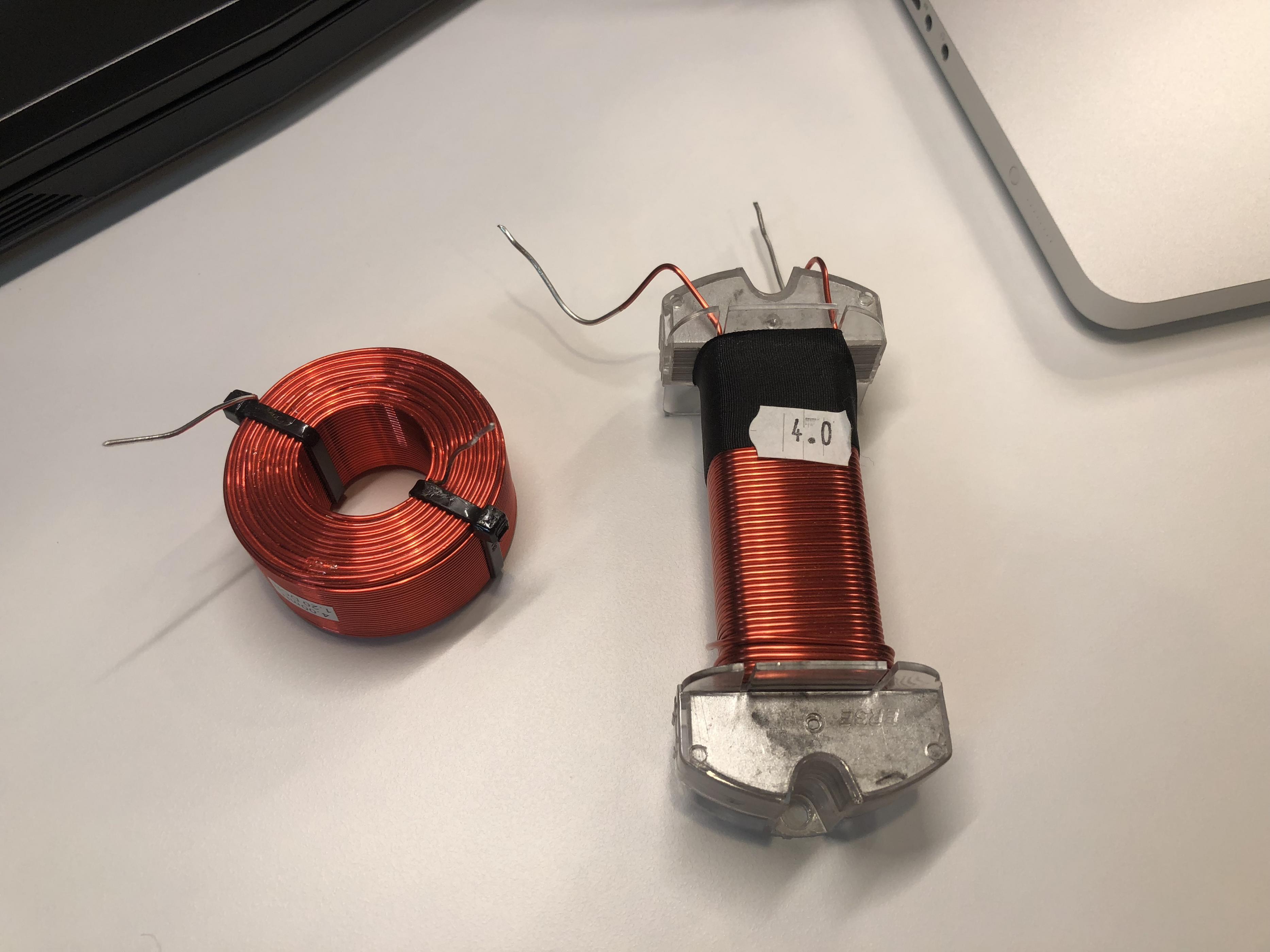

Here are a couple of small inductors I had in the lab, both 4mH, one air, one iron.
And here are the promised measurements: (aqua - air, green - iron) both in a 19V 1.7A circuit. 🙂
So a 4mH air core will get me to -1dB at 20Hz? That’s not bad at all. In fact, darn good for most speakers that I have.
Jantzen Audio 4.0mH 15 AWG Air Core Inductor Crossover Coil
Sound of air core should be better right?

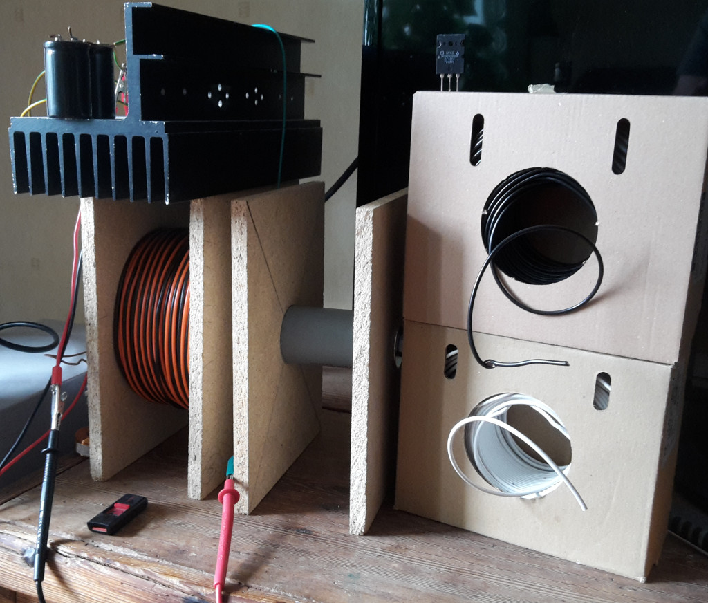

Here is my air cored bifilar chokes I use in my split load phase splitter amplifier.
Split load phasesplitter amplifier with bifilar choke load
It is a variation of the MoFo. It has 2 times the gain and a second harmonic cancellation effect to lower THD. If one wants to get all fancy you could call it a feed forward error correction quite similar to Nelson Pass super-symmetry. If you want to drive a high frequency unit then you would probably only need two 30 meter cables to each choke.
With two times 100 meter I get a nice response down to 10 Hz from this amp.
Johannes

1mH is awful reactive for 1KHz and 8r load. You want the inductive reactance significantly higher than the load impedance. More like 3 to 7mH.
24 Ohms of DC resistance is far too high for 8 Ohm loading. We may as well use incandescent bulbs (while we can still get some) (didn't someone else try that?🙄 ) Or is it 0.24, typoed?
So a 4mH air core will get me to -1dB at 20Hz?....
SMALL signal. The MOSFET has a very-very low small-signal output impedance, maybe a quarter-Ohm. This is indeed 0.004H at 10Hz.
But in a *power* amp, the choke impedance must be greater than the *load* impedance at the lowest frequency where we want big power. For 1KHz 8r this means more than 1.3mH, so really 3 to 7mH. Yet with DCR much less than load impedance, certainly under 2 Ohms.
Well, don't be fooled by the FR measurement alone. This example isn't a full range amp, for all the astute reasons which PRR provides, and the distortion goes quite high below 600 Hz, which is where the posted graphs start. The OP was asking about 1 kHz and up, and I think it wise to get well below whatever XO frequency is intended. 🙂
