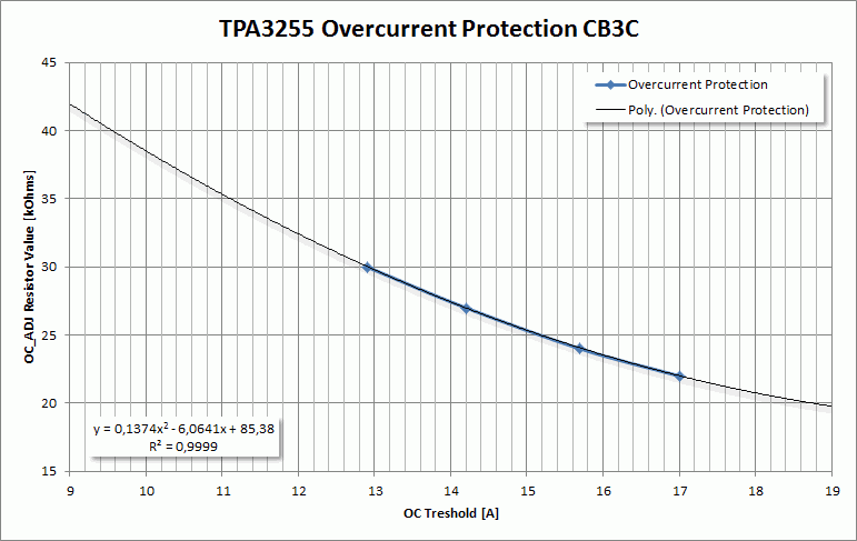

You can use the current limit programming resistor.
Approximation of datasheet values for CB3C:
attachment.php
170Wrms is about 340Wpk so at 4R there will be:
SQRT(340Wpk/4R) = 9.2A -> 41kOhms -> 39kOhms choosen to have some headroom.

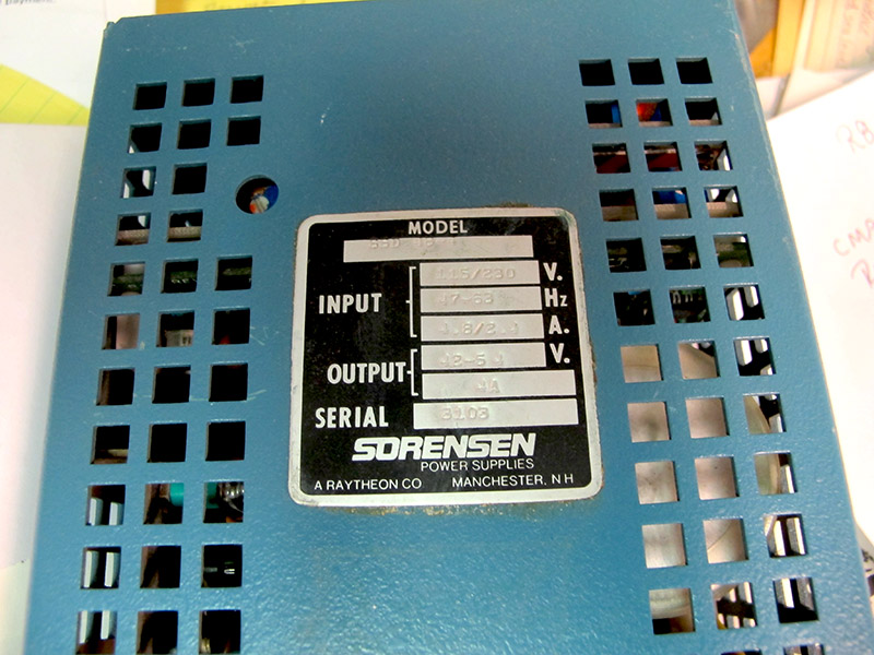

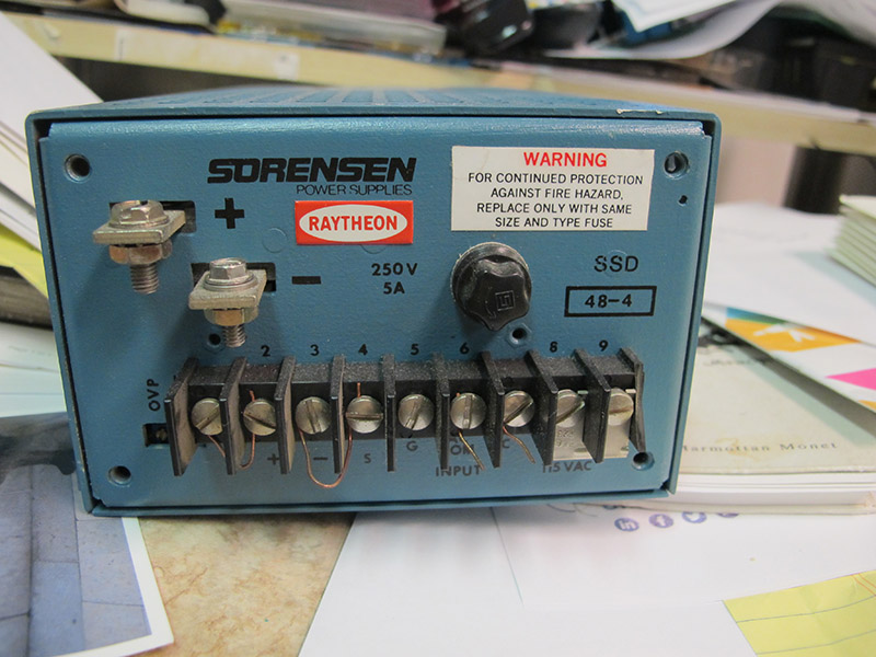

This was a "buy one get three more free" deal over 10 years ago -- 48V Sorensen supplies which have been sitting on a shelf. They would seem to be OK for this project Evaluation Module project. I think I almost tried to give them away at one time -- no takers:
