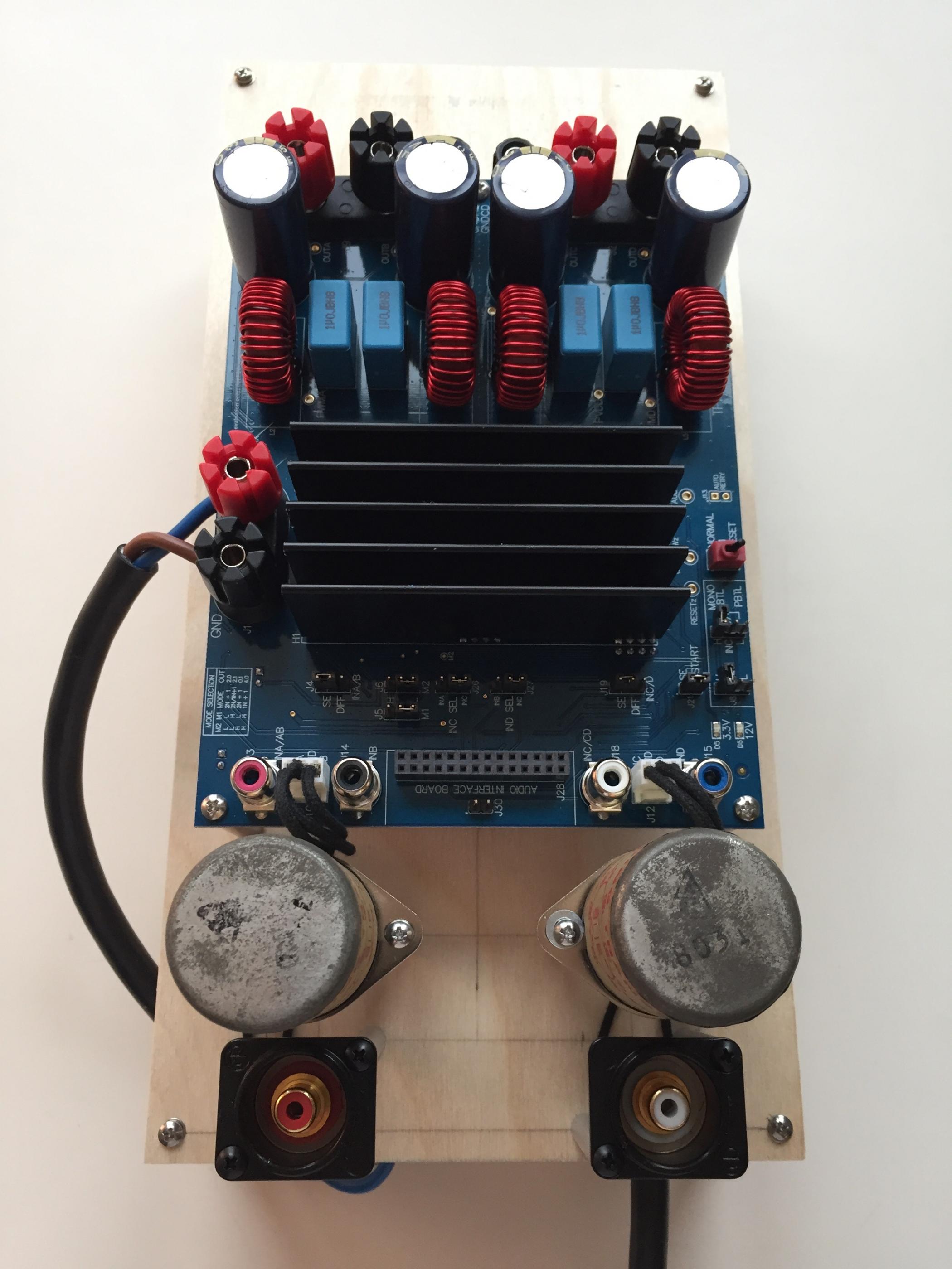

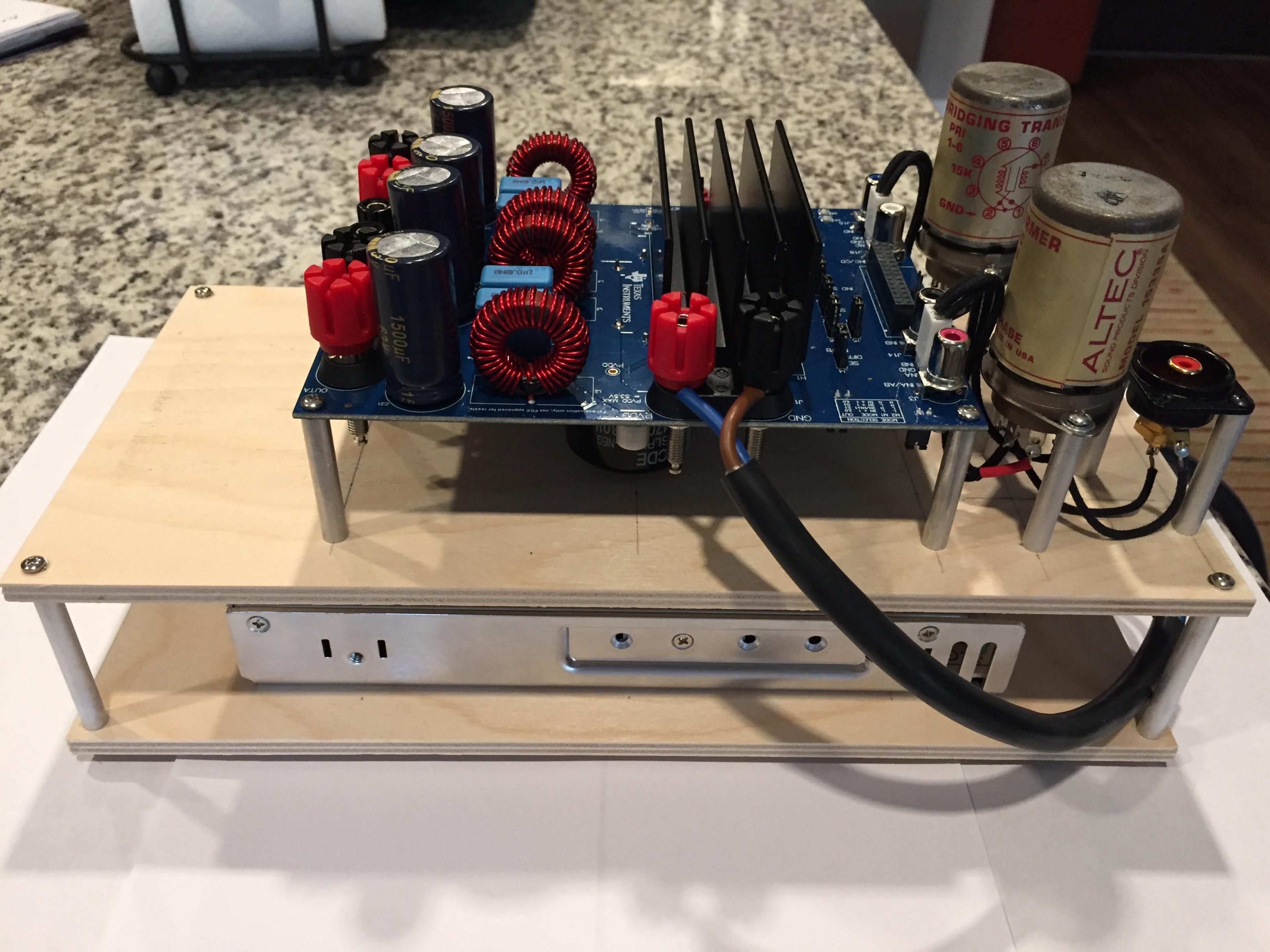

I added the Altec Peerless 15335A transformers, some Neutrik RCA connectors, some Molex connectors for the differential inputs and some Duelund DCA20GA hook-up wire.
The improvements are subtle. The midrange is cleaner, more detailed and more fluid. It sounded a bit grainy before, especially with drum brushes and some cymbals. The soundstage is deeper. I do not have any measurement tools set up, but I swear the noise floor has dropped as well.
I have a couple parts on back-order with Mouser for the PFFB mod. That is next.

@rhing, can you describe "fluid" a bit more?
After extensive listening to many familiar tracks, I hear more low level detail, which translates into more sustained notes and just more enjoyable listening. Before the additions to the amp, the upper mids and highs were a bit blurred or "grainy" sounding. Now, everything is clearer and better defined. When I use the word "fluid," the music doesn't sound grainy.
These are subtle improvements, but more pleasing to my ears. On Pink Floyd's Dark Side of the Moon, the multiple clock alarms and chimes at the star "Time" occupy their own space in the soundstage and stand in greater contrast against a blacker or quieter background. With some music tracks, there are no noticeable differences.
