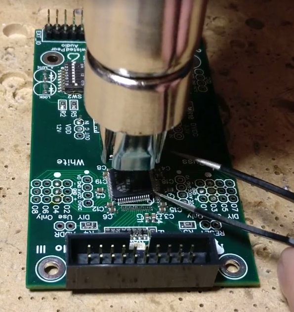

Since I happened to have a burned out Buffalo III board, I experimented with mounting an ES9028Pro on it.
Since the 9028 has the same pinout as the 9018, all that needs to change on the B3 board is:
1) Put a jumper on the reset pins.
2) Put in a higher current supply for the 1.2V PS. I found that with a 100MHz clock and 352.8K material current consumption is around 200mA.
I also made a new set of Trident replacement power supplies:
It turns out the I'll have to do a new design for the 1.2V power supply, since it's running pretty hot right now..

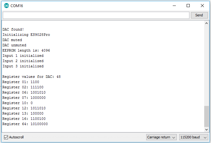

The experiment was a success. I'm controlling it with a piece of experimental code running on an Arduino and the sound is a substantial improvement over the "stock" B3.
attachment.php
Next step is doing a new version of my TFT HiFiDuino code that is compatible with the 9028/9038 (their digital core is exactly the same, my code has been tested on both of them and works fine).

Yes, I've started work on 9028/9038 support for my arduino tft project. Essentially what I'm doing is a major rewrite of the code. When I'm done with it it will bear little resemblance to the current TFT HiFiDuino code.
Yes, the code for the 9028 is 100% the same as for the 9038. I've tested both chips.

I did a similar conversion on a dead Buffalo III but had problems with the
thermal pad on the ESS chip touching the +Ve vias under the chip.
Did you make a provision for this ?
The 9028 does not have a thermal pad, so no prob.
If I were to try putting on a 9038, I'd put some kapton tape on the bottom of the chip and a big heatsink on top.
The improvement from 9018 to 9028 is substantial, as long as the rest of the system is transparent enough.
But the bigger improvement came from replacing the "stock" TPA AVCC module with the LT3042-based one.
I haven't yet managed to try out Kali in this setup but I will.. Plus I'm also waiting for Ian's MC FIFO.. :)
