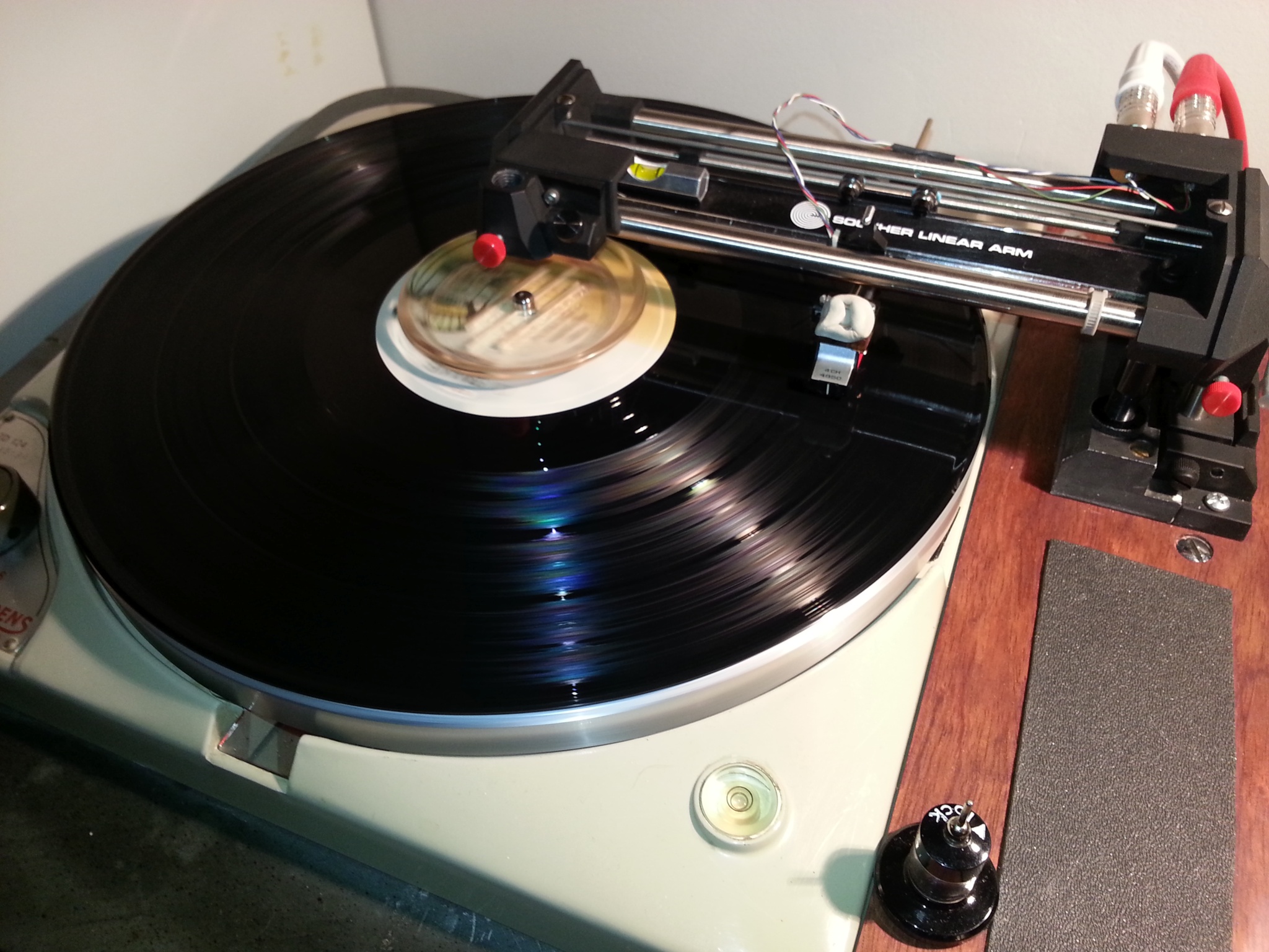

Interestingly I installed the 465C on one of my Southers and added about 5gms of mass to the too light arm wand so I could use a 6gm counterweight to apply a tracking force of 3.5gms.
I modified my Muscovite Mini and added 6dB of boost between 500Hz - 2.1kHz, did nothing above that, but it strikes me it can be a bit bright on some material. VTA definitely plays a role.
Surrounds surprising good. My line stage allows me to invert outputs independently of each other.

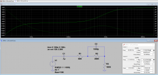

Seems like partially correcting the region between 500Hz and 2122Hz works better than the more aggressive approach I initially took because the highs above 10kHz are not boosted as much.
From 6.5dB shelving HPF I went to 3.5dB and it seems to be better overall.
So far I have not established a need for cut below 50Hz..
I still think the response may need to be knocked down a bit above 10kHz.

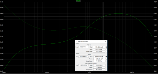

Tonight I will share graphs of the EQ tried so far.

I haven't figured out how to do a 3dB/octave filter, but some EQ appears to be needed.
Currently I have a very simplistic EQ with about 3.7dB of boost between 500Hz - 2122Hz which means the area above 10kHz is not excessively boosted, but doesn't fully compensate for the trough.

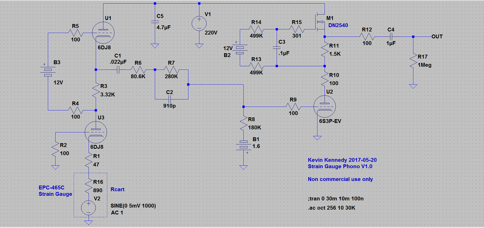

Version 1 Schematic Design

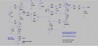

As I've remarked before I design phono stages with deliberately high output levels in order to integrate well with systems with digital sources with maximum output levels of 2.0Vrms @ 0dBFS.
With approximately 57dB of gain @ 1kHz the maximum output level of this combination of EPC-465C and strain gauge phono stage should result in approximately 2.1Vrms @ 5cms/sec at 1kHz.
Detailed description:
The first stage is nothing more than a 6DJ8 mu follower although the battery bias scheme may make that less than obvious. The batteries last many years and allow me to establish an operating point that is more than usually independent of the tube's slope of transconductance. In this case I have chosen 4mA as the target current as this is the value Panasonic mentions in the specification for these cartridges.. This yields a gain of approximately 30dB in the first stage and the follower provides an output impedance to the network of < 1K ohm.
Something less obvious is the input stage is non-inverting and provides bias to the cartridge.
The second stage is a hybrid mu-follower using a DN2540 as the upper element, again battery bias is applied, this reduces dependence to operating current on fet threshold voltage, it also allows for fairly large source resistance which improves the performance of the follower. The follower will drive transformers effectively output impedance is < 200 ohms.
A Salas SSHV set for approximately 200 - 220V would make a good power source for this design. Local decoupling is a must.
You will note that there are a lot of 47/100 ohm resistors, unless you want a VHF oscillator you will not omit these. These particular resistors need to be placed right at the socket.
Yes, I like batteries, they're cheap and quiet sources of bias. There are two A23 12V batteries and a single AA per channel.
Note that at your discretion I might recommend the use of a 5.1V low capacitance TVS diode on the cathode of each channel to protect the cartridge in the event of a tube or other component failure.
This version is currently in use here at home with an EPC-465C.
**Note** C1 may be increased to 0.1uF if LF roll off is not desired. (This is what I am currently using)
No provisions have been made to invert one channel relative to the other, you will need to invert at the speaker or if using transformers on the outputs invert one relative to the other. My line stage provides the ability to invert either or both channels as desired right from the front panel.
The design is shared with the explicit understanding it is for personal use only.
Edit: Please see POST # 73 for the updated design. (Major improvement)
