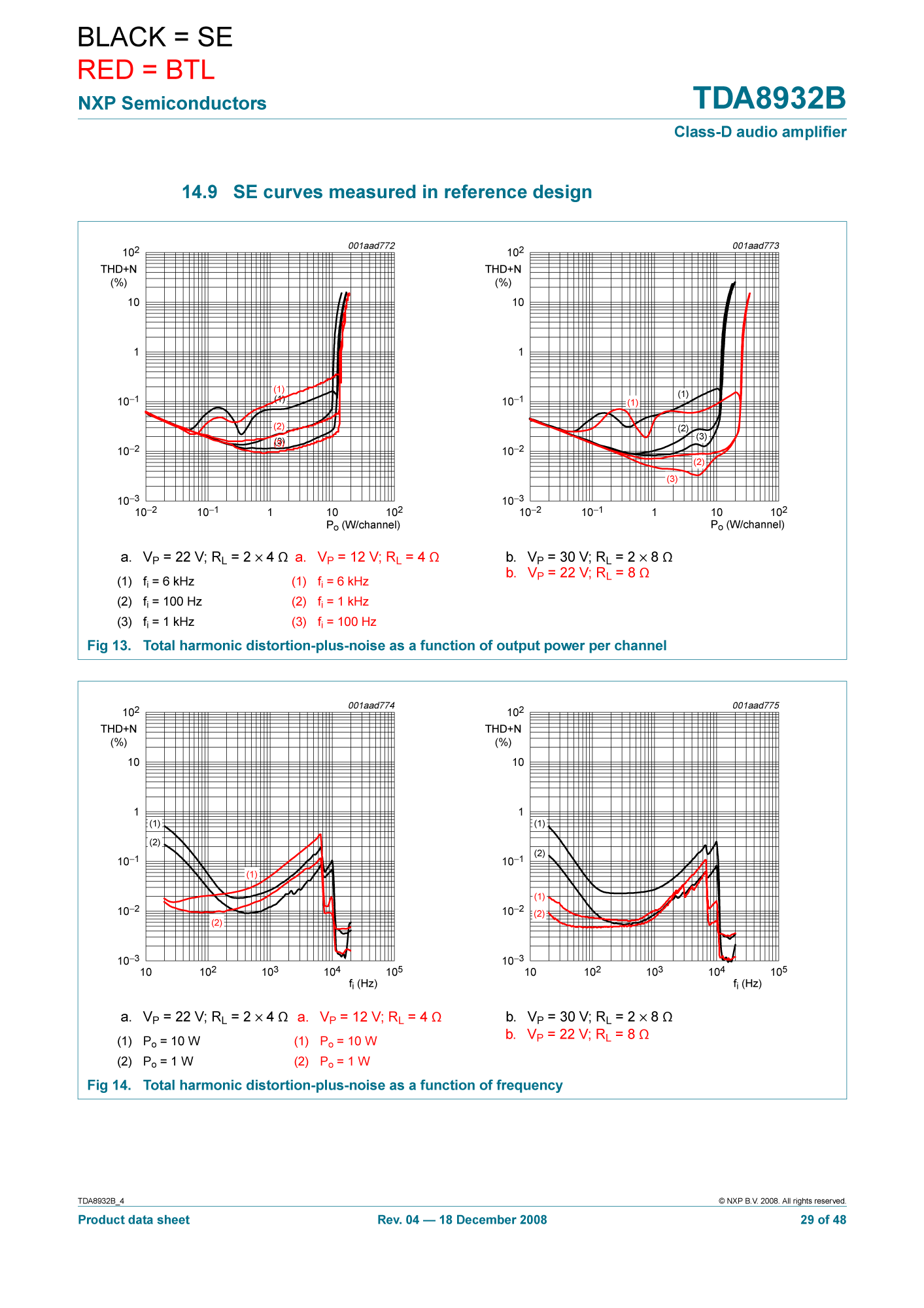

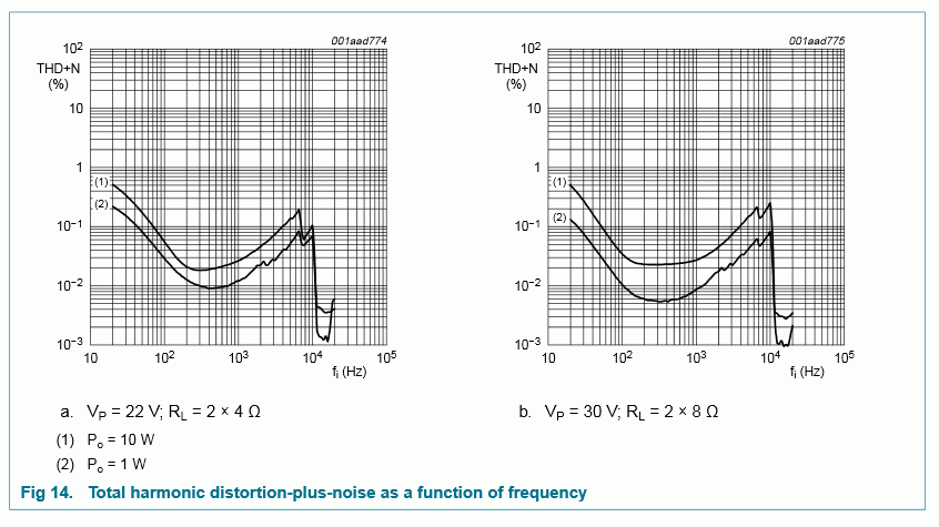

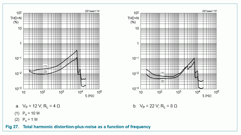

Hmm, when looking the the datasheet i can't see the improved from SE over BTL. (TDA8932B)
Reference: http://www.nxp.com/documents/data_sheet/TDA8932B.pdf
SE:
attachment.php
BTL:
attachment.php
What does SE makes it more "HiFi" than BTL? From Figure 26, the BTL is a bit worse at the 6kHz frequency but this is really minor.
BTL: 0.35% at 10W VP=12V RL=4R
BTL: 0.15% at 10W VP=22V RL=4R
Christian

To have a better comparison, i put both in the same diagrams. But still not seeing the point where SE makes it more "HiFi"? :confused:
attachment.php
Why indeed would there be an audible difference in practice, with a music signal and a real speaker when the datasheet shows a minimal difference in lab conditions?
I apologize! I cannot answer that question sufficiently.
I will try, because asked. But, this will go badly. I am sorry for that.
What can I say that is meaningful? Bridging does have several advantages, such as headroom that is awfully good for fidelity, power supply management, and resistance to negative impedance glitches. Those are all sure to improve the fidelity of any speaker drivers responsible for the bottom half of the audio band. But, it really sucks for tweeters due to the degradation of linearity that such loading will do to the tiny output devices. Additional costs of a series connection, like bridging (amp-speaker-amp--that's series), are incurred when something is wrong with the amp.
This is not quite wrong. Maximizing stability while driving a real speaker, increases efficiency and promotes a placid, ear-friendly tone, in all or most conditions. In SE mode, you get that. But, when two such efforts go in series, for bridged, you get doubled costs, just the same costs as if you'd overdone the compensation by twice (two amps, series). I so hope I'm not totally flubbing the explanation, although my track record on that would probably indicate that this will go badly. Another moment for apologies! Sorry about that. Anyhow, two good intentions unexpectedly run series results in overkill. The cost is a "much less interesting" output from your tweeter. The datasheet does show it, but it did not show the extent of it, practically. The logical but utterly craptastic answer has to be that the tested conditions were different. That is lab conditions versus speaker. I've seen that before with RMAA, where I routinely have to re-size the graphs 10x higher. My test equipment (crude, cheap, free, pc based, and a bit of guess), typically shows the answer spot on, as well as utterly fails to represent a practical extent. Basically, frequency fine, amplitude foobar.
Consider this! Maybe the datasheet is correct, that the treble is unnoticeably worse when bridged and I'm just a hyper-sensitive person equipped with a specially rigged speaker to spot it. That's a really different way to say it, but it is so close to the truth that I wouldn't really be able to dispute it.
Frequency fine, amplitude foobar, test conditions different. That's as close as I can get to an engineerese language answer. I wish that I could do better, and it isn't for lack of effort, but I just don't have it. Well, there it is.
