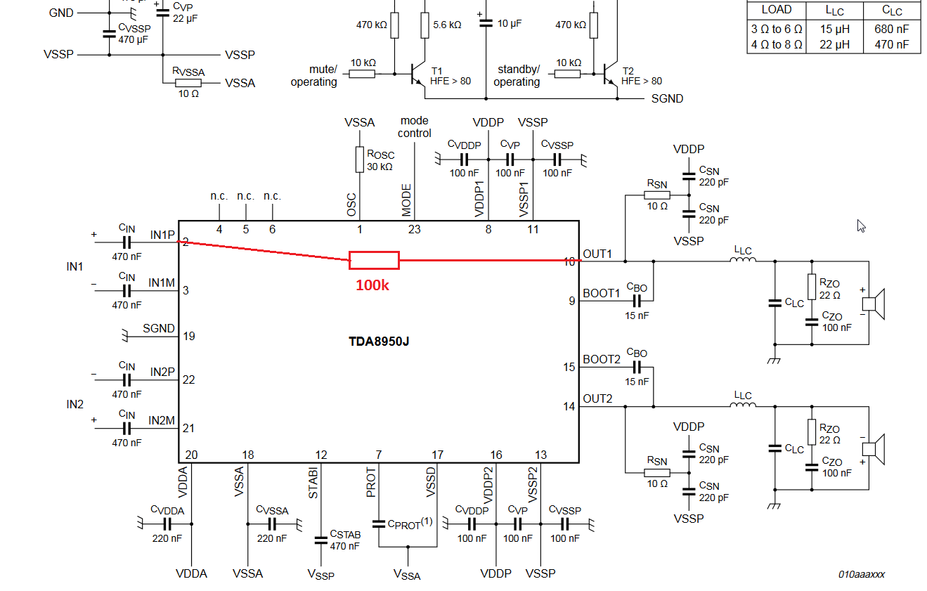

In parallel (not anti-parallel). OH, I didn't read carefully enough....board I'm using the two inputs are already wired in parallel. So I went with just two resistors.

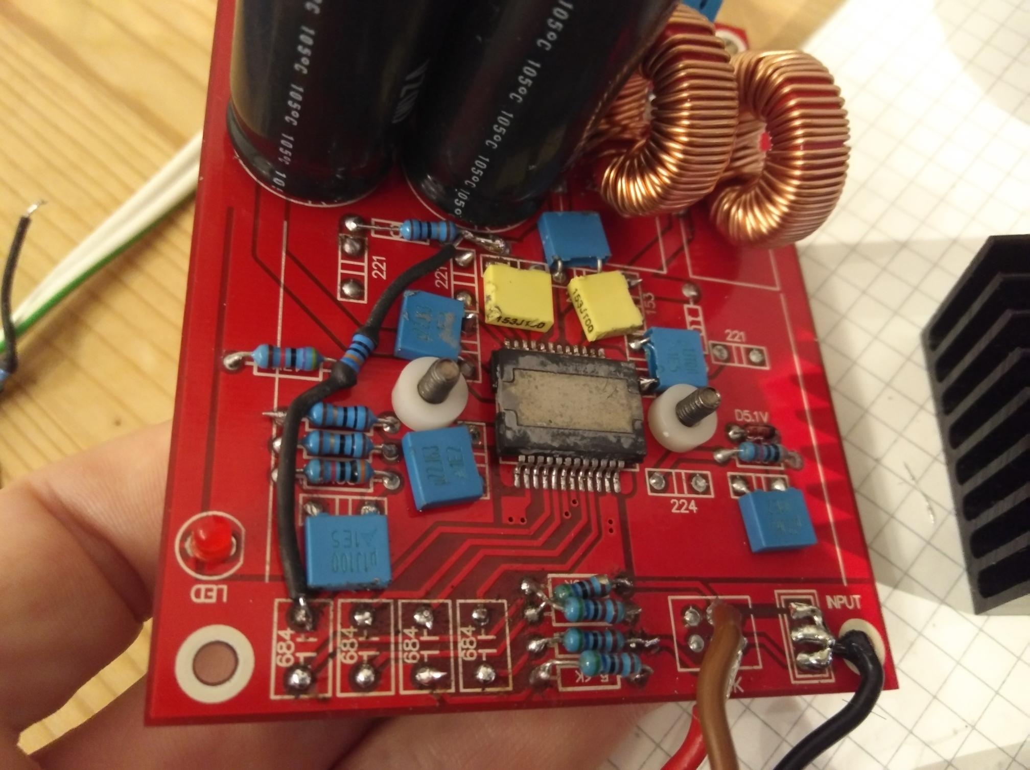

I have two of these cheap china modules (TDA8920 and TDA8950) and both have that annoying fuzz. The fuzz and distortion even got louder the more voltagy my toroid had. (less fuzz on 2x13V than on 2x18V) I already tried replacing the pot, different snubbers etc etc. nothing really helped. In my last attemt I tried as suggested earlier in this topic to connect out and input via feedback resistor AND IT WORKED.
Fuzz completely gone, Piano tones are 100% crystal clear. All audible ringing on the outputs is completely gone.
The only thing is: now the channel 1 is about -4db compared to the right channel. Fuzz and distorion is gone on both.
If I try to put another feedback resistor on the second channel, it does not work, the amplifier immediately puts out a DC voltage or the signal gets all crackly.
Attached you can see what I did.
can you tell me what I forgot or what I can do?

aha a good post here ... i too having the annoying buzz with my TDA8950 amplifier module. Dont mind can you show me how you physically modified the amplifier? i mean the add on resistor how you connected it? thanks
