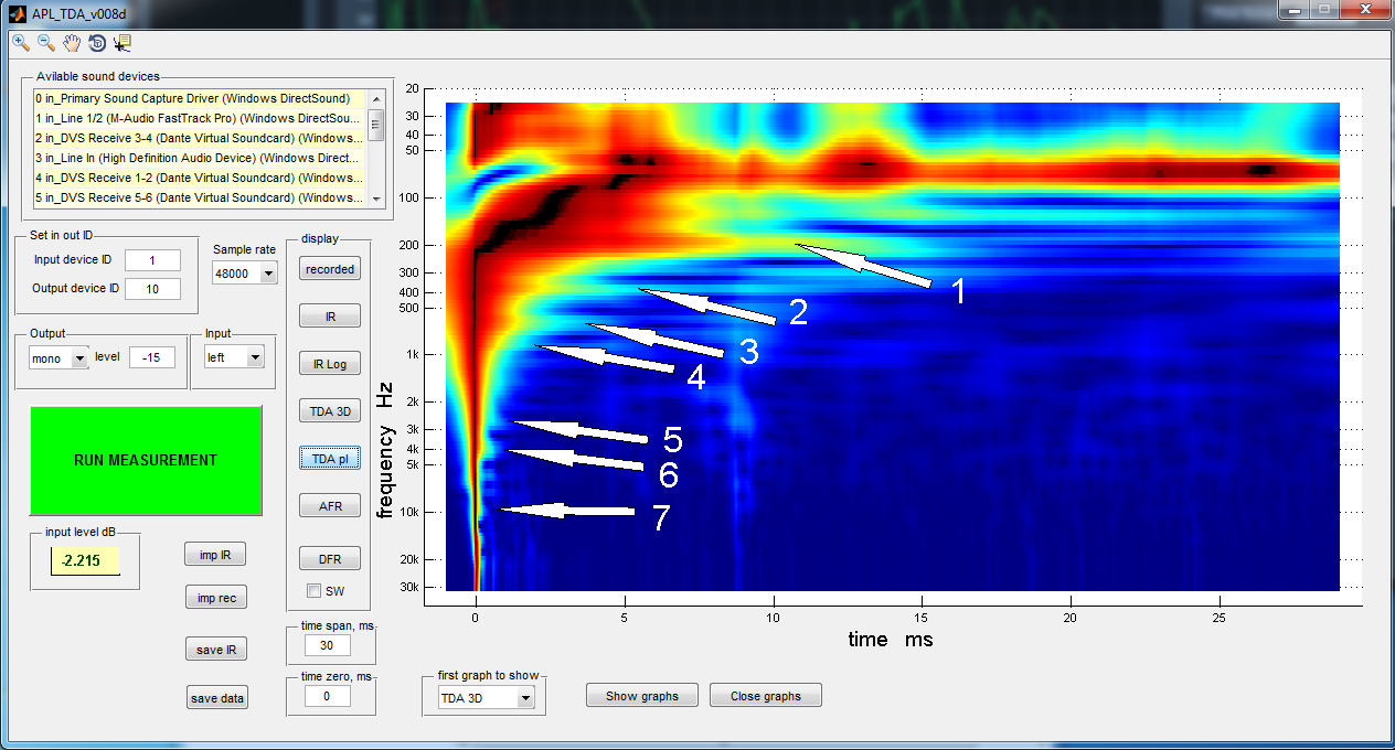

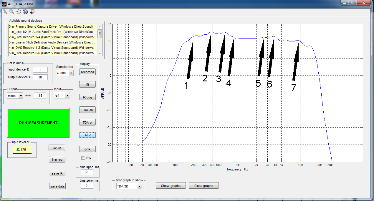

Than you may consider additional time/phase correction as it was in this example of tuning of Quested monitors:
delay estimation and measurement
The minimum phase correction is showing its beauty especially in LF where the main resonance of speaker is corrected in terms of an amplitude and phase as well by the negative group delay introduced by the correction.

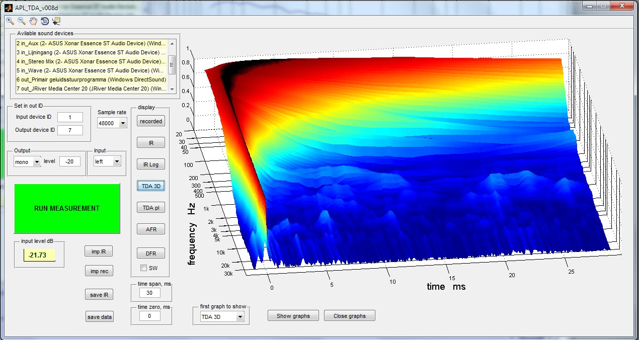

So I decided to take the plunge. I was a bit scared at first. What if this software would prove my DSP processing to be wrong. Anyway, I decided I could learn a thing or two just by trying it.
I started as usual, outlining my microphone in REW, making sure my mic is in the sweetspot.
The resulting Wavelet graph in REW:
Next I moved on to the demo version of APL. Installed the required software, including the Matlab compiler and ran a few tests.
At fist I did get odd results at 96000. So I decided to try 48000. My difficulty was getting APL to run trough JRiver's processing. Not the fault of the APL software, just needed to find out how to get it to work. If you look at the uncorrected graph, I was seeing a lot of that. Until I found the right key to get it to run trough JRiver's correction.

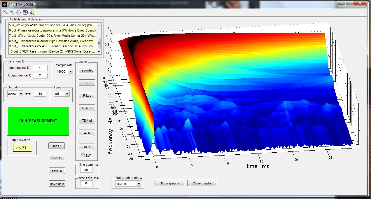

Once I got there, confirming the audio route visually in JRiver I got these screen grabs:

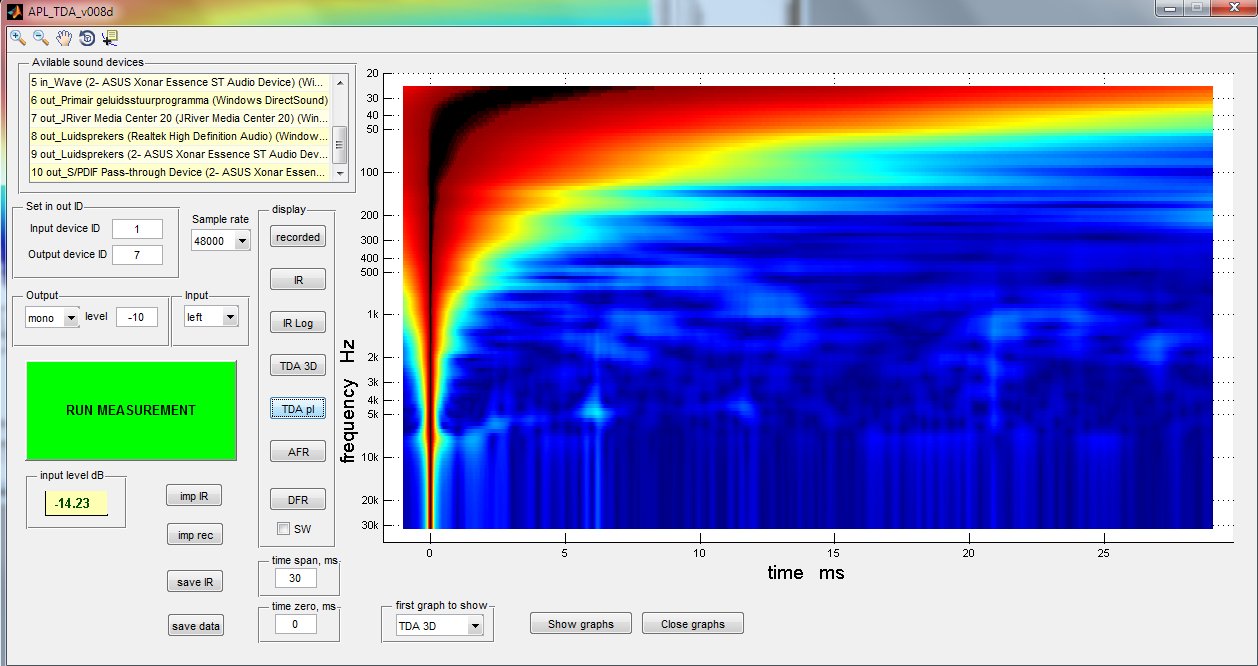

And in 2D view:
Mr. Raimonds Skuruls, would you say this is a reasonable result, now viewed in higher resolution? :)
I did already say I recognised much of my own priorities in your paper. A way of looking at this audio problem, actually. I enjoyed reading the discussion you had with Toole. I recognised a lot of it in my own rationale, where I differed from Toole's opinion. At least what he did make public in his paper.
I just used different software to get this, the stuff I had available to get me there. To me it does look like it works either way. As it should!
Even the listening impressions you quoted from a client(*) did sound very familiar ;). So I figured I should be alright running the Demo. Now you can see the minimum phase behaviour I spoke of at the low end. More pleasing than linear phase down to DC.
To show what my result is without my FIR correction:
I keep claiming on this forum this stuff really works, I hope more people do try it.

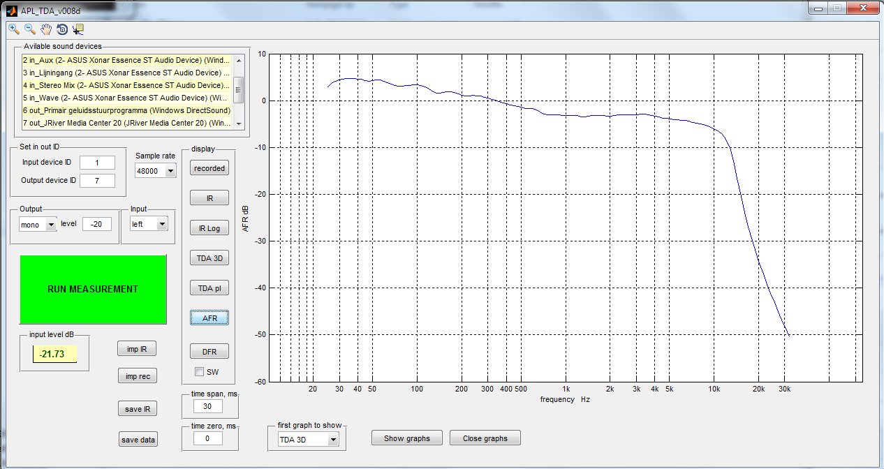

The AFR graph, new measurement:
524507d1452605945-room-correction-speaker-correction-what-can-we-do-dsp-power-now-availabl-apl_afr_wesayso.jpg

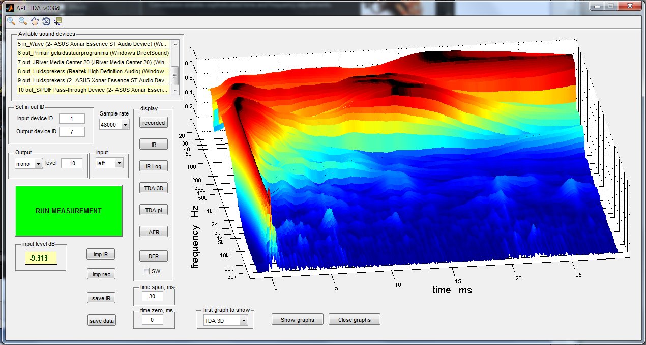

And the 3D TDA to go with that:
attachment.php
If you need any other view, I need to close down in less than 15 minutes. I have the setup stand by right now.

Those results look really good Wesayso. I stand by my earlier claim that the Two Towers are perhaps the best measuring loud speakers in all of hifi for "regular sized room use in far field when it comes to phase coherency, time accuracy, and low energy smear". Need all those disclaimers as Scottmoose will quickly remind us that a broad claim of "best" over all areas is not possible.
Well done!
