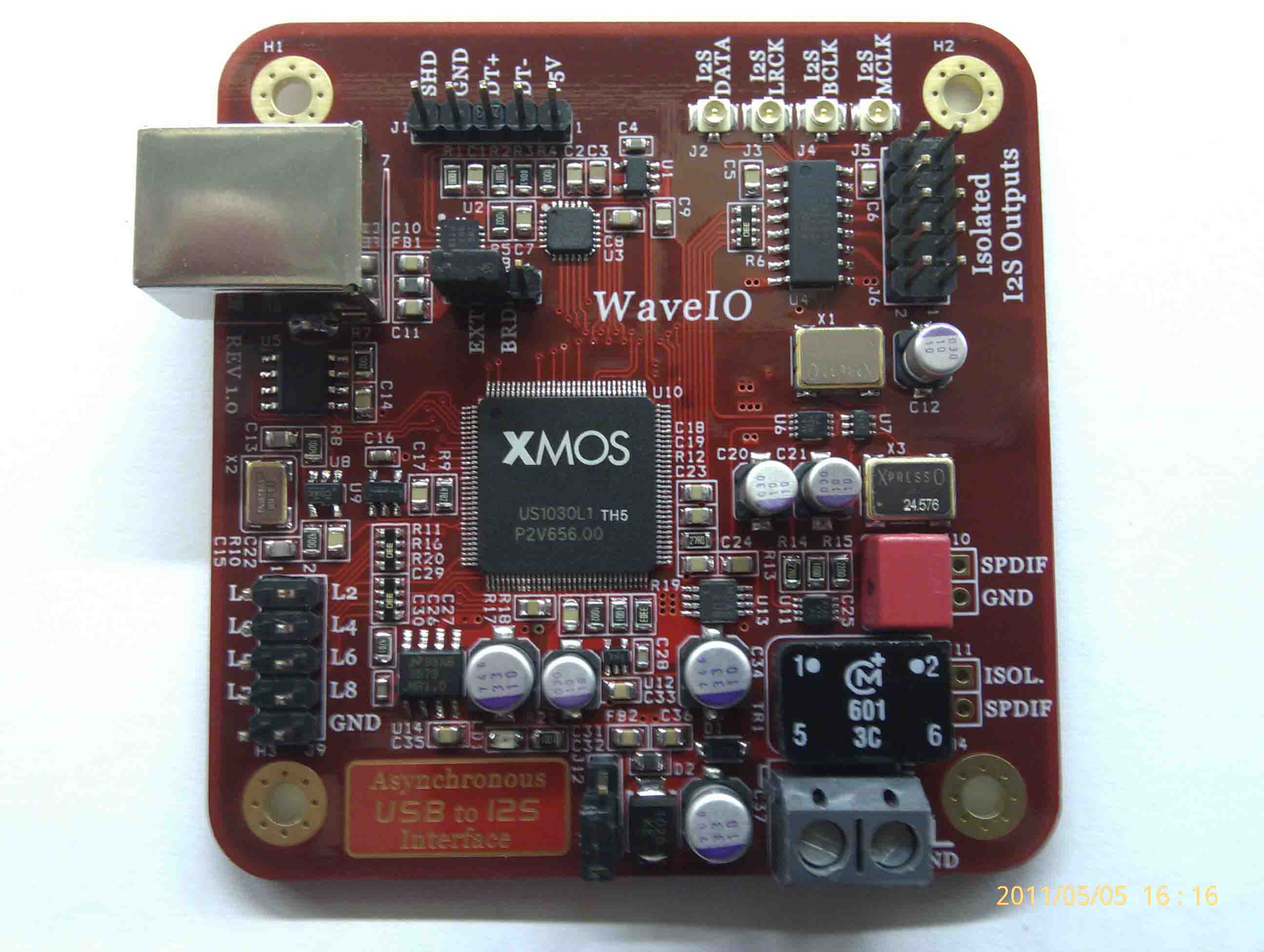

Hello everyone,
below there are pictures of my latest version of XMOS based USB to I2S interface. I've been working on it for some time now... drivers are from Thesycon and firmware from XMOS with slight changes to adapt it to my PCB needs. It's 2 channel, 24 bit / 192 khz with some improvements over XMOS' reference design:

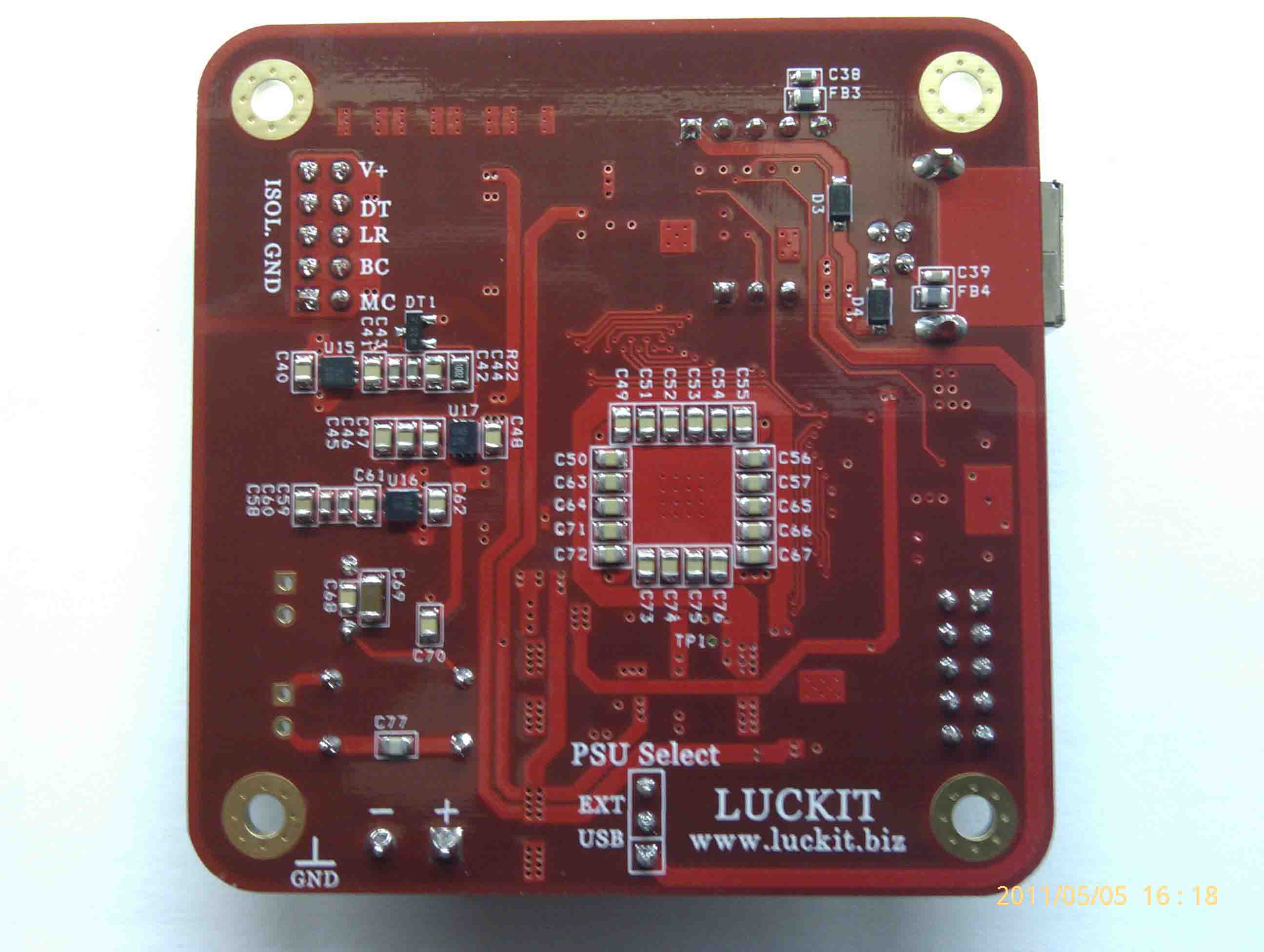

* 4 layer, gold plated PCB with 1/2/2/1 oz (or 35/70/70/35 um) copper thickness. There are a lot of vias to minimize the impedance.
* there are two USB inputs available: USB-B connector (mounted on the board) and 5-pin external header for something like this.
* isolated (using GMR isolators) or nonisolated (6GHz microBNC) I2S output signals.
* seven LINEAR voltage regulators are present on the card: every oscillator (and the ICs in the digital audio signal's paths) have its own dedicated LDO (the three chips soldered on the botom side of the board).
* Heavy decoupling all over the places, including OsCONs SVP electrolytics.
* USB OR external PSU. There's one green Power LED indicator on the board.
* SPDIF output signal at 1:1 trafo.
* Two LEDs can be wired to L7 and L8 pin header heaving the following functions: "Host Active" and "Audio Stream".
The oscillators are from Fox but I do have 7 pairs of ultra low phase noise NDKs available for assembling. I must admit, NDKs are very hard to aquire due to the long time of delivering (up to three months!)

A big "Thank you" Bunpei, mostly for your help related to NDK parts!
I think your design considers very well various requirements DIY users would always have.
Perhaps you are right! Though, I've choosen the parts that fits my requirements and expectations (like LP5900 for oscillators). Even if there is room for improvements I think this board act as expected. For now, I'm working on the decoupling networks, trying hard to minimize the noise on the board. It's not crucial but every DIYer have a paranoia :) = mine is mostly PSU.
Meanwhile, a friend of mine (also an active member on this forum) will make some tests with dedicated HW to this card. I hope he will have enough free time to draw some graphics for the two versions: with FOX and NDK oscillators. My goal is to use only NDK parts and replace other alternatives but you know how hard is to do this, mainly in small quantities.
I did listen to the NDKs mostly and I kinda like it: in the time spent trying to squeeze the noise out of my board by moding the cap networks.
Kind wishes,
L

Thank you barrows! Since this board is entirely based on XMOS / Thesycon work (SW speaking) you can see details directly on XMOS web site: "USB Audio Class 2.0 is natively supported by Apple OS X version 10.6.3 and above. Support for Windows is provided via XMOS partners, Thesycon and Centrance. The drivers are configurable and provide support for WDM/Direct X and ASIO 2.1."
Power consumption: I've made few measurements and this board will need at least 5V / 430 mA @ 24 bit / 192KHz to work properly :p
Though, Fox oscillators are consuming up to 8 times more power than NDKs, there's NO switching Vreg there and speaking off... this board have plenty of them. I must confess that the "no compromise" ideology regarding PSUs must come to an end soon otherwise ordinary USB ports will start to complain about power requirements.
I like your LiFePO4 PSU suggestion and I'll definitely implement it. My real job has offered me few pleasant surprises like these rechargeable batteries pictured below (used in some sort of hybrid/electric cars - I don't recall manufacturer' name). I've mistakenly short circuit one of it and I saw what they are capable off :warped:
Kind regards,
L
There's allways the external PSU option... though for all the tests I've used the USB 5V supply.
According to the specs, Idd for one oscillator is stated up to 35 mA for freq. between 20-50 MHz, please see here. There are two pcs. on that board: 22.5792 MHz and 24.576 MHz. One more reason to switch for NDKs.

Haha is that the ultra-low impedance high-current PSU for your board in the background? ;) Nice pic.
More seriously I'm really surprised that its taking so much current, given what's in that XMOS document. I must have overlooked something major to be more than 6dB adrift in my power consumption estimates. You're using the single core XMOS right ? (128 pin package, as opposed to the dual core which is 124pins ?) 35mA for two oscillators (presumably you disable the one that's not in use) doesn't account for such a difference.
Well, most of it... ~3.3V x 2 pcs. will be enough to blow away this card :)
Back to the power consumption, first thing to notice is that XMOS chip on my board is TH5 (500 MHz) variant. In addition, my ampermeter reads on 1.0V core PSU: 231 mA at full load (24/192) - though is not a precise one. Considering the fact that uP is warmer (even if the chip's thermal pad IS soldered on top and the board is a 4 layer one without thermal reliefs on vias underneath the chip)... I can only assume that it's working at its full capacity.
Though, I'll switch it with 400 Mhz variant or... better, I'll assembly another board around this chip.

Finally, after five insane days servicing air conditioning systems for cars, saturday got some time to play with this card....
Wishing to get rid of any additional source of EMI and switching noise, I choosed (for 1.0V core PSU) the NI LP3879 Linear Vreg. instead of ON-semi NCP1521 1.5MHz DC-DC converter part found on XMOS' reference board. Even if the later one have efficiency up to 95.3% - it's still a switching one.
Taking into consideration the I/O architecture of the XS1-L1 chip, the I2S signals comes directly form it thus it is not necessary to realign these signals to the master clock using FF. Even if XS1-L1 have two sets of PSU (for core and for I/O) I could choose DC-DC converter insted of LP3879 to power up the core and a better Vreg for 3.3V I/Os. Still, all the data processing happen in that chip thus noise can easily propagate. Moreover, that package is big enough to make you think harder at impedance and ground bouncing issues. So, for the sake of I2S signal's integrity, I thought it's better to replace the DC-DC converter with an linear vreg and minimize the noise as much as I can even if the later one is less efficient and comes with a higher price.
BTW, the current rising after replacing the 400 MHz XMOS chip with 500 MHz part was negligible... both works flawless and at the same temperature.

On the other hand, I'm thinking on a improved version of this board: better PSU will be a "must have". Any suggestion are welcomed!
New Board...
Lorien, I guess you are considering a new design to further optimize the power supplies, perhaps? If you mandate an external supply, then I would suggest that adding a shunt regulator to power the clocks. A TentLabs part might be appropriate here, as the high bandwidth, low noise, and low output impedance should allow the best performance of the clocks.
