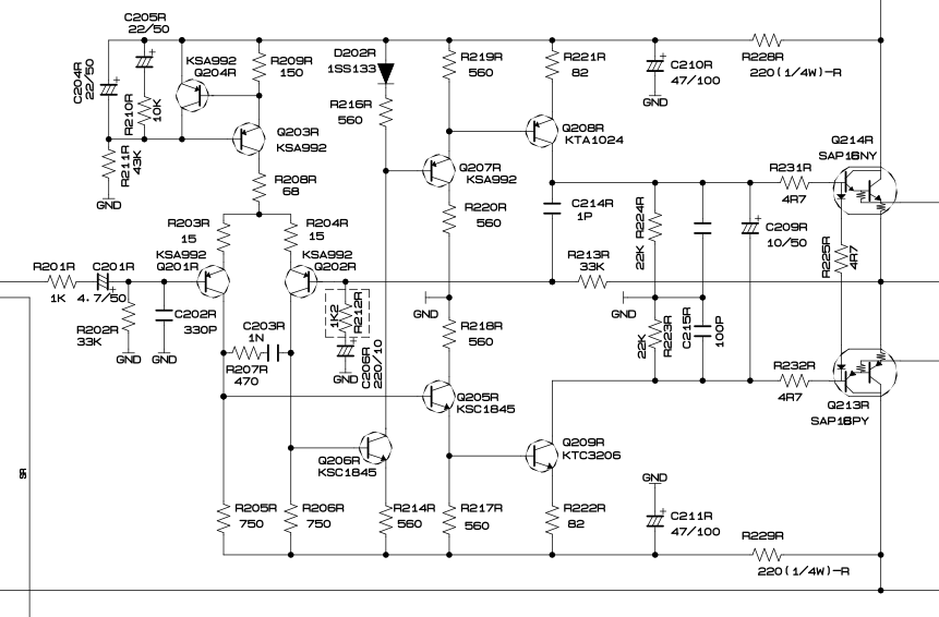

commercial products (brand and model number), that use adjust-free Class AB power amp sections still wanted (e.g. with the help of TDA7250/LT1166)
the Marantz SR-5200 receiver ties the thermal sensing diode string of a Sanken SAP15 pair together with a fixed resistor. No bias adjustment. Seems to work pretty well, but most likely under biased, to be safe and sure.
I was thinking of placing a red LED between the diode string for a stable constant voltage drop, and let the diode string do the thermal adjustment.

No. Except if one can guarantee that the constant current through the chain of all diodes don't deliver tolerances/spread effects.
But the purpose of a servo is just, that certainly values of tolerances, which are always present, have no effect on the quiescent current.
An adjustment variable resistor must be still present. But after choosen the value for idle current through the output power stage this must be absolutely constant under all conditions (ambient temperature etc).
By commonly circuit concepts (VBE MULTIPLIER) I must repeat the adjustment several times, that is horrible for me
I know it is "better" to be able to adjust it. But Marantz chooses not to with above schematic. There will be tolerances, but if one keep the system under biased, so that in worst case the highest to expect bias level due tolerance difference is still below the maximum acceptable level, it can work. But one must accept a mostly under biased output-stage. The diode string will compensate for temperature tempco.

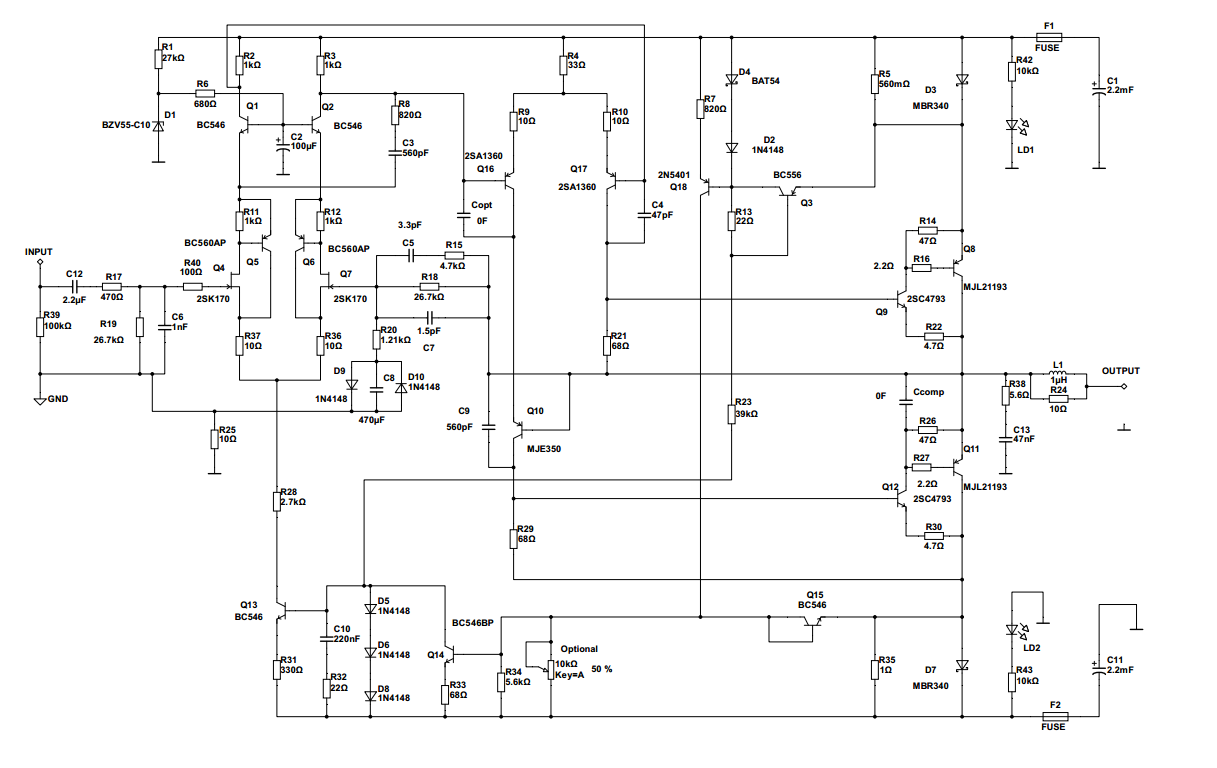

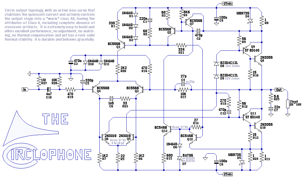

an additional bias servo approach, that looks very interesting
http://www.diyaudio.com/forums/solid-state/81436-william-t-chater-power-amp.html#post2562916
http://www.freepatentsonline.com/5055797.pdf
and post #40 about
http://www.diyaudio.com/forums/soli...tter-audio-non-complements-audio-power-4.html
but obviously there are very few adjustment free commercial amps; I am still looking for such audio amplifiers.
