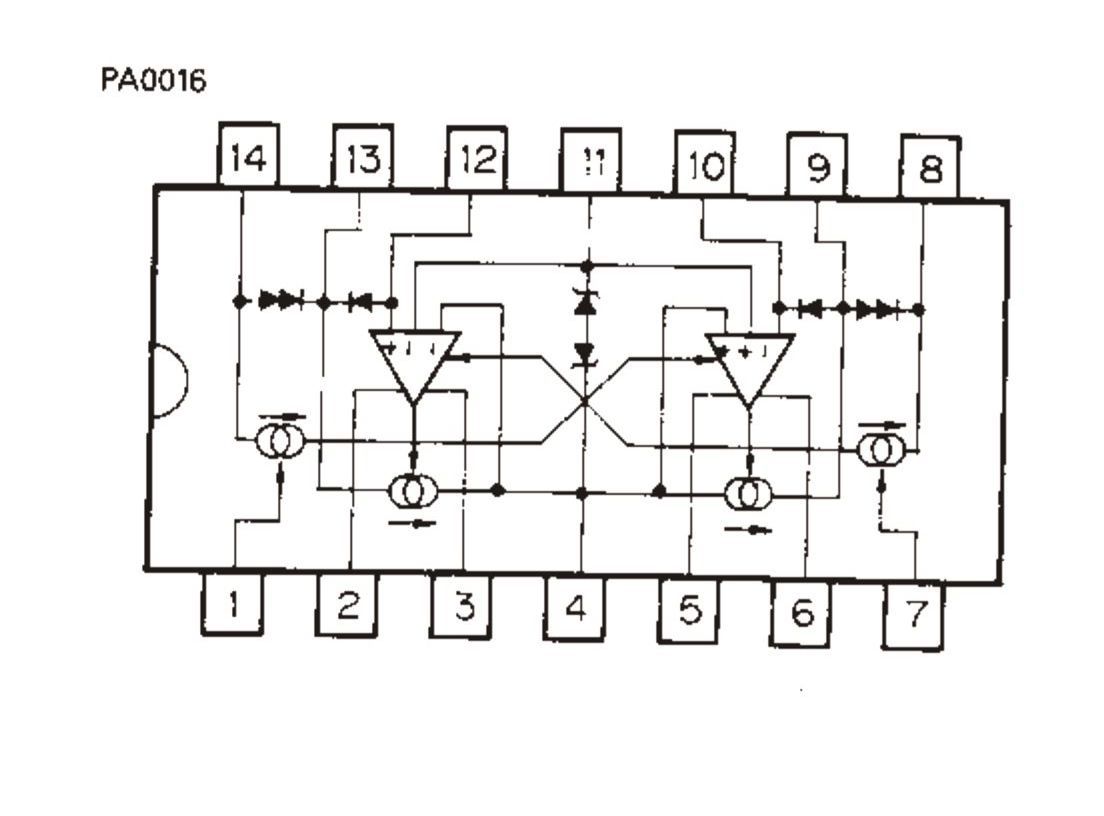

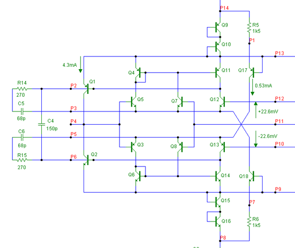

By chance I have discover various BIAS servo IC's like Pioneer's PA0016 - go to
Предложено На Форуме - Страница 2 - Усилитель мощности А. Лайкова - Форум по радиоэлектронике

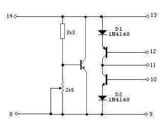

Are the internal circuit from the attachment well suited as a replacement for common vbe multiplier? Or should I prefer one of the other showed designs (JVC's VC5022, ROHM's BA3122N or one of the discrete design's) ?
What are the pros and cons of each ?

Thank you very much for advices.

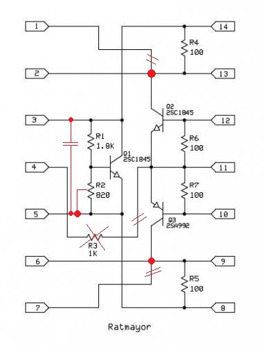

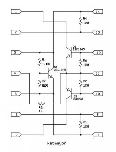

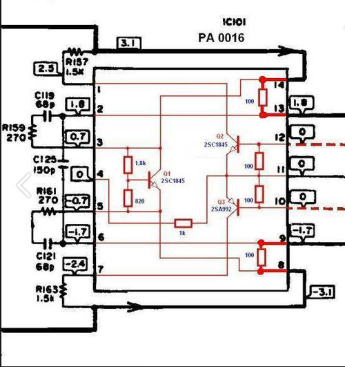

PA0016 clone:
RT22.RU Радиотехника 20 века, форумы • Просмотр темы - Микросхемы Pioneer PA0016

A colleague, who was no slouch, failed to get the LT1166 from oscillating into some loads. A lovely idea, but it had issues.
I successfully adapted Mr Gevel's approach from N FETs to complimentary triple emitter followers. It instantaneously set up bias, was non switching and halved THD at HF (the crossover residual) on and already clean amp. 8 biploars and some passives.
Reactions: MarcelvdG
I worked with them for a while, and finally gave up. Smarter than me,
Bob Cordell doesn't seem to have been happy with them either.
:snail:
It is quite easy to do with discrete matched pairs of transistors. The 10:1 ratio LT1166 has takes more parts, so I changed it to the constant sum of 2 exponents. The quiescent ends up a little higher than optimally biased class B, but the zero switching and smooth transition seems worthwhile, along with the zero settling time in production. Also you can remove the emitter resistors and use collector resistors to sense the current if that takes your fancy.

No no sir. Mr Gevel maybe on your level, but I merely get inspired from those who are around me, and re-arrange things until they work and sound better...
I have a couple of other versions, including a rail to rail one using p-channels on the positive rail and n-ch on the negative. I haven't built that one yet. Young engineers appear to be scared of the 3 legged devices, and it was vetoed on their protestations.
