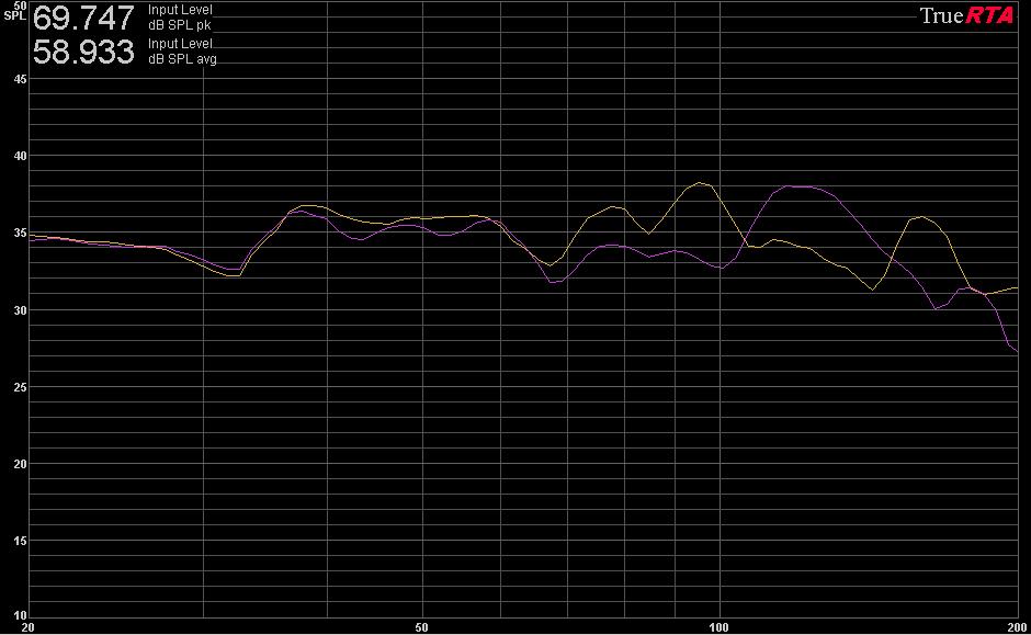

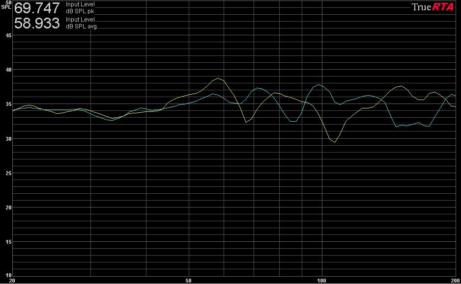

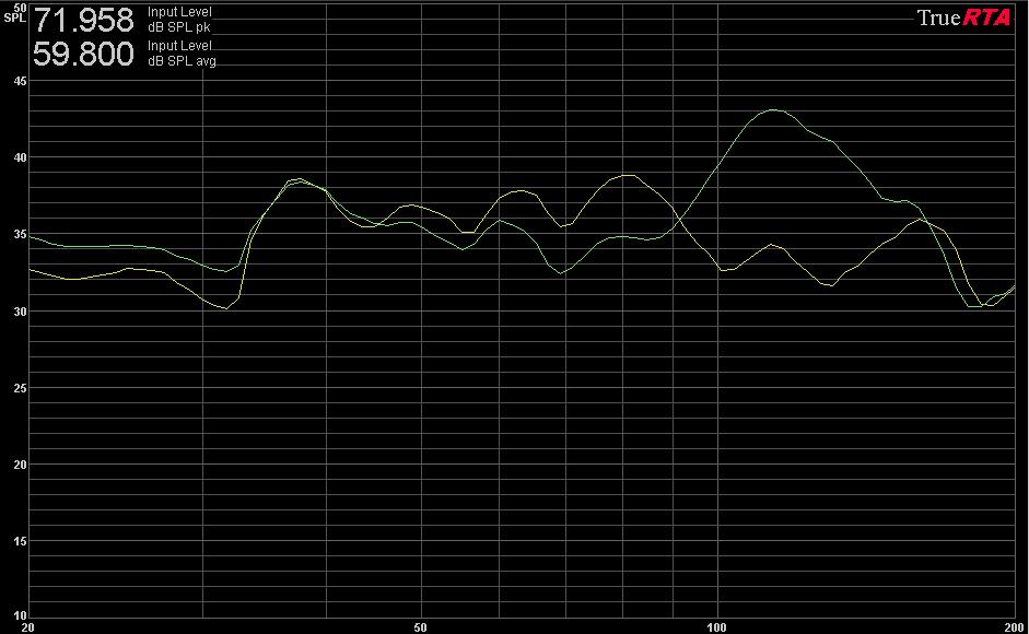

Count me in the multiple monopole club as well. I took some measurements today to show why :). In my listening room, I've got one main couch with 3 seets as the listening positions. I use TrueRTA (easy) in 1/24th octave mode with pink noise, spatially average over 5 measurements in each listening position corresponding roughly to the two shoulders, the chin, the top of the head, and about six inches above the knees of a listener, and then 1/6th octave smooth that average. I believe this gives a good picture of what is going on. The graphs below show the left and right channels summed with the subs, 4 ported 18s located around the room (after some guessing and a bit of trial and error). Note they are 20-200 Hz and the vertical scale is 40 dB. There is 1 band of parametric EQ applied and the subs are mated to the midbasses at 80 Hz.
Listening position 1:
