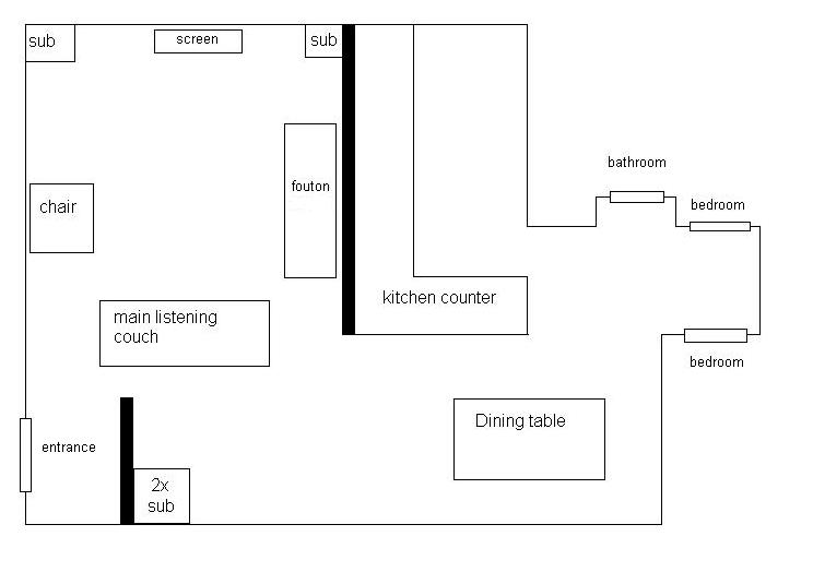

However the measuring range seems too narrow for my application I'll need constant response over a wider range than a couch, say, maybe 10 seats, or simply walking around within a few steps.
There's no reason why you wouldn't be able to do that. In order to get the responses above I placed the subs so that they excite the modes in the room in a very "complimentary" way. I could slide the couch back a little, put another one in front of it and adjust things a little to get a similar response over 6 seats. When I first started messing around with this I didn't have any furniture in the room and measured a large grid of responses for a few different sub placements to try get a feel for how things worked... obtaining a consistent response over a large area is definately possible. The only way I've ever been able to do that is using multiple subs... not directional subs.
It's actually a very convenient layout. The room is an awkward shape... it's an apartment where the living room, dining area and kitchen are all one meandering area, but it does behave somewhat intuitively. A (crude) drawing is attached. The "guess" was that the main listening area behaves modally somewhat like a rectangular room, and thus I have the subs arranged to take care of all the modes in the two lateral dimensions except for the even order ones in the long direction... the only one that matters (2nd order) ends up being at about 45-50 Hz and that is the EQ I have in place. If I flip the phase on either the front or back they drive that mode with opposite polarity and it isn't a problem but then the odd order modes get driven in phase so I get a nasty peak down low and at 70 Hz. With the subs in the back, there is some sort of modal behavior with the dining/kitchen area but it doesn't effect the listening area too much... mainly there's a slight side to side variation in the 20-30 Hz region where the main listening couch is. If you move it forward a few feet the effect goes away pretty much entirely. The response is not all that good where the fouton and chair are, but I don't care... they are located where they are for (1) damping near a boundary and (2) providing a "social" layout. If I was going to do a theater I'd probably do two rows. The next step is to try some more LF absorbtion to further smooth things.
Oh, and they are mono; I don't see much point in stereo bass personally... I have a hard enough time getting one channel smooth and consistent over a listening area.
