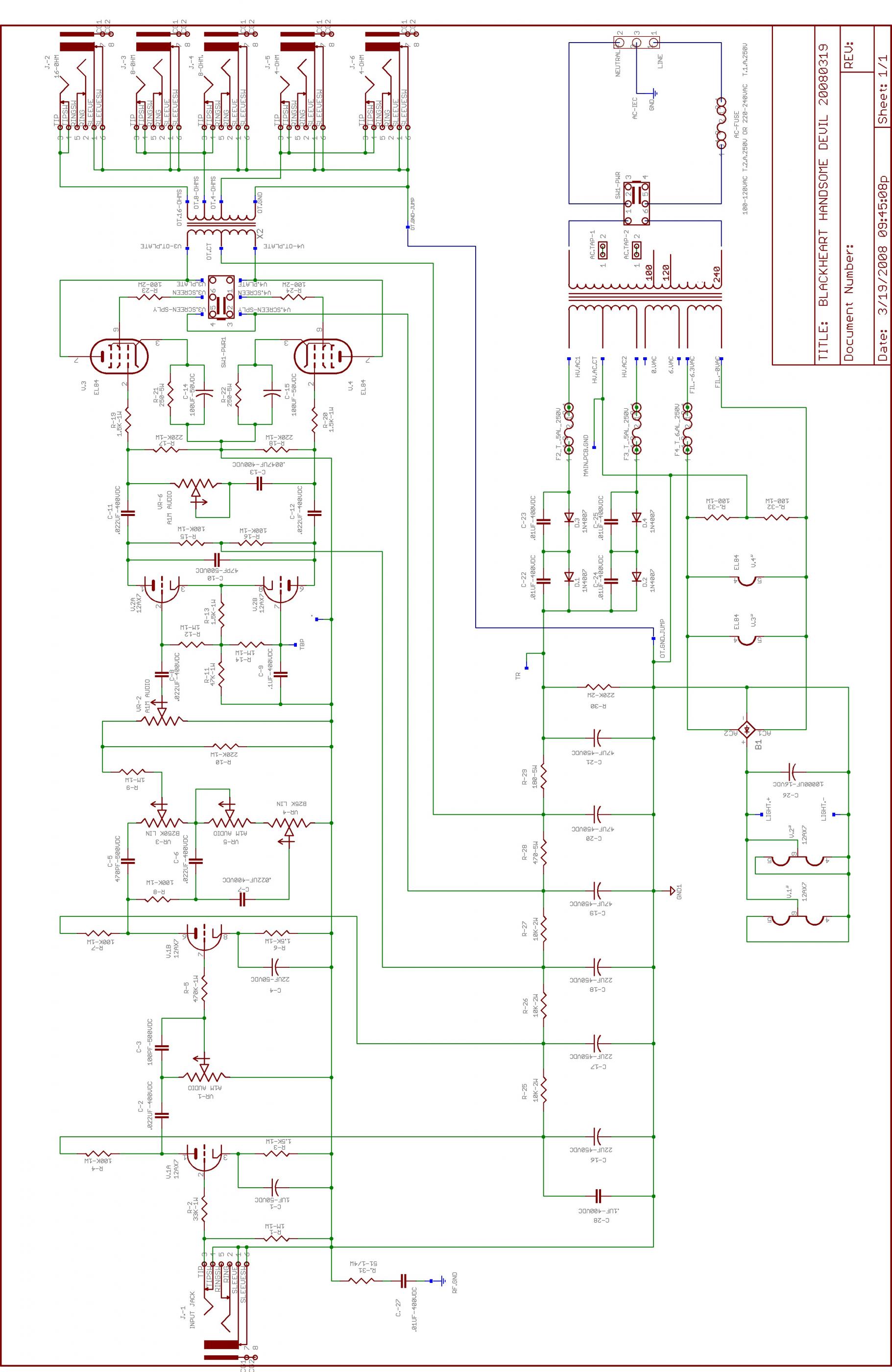

tube amp (BHHD-15) power supply/electrolytics
greetings ladies and gentleman...
i've done a deep research regarding capacitors on the power supply and other stages within the tube amp, to understand the role of larger capacitance electrolytics and the options to swap them out when recap time comes by;
the most reasonable approach when recapping with the same specifications electrolytics is not an option, is the following answer:
-there is no generic rule, it depends on the circuit design;
so... as attached, the diagram/schematic of the device is here for analysis and here goes the question and this topic subject:
when replacing the electrolytics for MK-types rated for run, with voltage tolerances above or equal to the stock electrolytics, how lower can i go for the capacitance, since some electrolytics are rated for 10.000uf and i don't want to parallel many motor run caps to achieve that sum?
(i am aware that lowering the capacitance will introduce some effects such as sag, decreased bass response, but anyway... how lower can i go on the capacitance?)
much thanks
ps: i've already reaped the c1 and c4 electrolytics and installed 1uf MKT blue bricks @250v on each spot... since c4 was originally 22uf, i thought it could change much, but i confess the device is running much better now, but what about c14, c15, c16, c17, c18, c19, c20, c21 and c26?
Substantially reducing the value of a cathode bypass capacitor will cause the gain to drop
significantly in the bass. The frequency where it starts to drop is 1/(2Pi x R x C).
The amount of gain loss depends on the particular circuit.

thanks, i had read some theory about it before and now that you've said it then i'm more confident that its a fact, if not much to ask, what could you tell me about lowering the power supply caps and the infamous c26, rated for 10.000uf (at least i've seen 10k micro, but i might be wrong, who knows eh?)
the c14 and c15 @100uf are the coupling ones or are they bypass caps? how lower can i go within desireable audible range?
Are you talking about a 10uf cap or a 10,000uf cap? I see nothing remotely as large as ten thousand microfarads in this amp.
isnt c26 10000uf? im lost now ;_;
isnt c26 10000uf?
Yes, C26 is (10000 uF). However, C26 has nothing to do with the audio signal going through this amp; the only thing C26 does is provide DC for the heaters for V1 & V2. The other heaters in the amp are fed with AC.
With a passive, unregulated power supply, lowering the supply capacitor values could cause
low frequency instability (motorboating), increased hum and noise, and phase and amplitude
aberrations in the bass. You might prefer the sound with film capacitors of similar values, though.
Lowering the C26 would cause more ripple voltage on the filaments, and more noise and hum.
I've seen as low as 2000uF used for this function, but use 10000uF myself.
C14 and C15 are bypass capacitors for the EL84 cathode bias resistors. Reducing their values
would again reduce the gain in the bass by the same formula. They must both be the same value.

so i could lower some stuff to 20-30uf, but c14, c15 and c26 demand exact values for a decent operation, of which leads to ponder that tube related filters such as bypass and heater filament need a higher, tighter tolerance to designer's specs, but the power supply ones can take a little drift downwards with the negative side effect described as 'sag' if not going lower than 20uf?
of course, with the exception of preamp/ecc83 triodes as our friend Gnobuddy said and i also previously tried and related on first posts, regarding the c8 22uf into 1uf, with great results
much thanks
downwards with the negative side effect described as 'sag' if not going lower than 20uf? regarding
None of these values have to be exact at all. A larger C26 gives less hum.
For C14 and C15, much smaller values (but still kept equal) will reduce the
lower bass, but with film capacitors instead, you may prefer the sound.
The C8 and C9 are 0.22uF (22nF) coupling capacitors, and can be made smaller
(but still kept equal), with the same reduction of low bass.
sorry i meant c4 22uf electrolytic that i've already decreased to 1uf
the c8 and c9 are currently blue block MKT of the same specs as original (22nf)
it seems that for c26 its gonna be either the good 'ol 'lytic or a regulated psu...
intresting fact that i didnt know... c26-wise, would it be any benefits in putting another 10kuf in parallel or swapping in a 20kuf if theres any easily available?
for heater, putting in parallel one really small mica, lets say 10nf or some 1/10th of the lytic (1uf or 2uf MKT) would improve anything on the tube performance, or the quantic relationship between high frequencies and the filament could cause microscopic vibration that could lead to undesireable effects such as feedback/noise/microphonics? if so, the high ESR of the electrolytics could be a plus on this application. if the answer is yes, i dare asking if some pio cap in parallel or inductor in series could tame even more this micro event;
or could the high frequency be good for the heater?
... or... the heater filament is invulnerable to mechanical tainting?
At some point, increasing C26 will increase the noise, due to the charging pulses getting
higher and narrower. The diodes could be stressed as well.
Why not try the small cap and see? It shouldn't hurt anything.
