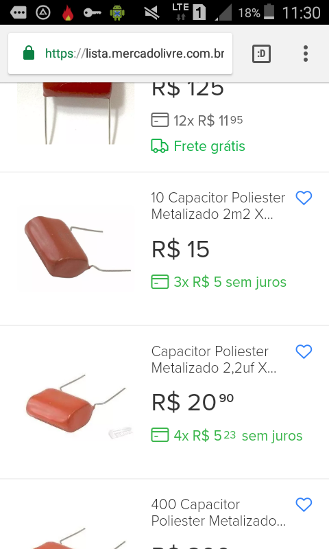

thats a good idea, i've found some that are similar for around $1,50 BRL each... pretty cheap and seem to be a better choice over the big motor run caps, of which cost +- 5x more;
question: between the motor run and these caps in the attachment below (metallized polyester) will there be any real difference if installed properly on the bypass and power supply stages?

about the multilayer ceramic caps... i've never seen those in Brazil;
