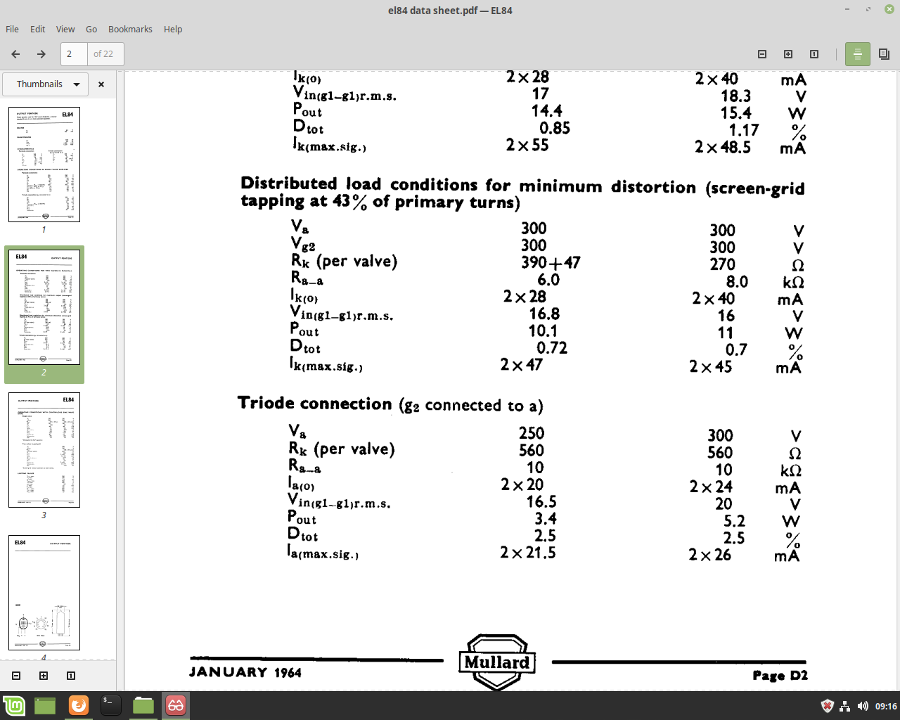

I've built an EL84 P-P in UL (7.6K OPT)
It is cathode biased and has a 270ohm resistor per tube, B+ around 310-315V, giving 35-39mA bias per tube.
For converting this amp to Triode (without replacing the OPT), do I need to increase the cathode bias resistor from 270ohm to 560ohm (per tube)?
A high-level explanation on the reasoning would be helpful too :)
Going off of the attached Mullard EL84 datasheet.
P.S Amp is a Tubelab SPP but question is generic.
The datasheet gives you Rk values for ultralinear ("distributed load") mode in class A and for triode mode in class AB. Hence the difference in Rk (and in quiescent current) for the same plate and second grid voltages.
If you're OK with like 3-4W output in the class A triode mode, you can keep Rk intact.
If you want more watts, you'll have to bias the amp for class AB, increasing the Rk and decreasing the quiescent current.

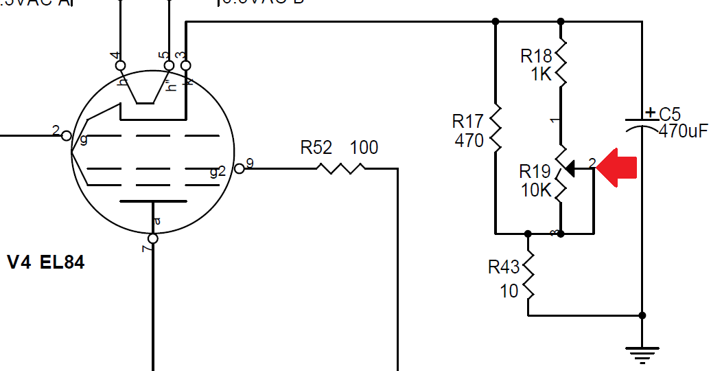

DIY TUBE BIAS SCHEME
The DIY Tube Dynaclone (no longer available) used an adjustable cathode bias scheme to optimally balance the current flow through the output tube pairs. I've used this on a few EL84 amps and it could be helpful for cranking back current flow in triode mode too.
S.
The required Z pri for triode connected valves are usually higher, see attached. For your B+ etc a Z pri of 10k is recommended. Using a less than optimum Zpri will alter power out,THD etc.
