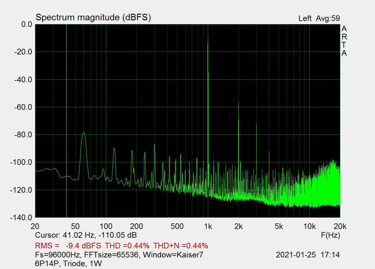

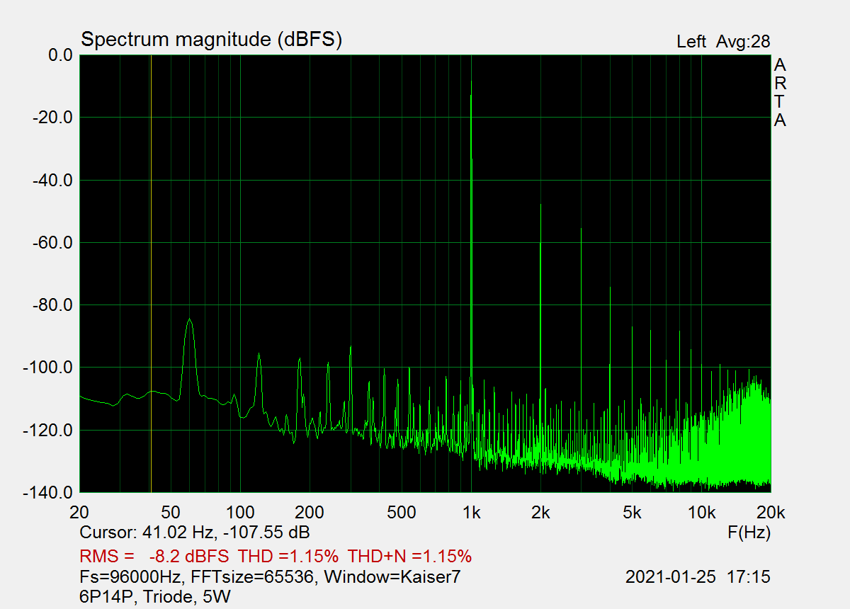

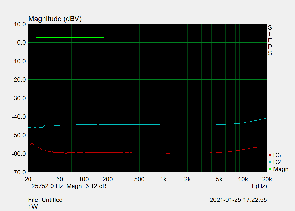

Lastly, I was able to run some measurements with both the 6P14P-EV and Hammond labeled Amperex Austria tubes. ECC81 are Mullards Blackburn. Wired as triode, still with gNFB from when it was wired as UL.
Max output was around 5W, frequency response pretty flat.
Attachments are FFT at 1W, 5W and FR at 1W output (2.83V across 8ohm resistor)

I wonder if you can rerun the FFT's with no feedback (in triode) for my own curiosity? I am not set up to do such tests and to me no feedback sounds better.
I have decided to get setup to do this type of measurement so no need but thanks if you were considering it.
