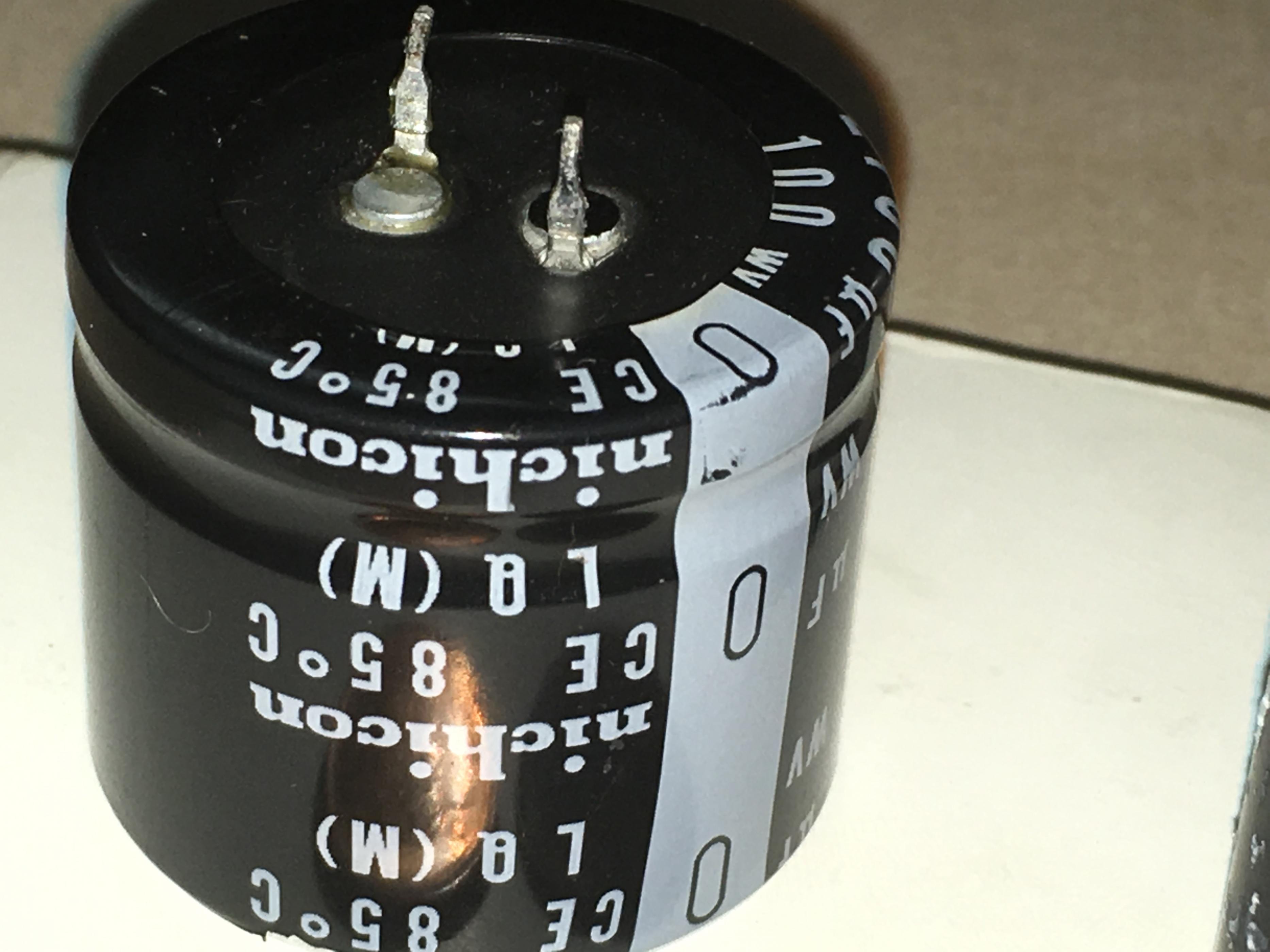

I was hoping to get some help choosing capacitors for this amplifier.
I will try to include some pictures of the old capacitors that I have already removed from the circuit board.

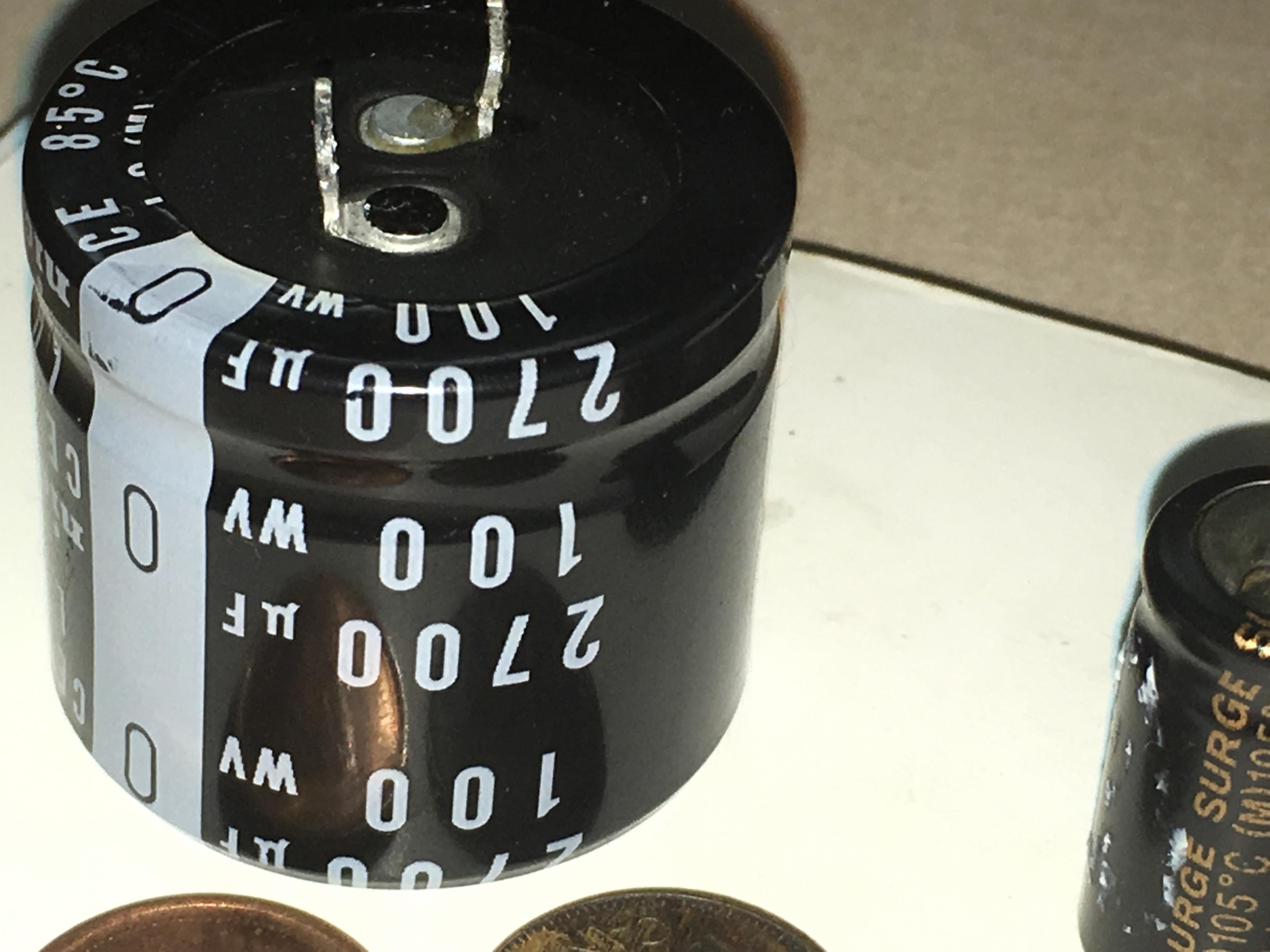

I have removed all of the aluminum can type radial electolytic capacitors.
There are 20 capacitors in total, and here’s what I know about each group of capacitors:
4-large snap-in caps- Nichicon LQ (M) CE 85’c 2700uf 100wv 35mmX30mm
6-medium caps- Surge 0114T (M) 105’c 330uf 63v 13mmX24mm-5mm spc.
10-small caps- Nichicon B0145 VR (M) 85’c 100uf 25v 5mmX11mm-2mm spc.
Through searching the Internet I have been able to determine that these caps are obsolete.
I think that my old 2700uf caps are referred to as the now obsolete LQ series. But...as best I can tell there is a cap on a vendors site with part# - LLS2A272MELC that I think fits the specs of my old caps very good. LS series.
I will get those and that takes care of my 4 large capacitors.

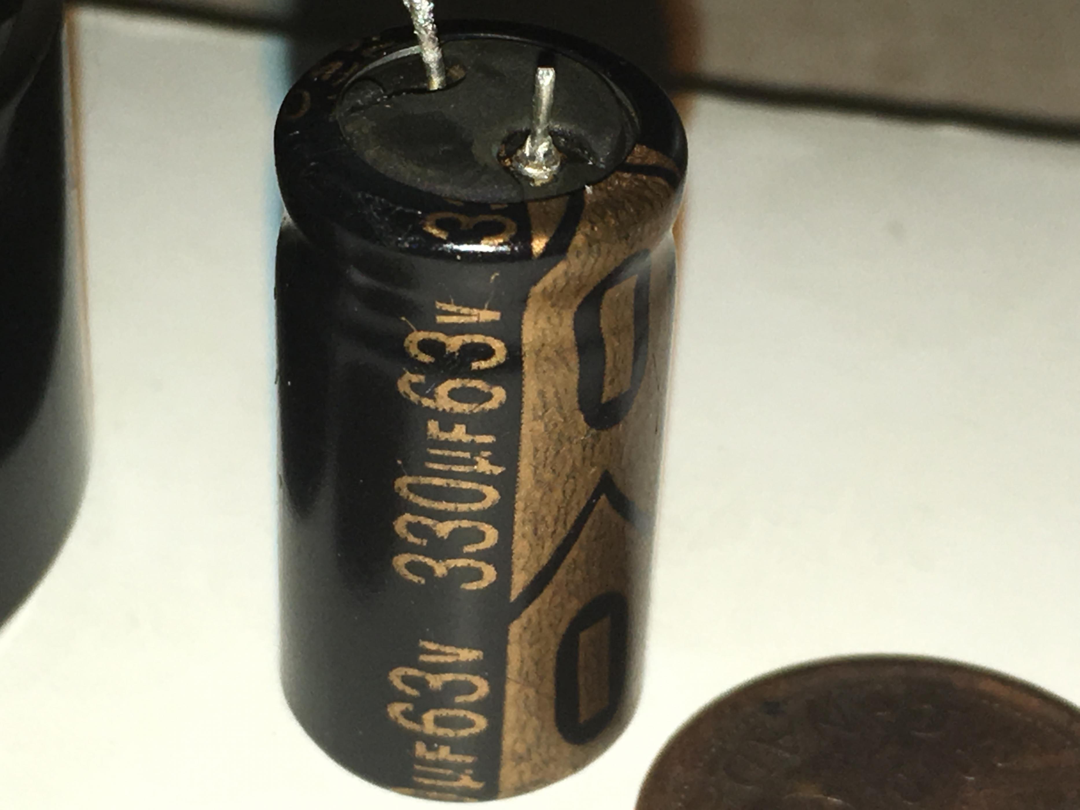

Next are these Surge 330uf caps. I have so far discovered that it is impossible for me to find any further specifications on these beyond what is printed on the outside of the capacitor jacket itself. I have even phoned and talked to someone at Surge components to try to find out more about these. This number 0114T that I gave her is apparently not their part#? She even tried to deny that this was a Surge capacitor, which I thought was strange. I sent her an email and pictures of this cap and the amplifier sticker/info. and she was supposed to get back to me but she has not as of a week later.
These 330uf caps are what I need help replacing.
I would like to stay as close or better than the old caps for replacements. I tried to find the Nichicon audio specific caps but the place I’m getting them from only have those in 85’c temps., as well as trying to match up the rest of the unknown specs is futile since I have no idea what the old Surge capacitors specifications are?
I seen some Panasonic FR series that looked close to the same size and 105’c but again I am stumped on the replacement specs.
I also saw FC Panasonic caps but these Panasonic caps are NOT audio grade caps? Do I need to worry about that? It looks as if people like these caps?
This is a mono amplifier and will obviously be used to power subwoofers if that makes a difference?

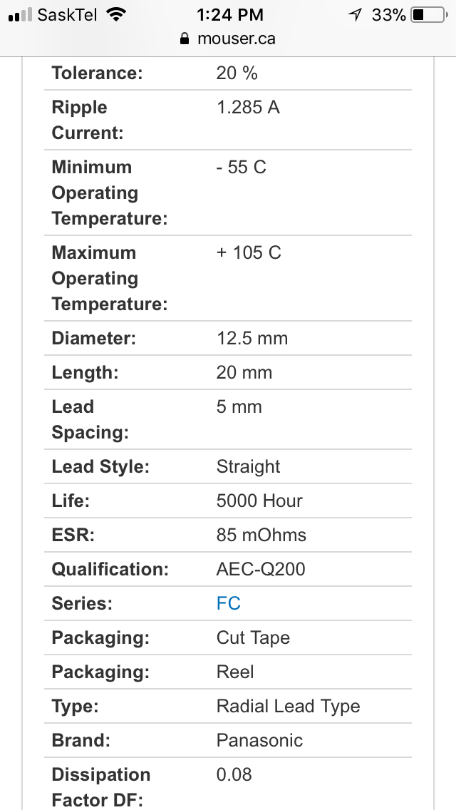

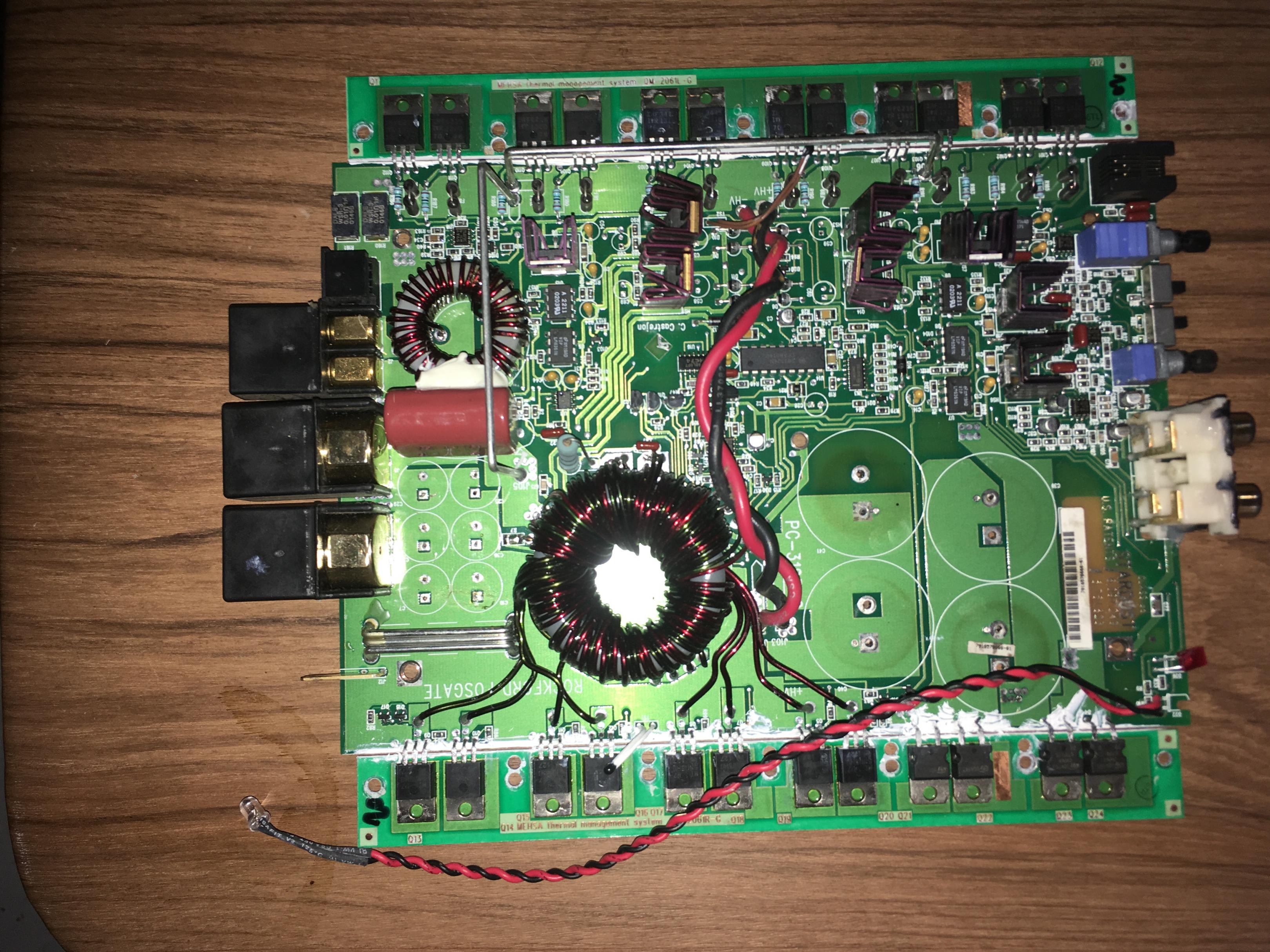

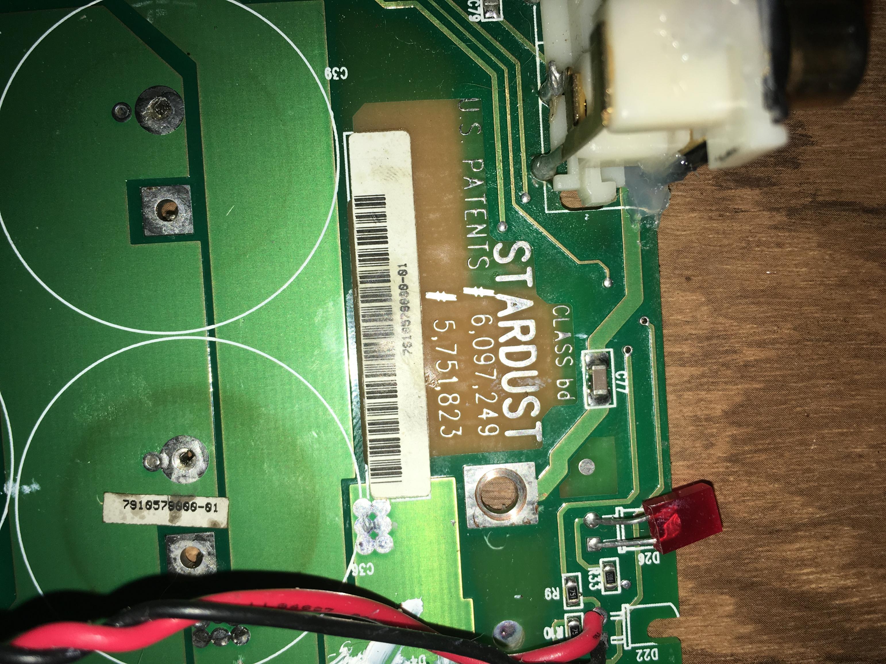

Pictures1
Pictures of the amplifier and the Large 2700uf 100v capacitors.

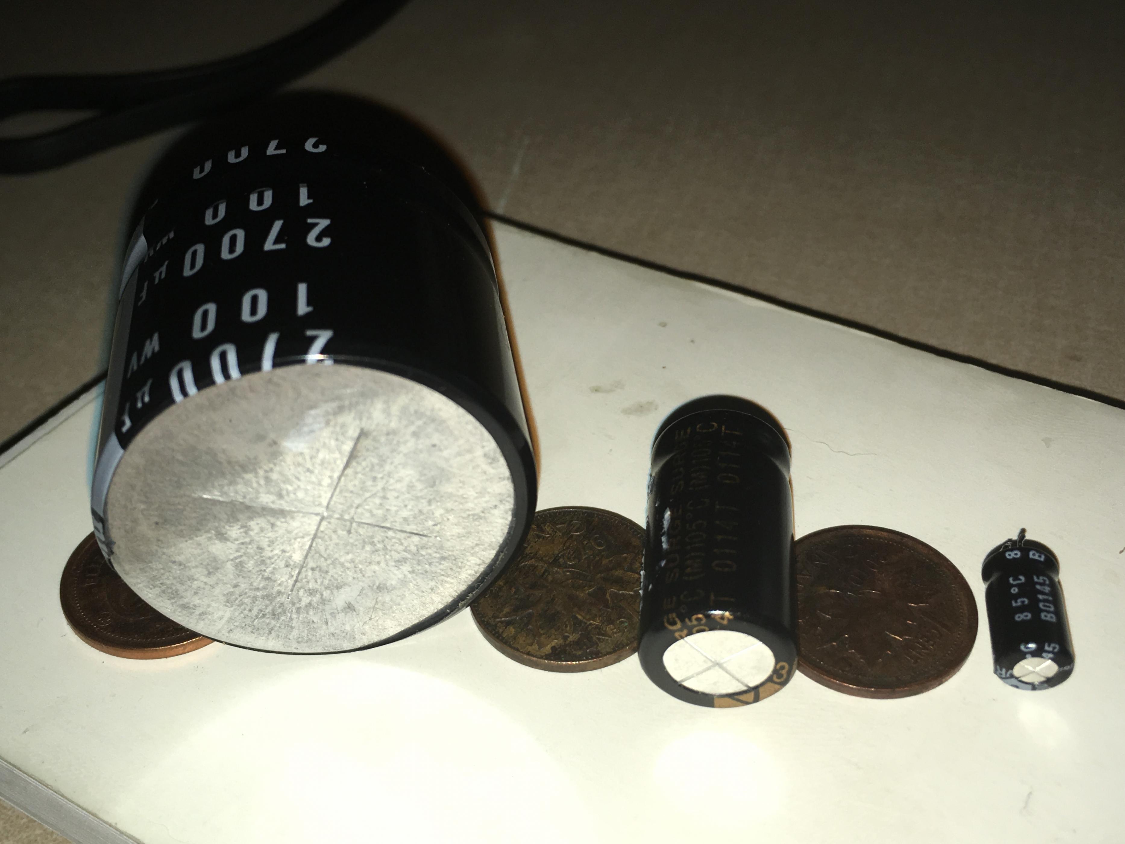

Pictures2

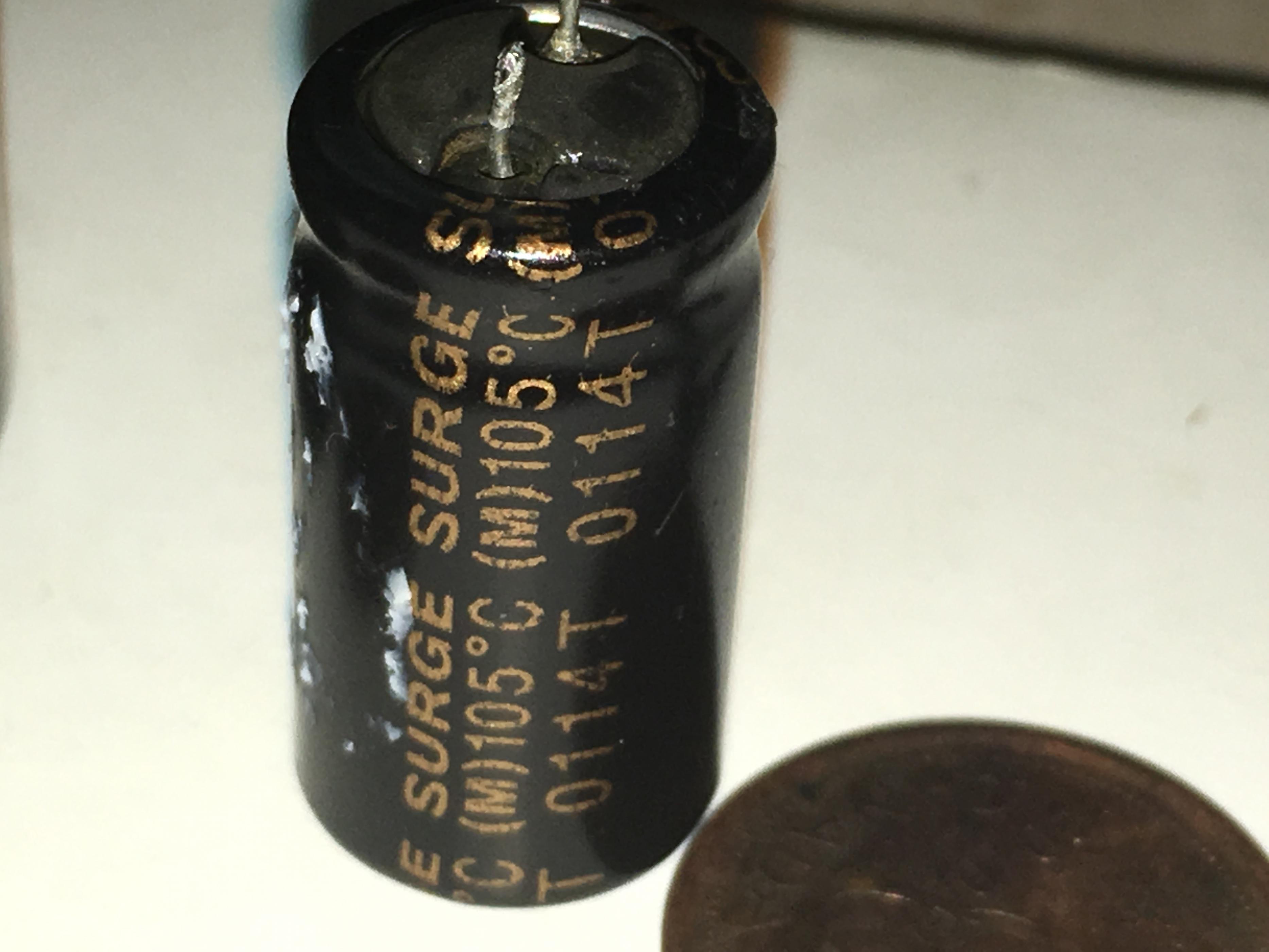

Here is the mystery capacitor. This is the cap I need the most help replacing and trying to find out what the specifications are? (Black and Gold)(pic#1 and #2)
-6 pcs of Surge 0114T (M) 105’c 330uf 63 v
- (is this “0114T”a Rockford Fosgate company reference number that they put on the capacitor at time of manufacture?)
-13mm diameter. 24 or 25mm length and 5mm lead spacing. 2 leads
-There are 6 of these medium sized caps in a group (2x3) on the circuit board.
—-There was some type of white silicone glue down the middle of the group of 6. —-(What is this stuff and what would I replace it with?)

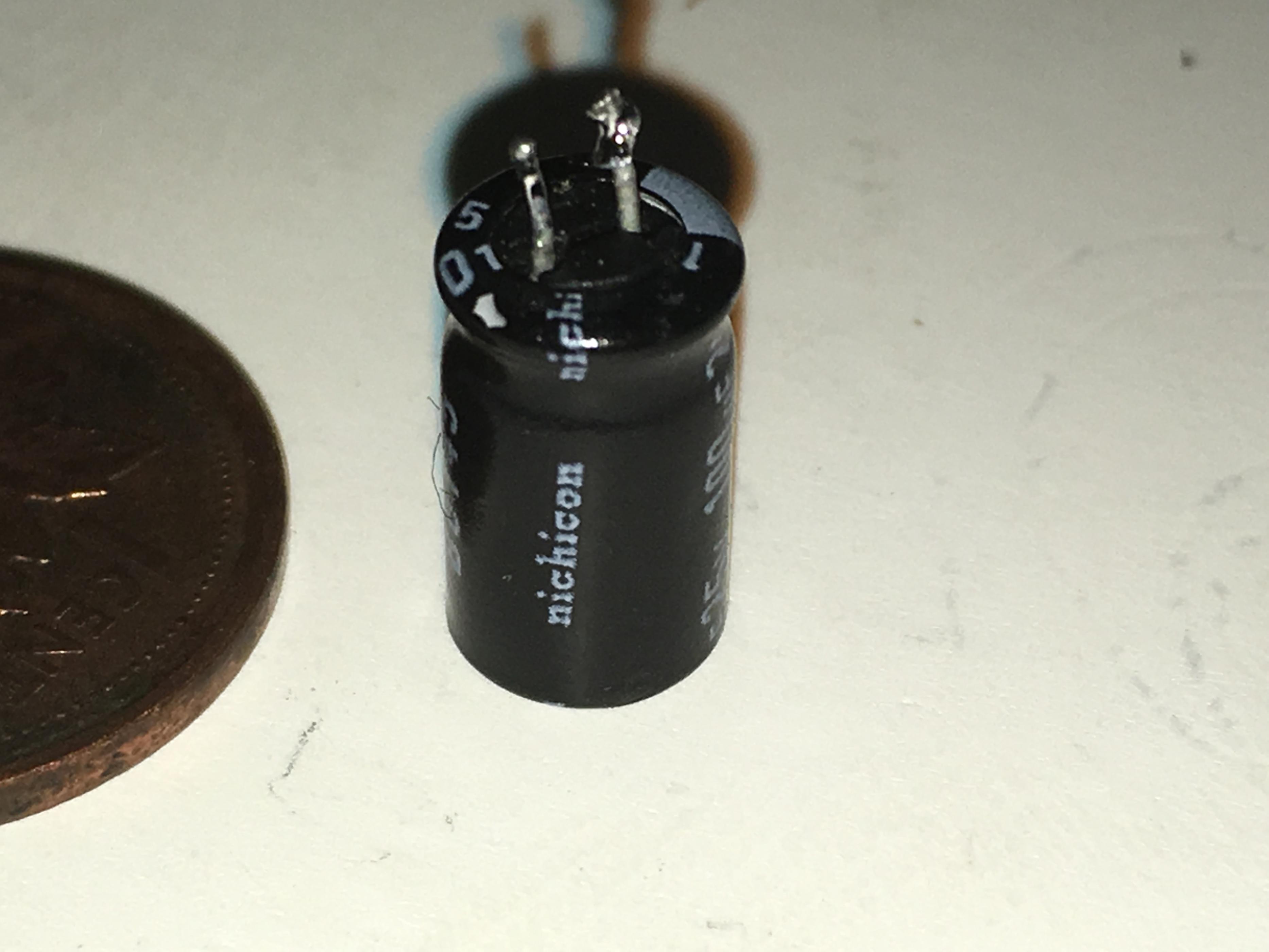

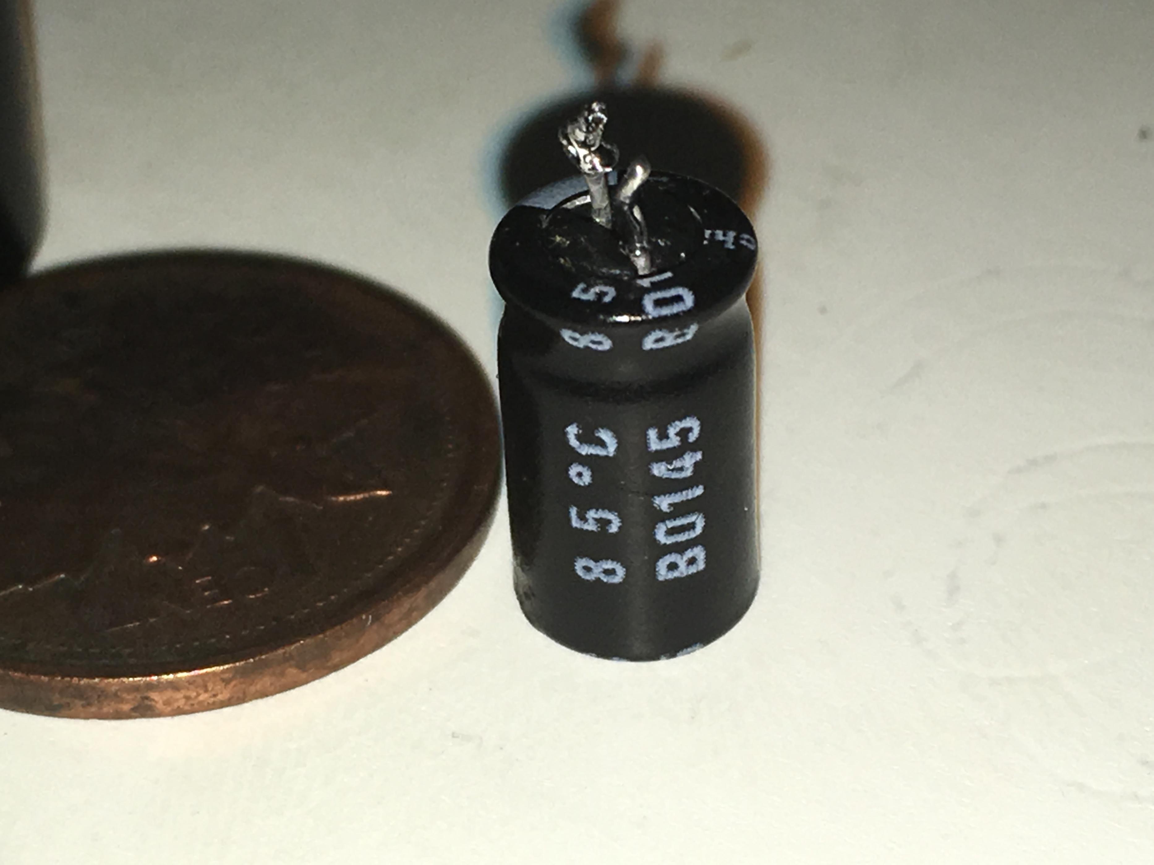

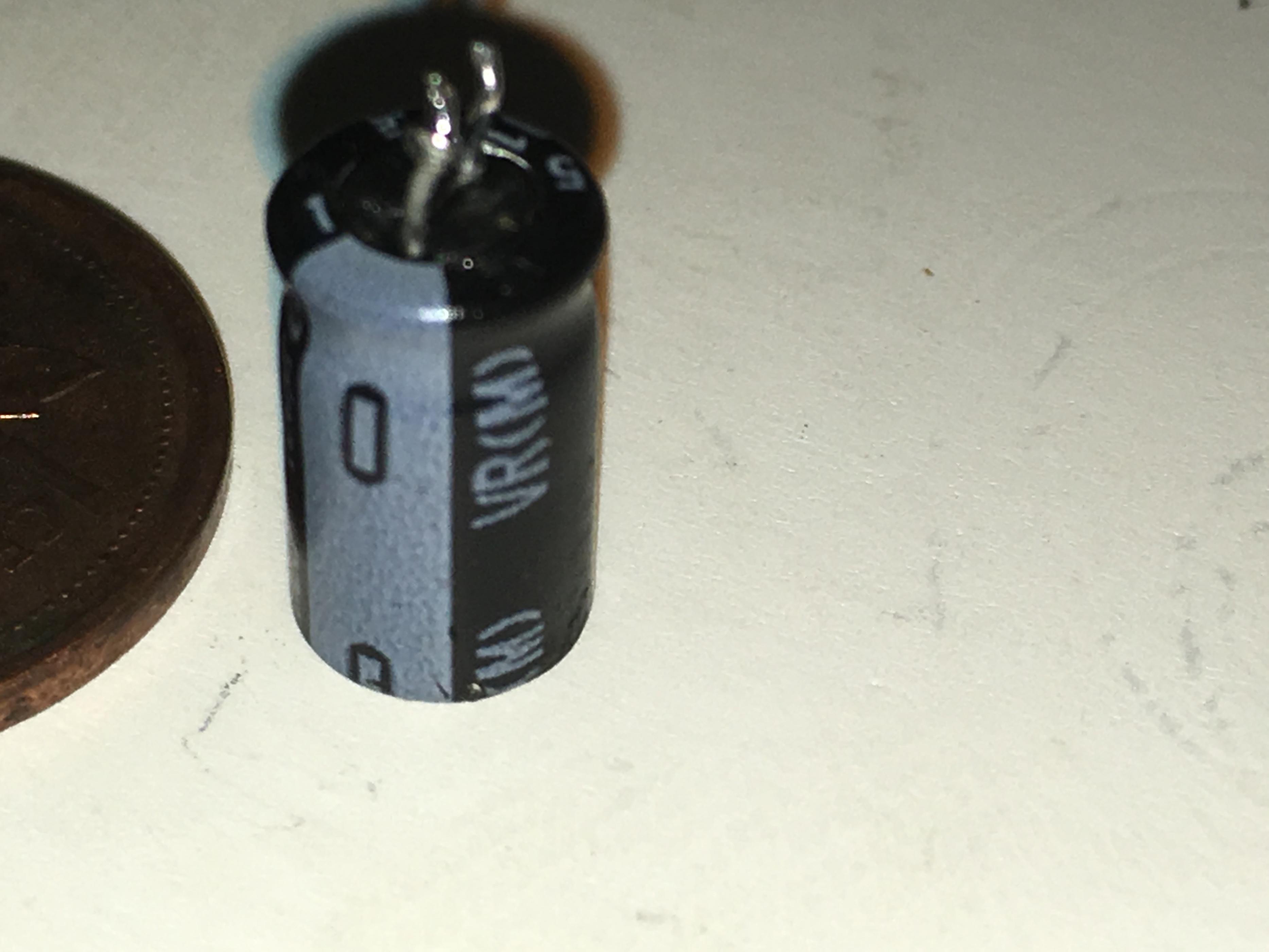

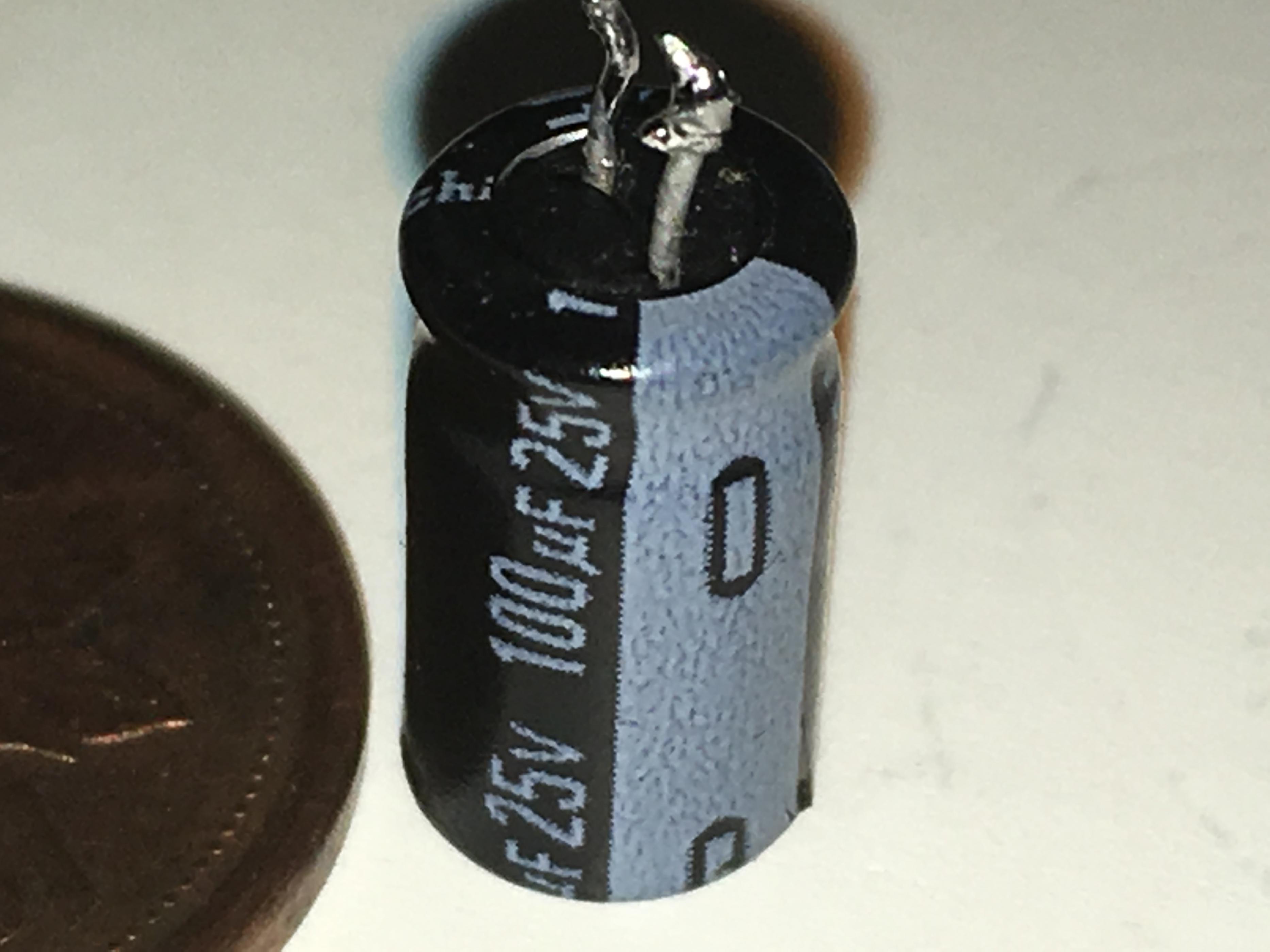

As well are pics (#’s3,4,5,6.) of the smallest capacitors. (Black and White)
-There are 10 of these in various/single locations all around the circuit board.
-I am not sure if that first character in the part number is a capital “B”or an “8”? B0145? or 80145? (I’m wondering if this is put on by Rockford Fosgate as a their own company reference number?)
-(These are small and so the letters/numbers are very hard to read?)
—10 pcs of Nichicon B0145 VR (M) 85’c 100uf 25v
-these little babies are 5mm in diameter and either 10 or 11 mm in length? They have two leads spaced about 2 or 3 mm apart.
—The vendor I will be ordering from has Elna Silmic 11 in this size (100uf 25v) however, I need to try to find out the specs on these old ones as well to make certain the replacements are a match to the old specifications. I would like to use the Elna as they seem to be well received from what I have been reading on various places on the Internet.
Picture#7 is of all three sizes/groups of capacitors in question for relative size reference to each other.

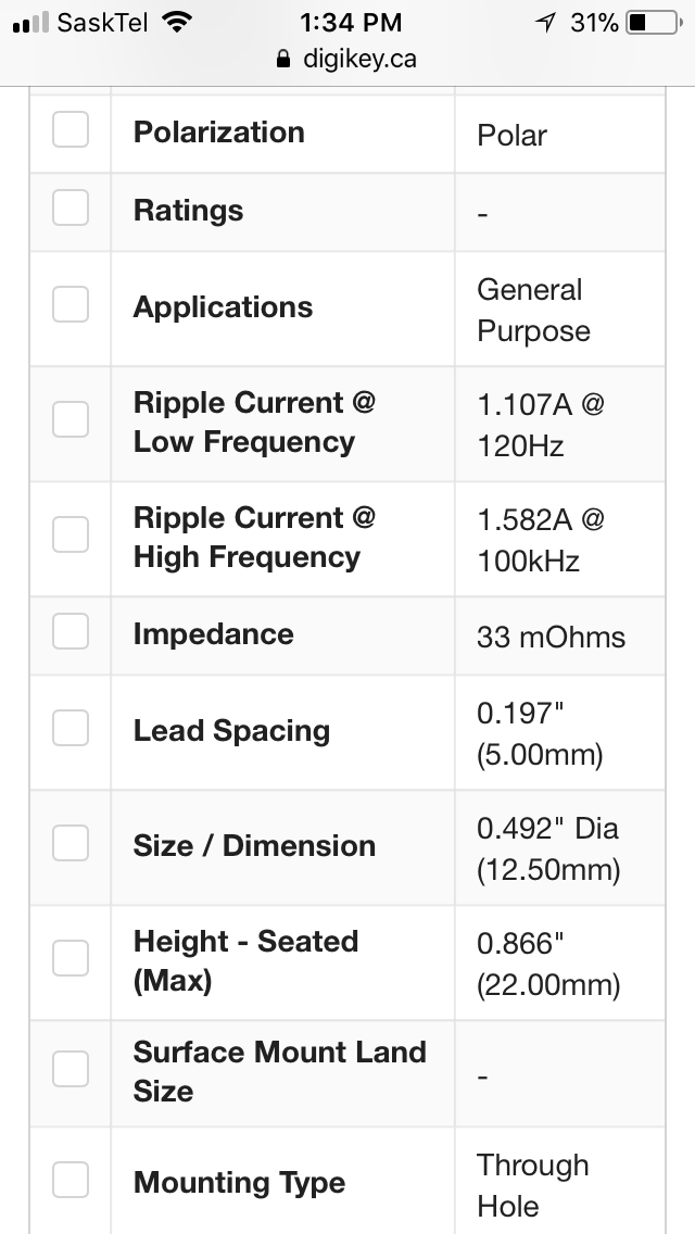

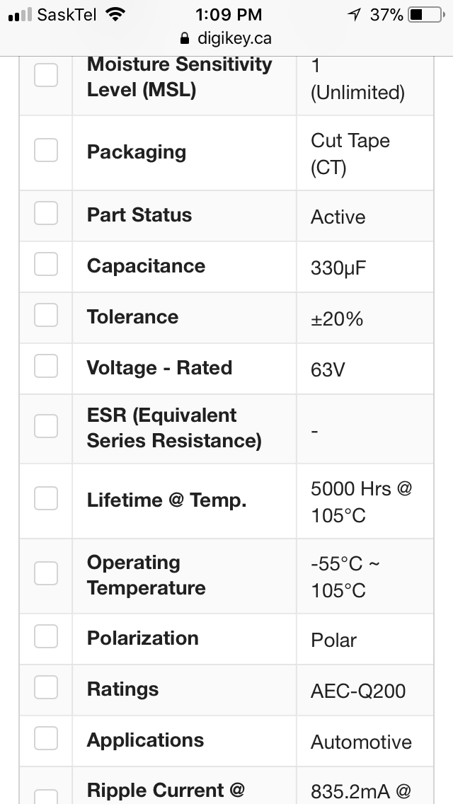

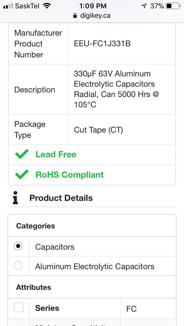

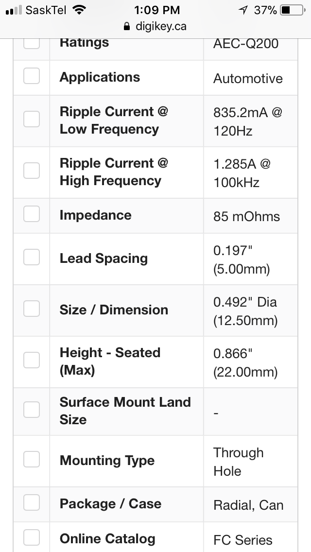

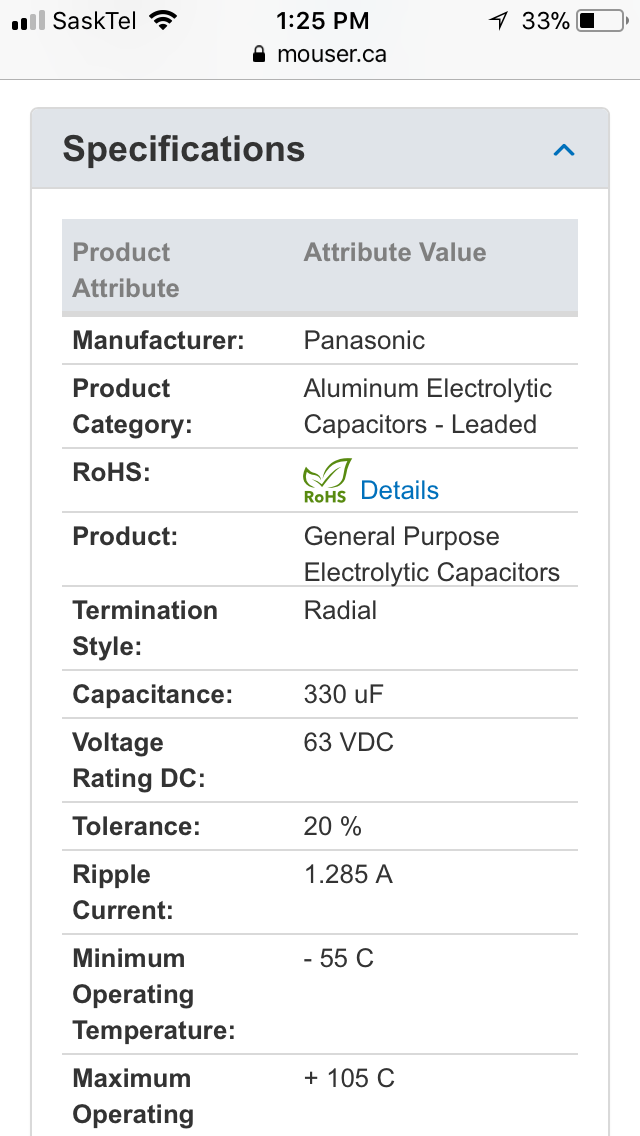

Panasonic EEU-FC1J331B
I have narrowed it down to a couple of choices provided I am reading and interpreting specs correctly.
Here is one of my choices for 330uf caps:
Panasonic
EEU-FC1J331B.
Panasonic
EEU-FC1J331B.

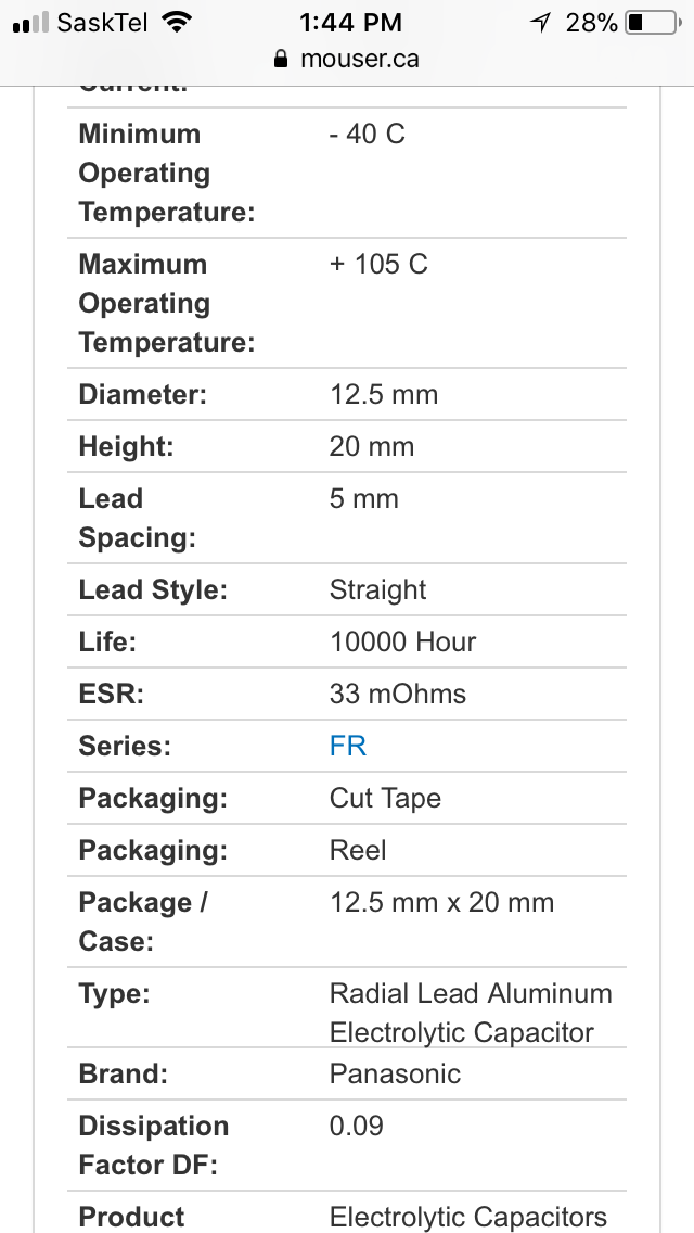

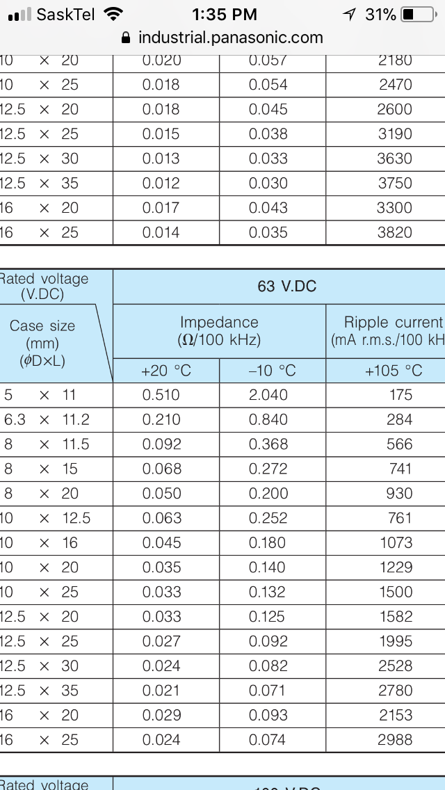

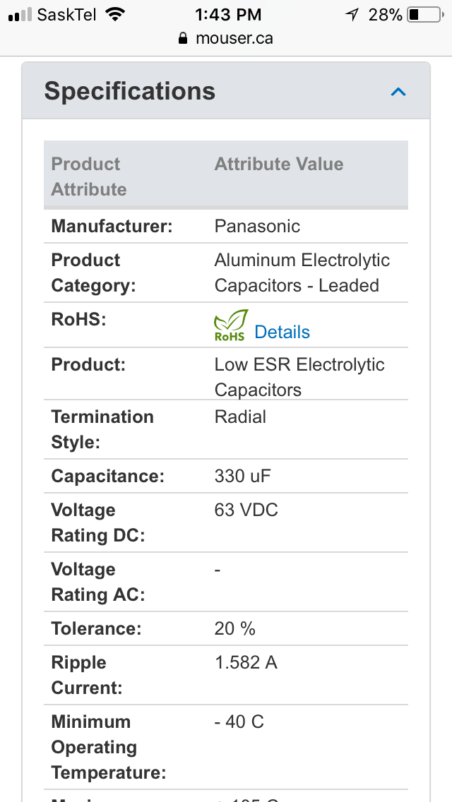

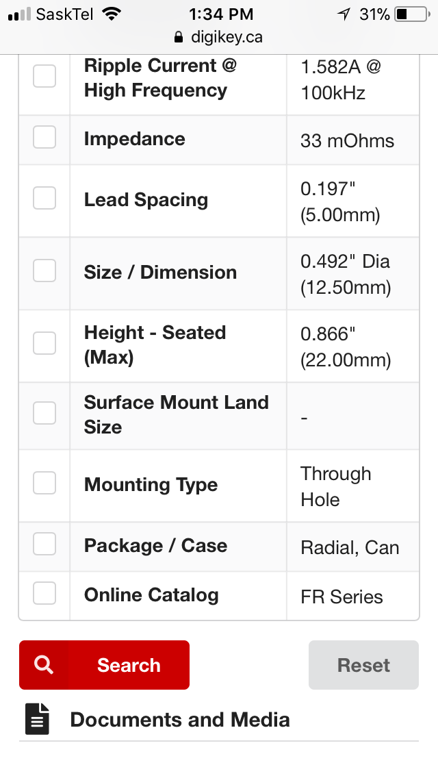

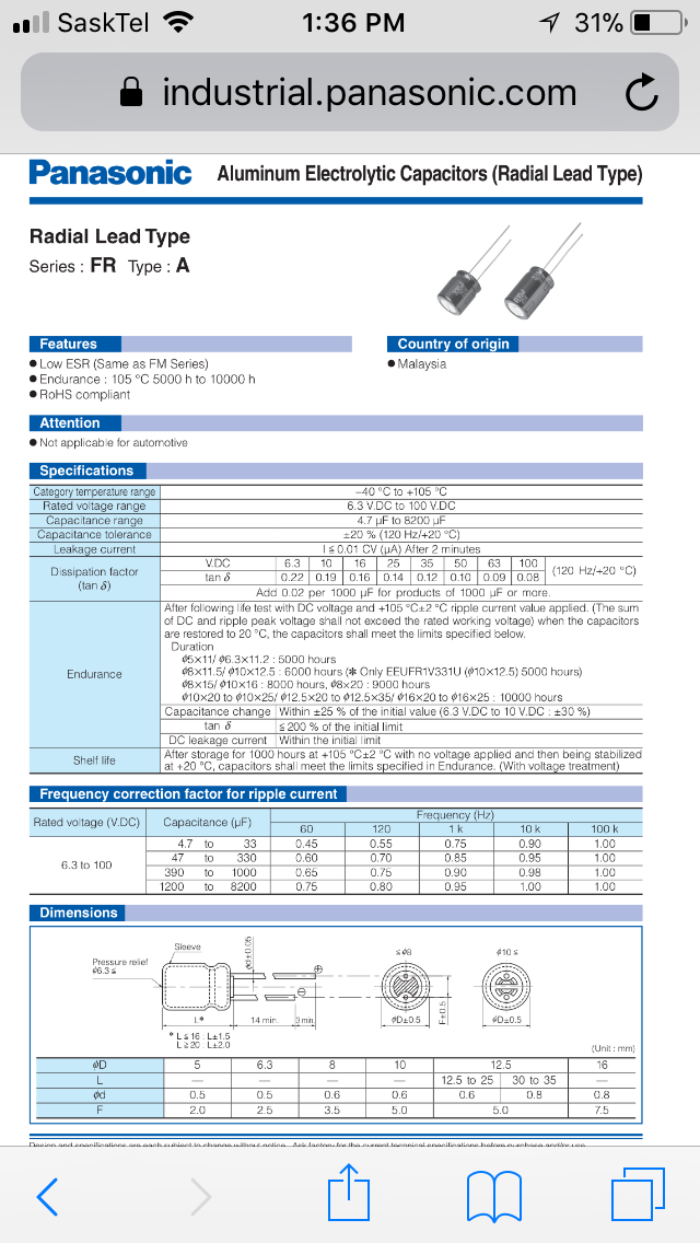

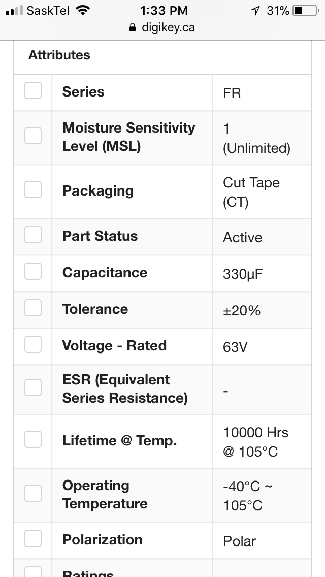

Panasonic EEU-FR1J331B
Here is my second option: Panasonic EEU-FR1J331B
Here are the specifications on these; I believe they would be referred to as FR series? These look to have a lower ESR if I am reading the specifications correct?
I am leaning towards this second option, but I’m open to opinions from the experts?
The data sheet states these are Low ESR (same as FM series)
It also says made in Malaysia?

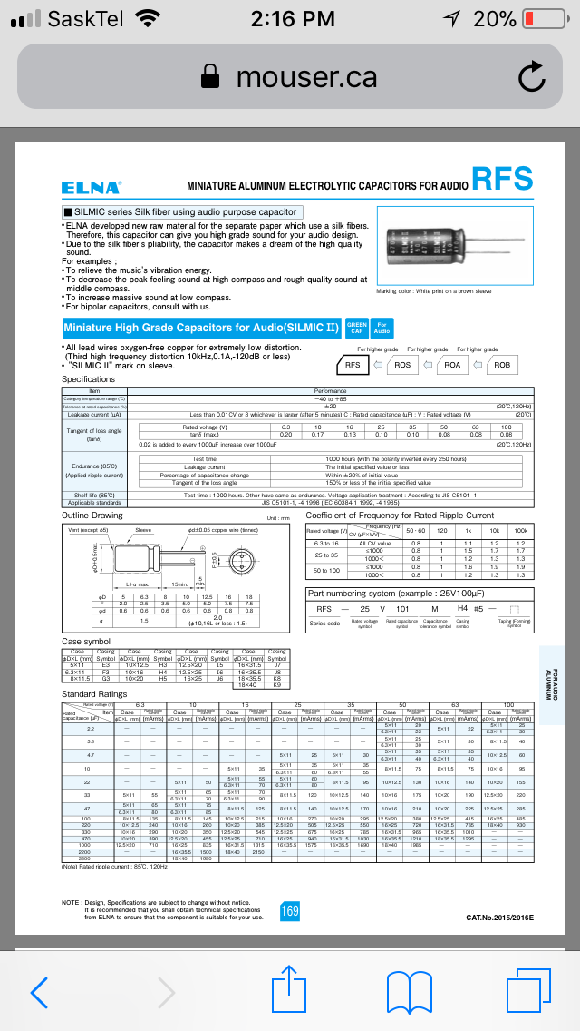

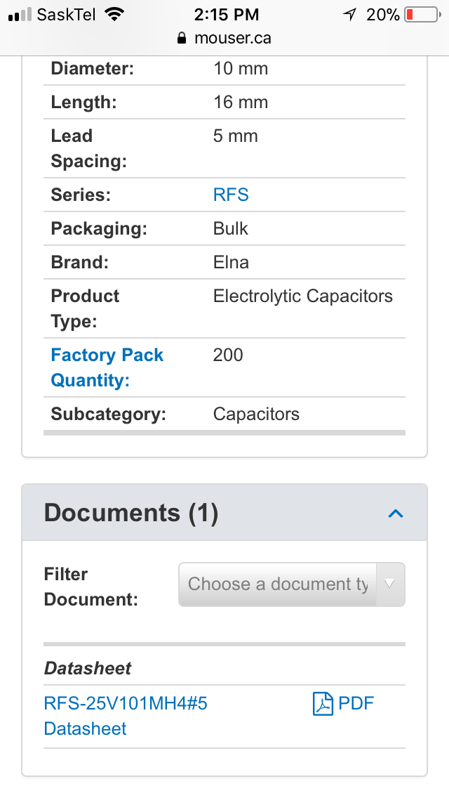

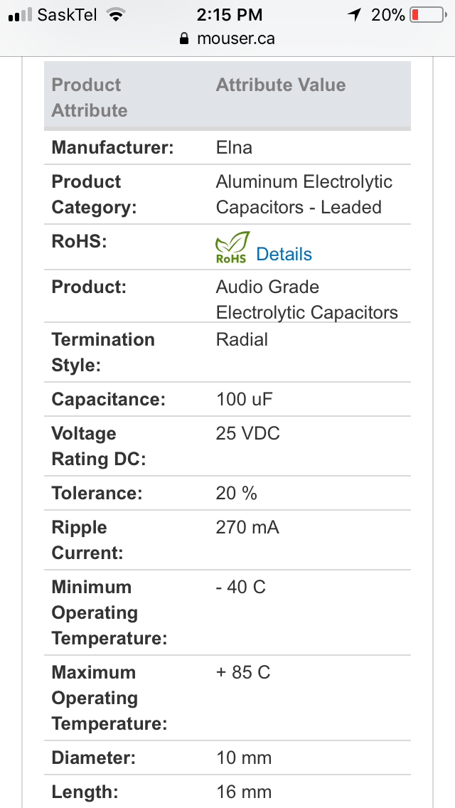

Here is my selection for the 100uf 25v capacitors:
This is my selection for the 10 small capacitors 100uf 25v:
Elna RFS-25V101MH4#5. Audio grade capacitor.
I am under the impression that the 330uf 63v Capacitors are my primary filter capacitors? There are 6 of them grouped together on the circuit board. The two Panasonic options I listed are nearly the same size as the ones I took out (surge)? Which of those caps would you use Perry? The FC’s or the FR’s?
The smallest capacitors that I need are the 100uf 25v. There are 10 of these little ones throughout the circuit board and not grouped together; they are singles but all are the same size. I listed those Elna RFS-25V101MH4#5 as the ones I was going to use.
I’m sorry if this is confusing. I’m not sure what the purpose or name of these little ones are? Are they primary filter caps as well?
Sorry these Elna RFS-25V101MH4#5 will not work!!!!!
Perry, I see what you are saying now! Thanks for the heads up!
I’m glad I didn’t go ahead and order yet!
These Elna RFS-25V101MH4#5 will NOT work !!! The lead spacing is 5mm and the diameter is double the size of the Nichicon’s I took out! I need 2mm lead spacing not 5mm! Also the diameter on the Elna is probably too big to fit in some of the spaces on the board. Weird that the values are the same but there is such a big difference in size. I’ll pay closer attention.
I guess I won’t be using Elna audio grade caps in this.
Back to the drawing board for replacements for my 10 pcs. 100uf 25v .
I’m getting the impression that this amp did not use any audio grade capacitors when it was built. I have not been able to find the 4 large 2700uf caps in an audio grade.
I have not been able to find the 6 medium sized 330uf caps in an audio grade.
And as for these 10 little ones 100uf 25v... I will see what is offered more closer to the correct dimensions this time.
Ok, the Fr’s Is what I will get, for the Primary filter caps. Thanks.
I’m just reading through the 100uf 25v capacitors specs now.
It looks like there are over 150 different types to read through. It doesn’t sound like it matters much which ones I use here? It looks like Nichicon still makes VR series in this 100uf 25v but the physical dimensions are 6.3mm diameter as opposed to the 5mm diameter that are being replaced?
I'd reinstall the large caps. If the primary filter caps were damaged, look for 'low ESR' replacements.
The other caps are not critical and virtually anything will work (even the originals).
what i´ve measured these old fosgates is those 10uf 16v SMD caps, all were around 8ohms, new is 0,9ohm.
All larger can type caps has been in specs
