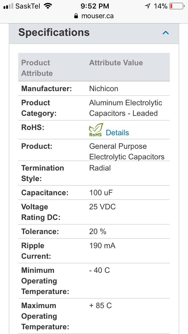

Replacements for the 100uf 25 v

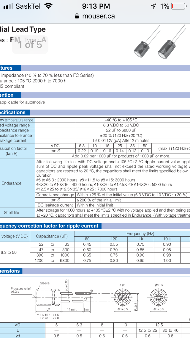

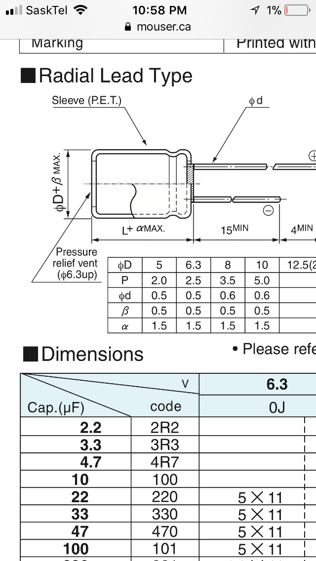

Here goes a second try....This is a few more options for those 10 pcs. Of 100uf 25v capacitors.
I have measured them a little more carefully and I don’t think they are the physical dimensions that I had reported in my earlier post...
Here are my more accurate measurements of these caps:
6.3mm diameter X11mm length. 2.5 mm lead spacing.
—What prompted me to re-examine the size compared to the original measurement I took was that there are hardly any capacitors available in the sizes I thought they were.
—Using the search filter on the vendors website kinda helped push me in the direction to figure that out.... and there are way more options in this 6.3 diameter size. (Even audio grade!)
—I had originally and carelessly measured the diameter to be 5mm.

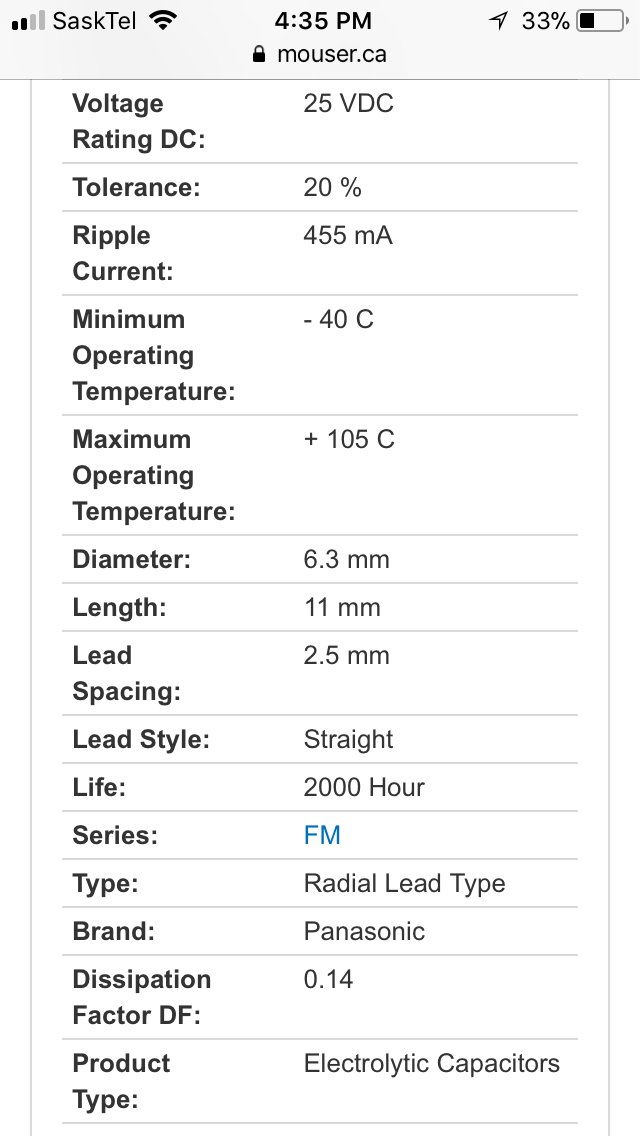

I don’t think the length matters much, but....I also discovered that the lead spacing is 2.5mm rather than 2mm like I originally thought.....
Anyways...
—Again I’m not sure these capacitor specifications matter as was mentioned, but I welcome advice from the experts once again and then I can order the parts...
—1st option that looks good to me (again, I really don’t know what I’m doing)
The one thing I noticed on the data sheet was at the top it says attention: not applicable automotive.
—I’m sure they meant that these would not be acceptable for automobile parts?
(O.k for an audio amplifier) But I don’t know? These Panasonics are also able to run up to 105’c instead of the original capacitors which are rated for only 85’c. Does this matter?
—Otherwise these have higher ripple current? It doesn’t tell me the ESR? Or is there something I am missing?
Panasonic : 100uf 25v
EEU-FM1E101H

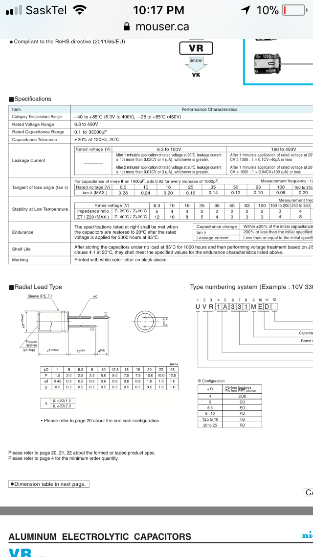

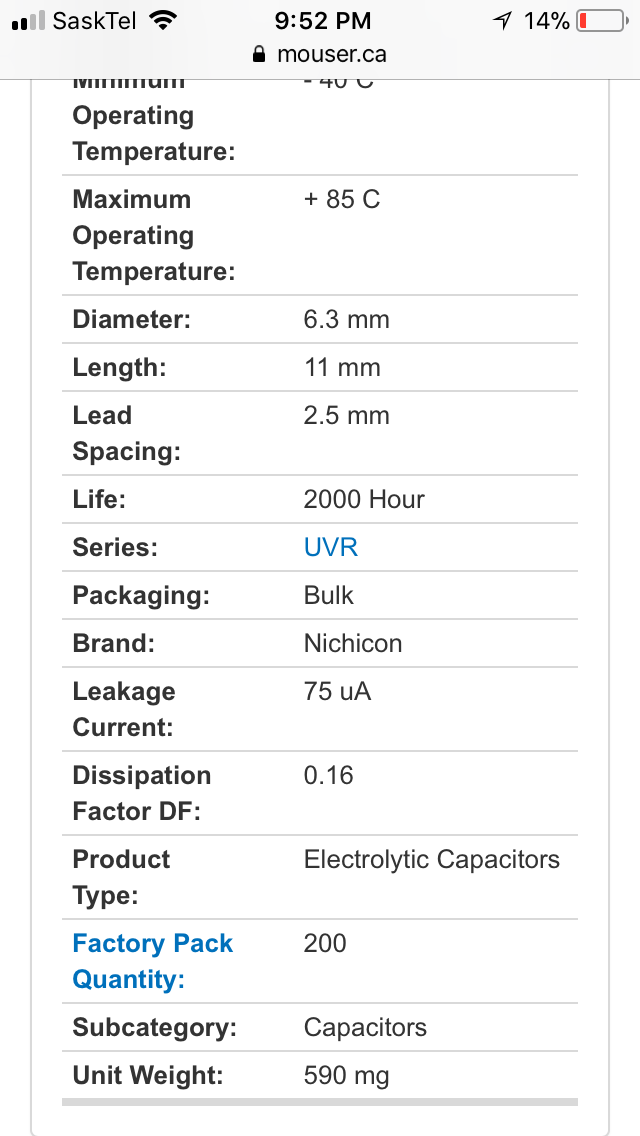

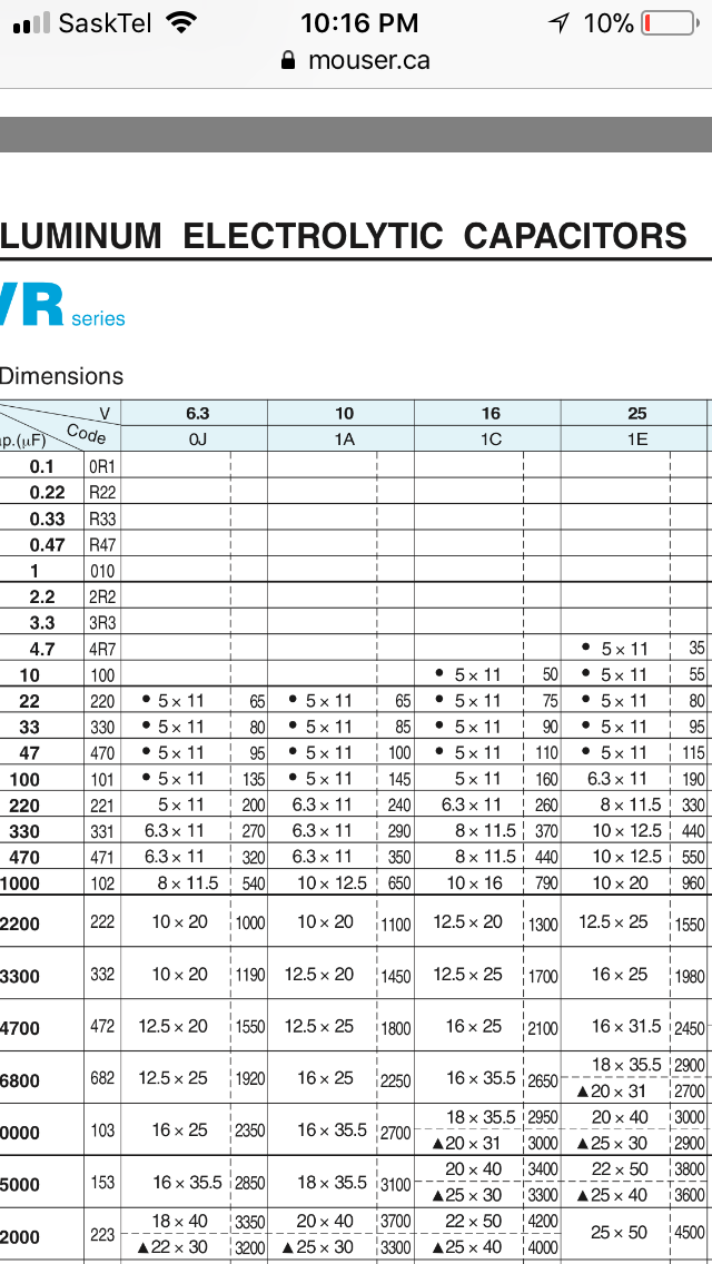

Second option:
The original caps that came out of this amplifier have VR on the jacket.
And here are VR!
Is it possible that these would be the exact same as the original caps installed in this amplifier so long ago?
If so... should I just order these and be done with it?
If it doesn’t hurt anything would it be ok to use some more modern capacitors such as the Panasonic’s I listed above as my first pick? I’m not sure that I should even be comparing things like ripple current and ESR for these smallest caps?
I know it was important for the primary filter caps...only because Perry told me so... Thanks to this site and Perry!
The difference in price is only pennies... but I only want to solder these little buggers in once.
If it will absolutely do nothing but improve function to put the more expensive Panasonic’s in I’m down for the Panasonic’s.
I’m not into experimenting much... or taking stabs in the dark?

Out of those, I'd use the panasonics but only because they're right next to regulators that run very hot and they have a 105C rating. But, realize that the 85C caps have survived for many years in those locations.

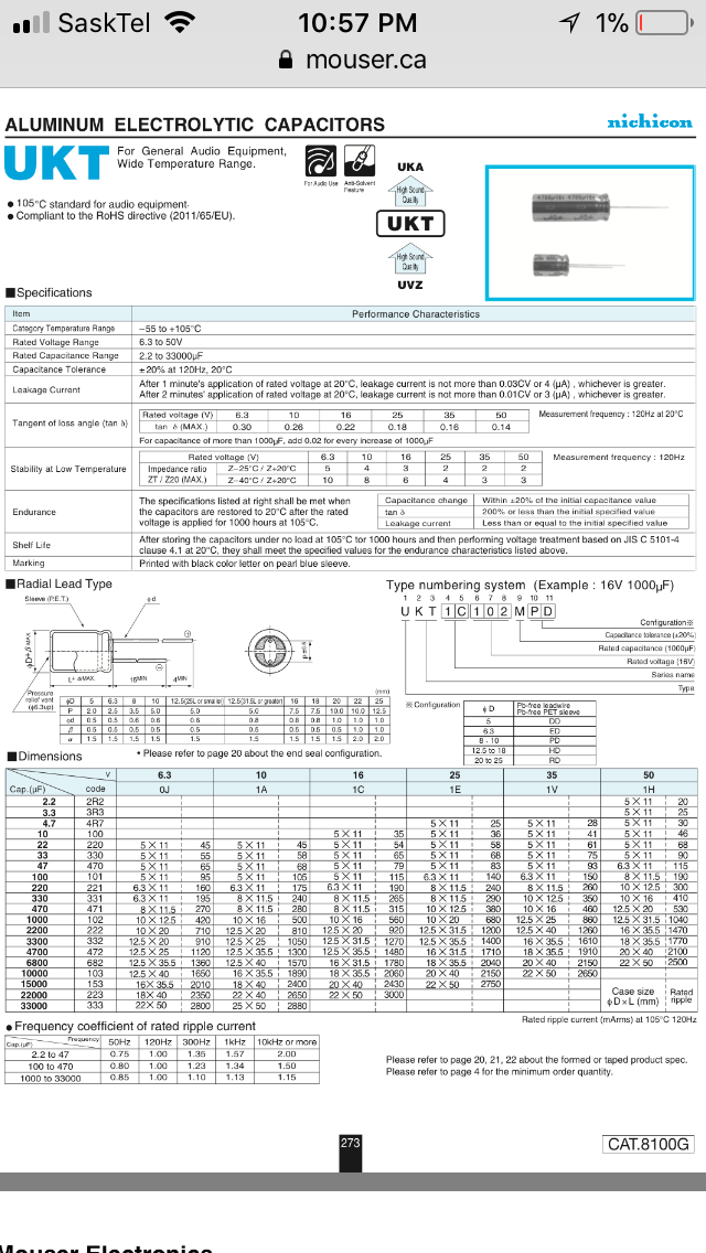

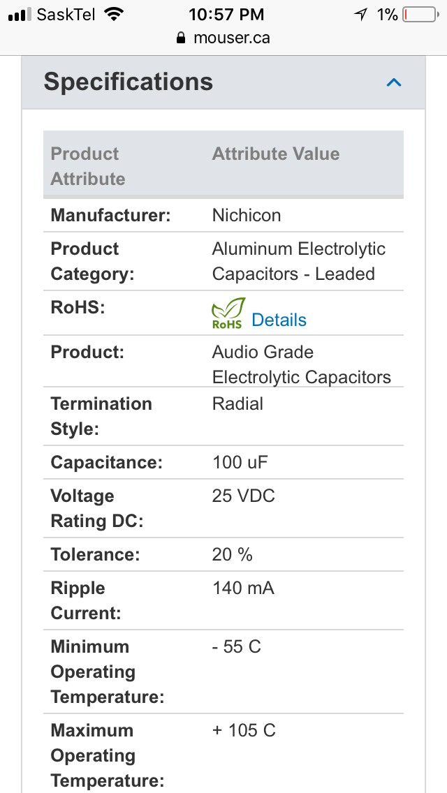

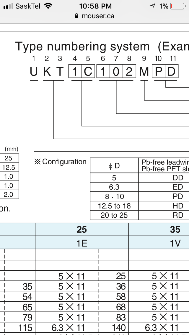

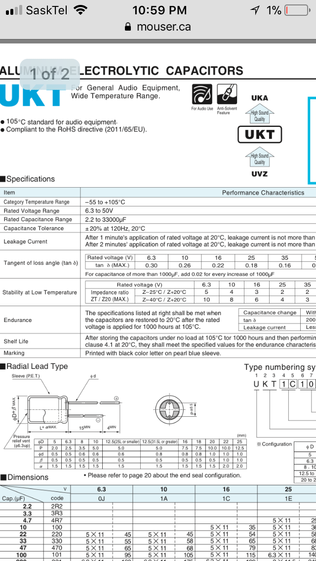

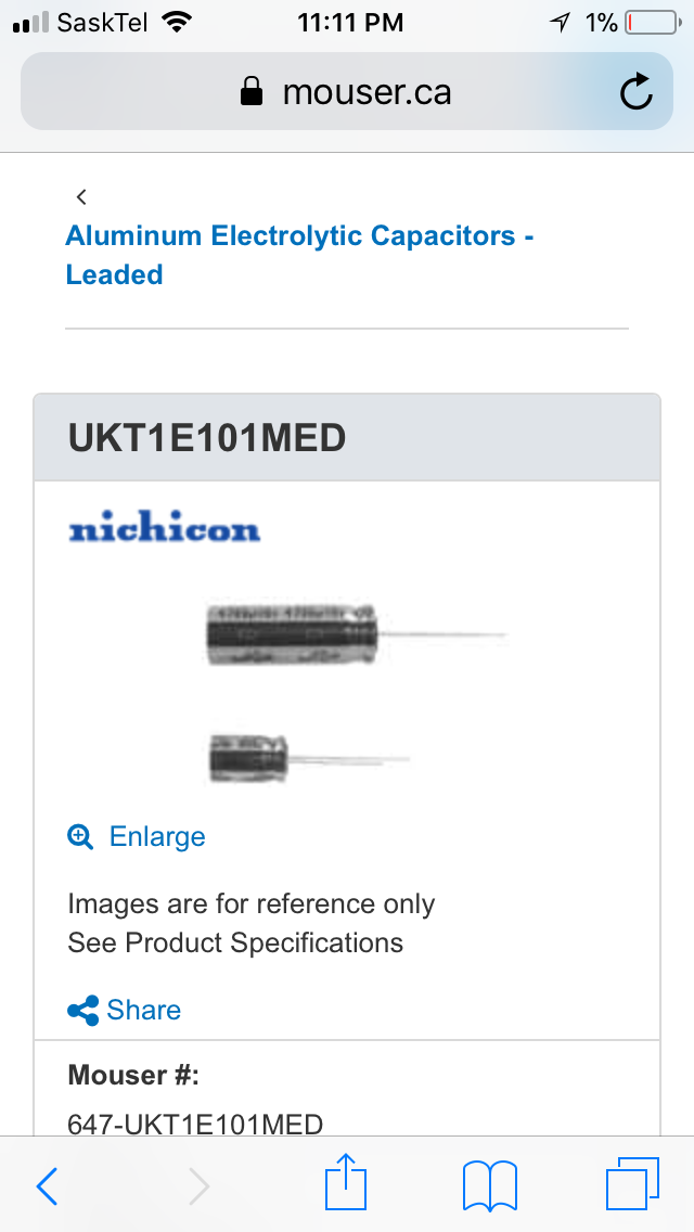

Third and final option : Nichicon UKT1E101MED Audio grade
Nichicon 100uf 25v
UKT1E101MED
This is an audio grade with a ripple current close to the VR series AND has a 105’c temperature rating!
The downside is the life is only 1000 hrs.
—Is that going to be a problem?
—If it lasts me 5 years, I’m happy.
(These are the most expensive, but if I order 10 there is a better deal and I just happen to need 10... only $2 more than the others.)
That’s my few choices. Which ones look like a good choice?
Of course, I’m willing to take any advice if these don’t look proper.
