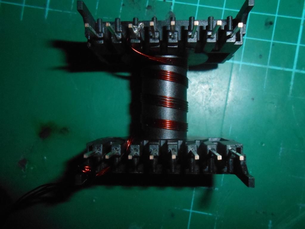

This image show the winding of the first part of the primary. I've started to wind the primary clockwise for no reason.
I plan to wind the second part of the primary inbetween the first one.

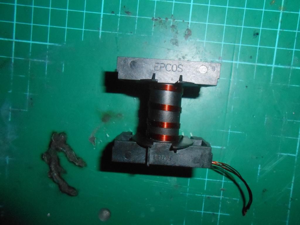

Another question do half turns count as windings? As you have to make a "half turn" to get outside of the bobbin.
If not theres only essentially 3 full turns per primary on this transformer.
My thought is that the 2 half turns, one at the start and the other at the end would count as a fourth full turn.
Another view from the top of the transformer makes it seem it has 4 full turns.

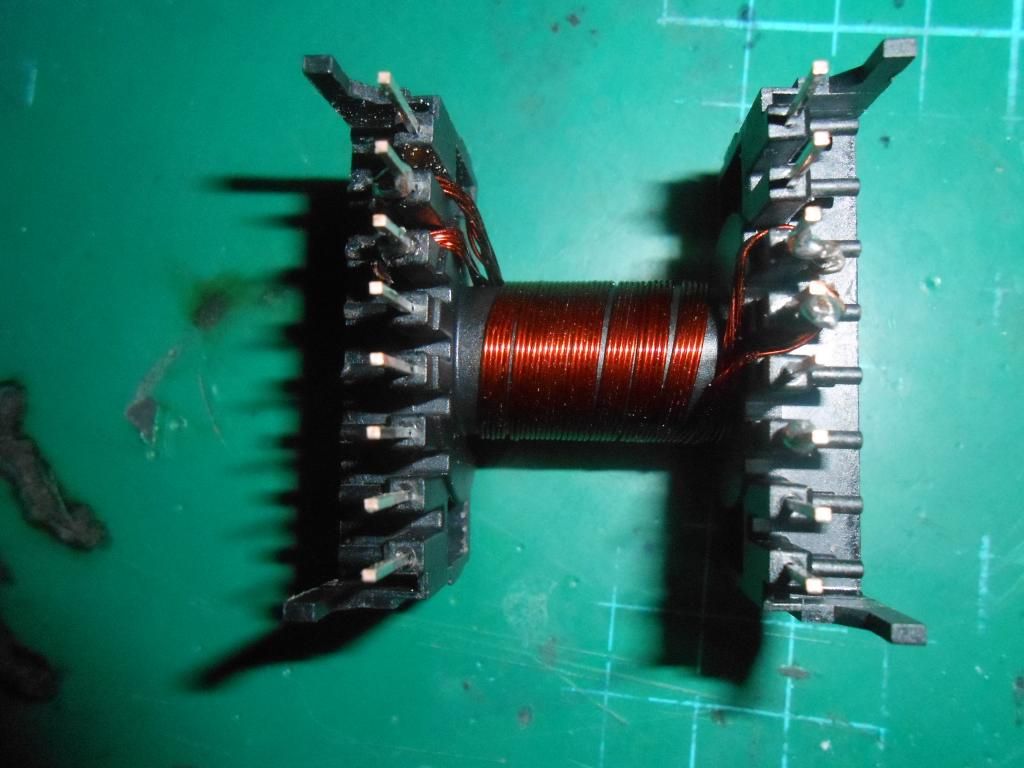

This image shows the second part of the primary wound between the first part in the same direction.
There are no overlaps of the copper wire and the winding are as tight as I could get them.

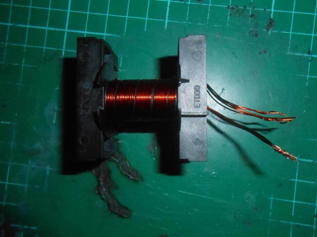

There is still some empty space on the transformer, I don't think this is probably good.
I've tried to keep the windings as neat and as uniformed as possible with no overlaps as before.

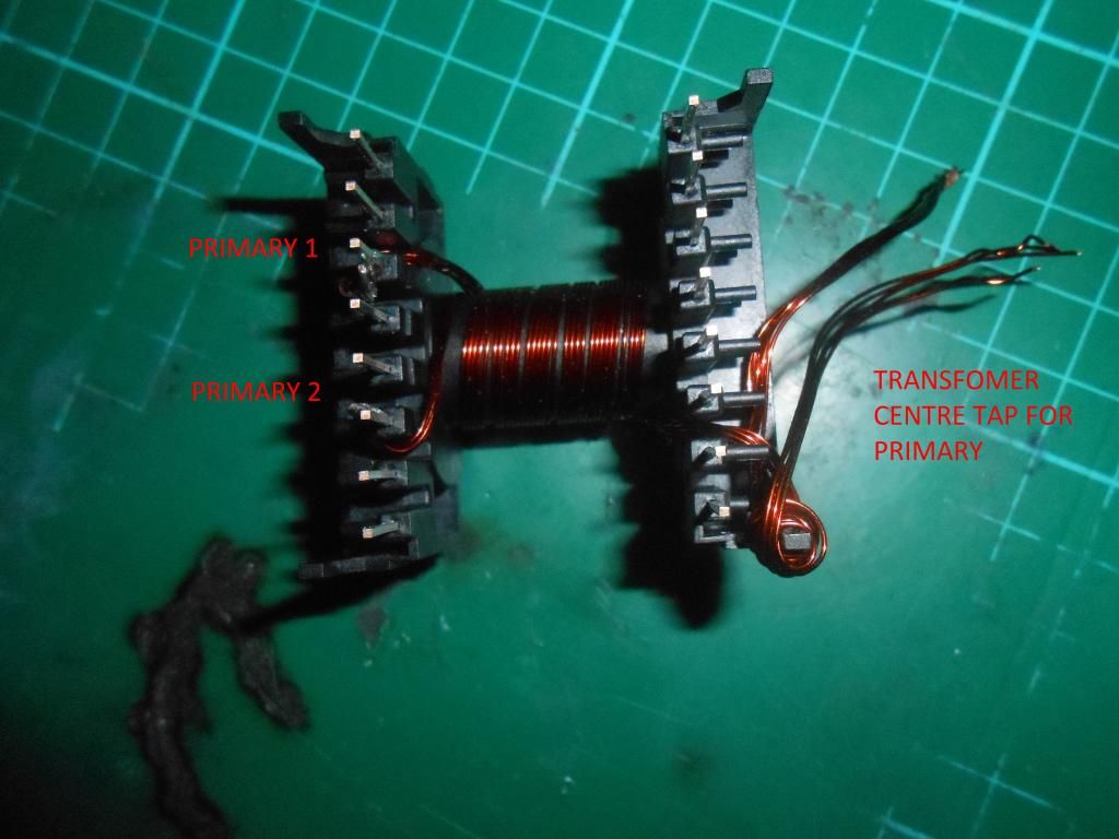

With this last picture I've added some captions.

Your windings look plenty neat. I didn't do any counting of turns but surely you can. It is possible to make half turns through any shell core but you have to pass through one of the outer legs to do it. Certainly balance in a push pull is far more critical than even primary inductance or ratio. So long as the legs of each winding and tap leads pass outer legs the same number of times you have fundamentally balanced windings. Winding uniformity and lead dress does affect coupling and leakage but you're doing a good enough job so far. It's obviously not an off-line transformer but I'd still recommend a good turn or two of mylar between pri/sec. A little space doesn't hurt. With a little care you can use it for end margin to keep the whole winding under tape. Proper construction actually.
The first pic shows a winding that starts and finishes on the same side of the core, so no half turns there.

There are two windows of the core that hold windings, formed by a center pole and two legs. Passing through only one of them makes a half turn. With only 4 turns primary, a half turn difference on one side of the center tap would send the core into saturation immediately at much less than 12v b+. So long as you don't do that and have no shorts, your transformer is likely to work fine. It looks like the bobbin could hold more wire, but if it doesn't heat up too much, it's good. Even masking tape is more fun to wind over than vinyl. With a good tape layer it wont make much difference which way you wind the secondary on this transformer.
I'm wondering why your transformer has so few turns on it? Like you, I'm concerned that you're using only a small part of the winding area. These two observations are ringing alarm bells in my mind that something's astray.
Care to share your calculations for the primary inductance? If you're using the core ungapped, perhaps this is why you've got so few turns - normally transformers like this are used gapped.
Well, taking a closer look at the last image, it looks like you're about to drive the transformer push push, which will be a bigger problem than anything we discussed so far. Unfortunately, if you start both halves of the primary in the same direction, a "crossover" connection is required from one start to one finish for the center so you end up forcing flux in the core in opposing directions by the two sets of grounded source power switches. Or, you can have your neater termination at the center by winding one half primary in the opposite direction. You'll have to take care of that one way or the other or it will be disappointing.

I'll just do a little math here for the OP - my Ferroxcube data for ETD39 core shows an ungapped AL around 3000. So with 4 turns this gives a primary inductance of 48uH. With no airgap though this'll saturate the core way too quickly for a decent power output.

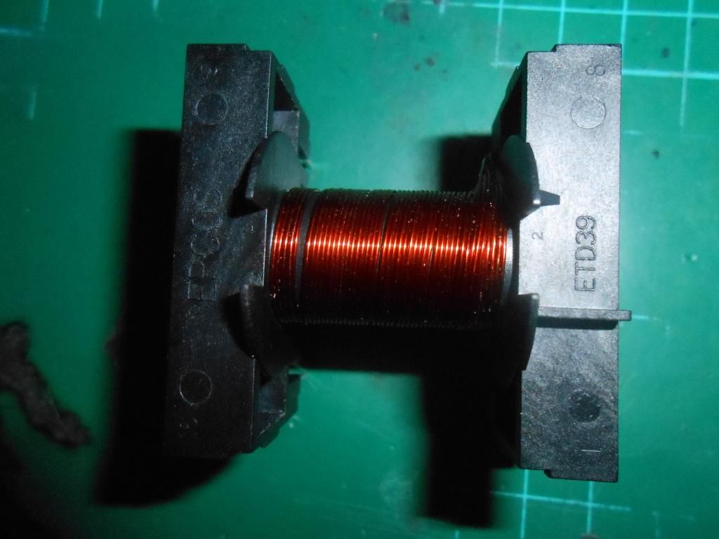

I've adding another second turn on both primary winding's to help fill up the core more.

Here's what the transformer looks like now.
That'll run. Just make sure to connect one pri winding start to the other pri winding finish for the center tap. The ESP instructions to wind both primaries in the same direction only works if you *continue* the second winding from where the first one left off, which effectively turns the current around in both directions from the resulting free ends.
The basic circuit is the usual poop, with no inductor between the output rectifiers and filter capacitors. This means that the output caps will peak detect and the PWM control will not have much effect to control output voltage unless dialed to a tiny sliver. Typical LCD crap design that has been floating around for years on end.
Sorry both primary winding DO run in the same direction "clockwise" are you saying this is correct? As for the center tape I was going to connect all the winding's to one pin for the center tap, but thought it would be best to combine two legs due to the current requirements.
