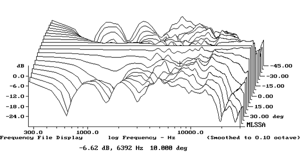

Actually I was surprised how well Tekton measured. I would have put the hex tighter. Sad that Stereophile doesn't publish distortion measurements.
Vertical shows extreme angles, up to 15¤ is ok, better than many 2-ways. Anyway perhaps woofers must play too high up.
Allen B : As Juhazi points out, it's' the vertical plot that reminds me of Dr. D'Appolito moving to use higher order filters and the rational behind his choices.
That's pretty awful, but from a practical perspective, owners have been quite happy with it and haven't noticed.
I read the comment: ["The closer I sat to the speakers, the less focused the aural images were;"]. This leads me to believe that either the baffle edge contribution, or the vertical polar response (fig.5) is troublesome.
Then I read this: ["Getting the Impact Monitors to focus their best required placing them closer together than I ever could have imagined would work—the centers of their central tweeters were only 5.6' apart"]...
So I was inclined to question the horizontal smoothness. On the polar there is a flawed region between 3k and 6kHz. Could be Patrick is right in suggesting a lobing issue?

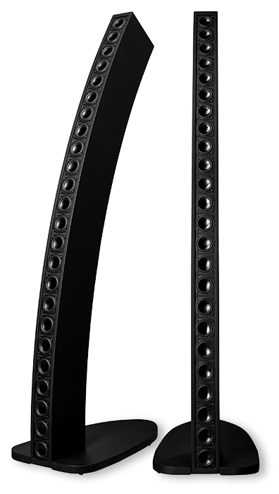

Let me clarify some of my comments on CBTs sounding "hazy."
Conventional loudspeakers look like this. The left speaker, right speaker and the listener form a triangle. The loudspeakers are equidistant to the listener.
Because the loudspeakers are equidistant, the depth of the soundstage is generally defined by the distance to the loudspeaker.
In a CBT, the pathlength to the drivers varies quite a bit. I've heard the CBT24 and the CBT36, and the depth of the soundstage was nebulous.
The top of the CBT24 is nearly two feet deeper than the BOTTOM of the CBT24. I believe that this variance in depth is audible; when listening to the CBT, the depth of the stage isn't apparent.
Three years ago I rented some SH50s and listened to them in my tiny condo in San Diego. They exhibit the same behavior; basically it's really difficult to tell where the sound is coming from.
I've told this story a million times, but here goes again:
While renting the SH50, our thirteen year old daughter literally asked me which speaker was playing. And this was while she was sitting one foot away from the SH50s. I think that's wild; she was literally getting blasted by a SH50 playing 100dB+, and she couldn't even tell if it was on. Try doing THAT with a conventional speaker.
Again, I think the key to this is that the DEPTH of the drivers is varied. (In the CBT 24, the top of the loudspeaker is nearly two feet further back than the bottom. In the SH50, the woofers are about one foot closer than the tweeter.)
It's a neat trick I think. It's eerie. When listening to music, it was bizarre how the HORIZONTAL positions were pinpoint, but the DEPTH of the soundstage was nebulous.
If things were reversed, it would be VERY BAD. For instance, imagine a loudspeaker where the HORIZONTAL locations are nebulous, and the DEPTH of the soundstage is pinpoint? You wouldn't want that, it would sound terrible.
