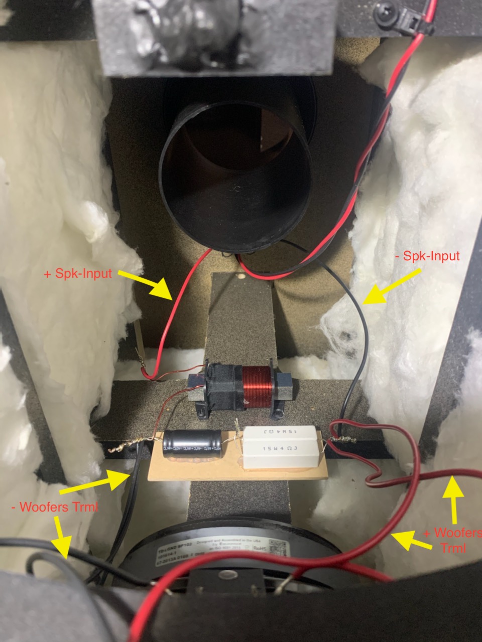

..need help troubleshooting 'low bass level' on Tekton Double Impact Speakers
I purchased a set of Tekton Double Impact Speakers earlier this year. From day one, I noticed that there was not great bass as described in the many positive reviews of the speakers. The bass sound seems very flat, especially at low to normal listening levels. The speakers are connected to a Willensenton R8 Tube Amplifier, Bluesound Node2i Network Streamer, and a Denafrips Ares II DAC. After trying just about everything from new speaker cables, Tidal Subscription, Two sets of Tubes Kt88 & EL34, to moving them out from the wall I decided to take a look inside the speaker by removing the top 10" woofer which allowed me to see the crossover inside. Based on what I see, does anyone know if the wiring to the crossover look ok? Are the wires from the woofers reversed? I see the red pos. wires from the woofers connected to the neg. side of the crossover and the black neg. wires from the woofers connected to the pos. side of the crossover. Could they have been wired incorrectly at the factory? Any help or input that can help would be great appreciated..
