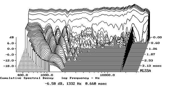

Yes, we all figure out that you abhor soft dome tweeters, but please do not present your subjectivity as a science. Soft dome tweeter waterfall can be perfect, as you can see on Dynaudio Focus 200 XD example:about stored energy. But here's a waterfall by Troels Gravesen of a 3" soft dome ATC mid. Some horrors there above 4.5kHz. A smaller 1.125" tweeter is going to do the same thing at a higher frequency.

That is a good waterfall for a dynaudio soft-dome, but not without problems at 16kHz. I'd guess dynaudio have carefully reduced the thickness of the soft-dome at the centre to lessen the problems, but the lack of rigidity always comes back to bite you. We really want to get it entirely out of band.

It is exactly 15,734 Hz - horizontal scan frequency of analog CRT monitor. It is not a problem from a Dynaudio soft dome, but artifact from an ancient CRT monitor which John Atkinson is using with his MLSSA system in all measured loudspeakers in Stereophile reviews:That is a good waterfall for a dynaudio soft-dome, but not without problems at 16kHz.

My curiosity is aroused, because I have wondered on various occasions why I see that exact same resonance with every speaker that Stereophile tests. Maybe there are some where it doesn't show up. But if there are a number of measurements of completely different speakers where the same resonance shows up, then it would have to be chalked up to a systematic anomaly in the measurement setup, would you not agree? What confuses me is that I have seen the resonance so many times, yet you apparently have not seen it except with this one driver. Very strange.
