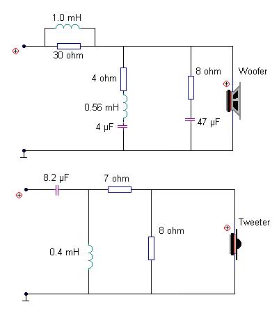

vdi, attached is the Dayton BR-1 modded MurphyBlaster Xover. The BR-1 uses the Dayton DC28F tweet and a DC160-8 woofer. This is just an example. How you will need to tune the xover for the DC28F will depend on what you want out of it as well as what woofer you are using with it.
