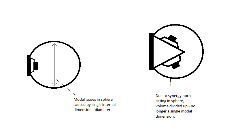

Usually a sphere shaped enclosure is not great for internal modes. This is due to the overwhelming single internal dimension - the diameter - causing a large resonance. Fortunately, due to the design of a synergy horn - the horn sits right inside the enclosure - subdividing the space up and breaking up any resonances:

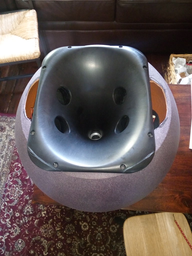

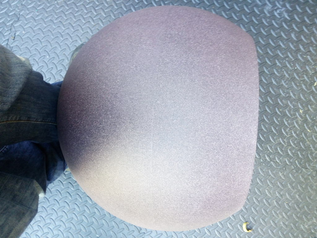

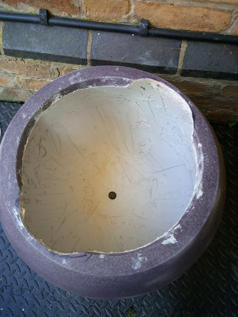

Soooo. Take one 51cm diameter spherical polystone planter....... Volume - 60L.
The polystone sphere is about 6kg. It appears to have a hard polystone outer layer, with a 4mm fiberglass inner which is orange. It is fairly light for it's size but very strong - I can sit on the side of it without any deformation.
Cut away rim in two areas to allow 8 inch woofers to slot in....

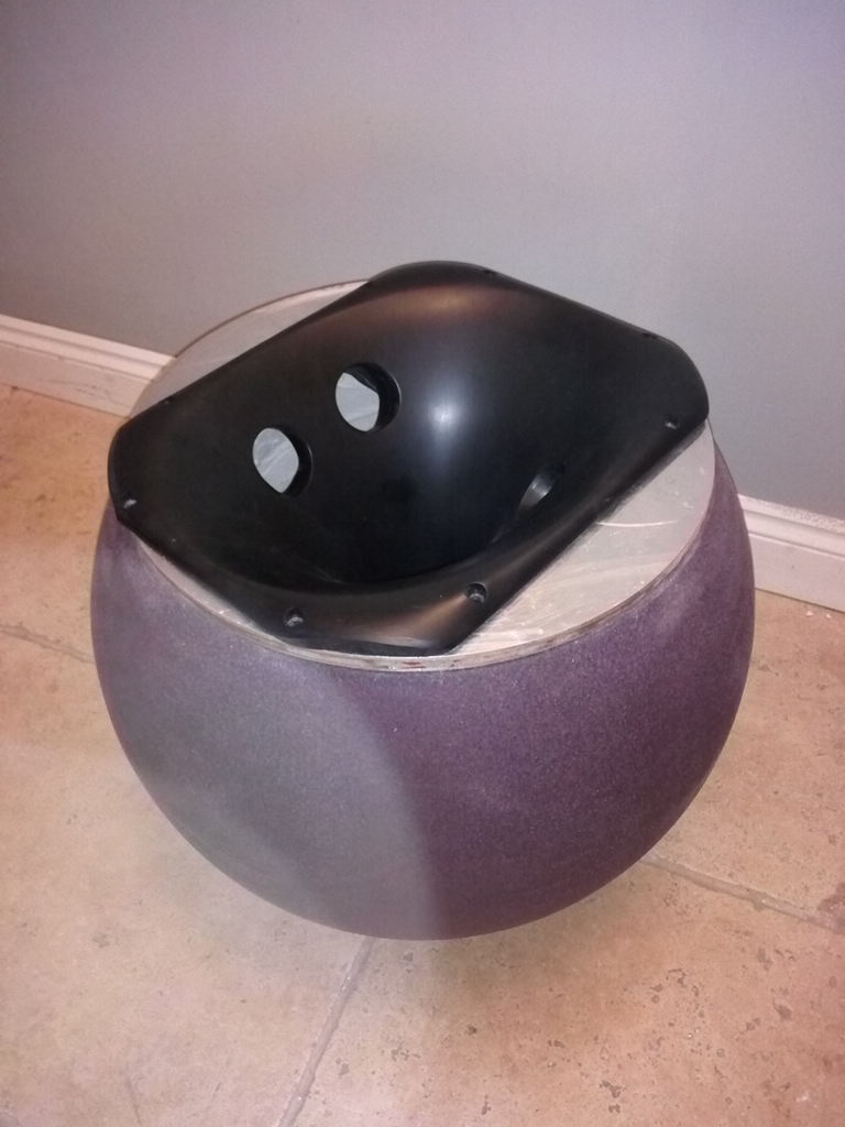

Obviously the horn will need some gentle modification. I will cut back the corners and round them. I will also need a new baffle.
So I have made a cardboard template and plan to cut a 5mm aluminium baffle with sorbothane gasket..

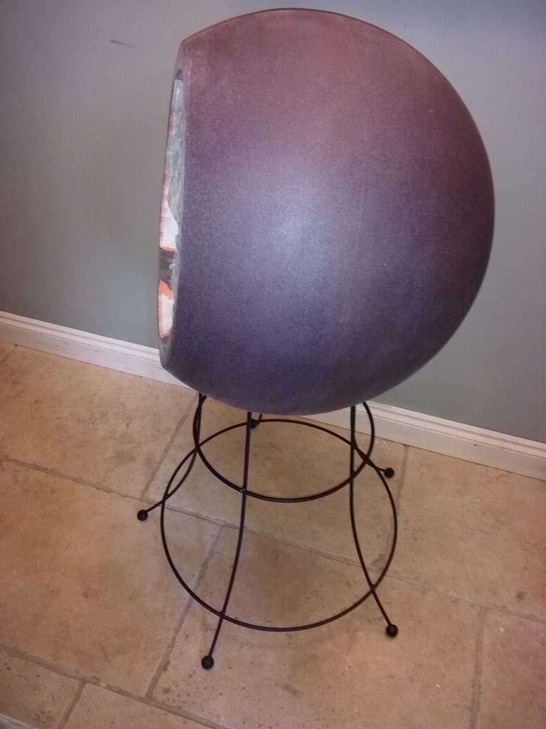

I will likely spray the aluminium baffle matt black and blend in the wave-guide to make it look uniform.
My plan is to sit the 'globes' on a ring hairpin plant stand like this:
Inspiration taken from these:

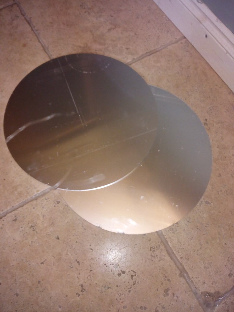

Does anyone know of a nice way of cutting a perfect 40cm diameter circle in 5mm aluminium sheet?!?
CNC water jet / laser - the water jet will leave some minor burring, but that'd easily be remedied
sometimes it pays to have tricky work done elsewhere
Try a circle jig and a carbide router blade. Wesayso cut holes in thick aluminum plates with a wood router until the cows came home. Carbide should cut Al nicely - just don't take too much off at a time.

I have hit upon serendipity just now on a certain auction site - the baffle circle needs to be exactly 400mm diameter to fit the top - and a chap is selling two laser cut aluminum 400mm diameter discs which are 3mm thick for about £25....

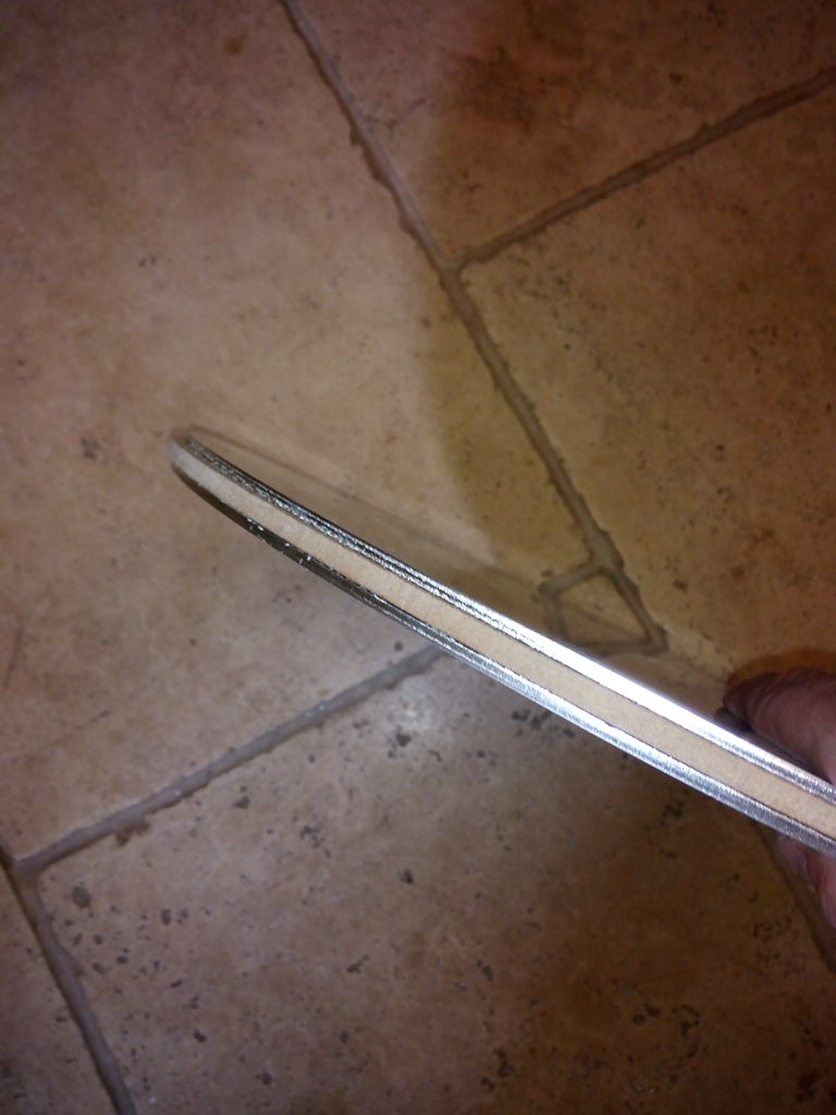

So I am thinking I could make the baffle with some CLD techniques - 3mm aluminium/constrained layer ~1mm (?epoxy) /3mm aluminium = total thickness of 7mm.
From some CLD work and research I have done for previous projects - I am pretty sure there are some good epoxy products that work well in CLD with aluminium - it needs some thing stiffer than the usual stuff you would CLD with wood if I remember right.

I think 1mm sorbothane sheets that you have should work nicely with aluminum. Use contact cement to bond it all together. The rim should have some screws to keep form coming apart but driver mounts naturally do that.
Water activated Loctite PL Premium adhesive could work too. Spritz it with water mist prior to clamping down.
Thanks X!
Will have to look back through my research - for some reason I thought sorbothane was more likely to work as an isolating layer rather than a constraining one due to the aluminium being so stiff.
But you are right - given I was going to use sorbothane as an isolating gasket, I could also use it for the constraining layer - not tried using contact cement with it....
I will start experimenting. 😉
