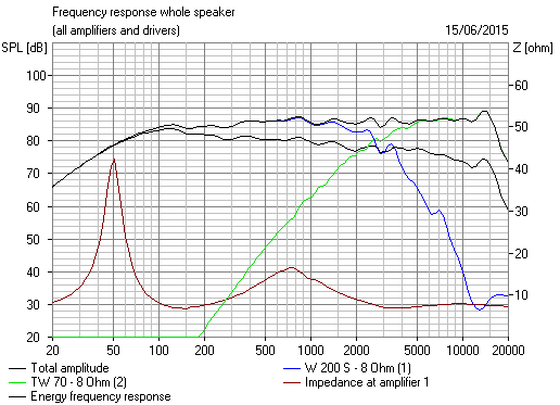

System7,
Great questions and you are not trolling at all. You are aware of my other Harsch XO thread so all I am doing is applying that to a tapered TL with damping applied to produce a gentle fall-off slope in the bass which translates to low group delay. The un-damped TL has a response similar to a vented bass reflex alignment with a double impedance peak. The TL has a lot more vent cross sectional area though so bass output flows a lot less impeded. It achieves low tuning via quarter wave TL vs a BR volume resonator. By adding damping strategically and monitoring frequency response and measuring resulting impedance peaks, one can adjust the bass fall off slope and trade off some extension for less group delay. You know you have the damping right when the impedance peaks get squashed into almost a single broad bump with two little "horns" where the peaks used to be. In this state, the bass extension is still very good and the group delay approaches that of a sealed box. I have measured a GD of 6.5ms at 50Hz. Some of that delay is from the XO filter.
The cabinet is a folded 48in long TL with a taper ratio of 5:4:3:1.5 - tapering produces a deeper tuning frequency than a straight TL. This one is tuned to about 55Hz.
On the XO, I implemented in minidsp active 2 way which lets me dial in time delay for Harsch XO time alignment. This requires the tweeter to be delayed by half the period of the cycle at the XO frequency to allow the Harsch XO to be quasi time aligned. I tried to implement this passively and it's my second passive XO design so a lot of work is needed still. I tried to remove bumps and wiggles which is why it's so complicated. With passives however, the only time to effect such a large millisecond range delay is to physically step the baffle and out tweeter back.
On the speaker you reference above, it does have similar 24/12 slopes - but by its nature of being passive and flat baffle - there is no way it is a time aligned quasi transient perfect speaker. So not technically a Harsch XO.
To do this passively - it makes more sense to spend a little more on a smoother mid bass driver to save on having to spend so much on all the coils and caps needed to flatten it. Not a problem with minidsp. I would use an AC130F1 if I were to redo this for a passive XO. That driver is flat and easy to make work in a 2 way.
Hope that helps.

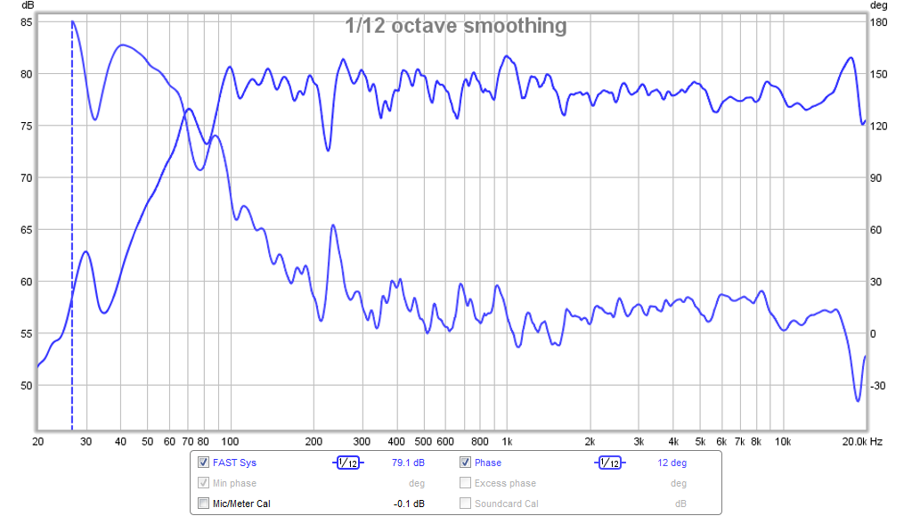

Sys7,
The theoretical phase at XO is detailed in the white paper by Harsch describing the XO. I think it is is theoretically 55 deg and flat above and below for that quasi transient perfect aspect. It's tough to get it flat in reality though as my measured phase if you take the trough to the left to be the baseline - then at XO it is about 60 deg. My phase to the right is deviating downwards and not flat. When you can match the textbook target curves of BW4 and BES2 perfectly - the phase is indeed flat with a 55 deg bump I think. Byrtt showed this with his electronic loop back experiments using a sound card and no speaker.
Here is my measured phase:
