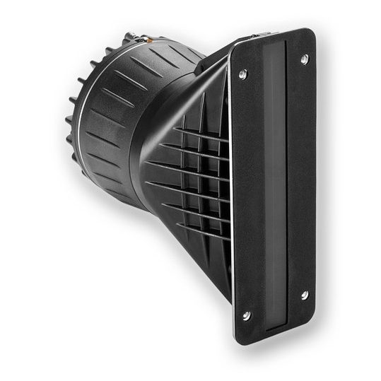

Now I hate to muddy the waters further, but I noticed something interesting in the Danley Jericho J6-42. If I'm not mistaken, this is the newest Jericho horn.
Here's a pic of the high frequency units. There are eight.
Here's a pic of the high frequency units from a Bose DeltaQ. There are four.
Those two look REAL similar to me. Obviously, it's hard to be 100% sure without opening them up. But one of the ideas I had, when pondering Paralines, was to simply use a diffraction slot that's mounted at a 45 degree angle. The reason that this can work, is because the dimensions are so small. For instance, if you keep the exit of the slot down to around 19mm, the wavelengths below 20khz won't form until they exit the slot. (This is also the reason that the layers in the "old school" Paraline are so short.)
It's possible that this solution is superior, because there are WAY fewer reflectors. In an "old school" Paraline there are as many as four bends:
1) There's a right angle bend inside the BMS compression driver
2) There's a right angle bend where the compression driver meets the Paraline
3) There's a 180 bend in the center of the Paraline (ouch!)
4) There's a right angle bend at the exit of the Paraline into the mouth of the waveguide

Yep. If you take the VDOSC, invented by CHristian Heil and used by L'Acoustic, and you squashed it flat, you'd have a Paraline.(1)
Here's a VDOSC. It starts with a conical or oblate spheroidal waveguide. Then you 'slice' off the top and the bottom at an angle of 45 degrees.
Here's a Paraline, for comparison.
Some of the BMS line array drivers appear to use the same geometry also.

Here's my latest attempt at a Paraline. This one is quite a bit smaller than the other ones I've built - the pathlength is just 5cm long.
Here's the unequalized response
Here's the horizontal polars. In the notes on this measurement, I was trying to make sense of why the beamwdith varies so much. I think it's because there's basically three different ranges in the device:
1) Above 13.5khz, the polar response is determined by the phase plug of the compression driver
2) From about 6khz to 13.5khz, the polar response is determined by the geometry of the paraline (I think?)
3) Below 6khz, the polar response is dictated by the walls of the horn attached to the Paraline
These are my favorite measurements. They show the vertical polar response. Note that it's asymmetrical.
This Paraline is designed to curve the vertical wavefront, similar to this convex lens. Note that only the TOP of the Paraline curves the output; this is by design. So that you could put two of them side-by-side, and achieve a single convex wavefront measuring about ten degrees.
