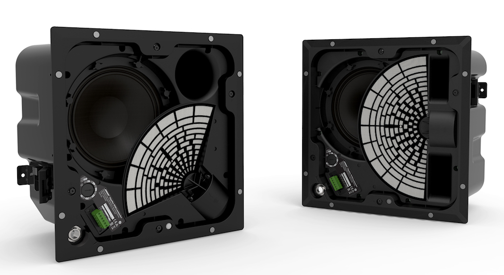

A member over at Diyma noticed a new 'sound reflecting' technogy from Bose
https://patentimages.storage.googleapis.com/pdfs/23aede5e4e817fd67099/US20170006377A1.pdf
The patent is a real skull crusher, normally these things are easy to follow, but YOWZA
I'm not quite sure what's going on here.
Bose is doing some interesting things with compression drivers lately, they've been popping up in everything from ceiling speakers to television sets
I believe these are supposed to be placed in the corner of a room, or where two walls meet. There's a compression driver that has it's wavefront bent 90 degrees. The patent shows a waveguide that looks oblate spheroidal from the top, but like a wedge from the side. Like the Geddes waveguide, it is filled with some type of foam. (I believe Geddes originally intended to use the foam to control the beamwidth of the loud speaker using some type of graduated foam density. The Bose patent seems to imply that's what they're doing, but I can't quite make heads or tails of it.)
Similar to a Paraline, the Bose device is designed to achieve a specific pattern without requiring a great depth. But the Bose approach is completely different.

I ran some sims and they're really not promising.
The grill on the Bose speaker seems to behave like a diffraction device, basically allowing high frequencies to exit through the center of the grill, while low frequencies exit via the edges.
Which is a great plan, unless you consider that a significant fraction of the output is bouncing around the waveguide.
Basically it's a Homster.

That Bose 'Phaseguide' device looks like a variant on a shotgun microphone to me. Seems to be a clever way to get asymmetrical vertical coverage from a flat in ceiling loudspeaker and a fixed horizontal coverage. Unfortunately not easy to make yourself, it must be tuned carefully using finite element method software.
Maybe it has got some sound bouncing around on the onside, maybe not. It probably is designed for meeting rooms where speech intelligibility (directivity / coverage!) is more important than a smooth sound.
It is my opinion (with some data support) that if one is going to have diffraction, its best to have a lot.
Like a Smith Horn? 😀
