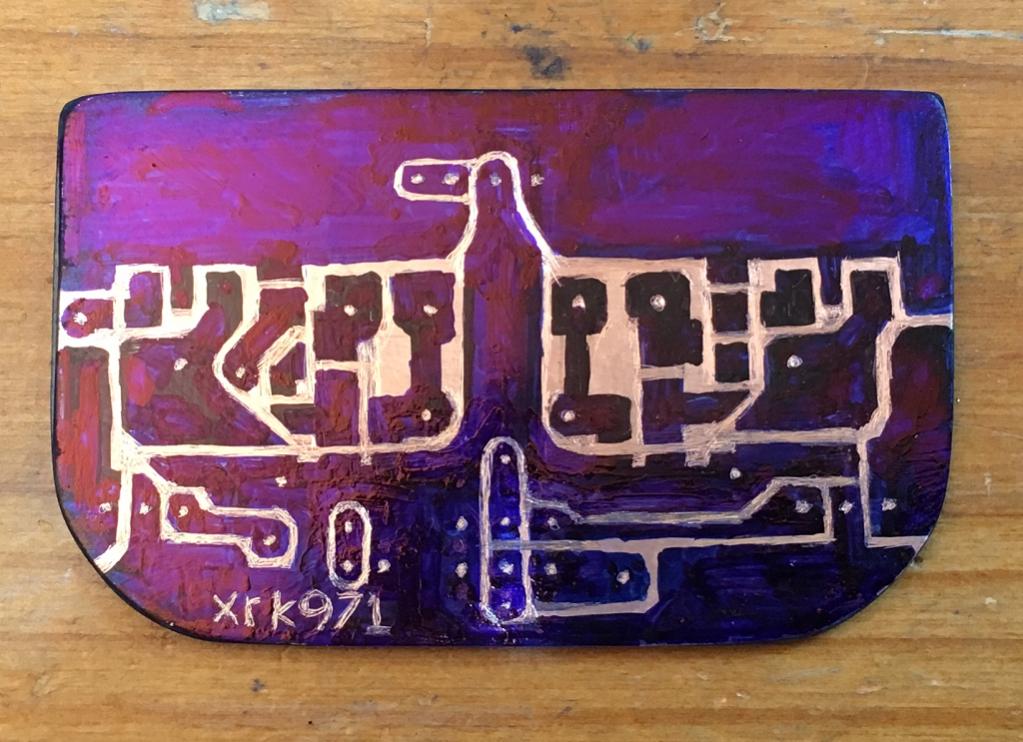

Very cool xrk! I didn't know about the sharpie trick.

You missed the opportunity to also put your GitHub link in the silkscreen as a QR Code, there would have been plenty space. 😉
But gotta love OshPark, their boards always look beautiful and I never had the slightest problem with PCBs from them.
I use these prototyping boards. Cheap from China. Do not overheat them, copper will separate from the substrate. You get what you pay for 🙂
But they work for quick and dirty test work. No need for etching. You can get them online or I found out that MicroCenter now stocks lots of useful electro parts, just like RadioShack used to.
